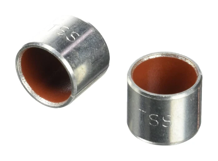

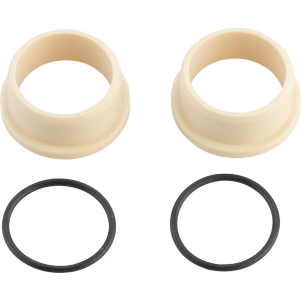

60mm should be fine, original RS hardware works if you remove the preinstalled plastic IGUS bushings off of the Fox shock and press out the thin metal DU bushings out of the RS shock.
Remove:
Reuse from RS:

Yes, it is true, but each of that bushings type need different spacers. The reused ones from RS are easiers because you can keep the original spacers.

The Black stock RS Spacers def look better than the plain cylinder type ones that come on the aftermarket hardware kits.

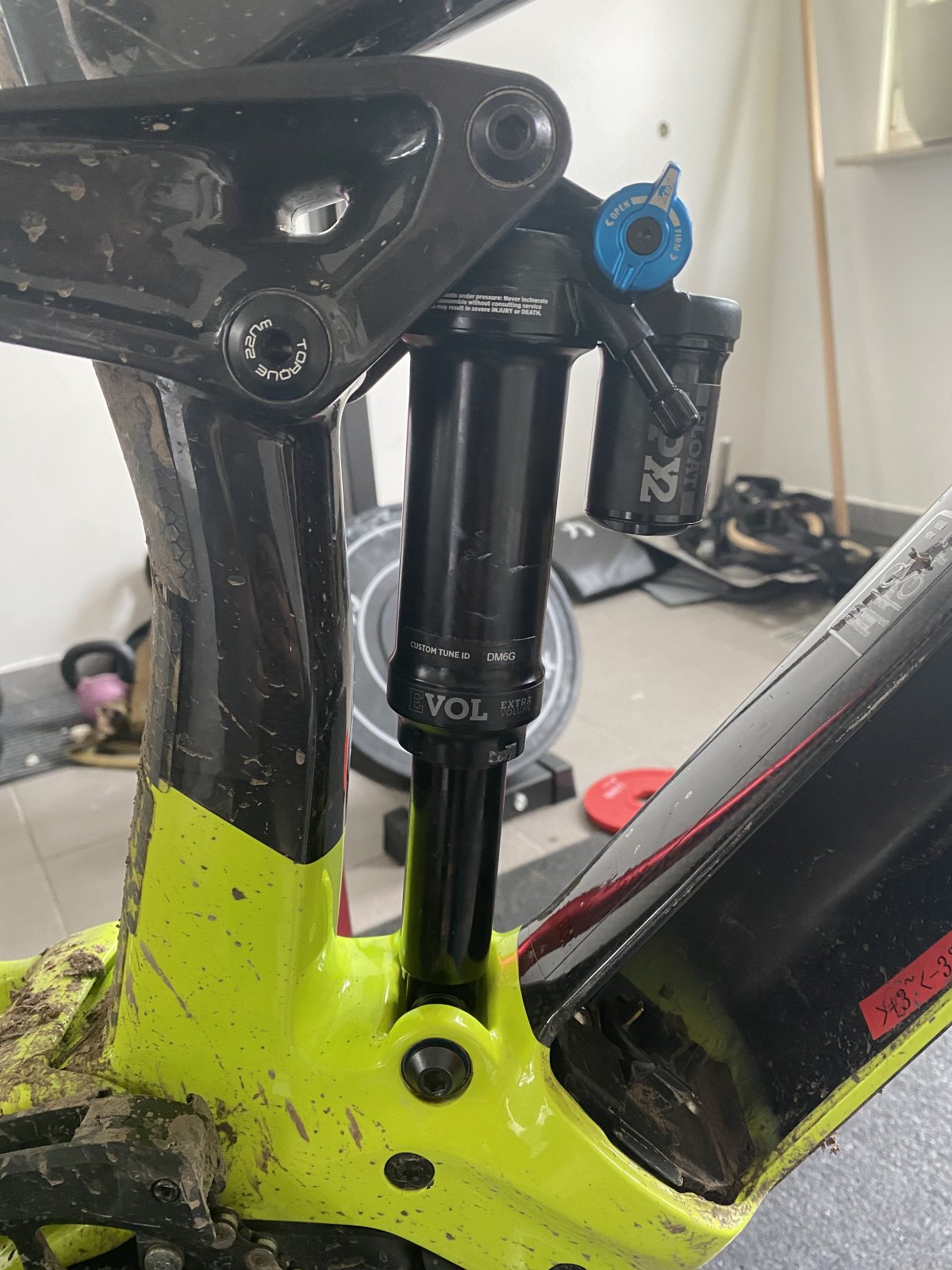

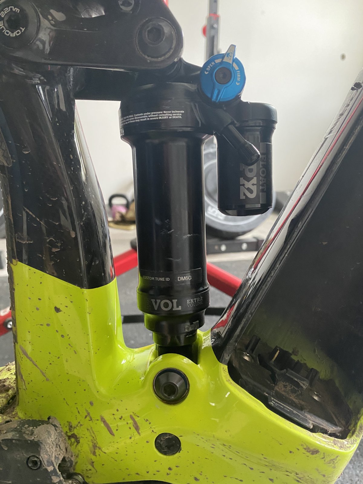

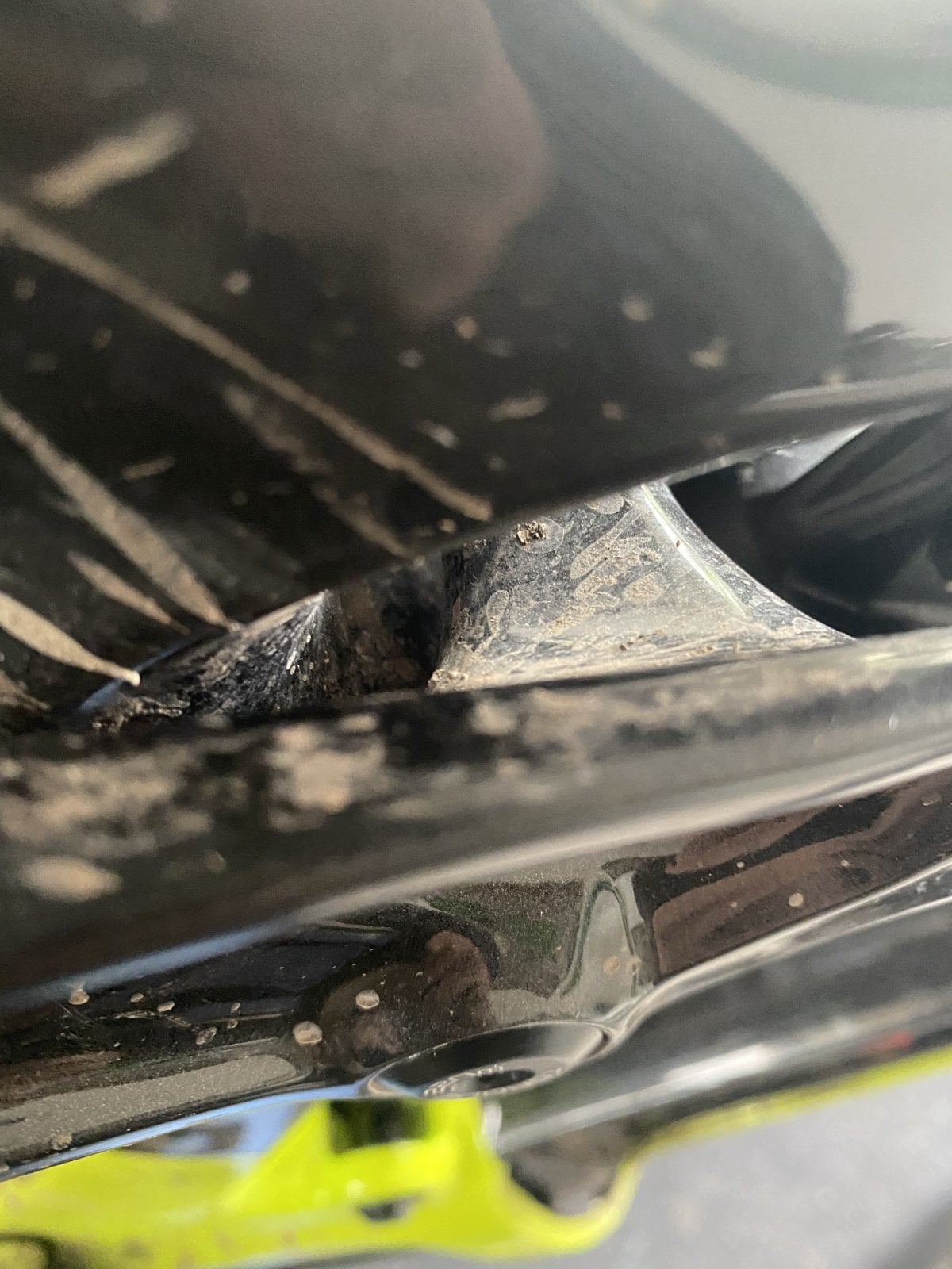

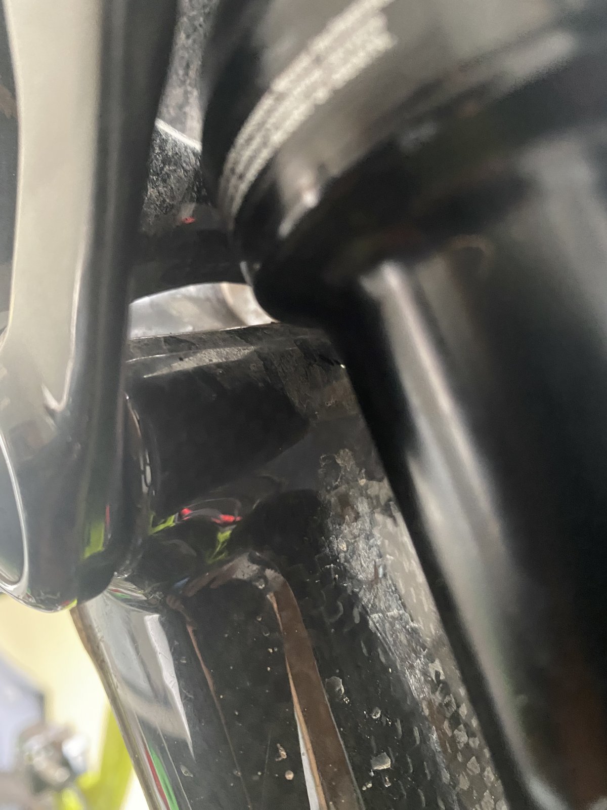

That‘s how a FOX DPX2 Shock230x65 fit into an Rail 9.7 Large Frame
But on the last part of the stroke the bridge from the rear end touches the seattube.
So I have to travel the stroke.

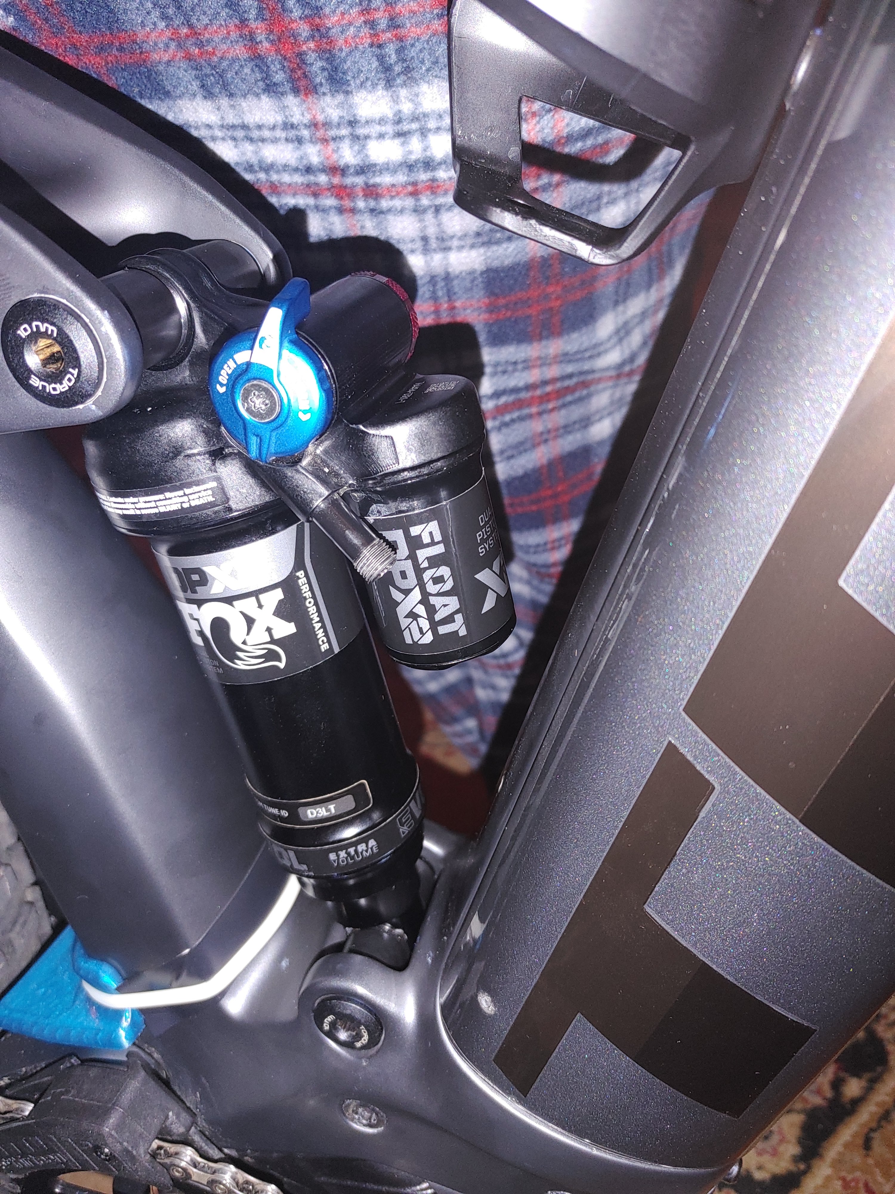

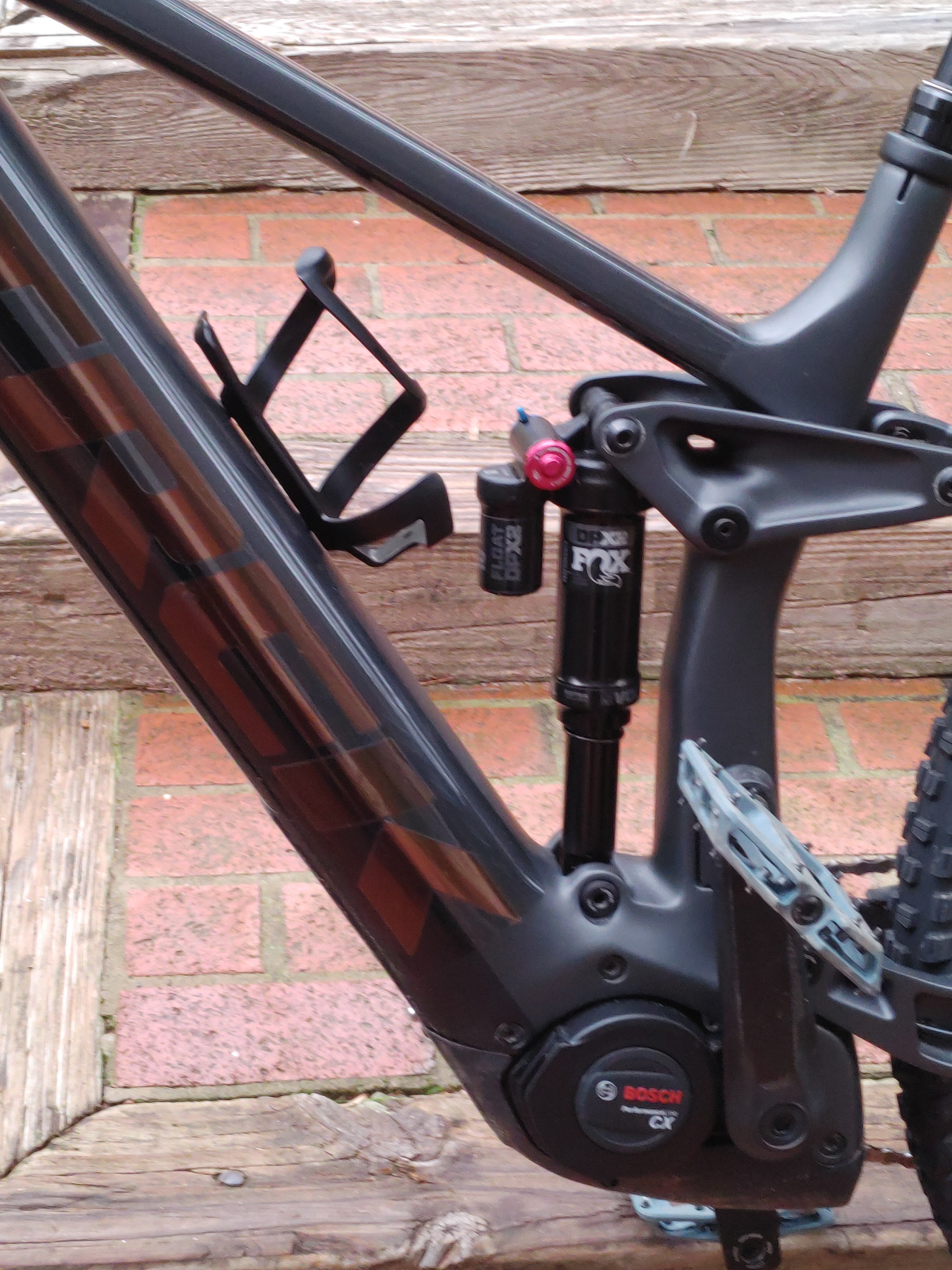

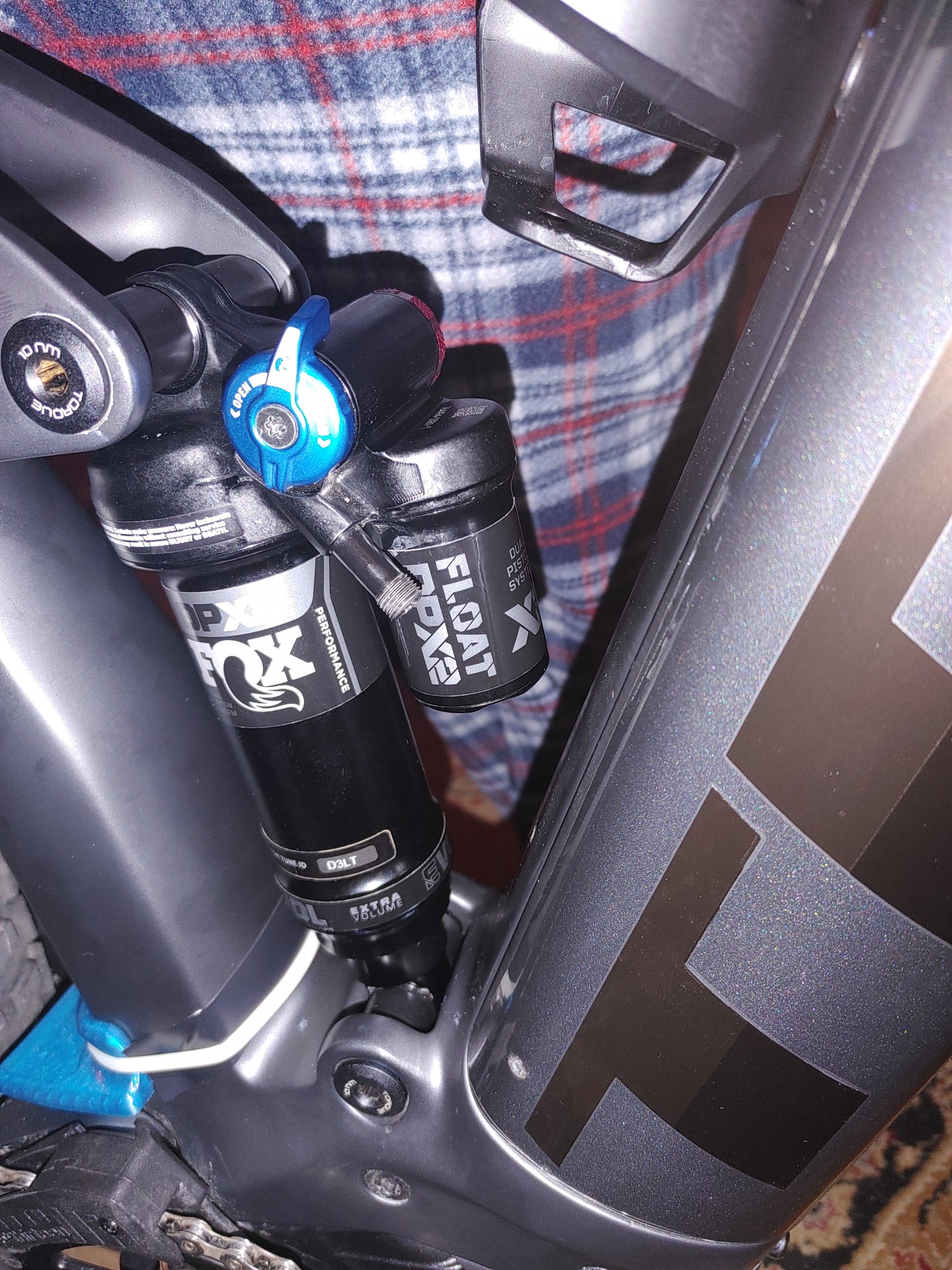

I have a 2022 carbon rail 9.7 and with the help of this thread and a few others I sucesufully swapped over a fox dpx2 230x60 onto my 2022 9.7 carbon rail. I bought Roxshock BU bushing tool and swapped over hardware kit from my Select Deluxe + to the Fox. Everything went smoothly. I did NOT have to purchase a new hardware kit.
I did have to add 25 additional psi to get to 30% sag and add a volume spacer to the shock. I put about 20 miles on it so far but the biggest drop ive done so far has been about 2 feet. I plan on some smaller jumps and some larger drops just to see if In using up all the travel. I may swap back to the previous spacer if I don't bottom out the shock. No issues with clearance.
