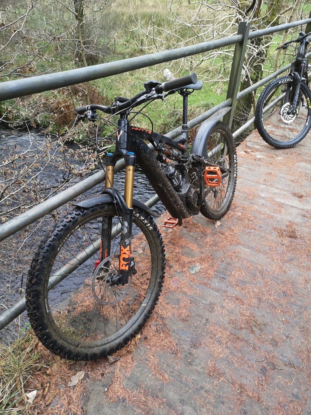

So after waiting almost 2 months for an e160 rs and constantly having the date pushed back i managed to catch a cancellation from the LBS of a 180 rs. 1 week later and here it is :)
proper photos will come but i just had to get it set up and ready to ride.
First impressions are that it feels super heavy and very slack compared to what i am used to and the suspension is going to take some doing to get dialled in. but DAMN this thing is nice :D Feels like it'll just pound the trail out of the way.
chucked some DMR V11's on that just came out as i prefer the composite pedals, grips i'm still wavering on but want to give the standard ones a good going over first.

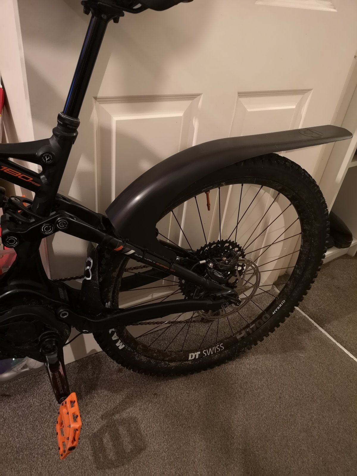

After a fairly muddy ride today I finally gave in and fitted the rear mudhugger. But I need to sort out the space under it.

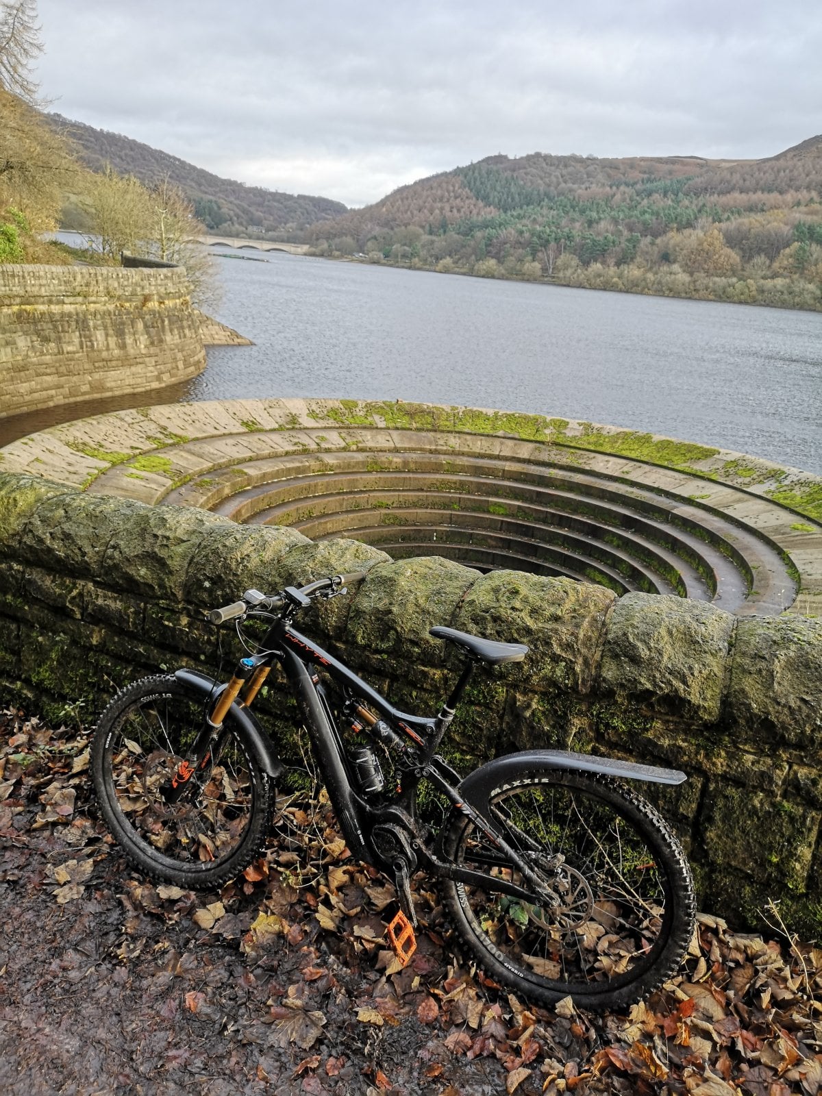

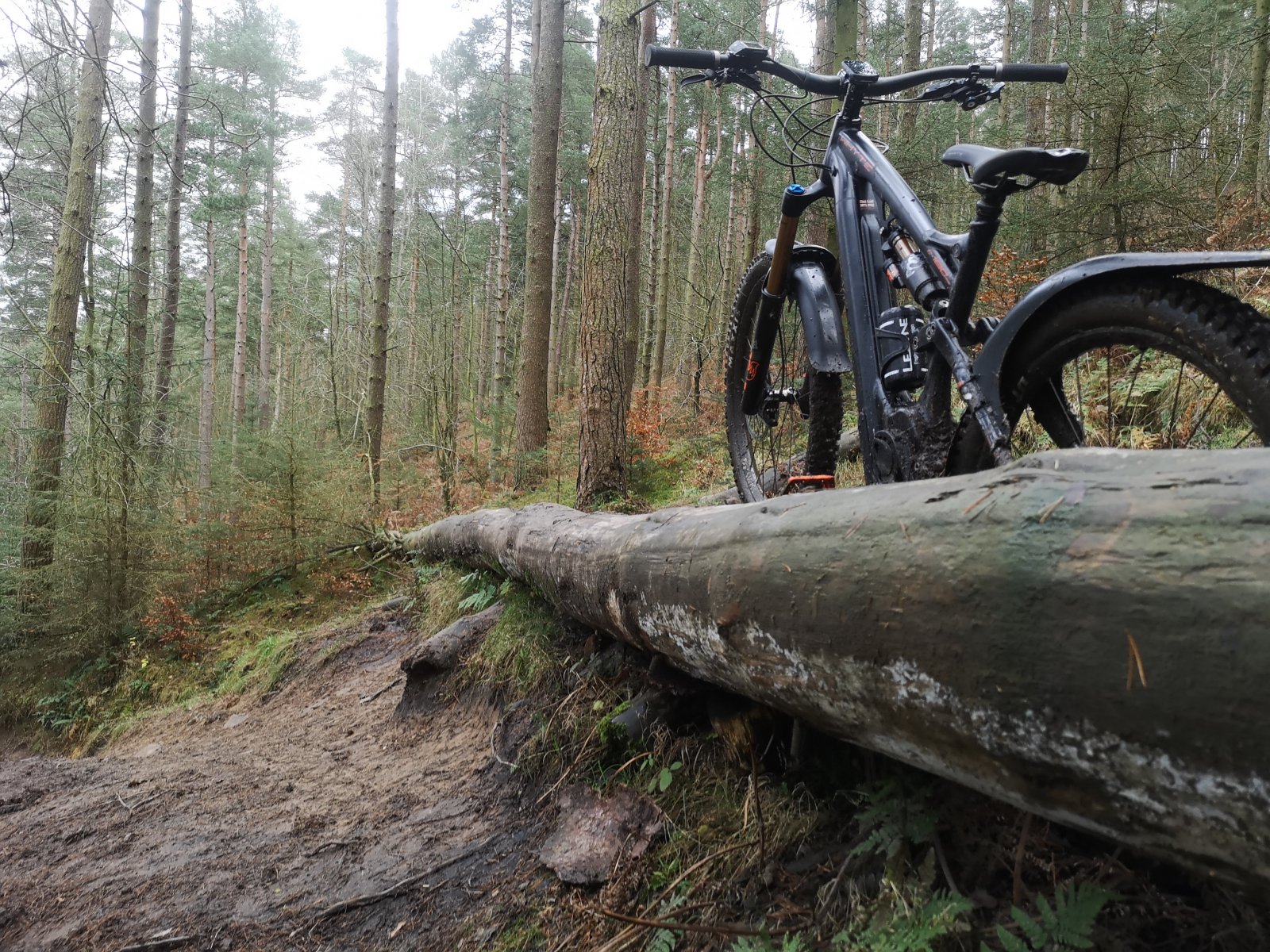

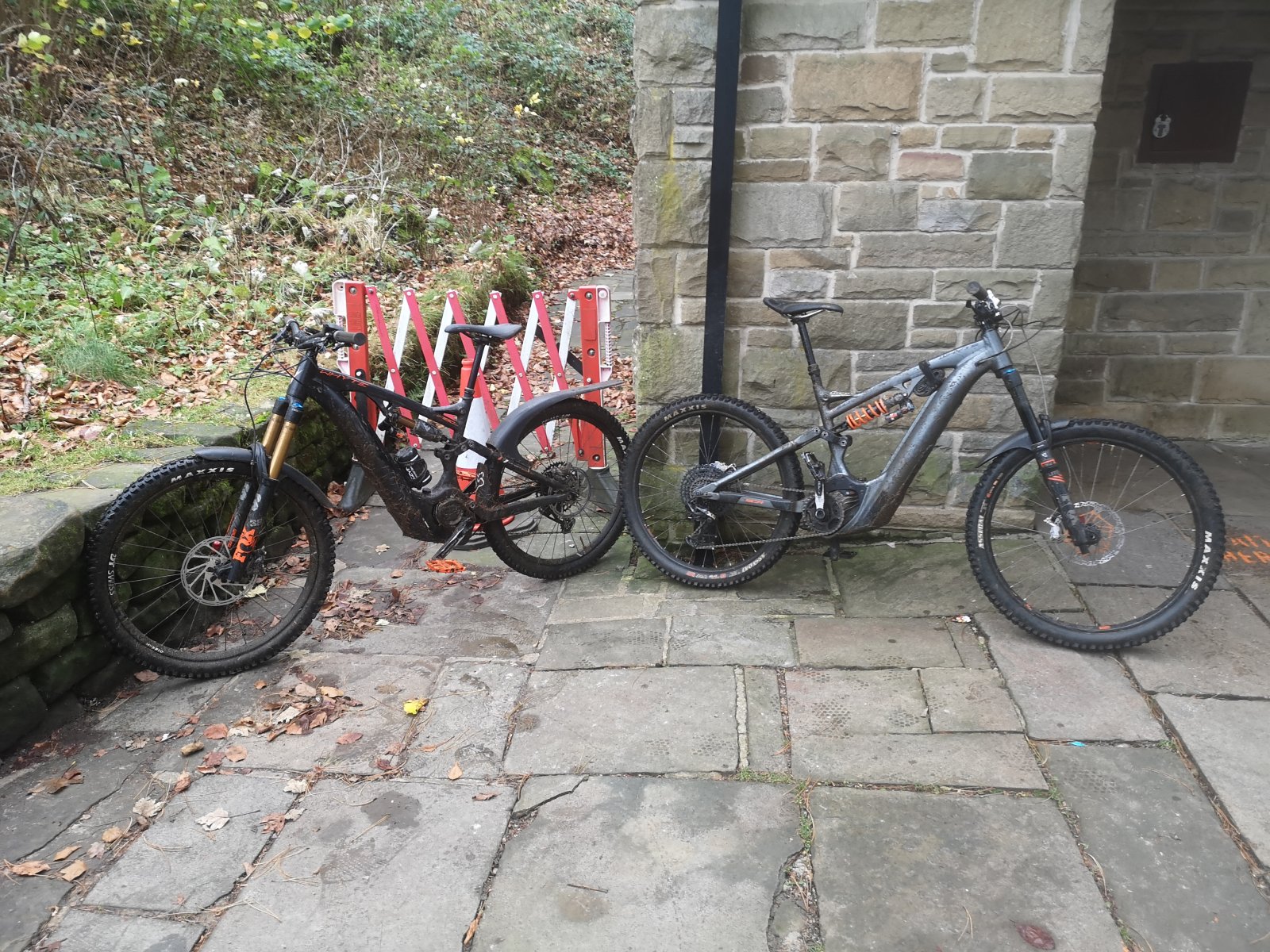

You wait all day for another e180 and two come along at once ? was nice to find some company after getting a bit lost. Serves me right for not loading up the route on the GPS before setting off from the house. Had no signal at all come the visitor centre so i took a wrong turn and stubbornly just pedalled along then took a right and went up as high as i could :D
In doing this slightly off piste route i also discovered that it REALLY is not fun to try and get this bike over a locked gate.

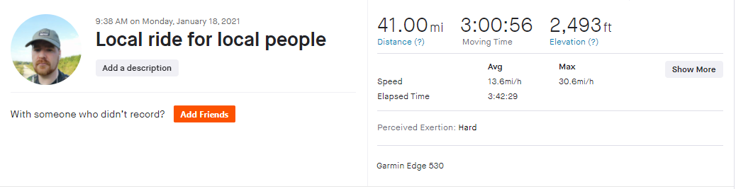

However when i got to the point of photo 1 i was able to get the garmin to load up the ladybower loop that i wanted to do, just a bit down on expected range. So off i plodded soon to be blown away by how composed it was down through the rocky paths back down to the 'start'. I really got to get a feel for how more capable this bike is than I am. Slightly concerned about my estimated range i did a good chunk of the first few miles that weren't stupidly steep in eco mode. Once i had reached the first summit i really enjoyed the mostly flat to downhill open sections with rocks you could do little hops on, down over the a57 and crossing the dam to then be trolled by my garmin which sent me up a stupidly steep and technical trail for no reason. Being too stubborn to turn around i plotted the nearest trail to get me back on track which resulted in discovering what must be something bordering on a proper DH track which had some gnarly drops and with the extra slop was highly terrifying/enjoyable.
Back on the main trail and climbing again which eventually lead me around to the start of the beast and this is where my luck changed. Just as i was about to set off down a group of 4 appeared two of which had the v1 e180RS and didn't mind me tagging along. It was my first time being in a pack of ebikes and it was fun to be flying up the hills and then back down again.
Before i knew it i was back at the visitor centre and it was time to head home. Certainly need to do this again with a bit better planning (and beefed up arm muscles :D)
