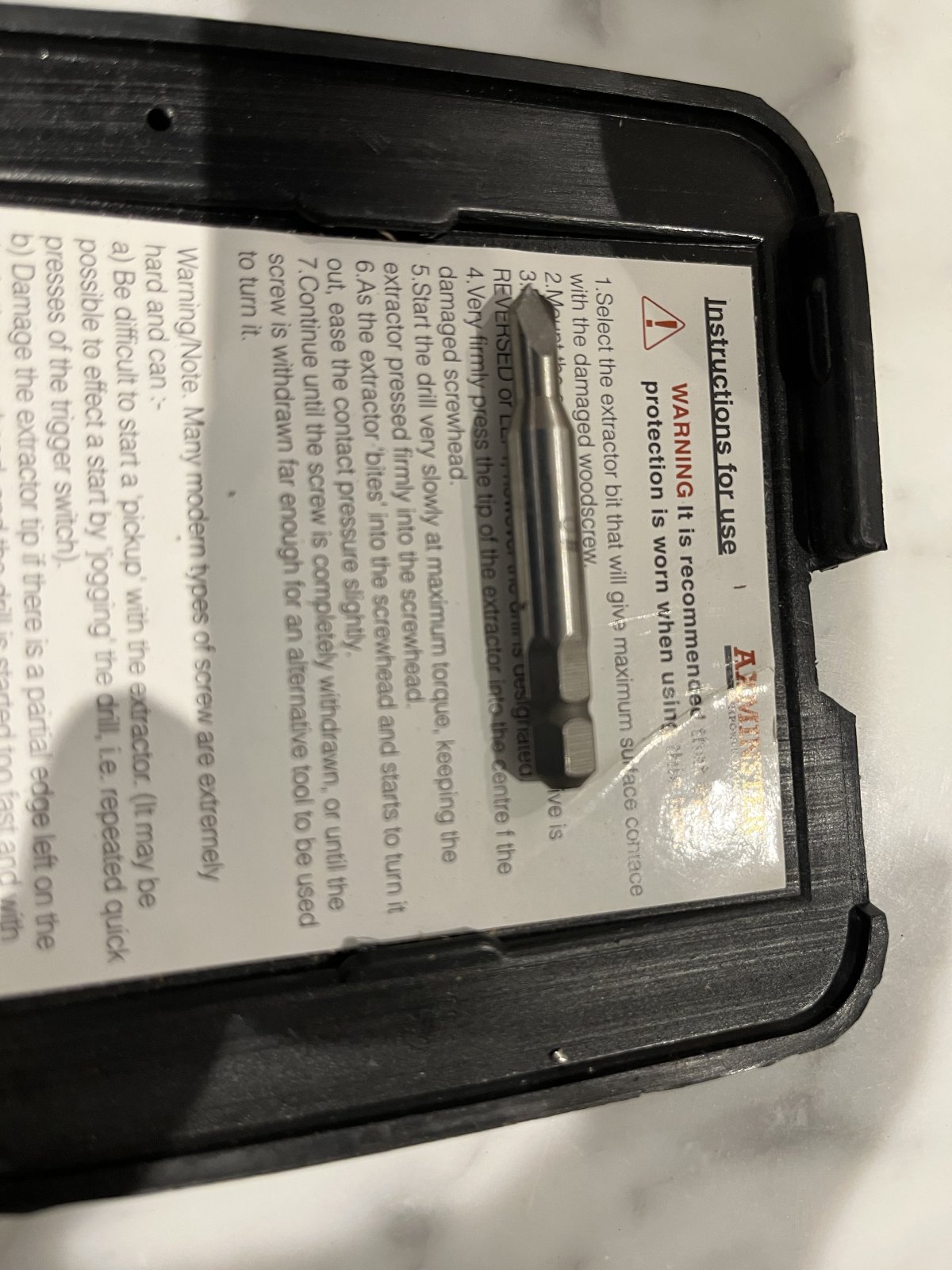

I am a little late to this group, however I have just had the same problem with a successful outcome. My mech hanger failed on my 4th ride out on my Whyte e160rs (from new). It happened when I changed down in Tour mode. There was no impact. The head of the fixing screw went with the mech hanger.
I tried drifting the remaining shaft out with a centre punch but this failed because the screw is too small.
I then punched the centre of the screw shaft with a sharp punch. I have a Makita right angled drill and I drilled down a couple of mm using a 1.5 M drill. I then used an Axminster wood screw remover size 0 (as shown) and to my surprise the old screw came out cleanly.
That said, I think it was 60% luck and 40% having the right tools. I would only recommend this as a last resort.
