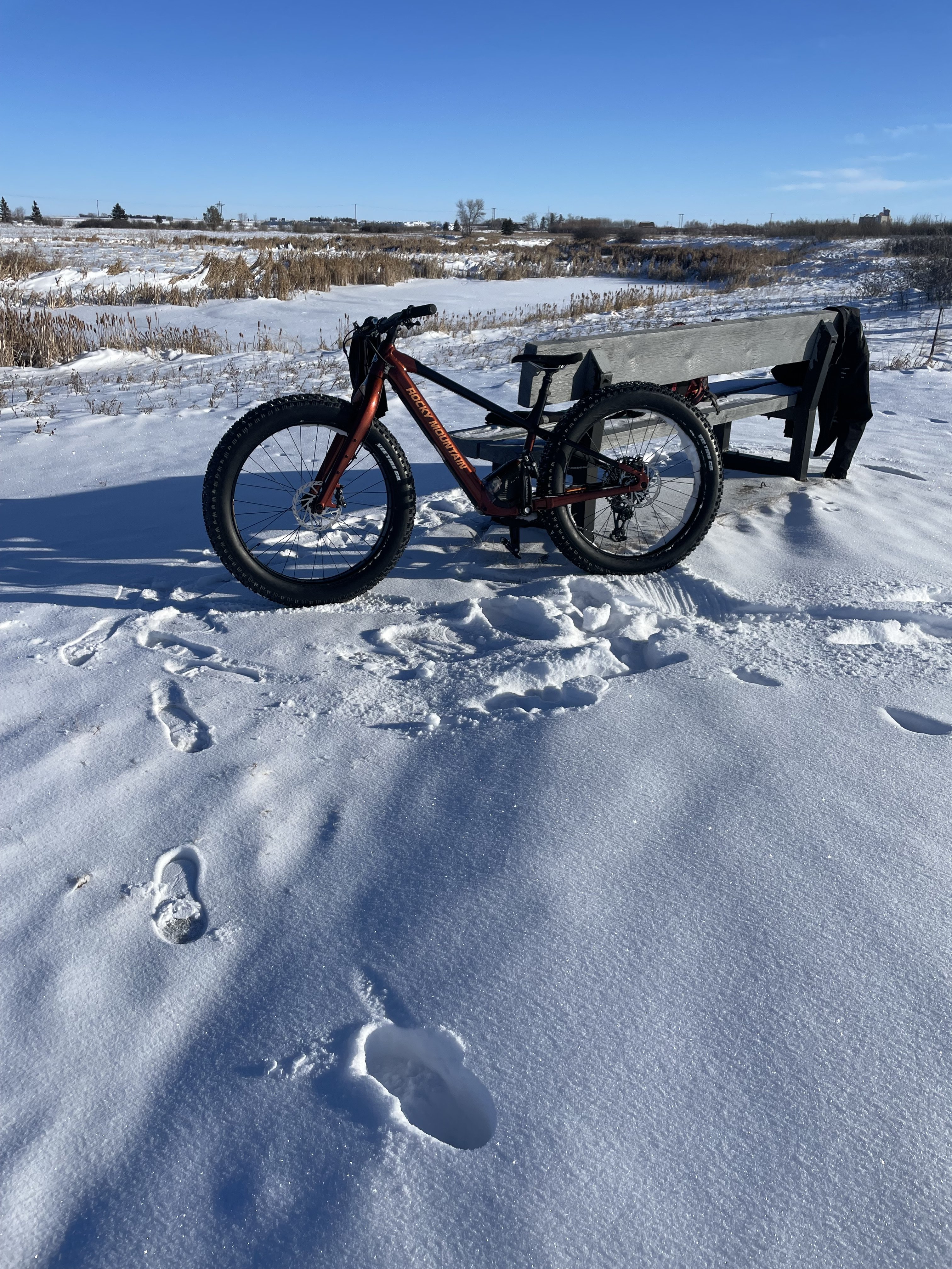

So I rented a Moose Manic over the weekend. In rode it for about 5 kms before it had a chainring issue and then was no longer rideable. Taken back to the shop for repair.
It was a large and felt more nimble than my xl Bigfoot. I wonder how much had to do with it not having a front suspension on the Manic. My Bigfoot has manitou forks.
the Bosch may have had a bit more torque than the shimano. Not a drastic difference by any means, but a slightly more boost feel going uphill.
It was comfortable enough and rode well.
I just didn’t get to ride it enough to be able to provide a decent review.
