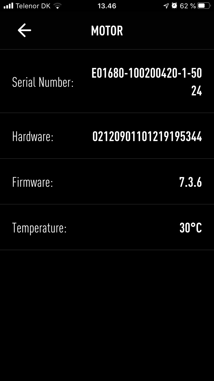

Levo Gen 2 Who has already updated his 2019/20 Levo to motor v. 7.3.6 ?
Peter#DK#
Apr 11, 2019
9
Denmark
So where in this serial number Is the date?

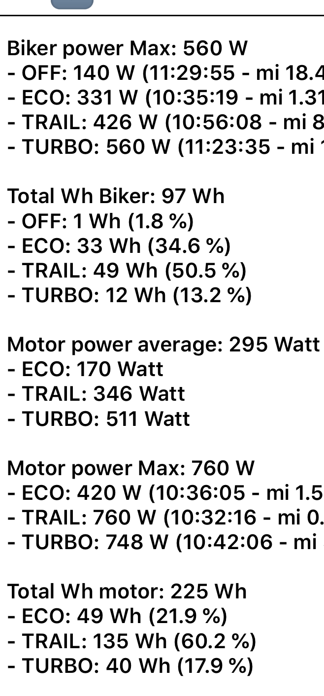

I had the firmware update last week and all good so far. I‘ve not really used the walk mode so not too worried. Last year the (noisy) motor was changed out and the replacement had a max power of 711W. However, since the new firmware I can now get 760W ! See BLEVO below from short ride.
lumpy
🚁 CHOPPER 🚁
Nov 26, 2018
469
441
SF Bay Area

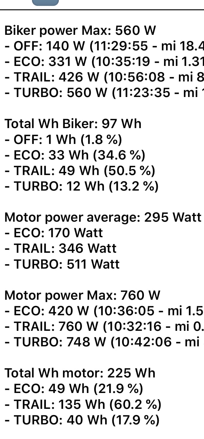

My motor max the other day was 754W :love:
No loss of power, and it felt more seamless in the delivery. I also noticed that when I hit 20mph (I'm in the US) the support power rolled off more smoothly and not as noticeable as before.
I do use walk assist on one set of stairs and found if I hole the button for about 10 seconds then it perks up a bit - not as much as before but enough

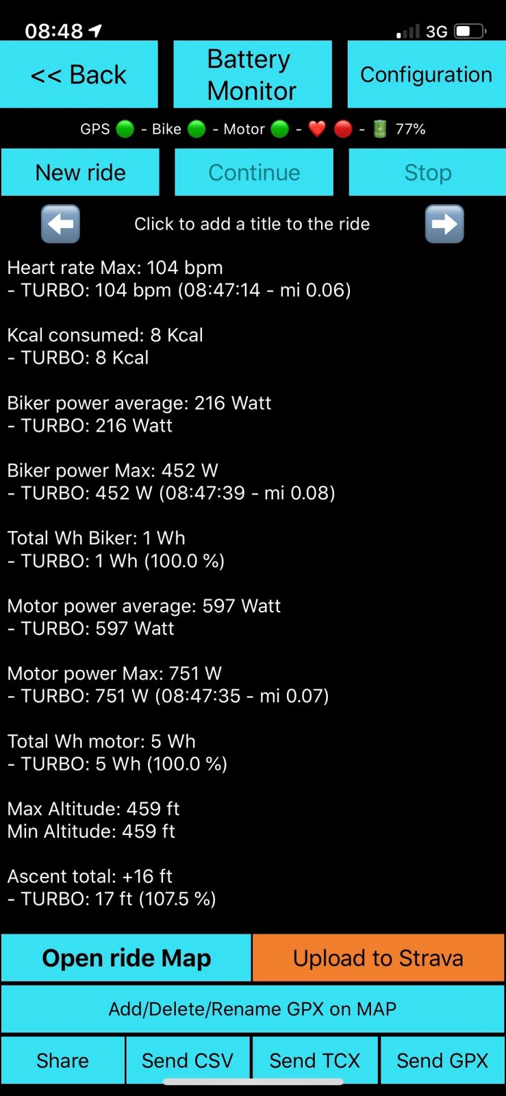

Not sure the new firmware is giving extra power - I'm on 6.1 (so old firmware) with a 2.1 motor from April 2019 - gave it a very short try this morning and got 751w:
