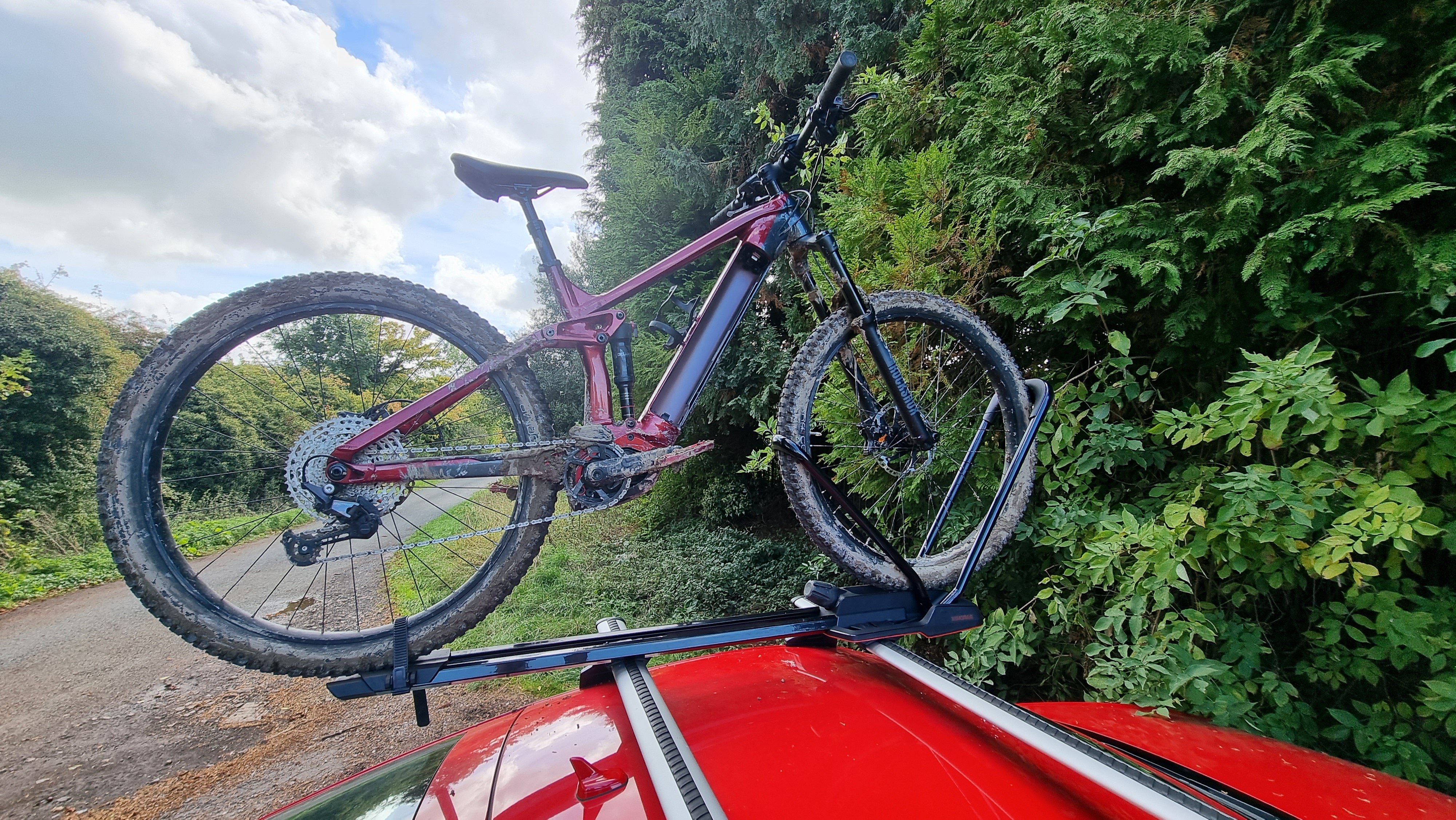

Yakima High Road. Had this for over a year and done thousands of miles with the EMTB on it. It’s a great bit of kit, really easy to use too.
I also have various Thule roof carriers and this makes them seem like plastic toys, and is way easier to get the bike into place on.
It holds the bike rock solid, and most importantly the connection of the carrier to the roof bars is substantial, and spreads the load really well.

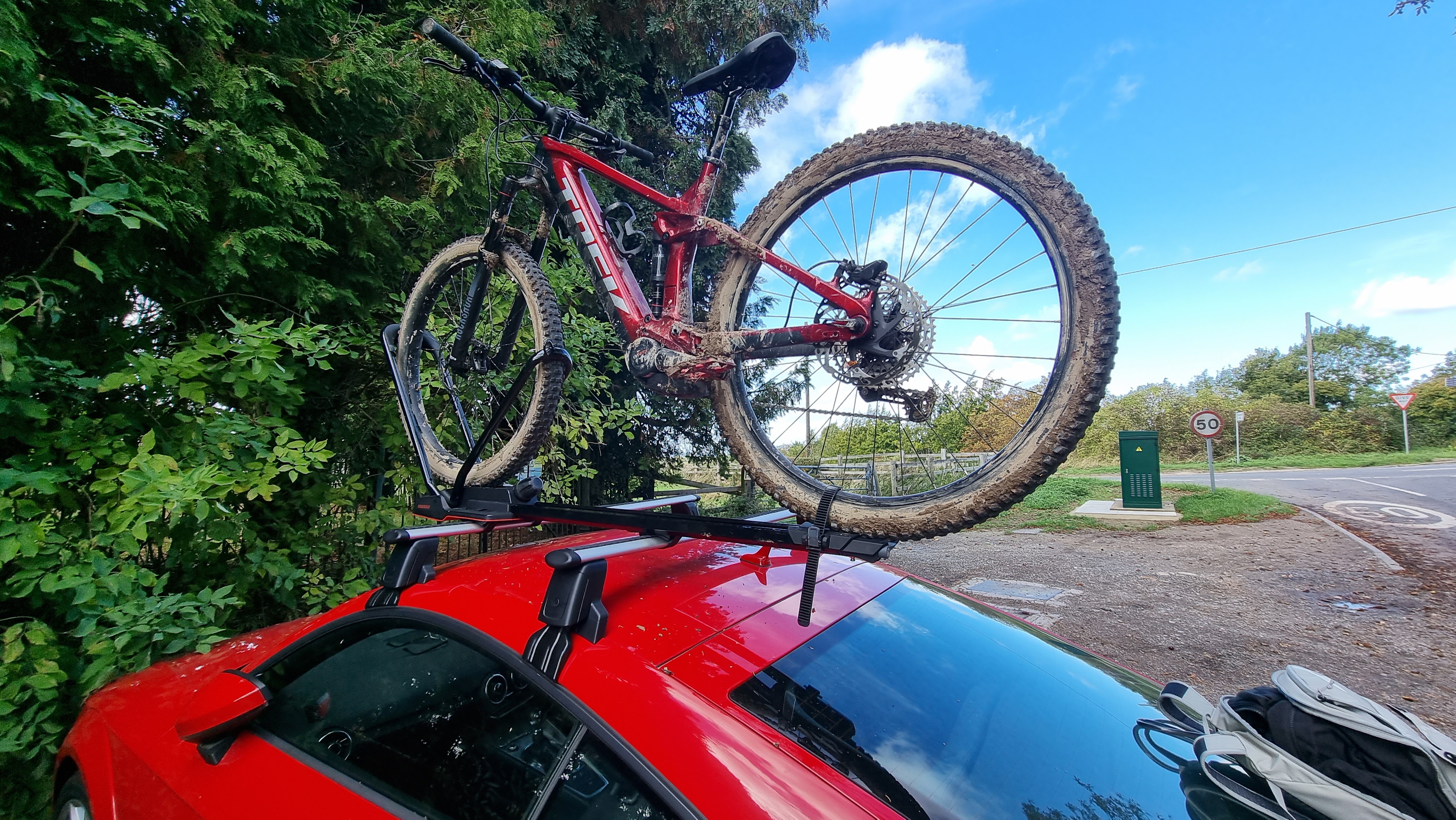

Worked great (didn't fall off) thank you.
Pasho's solution still working great 5 months on. Two 5 hour round trips to Bike Park Wales, various eyebrow raising collisions with trees while driving in the Surrey Hills and the Levo is still with me. drive it like this 3-4 times a week
Even use it for the non ebike.
I have to twist the straps (so they are not flat like in the picture) to avoid any noise, otherwise I get this unholy buzzing noise. Was going to get a van but not sure if I can be bothered.

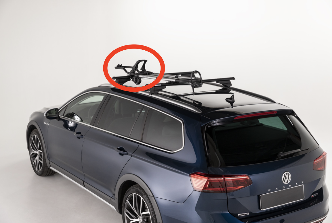

i just came around this roof rack that can carry up to 25KG !!!
does someone hear about it or actually have some real experience with it?

Interesting - I would worry that this bit would whistle like crazy in the wind though when you haven got a bike on it.

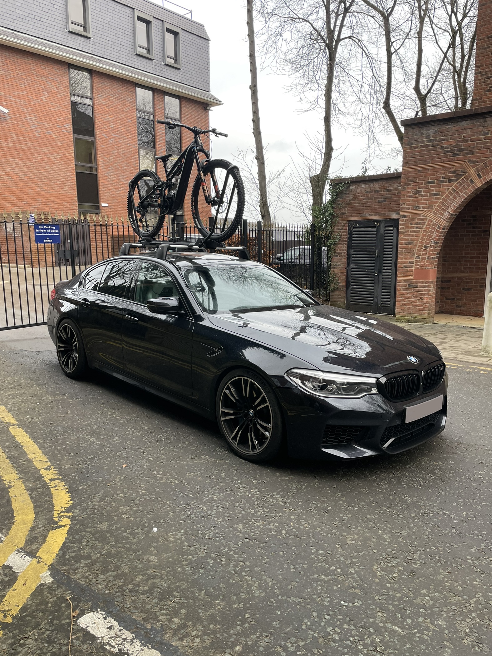

I'm looking for a roof rack to carry a Whyte e-160 and a Levo Alloy, unfortunately there is no tow bar available for my car (BMW M5) and sold my Defender a few weeks ago so my only options are buy a van which I have no room for or get a roof rack. Getting the bikes on shouldn't be too bad, the car is quite low and I have a little step ladder.
The Whyte with battery removed will be about 22kg and the Levo will be around 20kg.
The two options I've seen are the Yakima High Road which now says 20kg limit so the Whyte maybe too heavy for it or the Inno Tyre Hold 2 which has a max rating of 23kg so with the battery removed both of the bikes would be fine.

I ended up going for the Inno Tyre Hold 2. Seems stable. It’s a bit of a pain loading the bike as you have to lift it quite high to get it in the actual wheel holders, after a small pedal incident I think I’ve got it mastered.

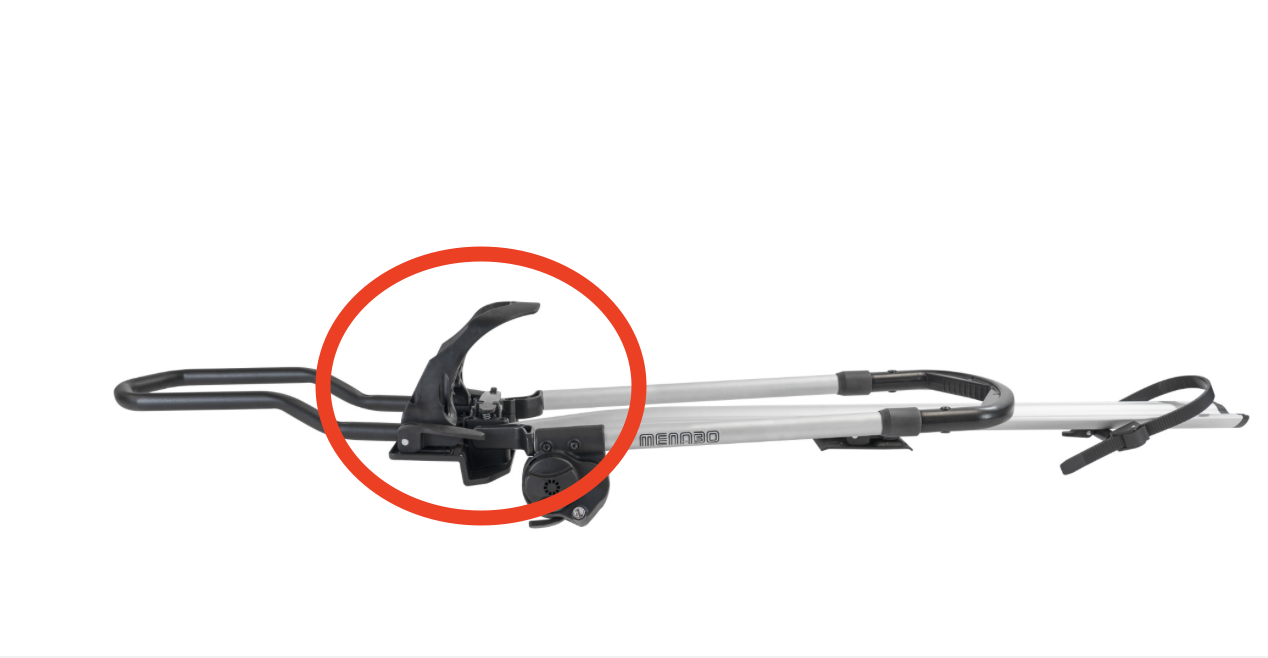

No, the bit that clips down to hold the rear tyre holder in place has become faulty. I’m awaiting a replacement. To be honest I think I broke it by trying to ram it down too hard. I’m tempted to try another rack, there is one called the Menabo Chrono that is specifically made for e-bikes, has a 25kg limit.

I’ve not tried the Menabo one yet, but I believe someone on this forum has and it broke, I don’t think they were best pleased with it, if you do a search you should be able to find the thread.

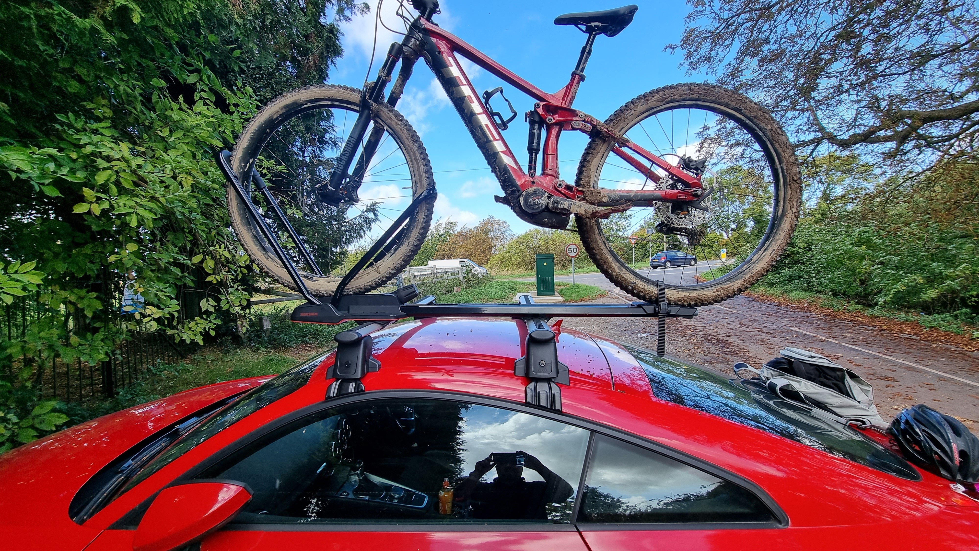

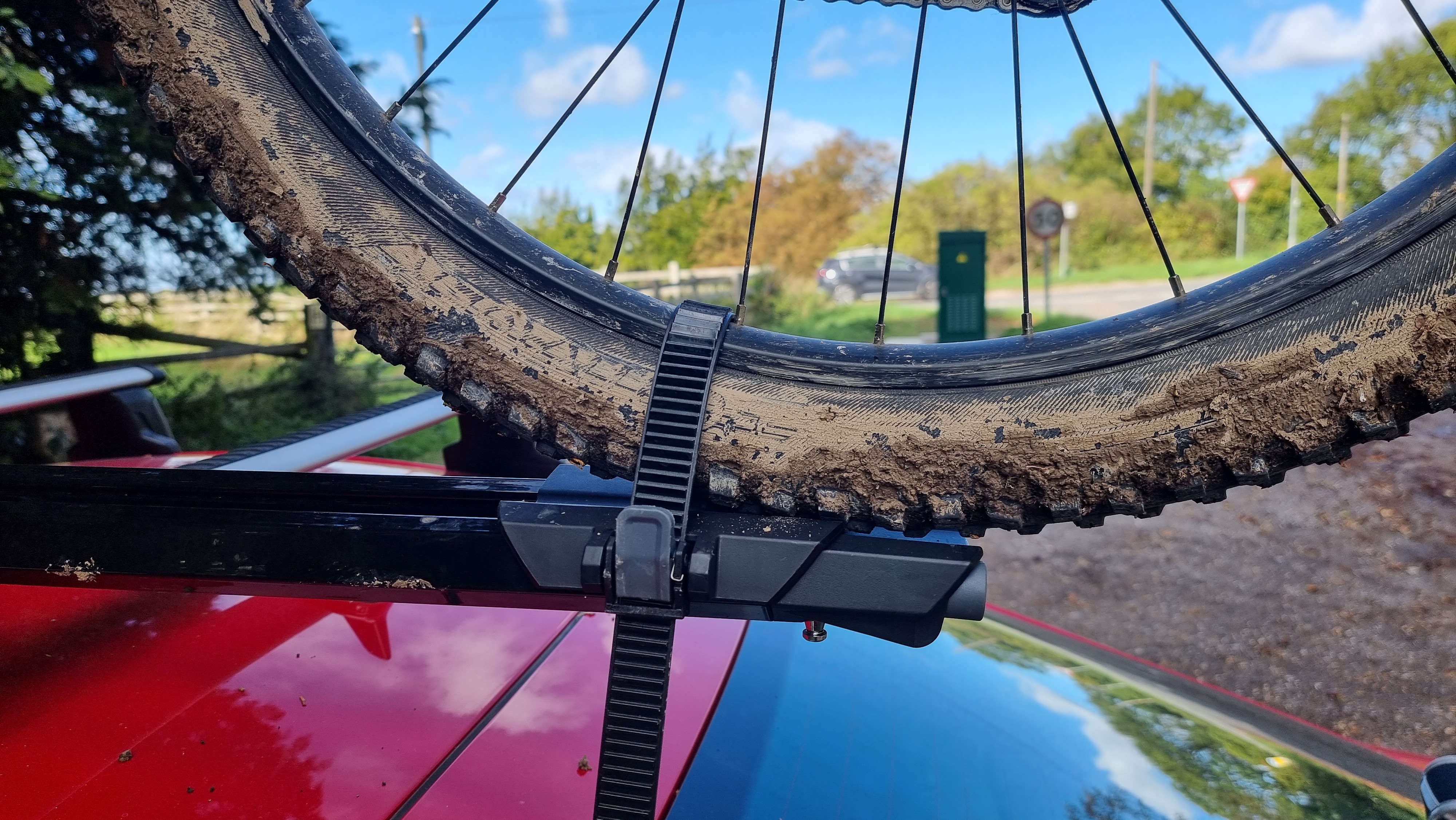

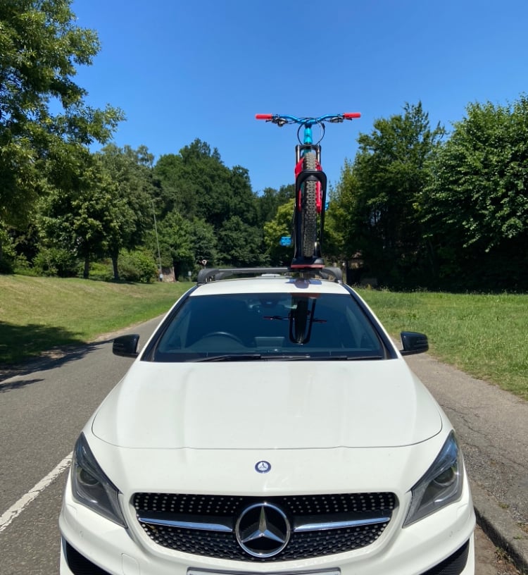

I went for the Yakima Highroad Black Roof Mounted Bike Rack (Tyre Holder), it's a very solid build and holds the bike (Trek rail 5) great. The only observation is that with a large bike with 29-inch wheels the back wheel is only just supported by the rack. Something to check if your bike is very long.
Yeah, that seems to be the problem with most roof racks. (in addition to the obvious weight limits)
What's the wheelbase of your Rail?
