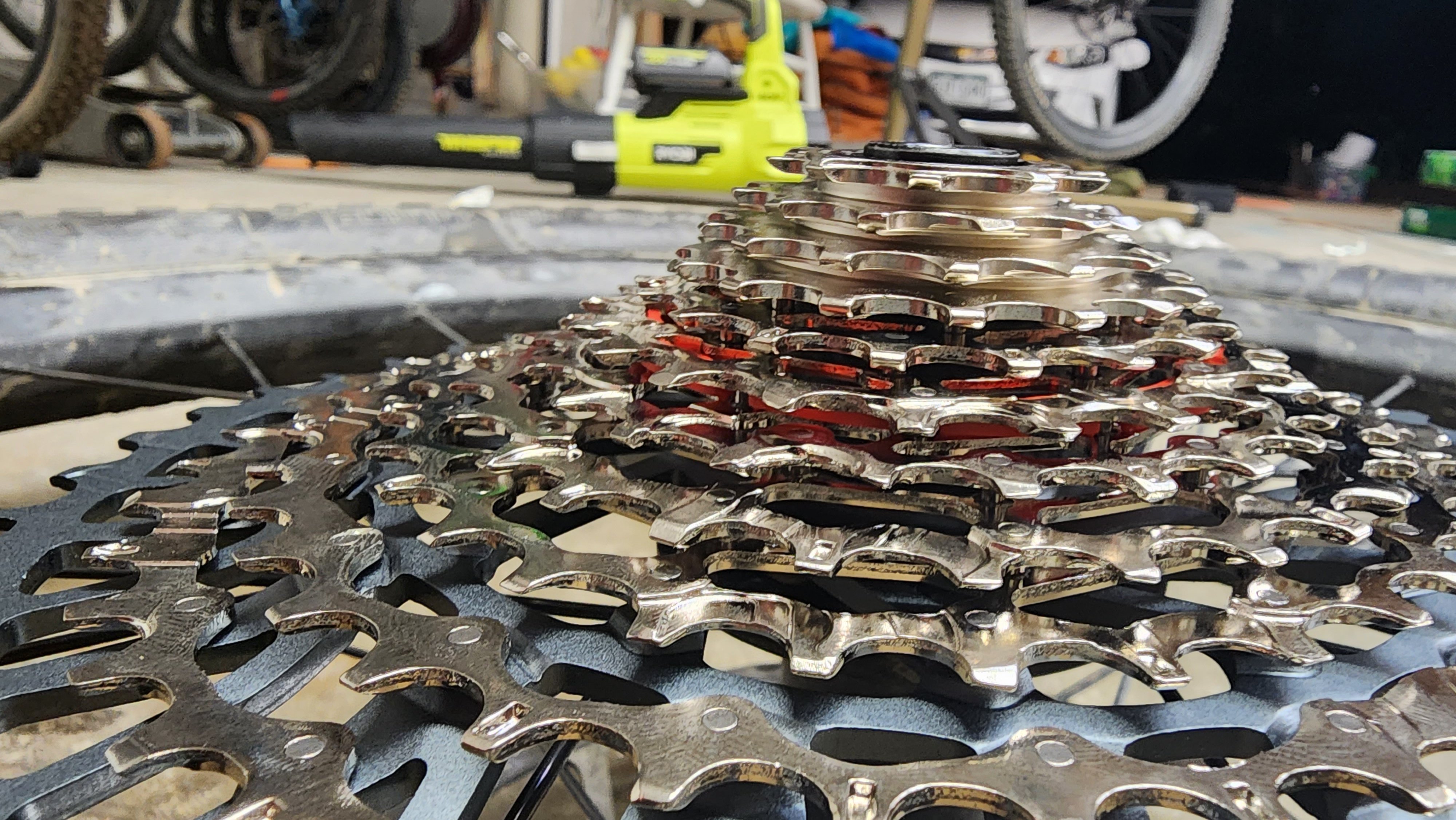

I'm installing the transmission cassette and derailleur on a gen3 levo. I've rechecked the install several times and can't figure out what I've done wrong.
When I tighten the axle down the wheel won't turn because the cassette is bound against the derailleur. It looks to me like the spacer needs to stick out more to accomplish this, but I don't think I lost any spacers or anything. It should stick out more than that though right?

Looks like the cassette is not properly seated on the freehub because the endcap should stick out more. Got any better photos?

To me that does not look like the cassette is properly seated on the freehub body.
Remove the cassette from the body and when you put it back on turn it a little bit until you feel it seating properly, and then you can start to thread it on.

Took it to the shop and indeed they had crossthreaded the cassette so it didn't seat. That's frustrating since i was going to do it myself but wanted to make sure it was done right. They said they were able to chase the threads and everything looked good, though I'm certainly going to make a note to bring it back if I ever have an issue w that cassette. It wasn't cheap.
