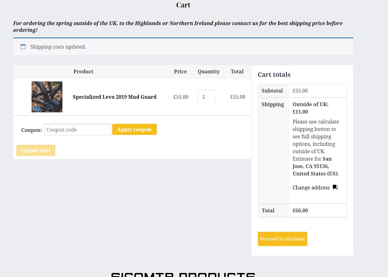

SicoMTB mud guard $70 + $14 shipping = $84 USD to California
In the grand scheme of things not much vs. the big $$$ we paid for the bike, especially for a small-volume custom-fitted product. Besides, I'm already in for a new rack to transport the beast (1 Up USA). My Kuat Sherpa 2.0 is technically overloaded and the Levo is longer than the max rating (it hangs precariously off to one side). Oh, and I like the Blevo app but really should get one of those cheap outdoor-rated phones... What's another $84? :p

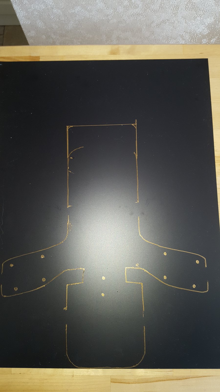

As an update on my plans to make my own I decided first off to identify the type of plastic used to make the various mudguards out there...and where to source a supply. So the right plastic is called Plasticard (UK)....also known in the US as Styrene or HIPS. The matt finish version is best if you intend to paint or glue the finished product. I ordered 1mm thick which is as thick as you need to go....most of the branded mudguards are 0.5mm or 0.75mm.....which is easier to cut etc but I want mote deflection strength. Plasticard sheet is extensively used for modelling so craft/ modelling outlets are the best supply source. Plasticard is flexible, non brittle, can be easilly cut glued and painted. You can also thermoform it with water at 80°c using a former. I got 3 sheets each 325mmx440mm for £9 inc postage....enough to make 3 rear mudguards. I am on ver3 for the template. If that is right I can cut and fit in the next couple of days

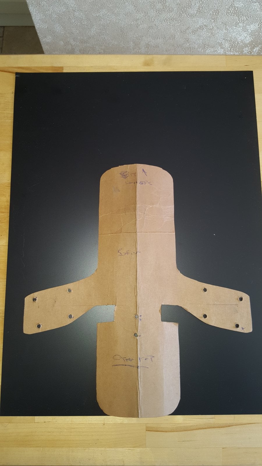

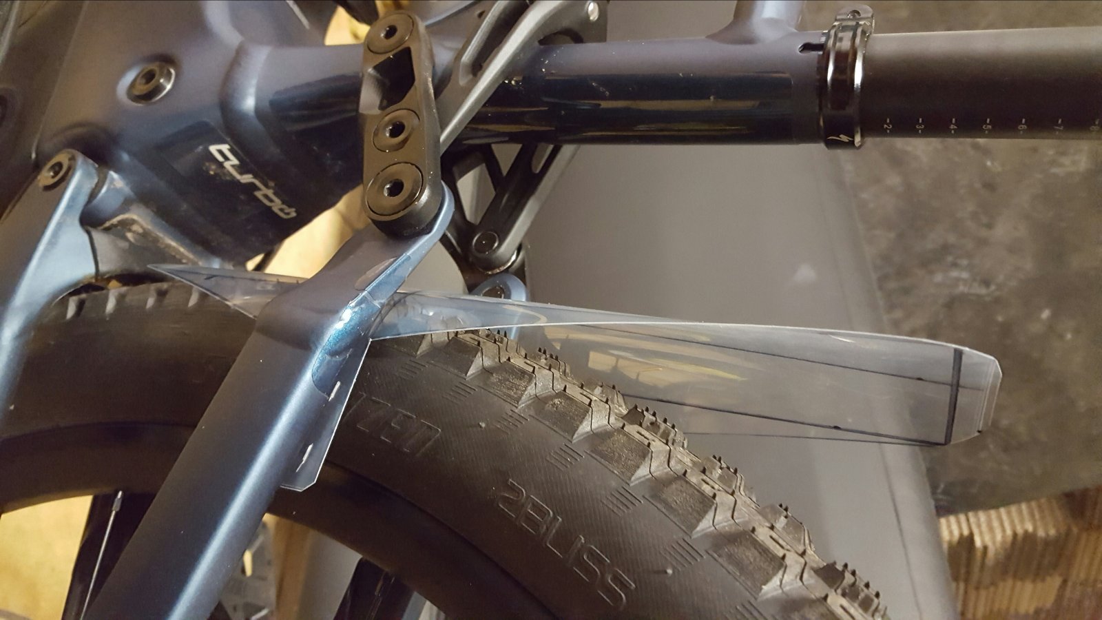

Mikerb
May 16, 2019
6,745
5,218
Weymouth

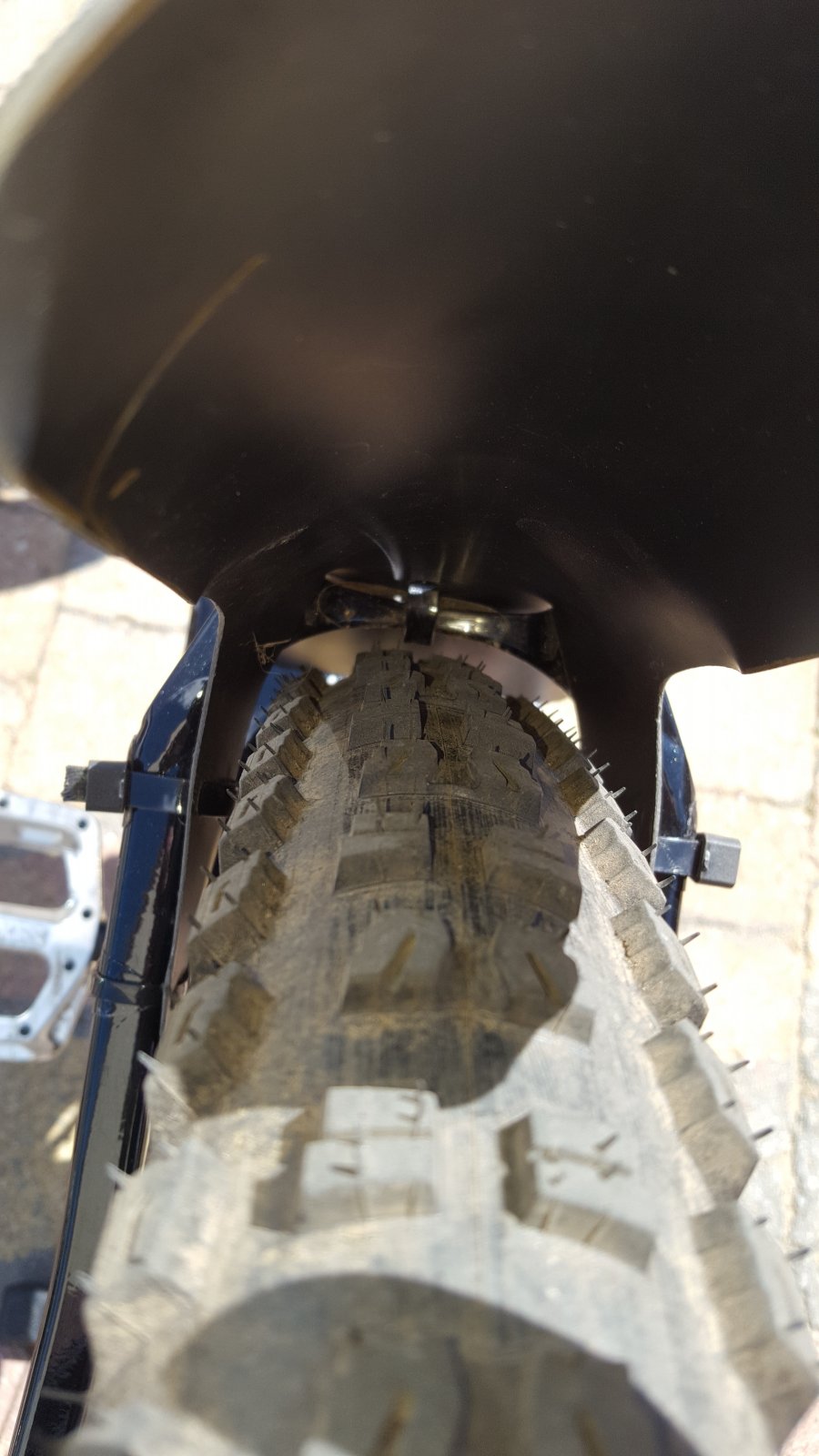

Diy mudguard....cost £3. The difference between this and stock items are
1. Thicker material...1mm
2. Fixed behind the cross bar of the upper chain stays...not between the tyre and the cross member.
3. Tall enough to match the top of the diameter of the rear wheel/tyre.
The motor protection seal/kit will be fitted on my bike at its free service so I probably will not bother with a separate piece below this one. Meanwhile I have pushed a kitchen sink sponge/scourer into the gap and replace it every couple of rides.

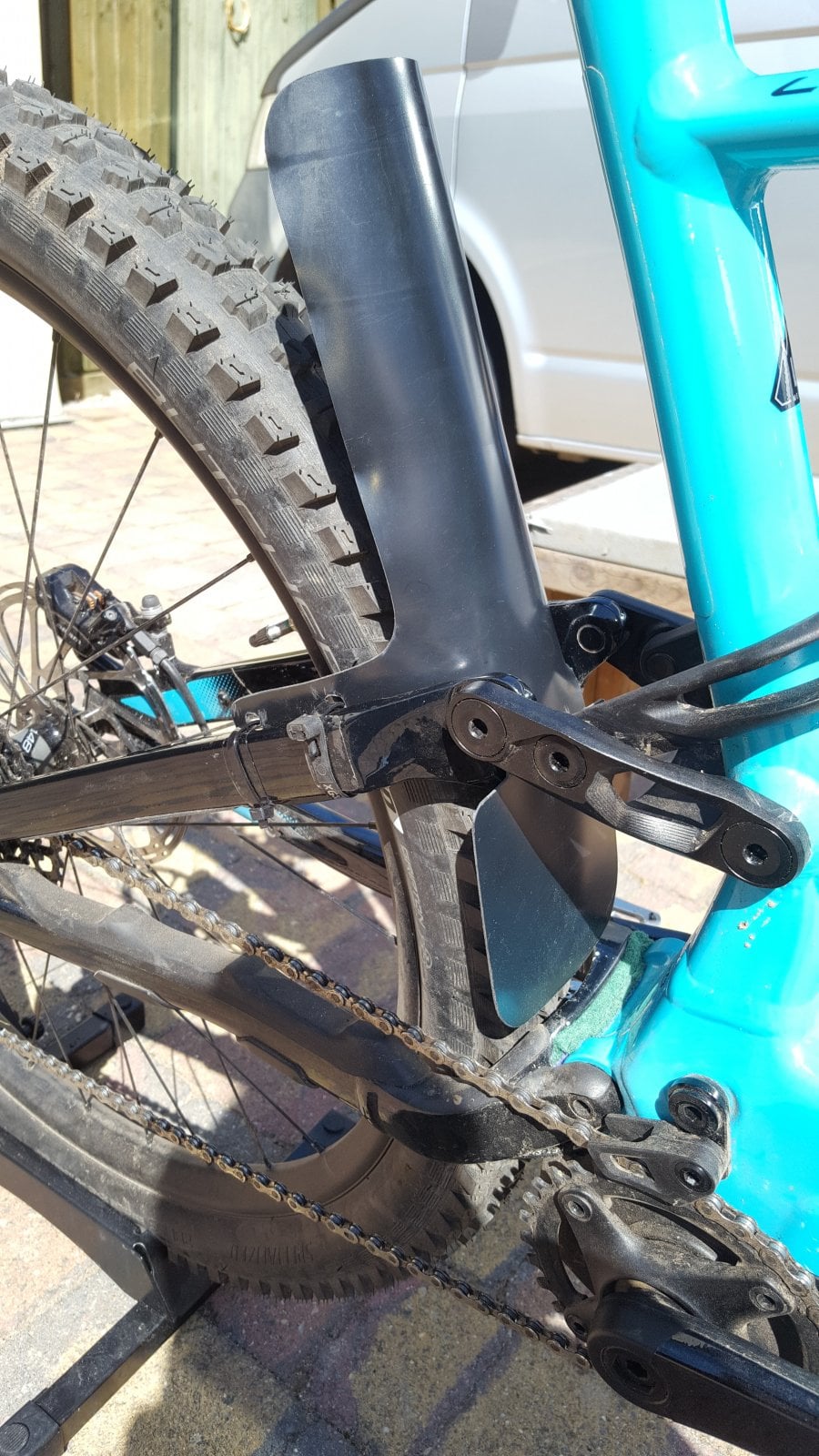

I have just fitted the SicoMtb Duo Guard to my Levo Carbon Comp. I would be keen to hear from anyone who has fitted this so far with regards to what tyres you are using. I have the 29x2.6 Eddy Current which rubs on the cable ties used for fitting across the chain stay. I have contacted SicoMtb to see if there if the Carbon Comp is affected like the S Works model which they mention on the website. It will be a shame if I have to return it.

I heard back from Simon at Sicomtb, you have to really push the lower guard on to make sure it is fitted properly. I have removed the cable ties and refitted and whilst there is not much clearance it is not rubbing. I will have to see what it’s like when things get muddy.
I really can’t fault the customer service though, they’ve been really helpful.

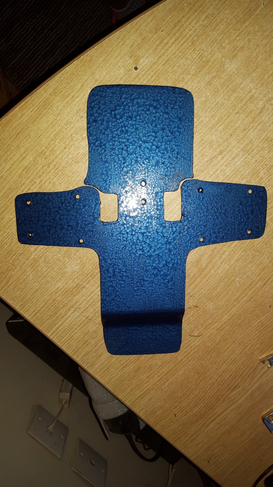

As an update on this project the mudguard performed really well right up to last week when it broke. On inspection a small section on each side of the chainstay tabs had become brittle. I kept the template so it takes only a few minutes to cut a new one from a £2 sheet of plasticard. I do wonder however whether polypropylene sheet would stand up the flexing better. The problem is I cannot find a supplier of 1mm polyethylene sheet that does not charge a minimum order value of £40 whereas I can get 3 or 4 plasticard sheets at £2 each with no surcharge.

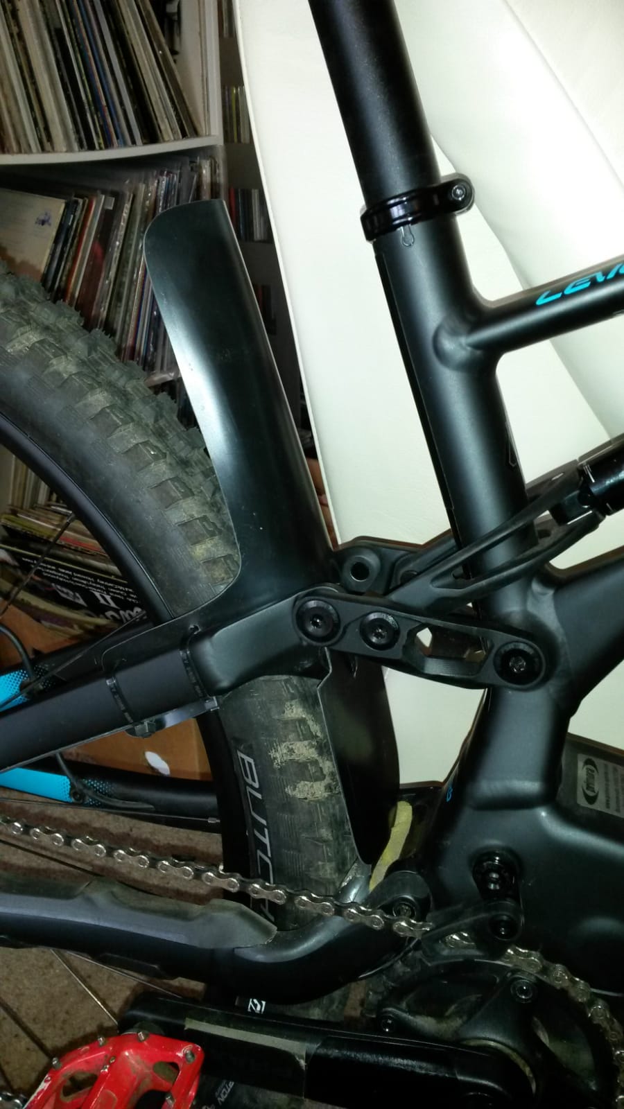

I have just fitted the Mudhugger FRX ( xl front mudguard) as a rear mudguard. It needed just a little cut off the front but other than that it has multiple marked but not drilled hole options for the cross member zip ties. The upper 2 were a perfect fit. The mudguard is a pretty close fit the tyre all along its length so I was sceptical whether it would work. Used it yesterday on my local forest trails and it worked absolutely fine. We have had a fair bit of rain so there were boggy sections and the forest floor was of course wet. The conditions are however sandy loam rather than clay/sticky mud. So in those conditions, which to be fair are my usual riding haunts around here it is fine. Whether it would survive more claggy mud without clogging up is debateable.
So I have ordered more plasticard and am making a stock of 4 of my DIY design mudguards. Each mudguard takes a bout 20 minutes to make. Total cost for the 4 will be £10 and if each lasts as long as the first one it will be 2 years before I need to make any more. Or I may just use them as changeouts for non local rides that are likely to be more muddy!

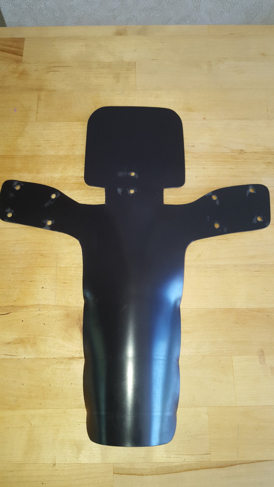

So this is my mk2 version ....same material and same template but I mafe a couple of changes which should improve resilience. Firstly I used a drill to radius each internal corner before cutting out and second I extended the thermoforming to include the part that zip ties to the crosd member ( behind it not between it and the tyre). Both should help avoid creating a stress point where the tabs bend round to zip tie to the seat stays. At c £2.50 per mudguard its an easy low cost fix.
