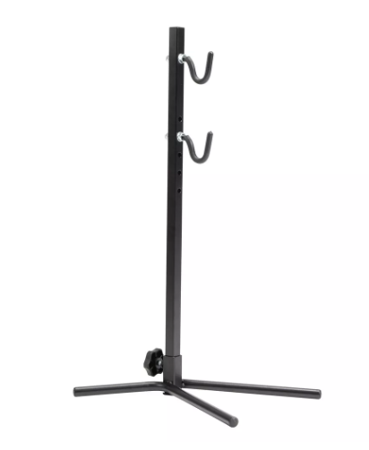

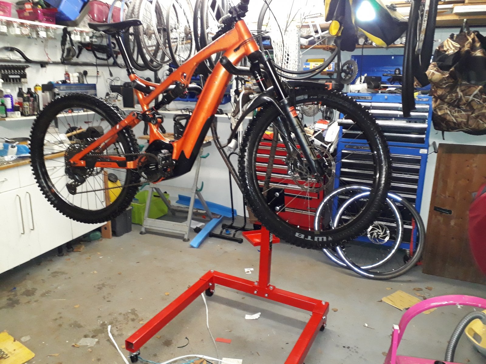

any one adapted a Park Tool bike stand to take a rs180, e bike , I feel the weight distribution to the front is to much for the seat post to take. On a sx800 lappiere i was able to fit the clamp to the top rail ,but on the 180 the gap between the stem post and shock mount is to small.
any ideas?
Rahr85
Sep 6, 2020
495
1,058
nottingham
I've had my bike up on the bike stand a couple of times but i'm really not happy having it hanging off of the seat post either. There's no alternative option in terms of mounting position. If i am working on the bike i either have it upside down on the floor or if just cleaning/chain lubing i'm using the decathlon stand to just prop up the rear.
Mr President
Sep 20, 2020
306
213
monmouth,wales
Can you make me one while you’re at it?!
I did wonder if there might be some interest. MOABS 2 is mostly in my head at the moment. I need to buy some specific tools to build it properly and also find a bit of time. If it works it could be a commercial product. I'll keep you posted.

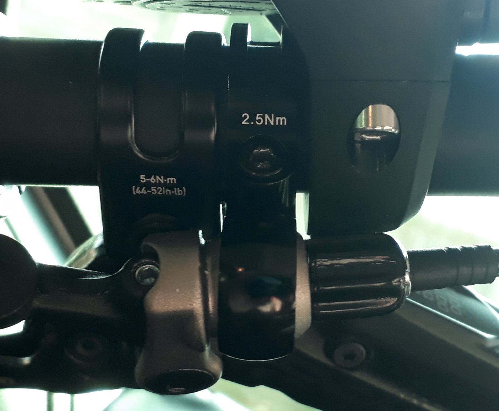

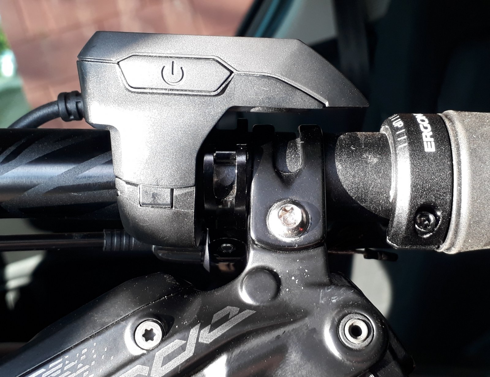

A small upgrade and a small change. Having cut my bars down to 760mm I then fitted new Ergon GA2 Fats, and having loosened the Purion, dropper lever, and brake levers, I then repositioned the dropper lever onto the inside of the brake lever. It now feels far better in that position.
EMTBSEAN
Feb 20, 2020
1,055
757
Sheffield
Any chance of a picture of that please, I like the sound of that but I’m having trouble visualising it ?
