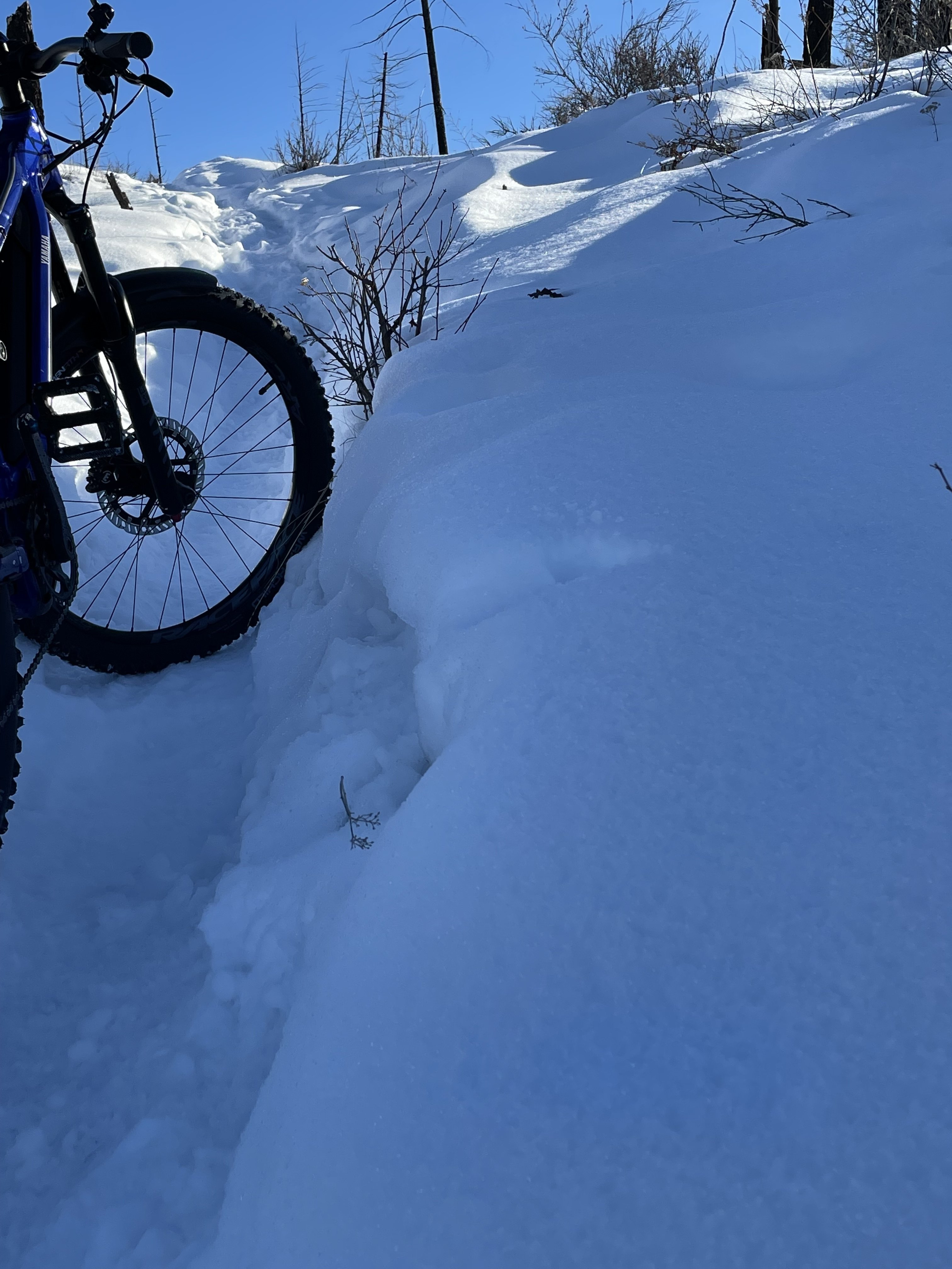

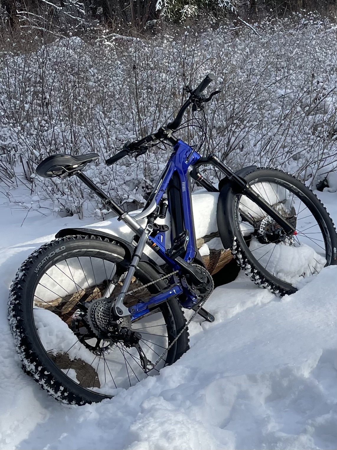

Gee you guys I guess your Winters are a lot different than here... 45NRTH 3.0 Studded Wrathchild's
