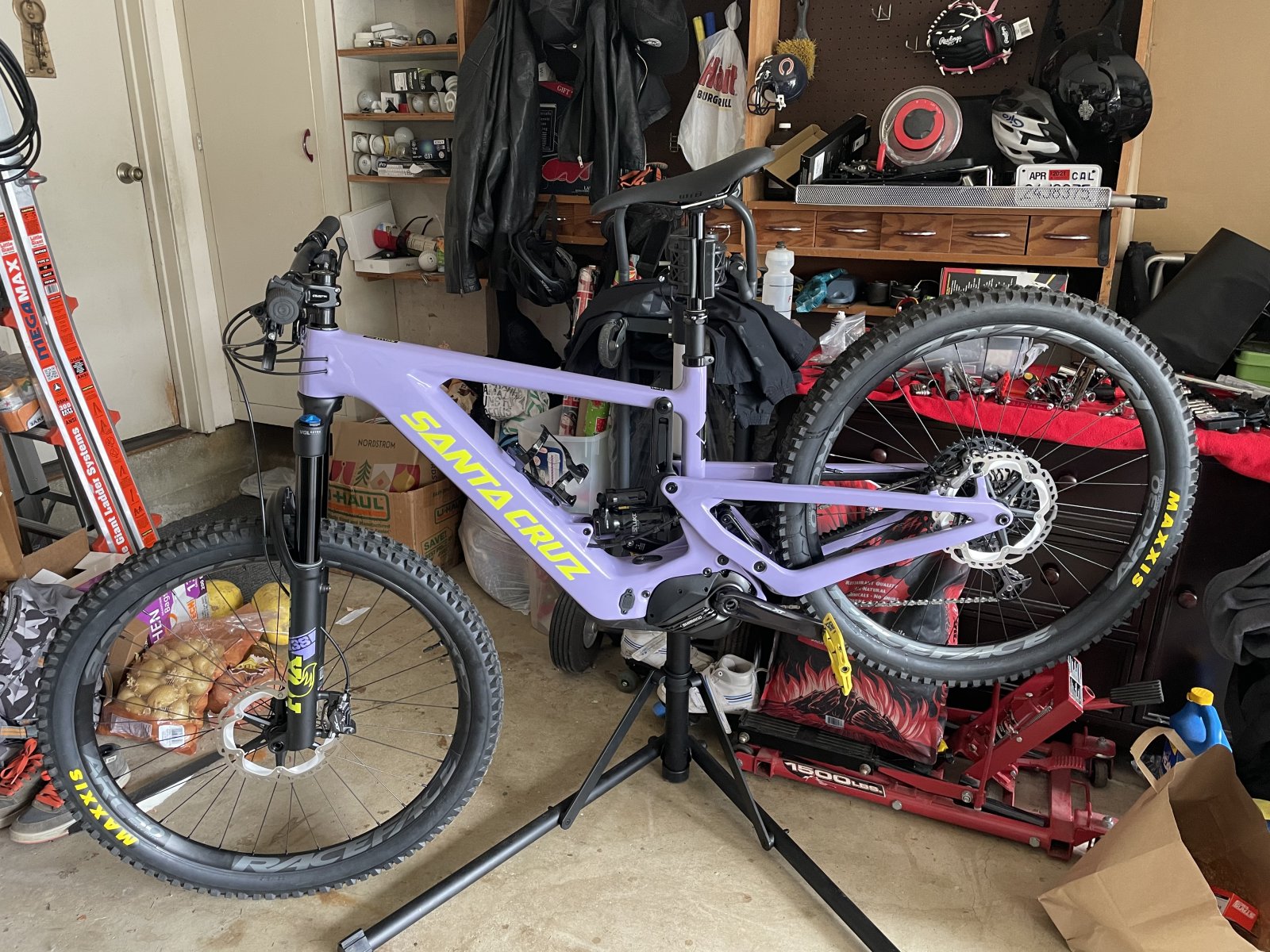

I just got my Bullit XT kit and was considering waiting on the new Gen 3 Levo myself. My wife has a 2020 Levo Comp and so I do have some comparisons. Off the bat the EP8 is very quiet going up and mine is very quiet going down (no noticeable knocking noise) so I’m very happy there as I’ve heard the rumblings from the net. Love the 170/170 front and back as it’s a very plush ride and very stable...I’m much faster going down now without even trying to be. Love how the EP8 is small motor and now very quiet opposed to the Levo having a large very Ebike looking motor. Levo’s are tanks comparatively at least in the Comp trim line. The Gen 3 Levo is step in the right direction Geo wise and I’m sure will be a fantastic bike, but the Santa Cruz is sex appeal and super light. You’ve had the Levo’s ....it’s time for something new and exciting and the Bullit will compliment your Gen 2 Levo very well. Just my 2c.

I just got my Bullit XT kit and was considering waiting on the new Gen 3 Levo myself. My wife has a 2020 Levo Comp and so I do have some comparisons. Off the bat the EP8 is very quiet going up and mine is very quiet going down (no noticeable knocking noise) so I’m very happy there as I’ve heard the rumblings from the net. Love the 170/170 front and back as it’s a very plush ride and very stable...I’m much faster going down now without even trying to be. Love how the EP8 is small motor and now very quiet opposed to the Levo having a large very Ebike looking motor. Levo’s are tanks comparatively at least in the Comp trim line. The Gen 3 Levo is step in the right direction Geo wise and I’m sure will be a fantastic bike, but the Santa Cruz is sex appeal and super light. You’ve had the Levo’s ....it’s time for something new and exciting and the Bullit will compliment your Gen 2 Levo very well. Just my 2c. View attachment 58158
lovely looking bike, congrats
