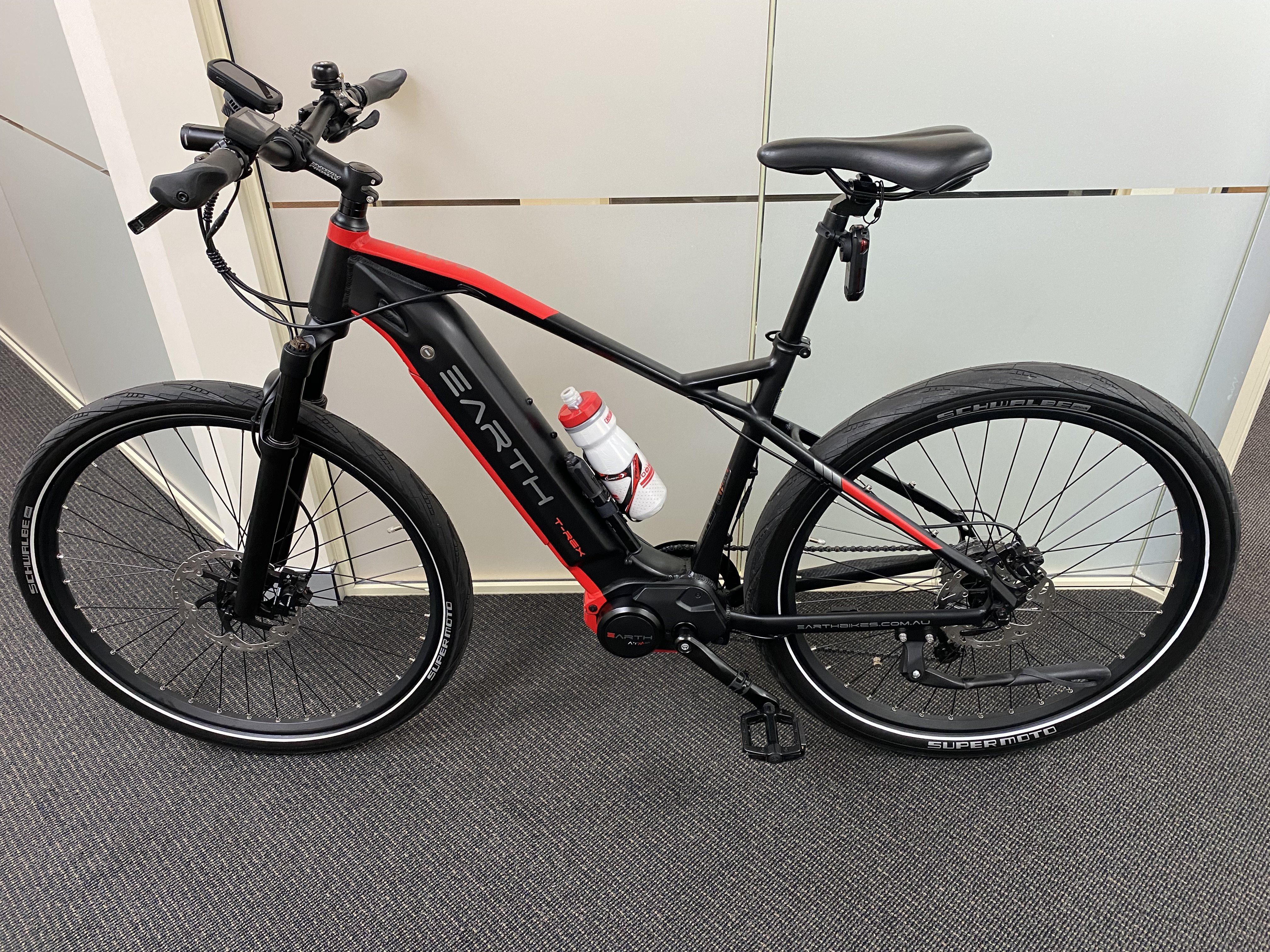

I have two e-bikes. One powered by an Ananda m100. This was derestricted by the dealer LBS at purchase and still covered by warranty. It tops out at 47klms/hr assisted, though I have pedalled beyond assistance to 55klms/hr. No issues after 16 months.
My other bike has the Bafang 60v m620 which is factory “derestricted” to 60 klms/hr with 2 year warranty. Again no issues after 12 months.
In summary, both are Chinese built motors that operate perfectly without issue derestricted.
I've just bought a bike with a ananda m100 and I'm looking into derestricting , I'm in Australia and we have 25 kmph speed limits what country are you in and does your speedo work properly after being derestricted
