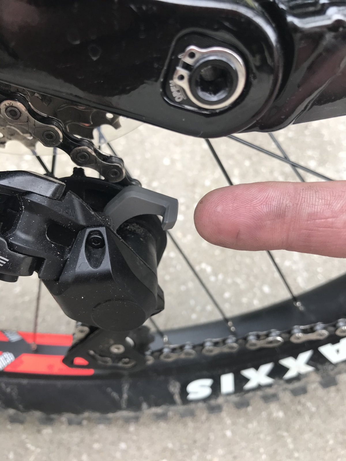

Hi. Saw this whilst I was putting on some chain lube, what is is and what does it do? What is open/closed, etc. what is the riding position?
Was applying some chain lube and saw that.

Yep, its a proper clutch, not just a device to hold the mech open while removing the wheel.
The clutch is a friction device that helps prevent the lower strand from bouncing up and down when traversing bumpy ground. The loop of chain that can develop can be big enough for the chain to come clean off the front ring. But disengage it when removing the wheel, it will be a lot easier.
Some people don't like that there is a slight increase in thumb pressure when shifting to larger rings. It is very slight, and they can always switch it off if they want, but some clutches are adjustable. Shimano only I think, (based upon my Shimano one being adjustable and my Sram one not) Happy to be corrected. :)

No need to turn it on. The chain guide and the narrow/wide chain ring isn't letting that chain go anywhere at all.
Definitely don't want to leave it on, it stops the chain growing by limiting the derailleur from extending. Don't down shift into the bigger cogs with it on as you will be fighting it.
I totally disagree. That's why the switch is made to prevent the chain from falling off or slapping .So keepit always on when riding.
It has not been developed without reason.

I might be wrong, but I thought as a general rule of thumb, you just leave it on. It stops the derailleur slapping back and forwards on it's spring. You only use it/turn it off/lock the derailleur forwards (depending on type) when you want to work on the chain/remove the wheel - so it's more a maintenance switch.
For some reason my last bike's derailleur didn't have a clutch, not sure if they ran out when they were assembling them, someone picked up the wrong one or if the guy in the bike shop swapped it out with another bike. Either way, at first it wasn't a problem.. Once I got faster, pretty much as soon as you started going over 30kph on anything gnarly downhill and it was chain off - every time. So changed to one with a clutch, problem solved. Yes, it does require a tiny bit more thumb pressure to change gear, but it's not like your thumb gets tired from it or you have to spend a few hours on the thumb machine at the gym every few days :)

I see you got loads of replies and yes it is a clutch to help keep the chain on when on bouncy rough terrain...importantly it is adjustable dependant on how much tension you want...

Keep Clutch on when riding. Off, when removing the wheel.
Great piece of kit. Saves you getting to the bottom of a quick rocky downhill and then cracking your nuts ( or crutch for the ladies) or gouging your shin/ankle on the peddle when attempting to pedal with no chain on ?.
