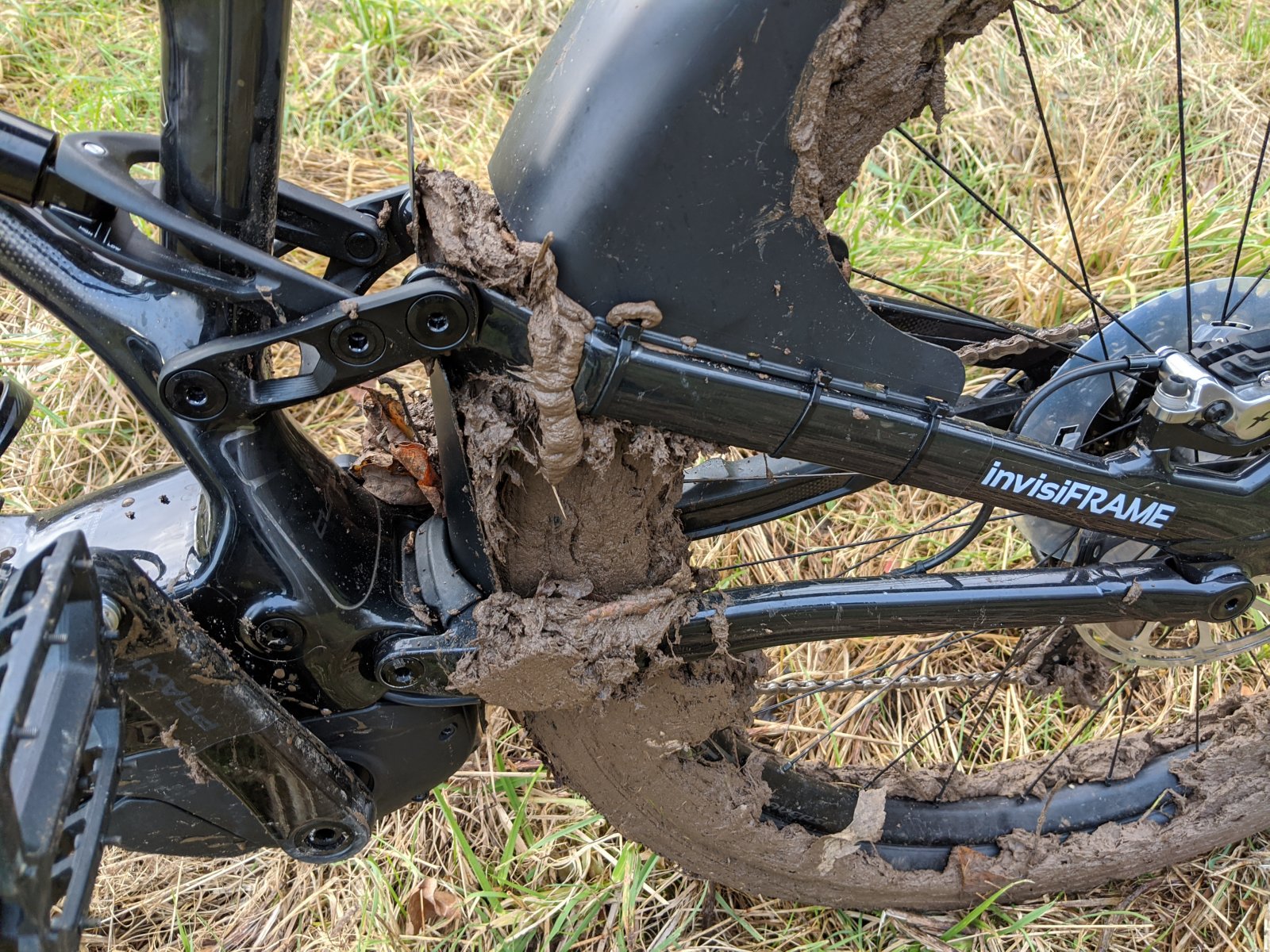

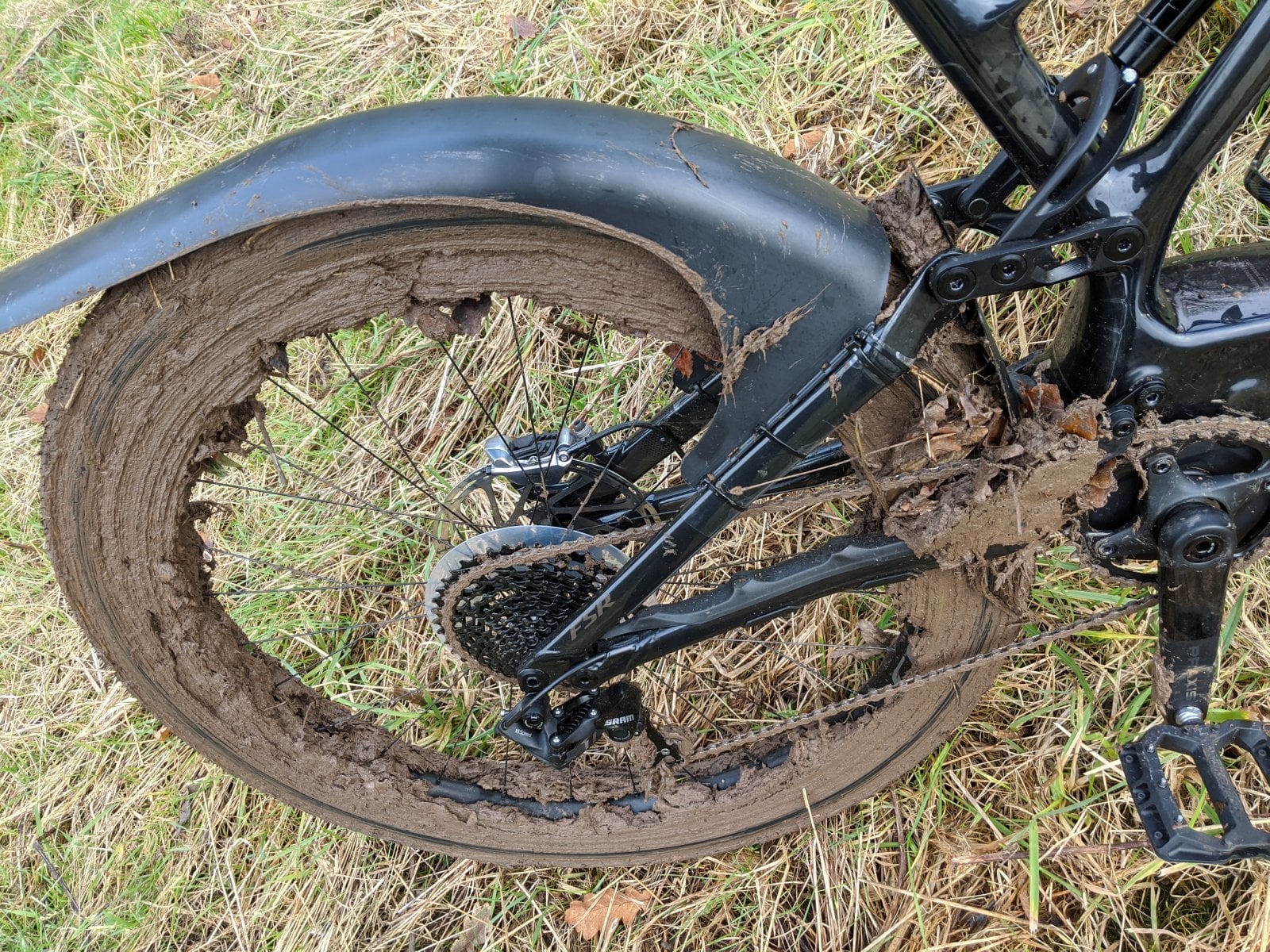

Not sure what the solution is for mud like this apart from trying to avoid it ?
The wheel was just spinning and losing traction.

The combi-guards look to have done the job. If you could have sunk a bit deeper, you should eventually have got some traction from your pedals ... :)

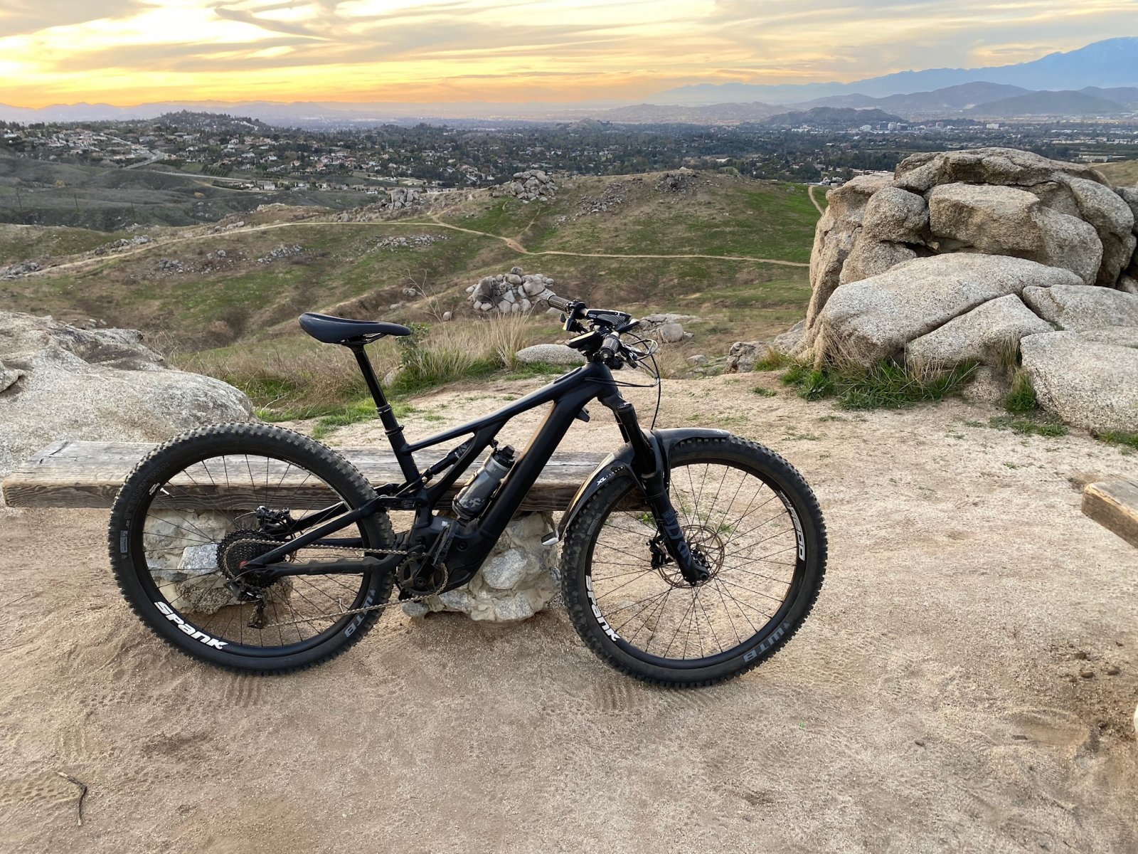

I turned my 2020 Levo Comp into a 29+ ebike...
WTB Vigilantes 29 x 2.8 front and back on i35 rims...not much clearance in the rear, had to take off my Will Hesch rear fender.
I won’t be able to test ride it till Saturday.

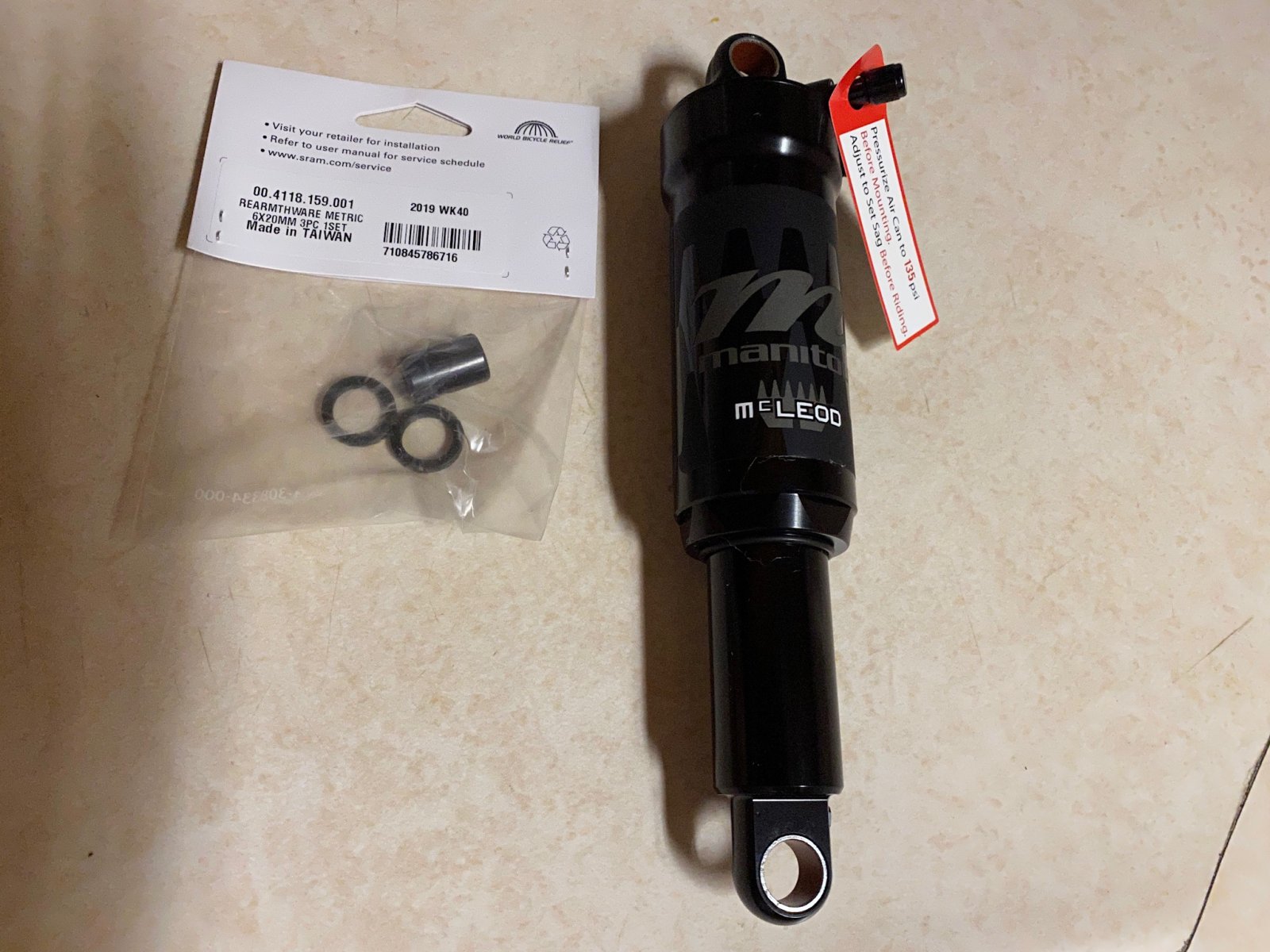

10 mile ride on 29+ front and rear (WTB Vigilanties 2.8 with Vittoria Air-Liners - 17 psi rear, 15 psi front - no rubbing but not much rear clearance).
First ride on Manitou Mcleod 210 x 55...only needed 180 psi for 30 percent sag (needed 230 psi in stock Deluxe Select)...it felt more plush...great shock for the money (paid $262 new).
Still want to increase the Lyrik to 160 mm...
Still want to try coil...

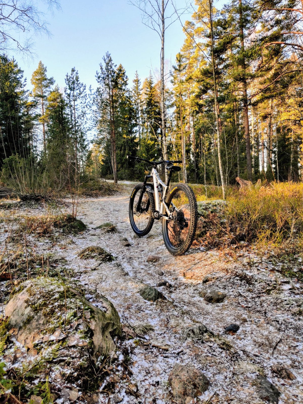

Fitted 160mm airshaft in lyrik on my 2020 comp.
Wonder what they have done with these select forks/shocks as they need much more airpressure than 2019 models.
Select fork:
Now 115psi
2019 90psi
Deluxe select+: 240psi
Deluxe:180psi
Rider weight 88kg.

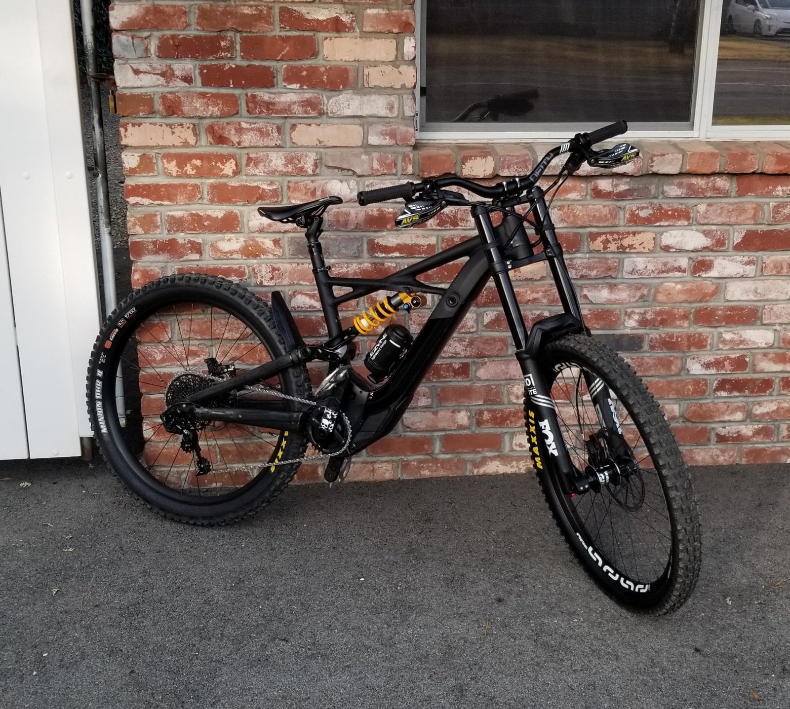

Had the LBS install on my 2020 Levo Comp:
RC2 damper and increased my Lyrik to 160 mm.
Cane Creek DB Coil IL 210 mm x 55 mm (non Levo version - mounted upside down) with 650 lb spring
Large Mud Hugger rear fender
Dang, have to wait till the weekend to get a good ride in...
