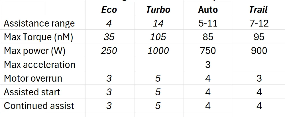

Confusing subject (to me anyway) as depending what article you read or which AI you ask, the answer is not consistent. Having come from a Bosch Gen4 where you generally have to change modes depending on situation, Auto feels the 'best' 85nm/750W for 90% of my riding and trail 95nm/900W for the techie climbs. But eco 35nm/250W still feels OK.
Please post your configs and a short explanation as to why those settings work for you.

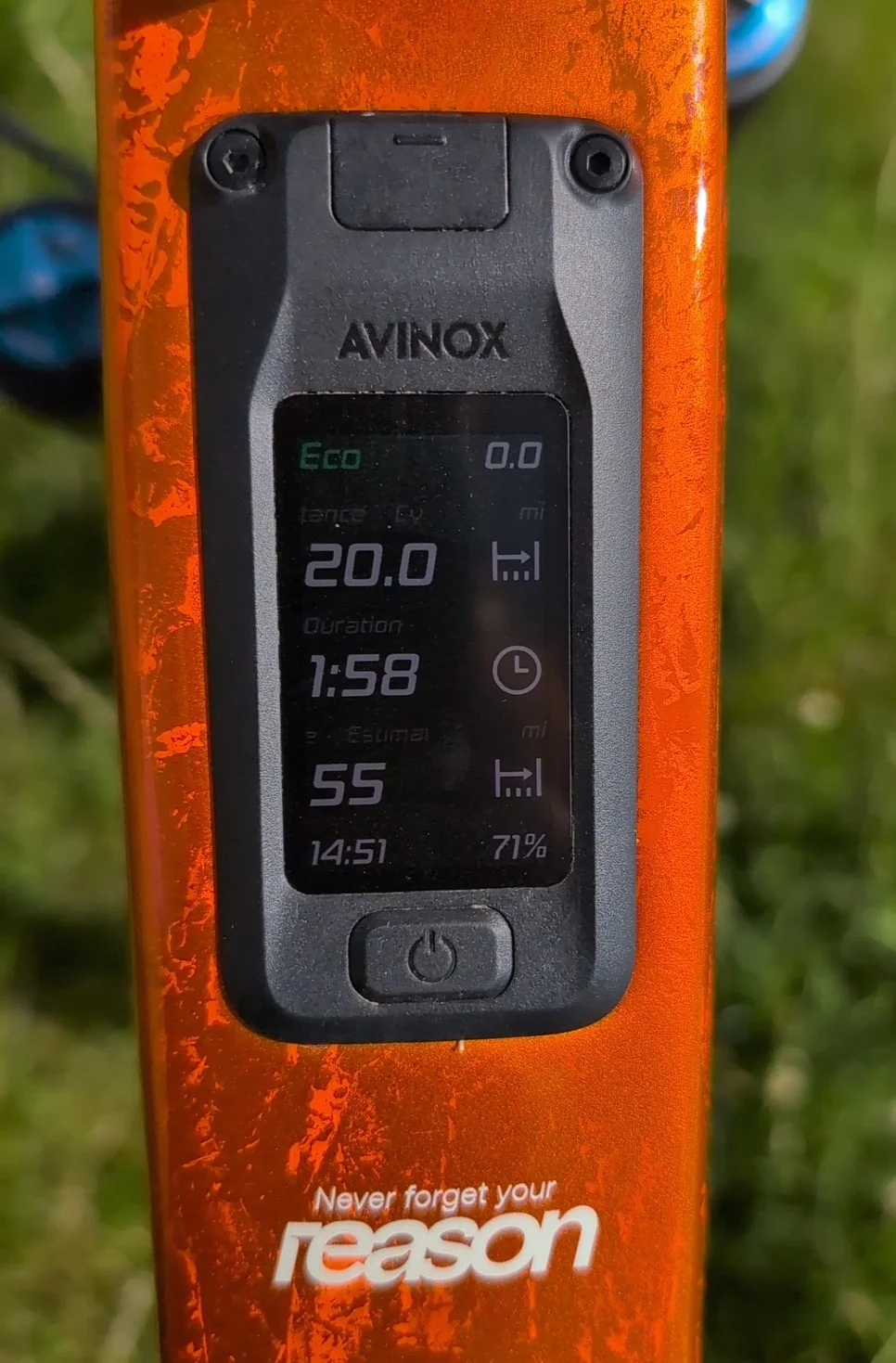

I use a mix of Eco and a detuned Auto for hillier bits. Then when heading home and I know I have a bit of battery left I use Trail and Turbo for giggles. Did almost 50 miles yesterday and the bike reckoned it could have done another 25. At 30 miles the estimated range was 47.
Please post your setting (nm/W) for comparison.
So my Auto settings are:
Assistance 4-6
Torque 85Nm
Power 750W
Trail I have at 105Nm and 1000W and Turbo is full power. I just wanted all the modes to feel different and they didn't out of the box.

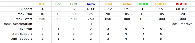

I think it's a bit confusing too. I made this to visualize the differences in modes, and to better tune modes so that the 4 selected modes compliment eachother. Bosch CX Riding Mode Explorer . It is based off the dyno results done here: https://www.velomotion.net/2025/10/Bosch-e-bike-support-test/
