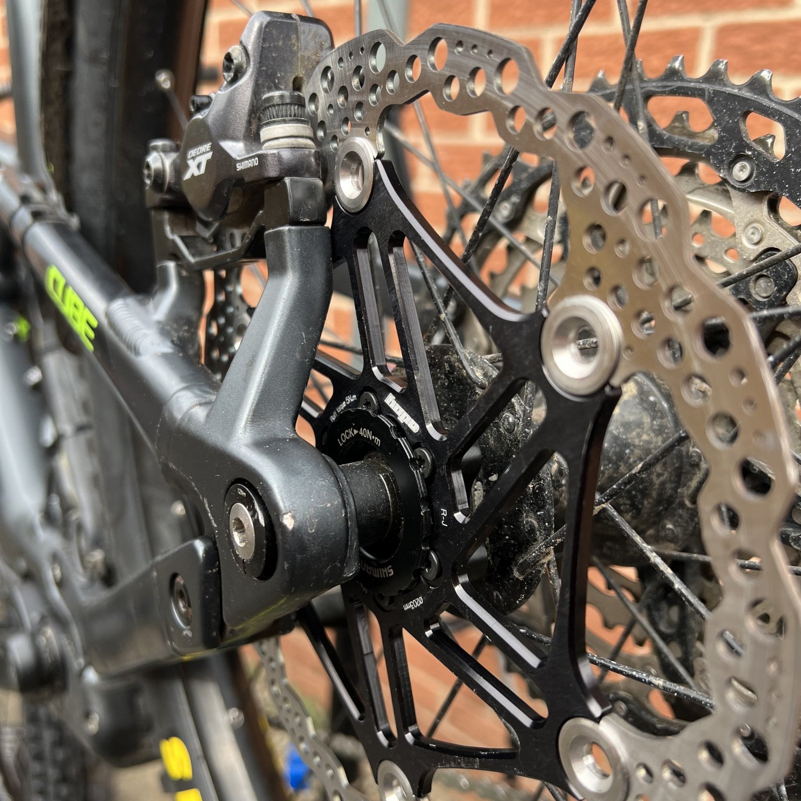

My standard rotors were below replacement thickness and I was going to go ice-tech as I had them on my last bike, but heard a lot of horror stories about them
I decided, against the advice of most forums/reddit, to get a pair of 203 hope floating rotors, and some shimano centerlock to 6 bolt adapters
You have to file the edges of the adaptors down a bit to fit flat agains the billet machined hope rotors, but it only took 5 minutes to do.

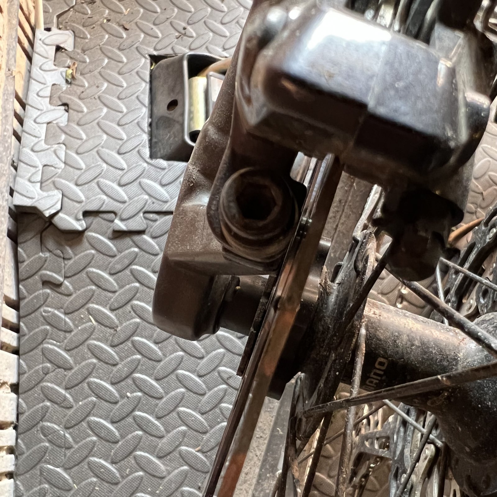

The clearance between the XT caliper on the rear and the 203mm hope rotor pressed studs is very very very close and you either have to get the caliper alignment perfect or file a touch off the caliper. Mine are fine after alignment.
Night and day difference, they handle heat a ton better and they're a lot thicker which gives a great lever feel.
I'm not a light guy but I can drag a brake on long downhills now without melting the rotor and they offer more than enough stopping power to put me over the bars. So I'm properly h appy

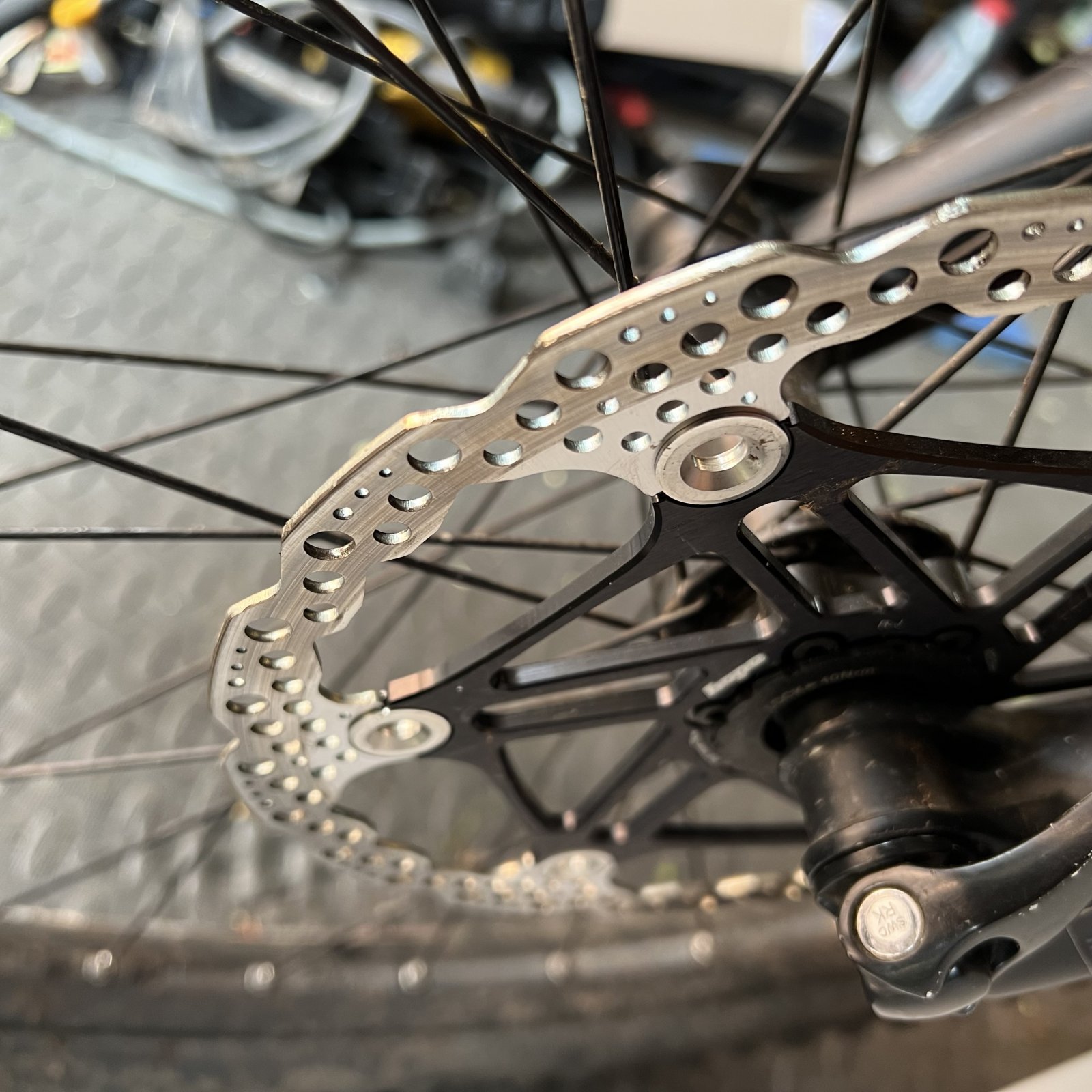

It might be the pic angle, but it looks like theres a lot of meat on the inner edge of the disc friction surface that isn't showing pad scuff?
I noticed that when I added the pic - that pic was straight after fitting the rotors and literally doing a few wheel spins for alignment and stopping with the bike on a stand
They're looking better now they've started to wear in, though I didn't change the pads and maybe should have :rolleyes:

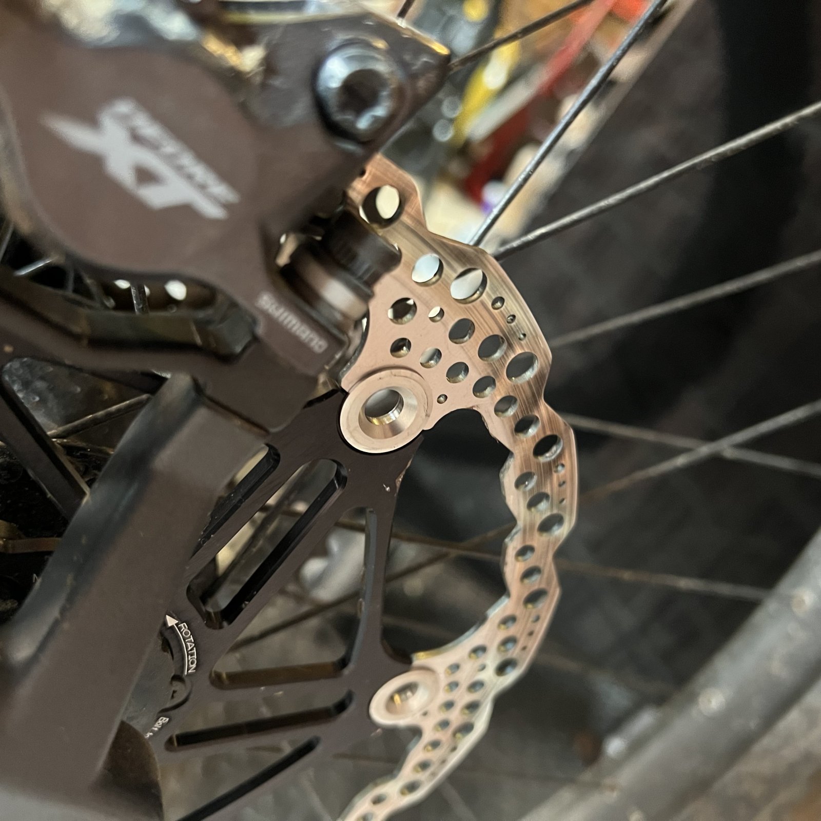

You can see the "plenty" of clearance here

Ah yeah thats looking a lot better. Still, does seem to be a bit of untouched disc left though - mine literally goes from outside edge to inside edge. Maybe Shimano pads aren't as 'deep' as Maguras 🤔
Yeah thats tight for sure!
Perhaps - it's the same area that was covered on the shimano rotors. I think the hope calipers and maguras are a bit bigger though tbh.
