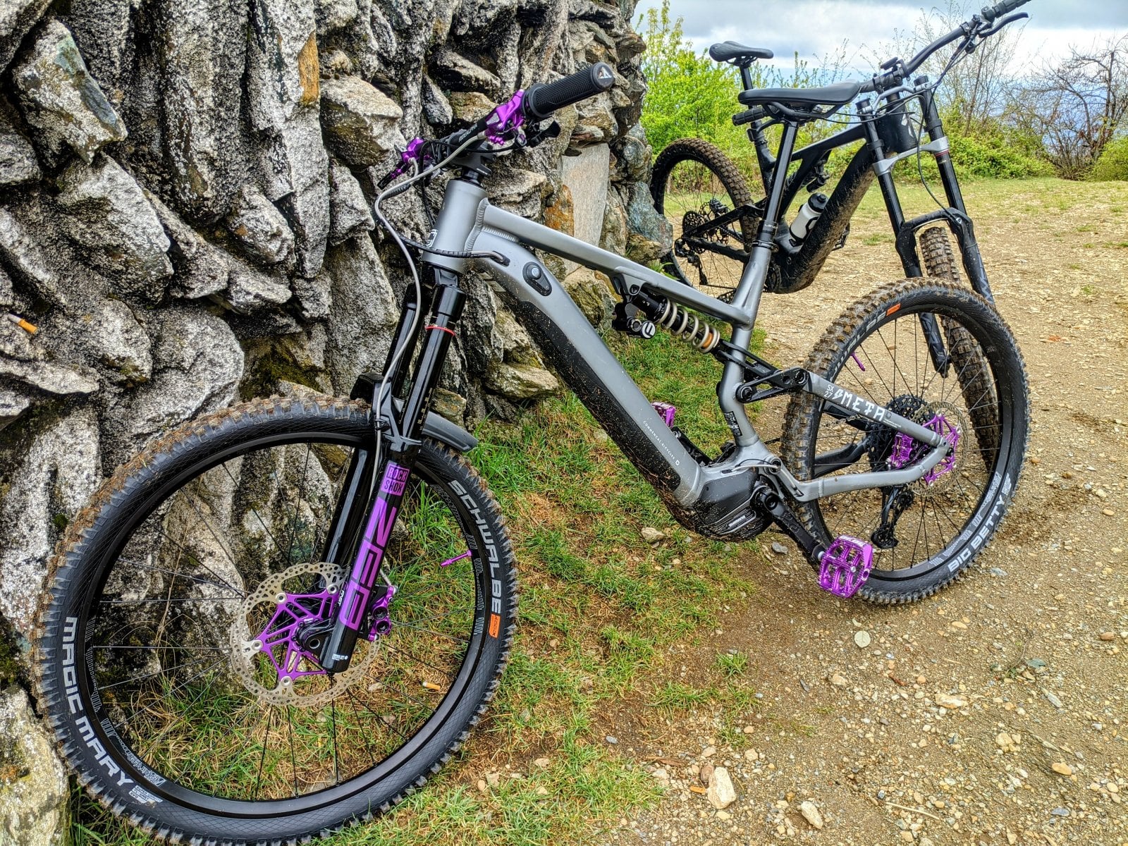

I've done a few little things to mine so far but nothing major. The biggest thing I want to do still is install the drop in fork upgrade that people say is the shit.
But so far I've changed the bars, grips, pedals, added a saddlebag, tube strap, fidlock bottle, Granite in bike tools for the stem and bar ends and changed the cranks to Shimano ones as well as added crank boots... oh yeah and a seat. Just the small things to make the bike feel like my own.

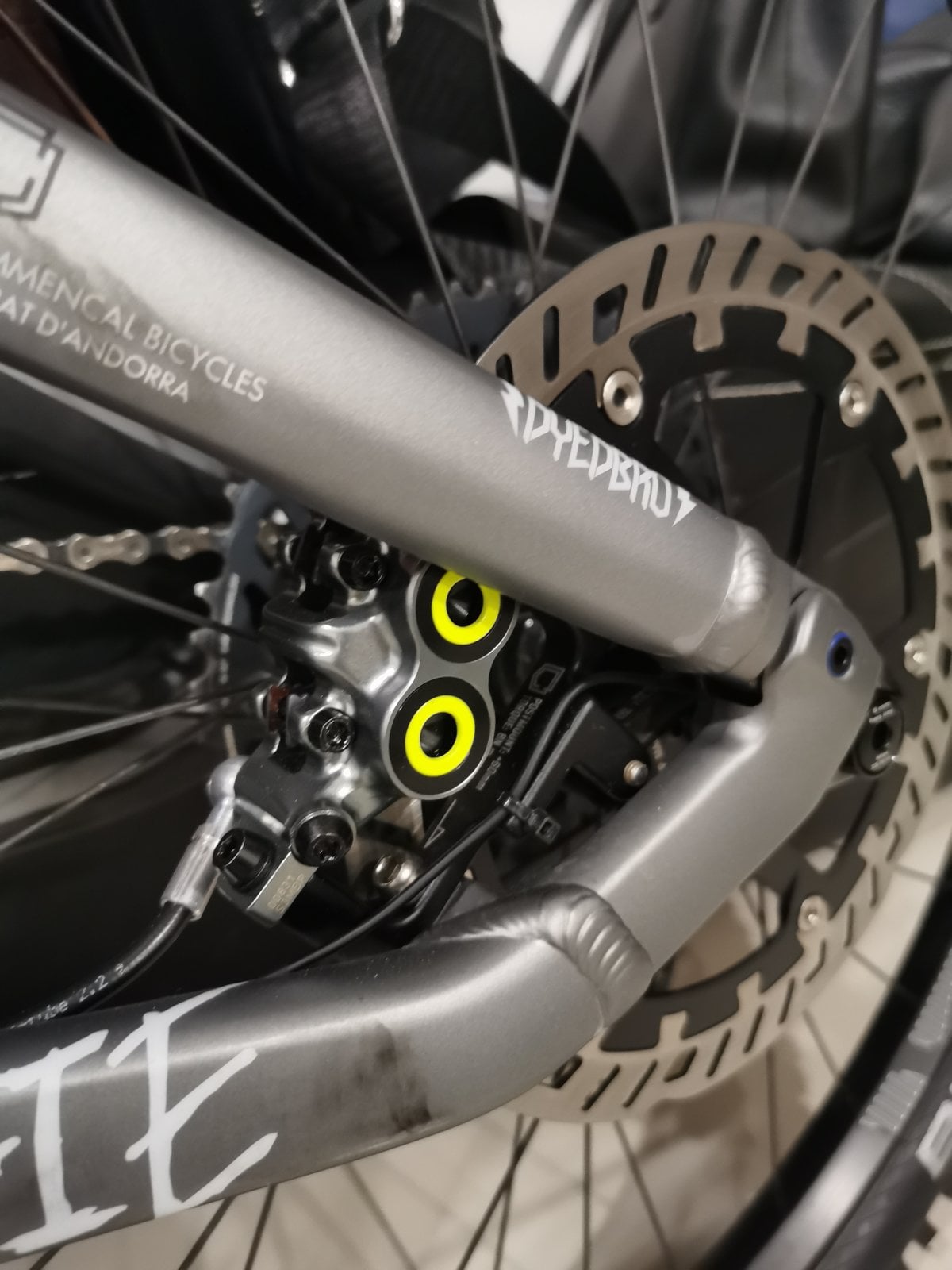

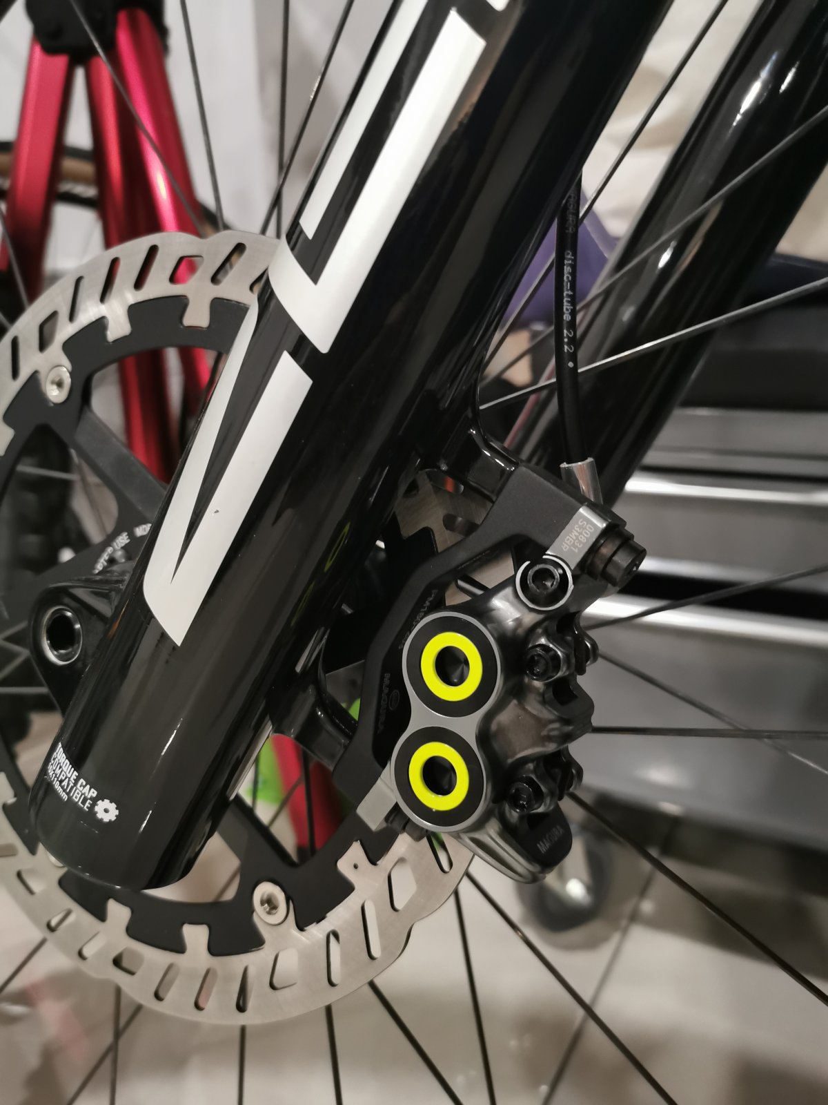

Swapped out the Code R brake set to Magura MT7 Pro with MDRP 220 rotors front and rear this past week and just started to bed them in. Crank arms have been replaced with Shimano XT 165mm's. Other items such as Burgtec carbon handlebar and others are enroute! Zeb decals will be replaced to compliment Magura's neon yellow.
