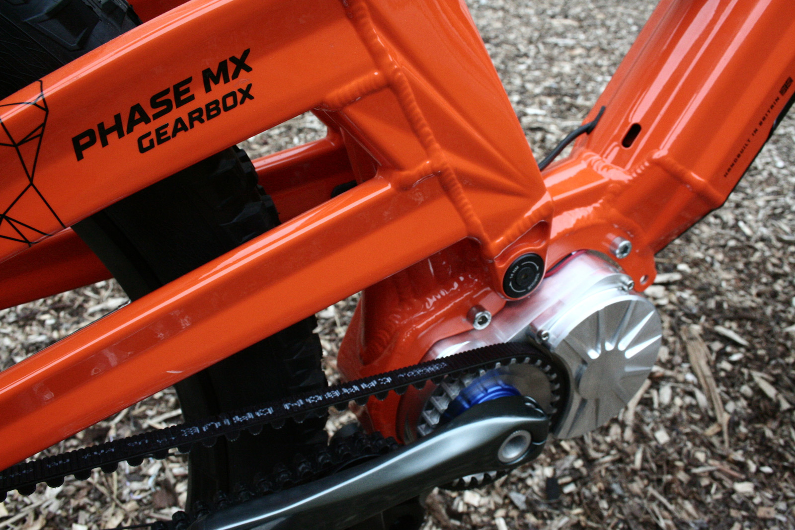

Intra-drive are trying to do this, but to get the space they need they have bulged out in front of the chainring which restricts its size AND they need some space between the mounts which isn't always available.
Its not that different as far as I can see? In fact, it could be even less bulky than the shimano EP8 that it replaced?!
Intra Drive (using Shimano Bolt Pattern):
Original Shimano EP8:

EDIT - I see what you mean, its a bit lot wider compared to EP8.
I do think though that its impressive they've managed to fit an entire MGU into the space / bolt pattern originally intended for an EP8.
orange-phase-mx-with-intradrive-8speed-powertain-ebike-motor-gearbox-drive-side-view.jpg
Yes, it's definitely impressive. But this side bulge and their talk of needing space between the mounting holes which isn't available on some frames, hints at the difficulty that this "standard" imposed on them.

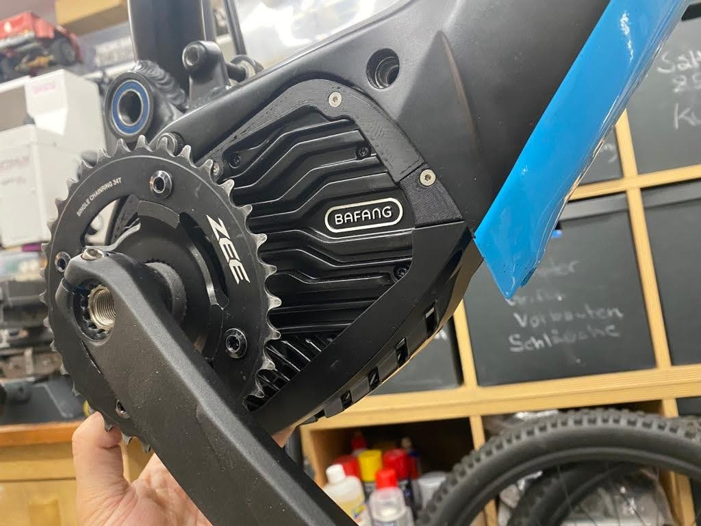

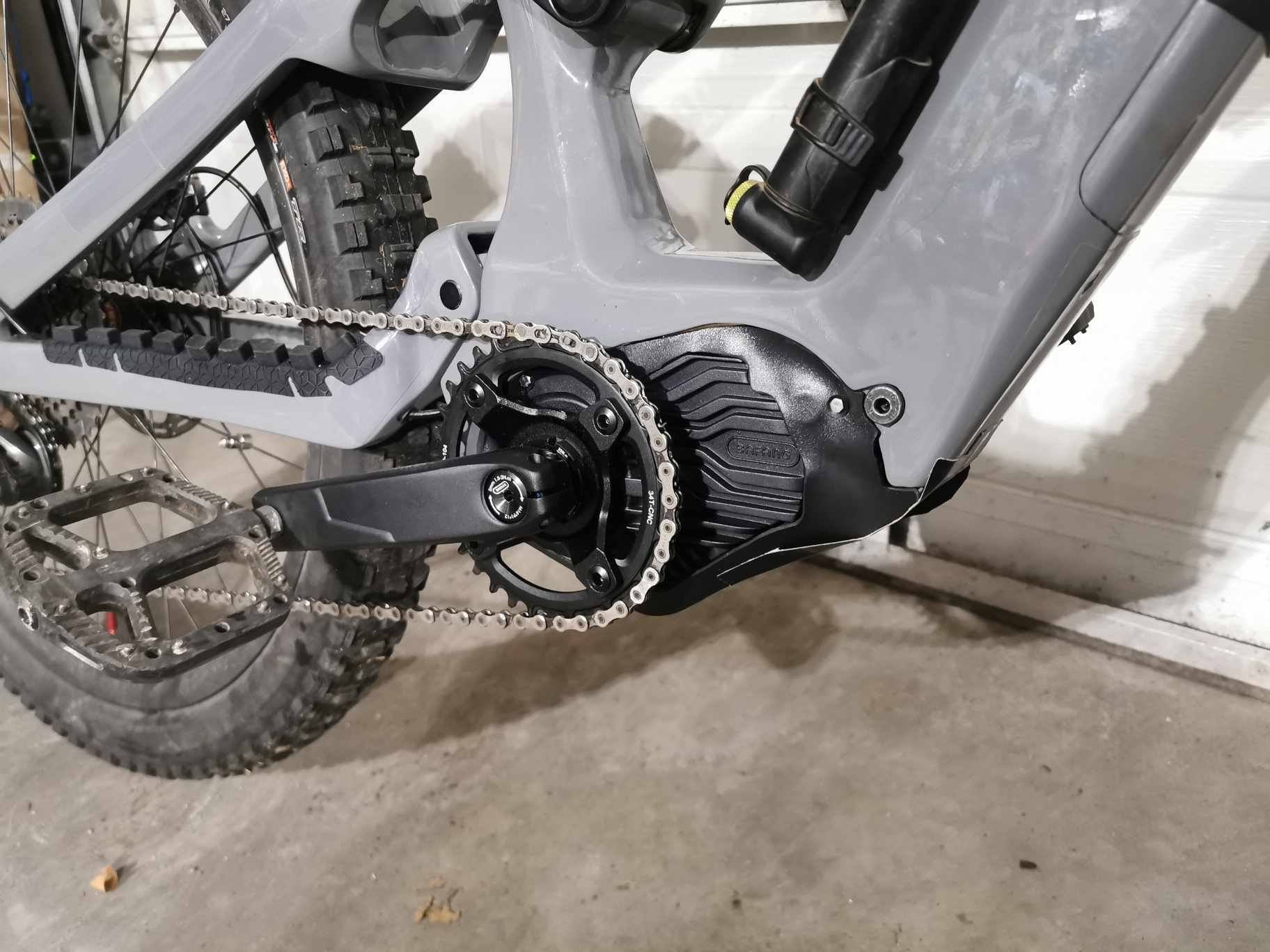

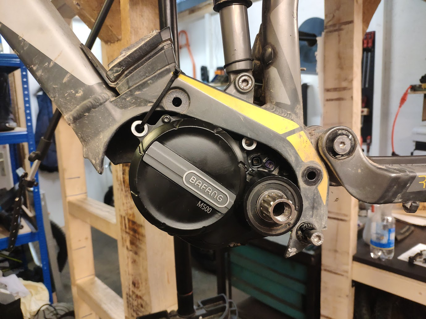

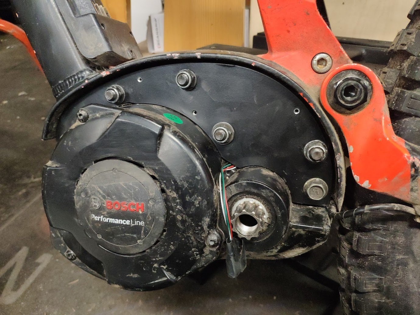

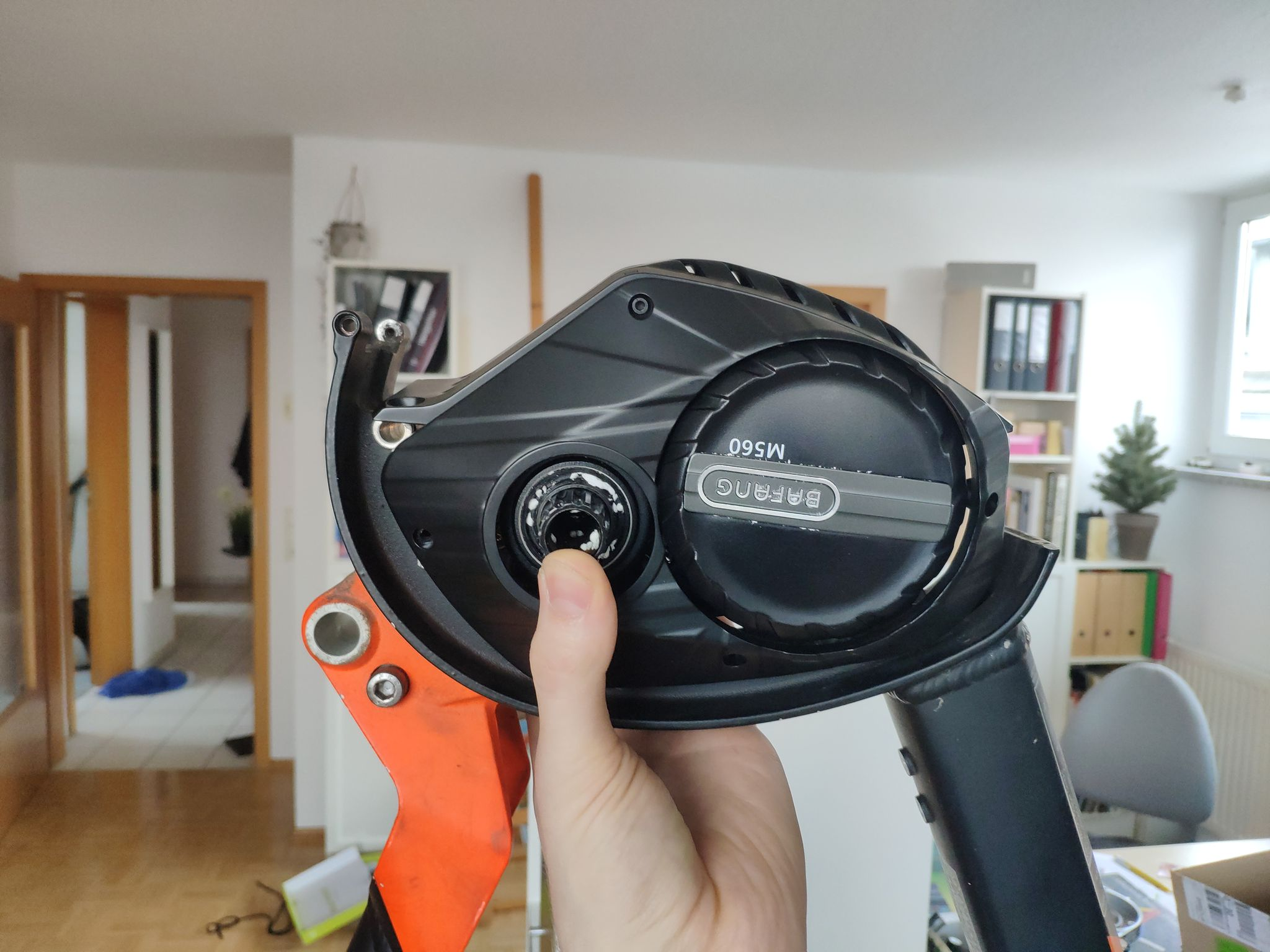

Hey Rob, I do similar stuff:
Bosch Generation 2/3 frame to Bafang Ultra M620 motor (available):
- photos.app.goo.gl/PDb7xz4Mrpf3xrYR7
Shimano E6100/E7000/E8000/EP8 frame to Bafang M500/M600/M510/M560 motor (available):
- photos.app.goo.gl/DbCt7XYLLx23TqqR7
- Teaser for Shimano to Bafang M600 conversion 🤫
Bafang M620 frame to Bafang M500/M600/M510/M560 motor (available):
- photos.app.goo.gl/51LiUZA7fEoTbWLd6
- Conversion - Installing M500/M600 Motors in M620 Frame
Bosch Generation 2/3 frame to Bafang M500/M600/M510/M560 motor (planned):
Yamaha PW/PW-SE/PW-ST/PW-TE/PW-CE/PW-X frame to Bafang M500/M600/M510/M560 motor (planned):
Yes I do use 3D-printing for my kits, but thats the only way to costefficiently realize them. The ultimate goal is to have them professionally made, some day, but to get started its necessary to rely on 3D-printing as temporary solution :) I'm on my own and this is not a business, that be accomplished by myself. I do have a lot more plans and ideas, but for now I need to go step by step.
Cheers, Tomblarom
