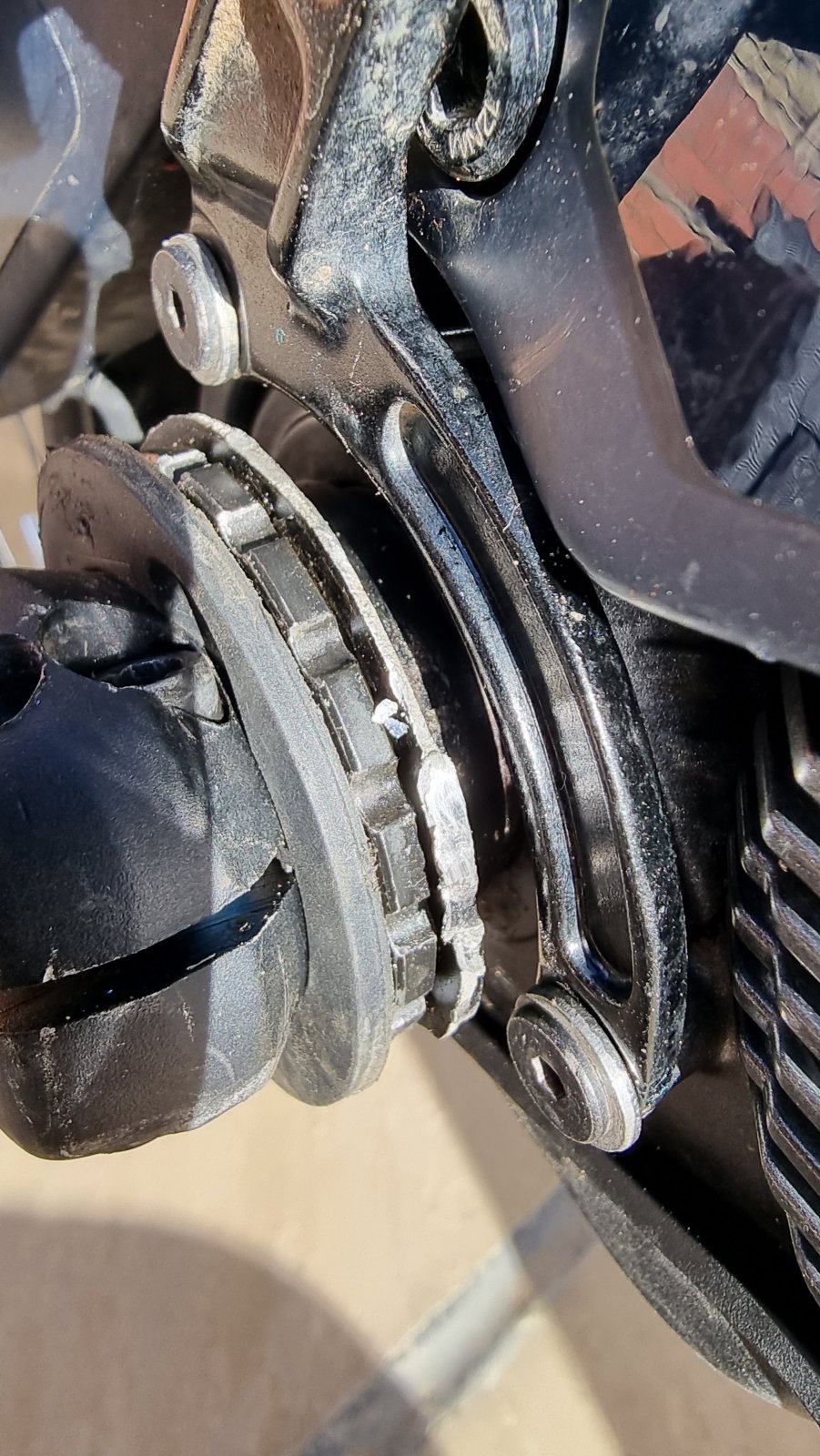

View attachment 83170 View attachment 83171
I had my left side crank come loose this morning on my Rise. It looks to be updated, i.e. without the seal and loctite applied.
Best to watch out for it. Anyone else had this issue on a recently delivered Rise?
This is a well known problem (search the threads), mine fell off four times before I found the solution:
apply loctite medium grip to bolts and end cap,
do not use the seal, tighten the end cap to 3-4 nM or see below
tighten bolts to 14nM carefully as the bolts are quite soft alloy
I also replaced the fixing cap with an aluminium one from Amazon and tightened to 3-4Nm.
I then had no further problems.
Orbea are replacing carbon e13 with the Shimano Steps so it might be that you are due a warranty replacement.
If not I would purchase them anyhow and retro fit them to your bike asap.

The issue is because a L/H HTII Crank arm was designed to preload HTII BB bearings AND as, such they sit snug to the bearing cap.
Using the same crank fixture design on an axle where the crank arms do not load against anything (ie. have a gap). Means every time the crank arm flexes it moves microscopically on the axle/splines. And it "walks" off the axle. Either loosening the preload cap as it does or if its plastic causing the threads to fail.
The cheap Alu preload end cap fix works on Shimano cranks for two reasons.
Firstly the threads, are stronger so it won't strip out so easily under load. And secondly the Chinese Alu preload caps are slightly bigger in diameter than shimanos so the crank arm actually grips the edge of them locking them in place when the crank arm pinch bolts are torqued.
The end cap can also safely be tightened a fair bit past the specified torque.
I found this issue and came up with the solution almost 4 years ago with the E8000 and then E7000. My first E8000 threw both its cranks really early on (back in 2017?)
Pretty sure I documented it in this forum around 3 or 4 years back. Shimano's design hasn't changed in that time. (other than slight mismatch in sizing and cosmetics for EP8 pedants)
