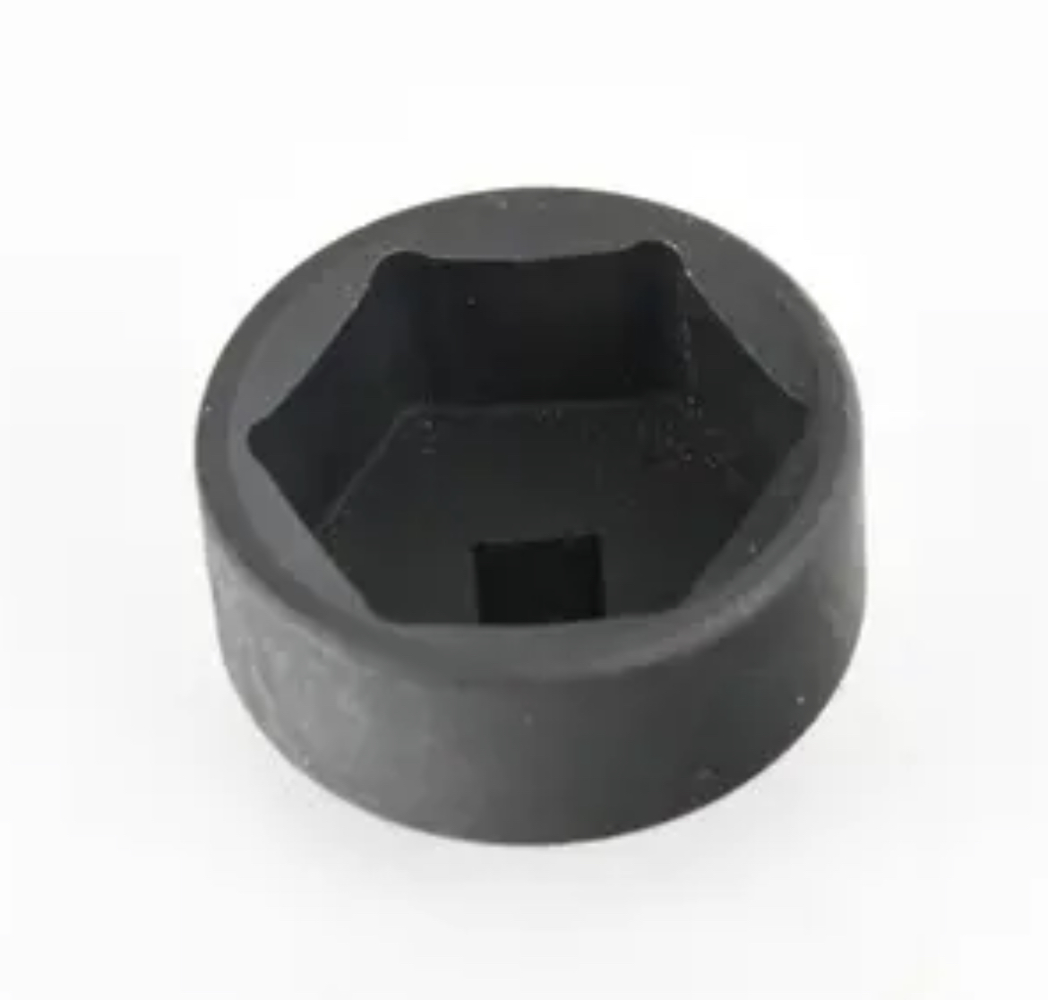

For anyone that gets the Park tool and needs an easy way to torque the ring. This 36mm socket with a 3/8 drive works very well (intended for oil filter housings on German cars).
https://www.ecstuning.com/b-bav-aut...ap-tool-36mm-bavarian-autosport/b8800020~bav/
You can get them on Amazon as well.
