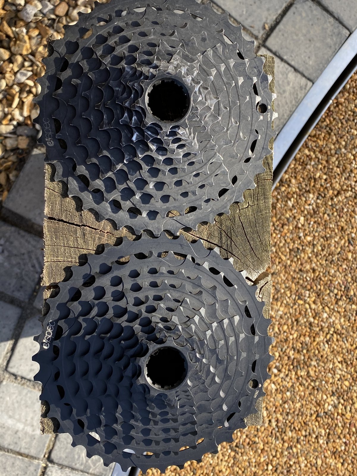

E13 told me I had the latest cassette too, but sent me a new one. Mine just jumps in 10th and 11th gears (2 smallest cogs), on the odd occasions 11th gear is selected.
sent bike back to YT yesterday, so I’ll see what they come up with.
Yes mine behaves the same, I have one on a trek farley and it’s faultless !

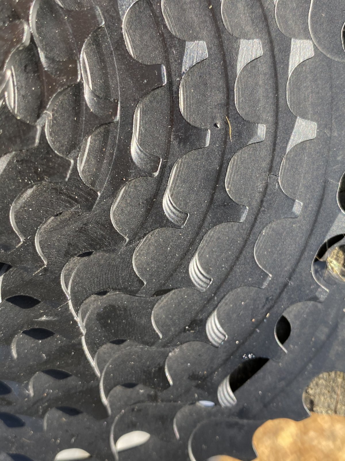

the replacement has more defined machining on the ramps
