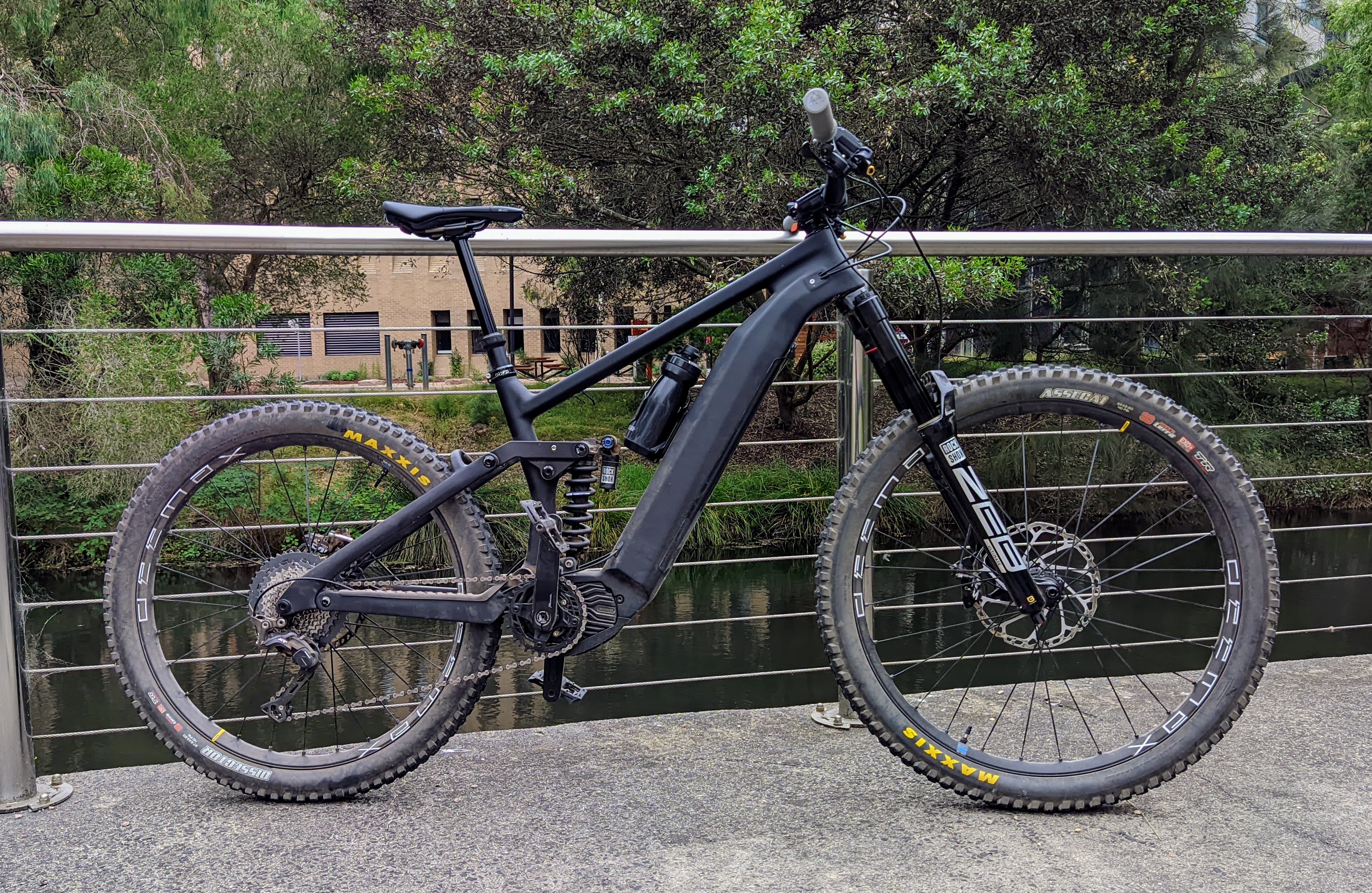

I've ordered a frame. Build will be:
Rockshox Zeb Ultimate 29 A2 (2023 model, with Charger 3)
Rockshox Super Deluxe Ultimate Coil (2023 model, with HBO adjust)
Mavic e-Deemax wheels (S30 29 front, S35 27.5 rear)
Maxxis Assector (Assegai 2.6F, Dissector 2.6R)
Rimpact Pro insert in the rear tyre
PNW Loam Dropper
Raceface bars & stem
XT 11 speed with XTR shifter & 11-46 cassette
Saint brakes (old model from previous bike)
Deity compound pedals (also old)
Considering spraying it a different colour before assembly, which may be delayed by shock. If that's gonna take too long, will consider CC Kitsuma coil.

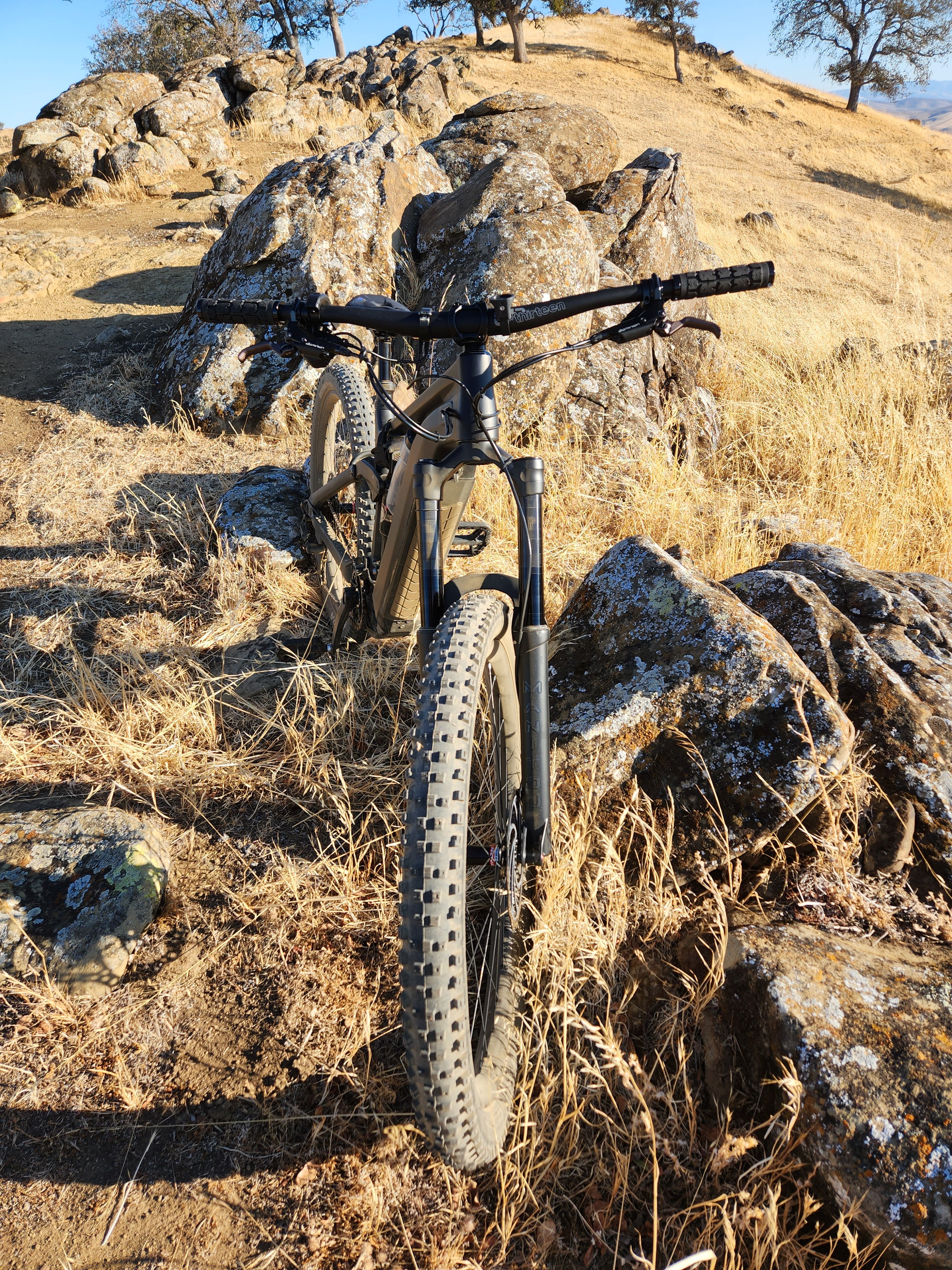

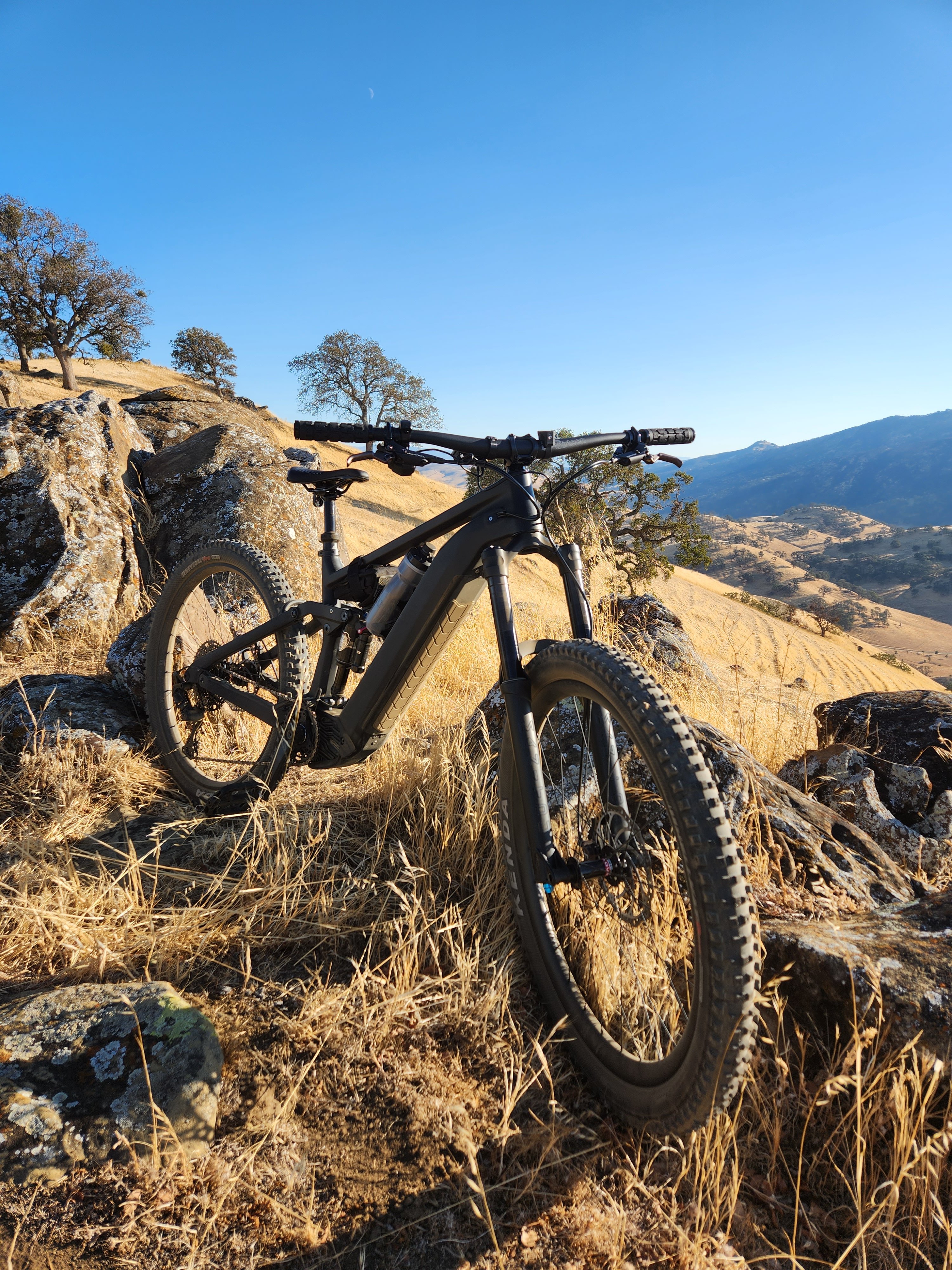

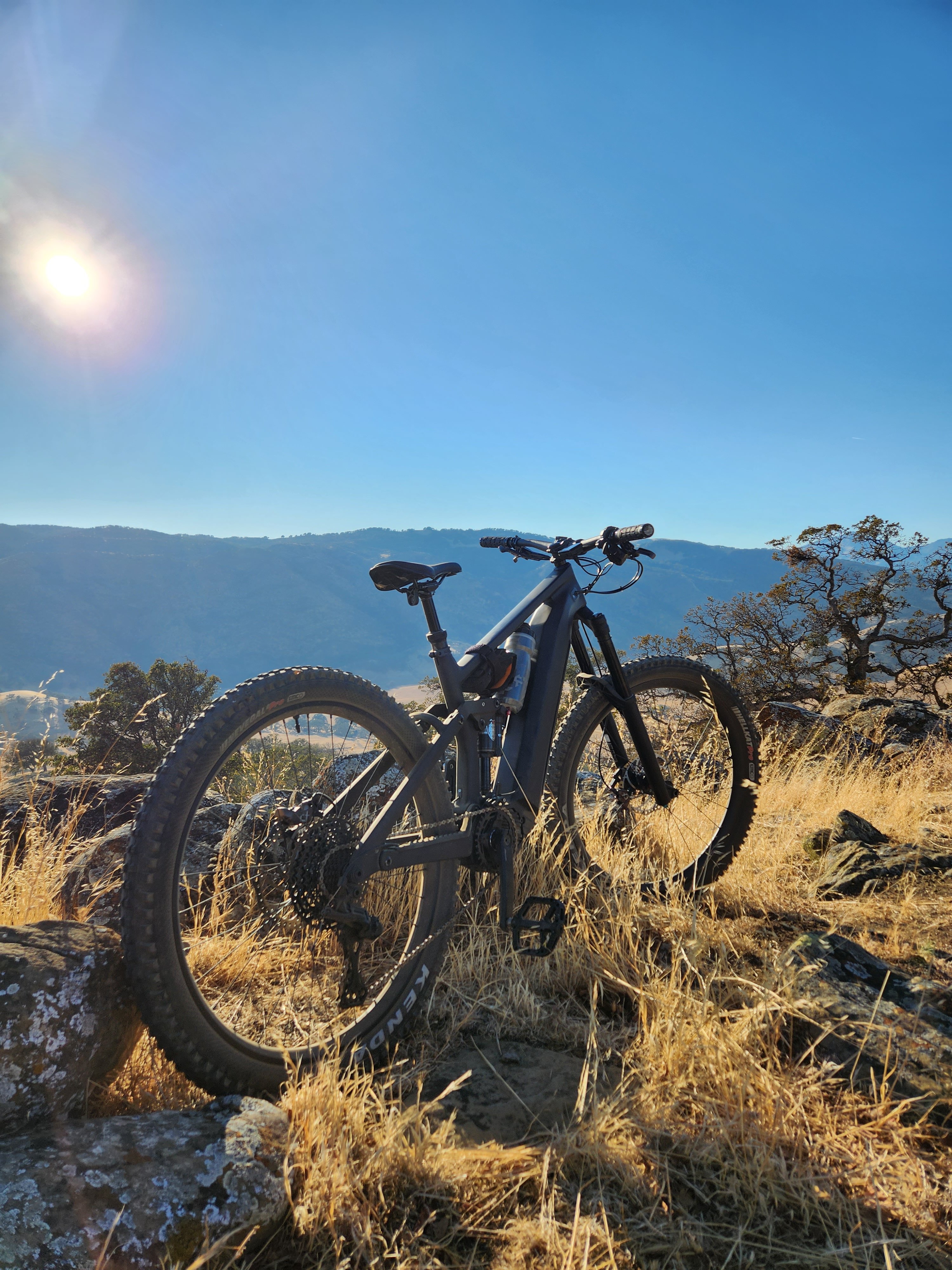

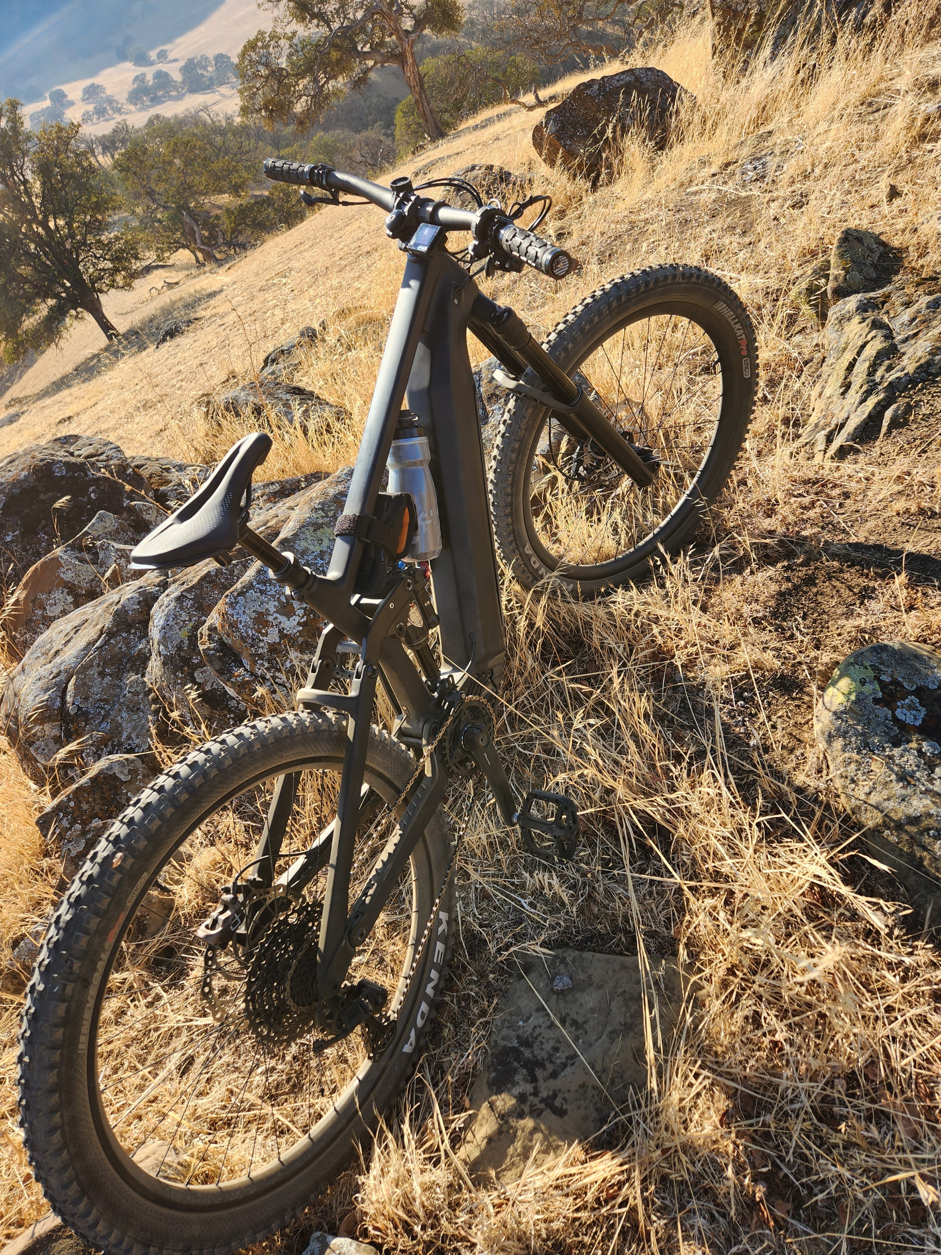

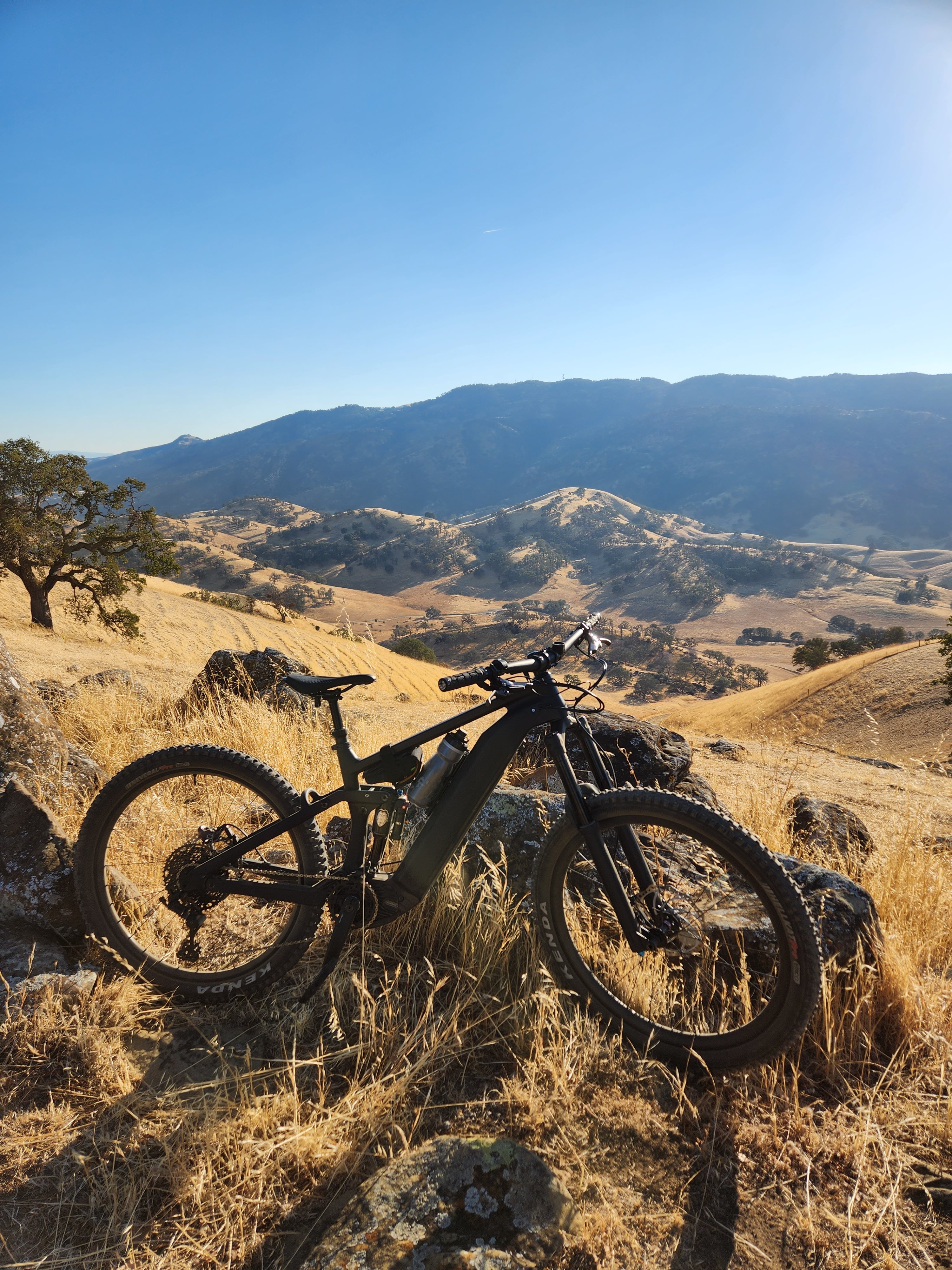

Finally recieved my frame. Assembly was straight forward and I didn't run into any real issues.
Chris has been very helpful and attentive during the process.
The bike feels great on the trail. The geo feels great. Motor has plenty of power for steep climbs. The battery capacity is pretty good.
This is my first EMTB, so I have nothing to compare it to.
Overall Im happy with this purchase. I'm glad I cancelled my E10 order.
A brighter display would be nice. But I do like how compact it is.
Chris let me know before shipping that the battery needs to be removed in order to charge it. A bummer, but it is what it is. Not a huge deal since I'm not riding every day.

Looks great. I'm building mine up at the moment.
May I ask - what bottle cage are you running there? It doesn't even look like there is a cage. I'm running a Super Deluxe Coil and I was wondering if I'll even be able to fit a regular sized bottle in there with the piggyback, but it looks like you have.
Thediesel233
May 11, 2021
25
20
Cali
It's just a cheap ZTTO aluminum side mount bottle cage off aliexpress. Should be less than $10 delivered to USA. The bottle fits but it's a bit tight so it needs a little wrestling in and out. No big deal, it hasn't dropped a bottle yet. I use this same bottle holder on all my bikes.

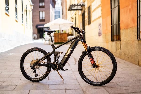

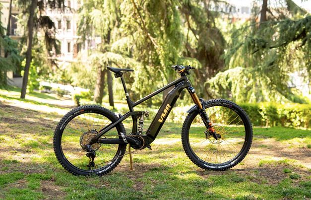

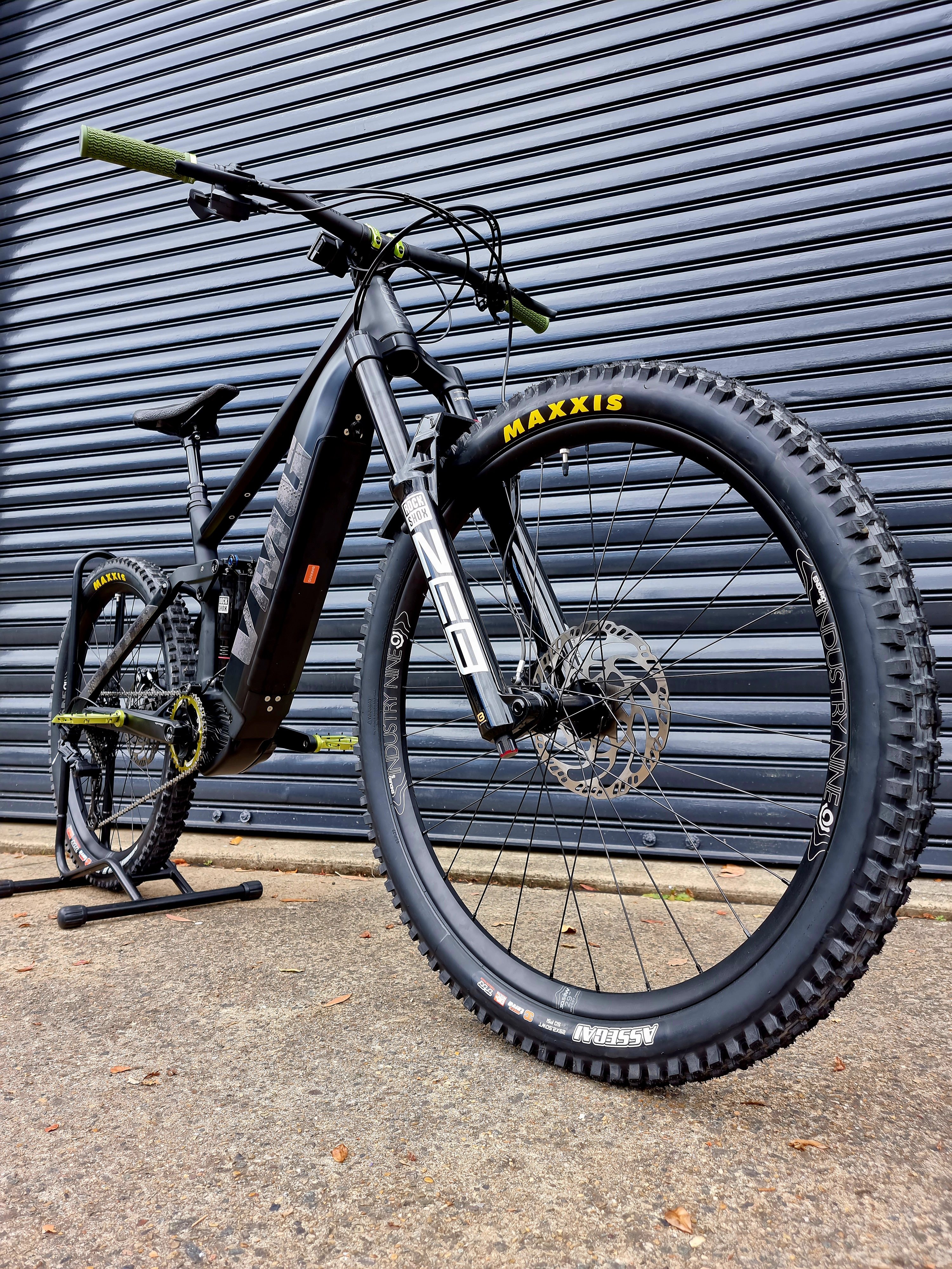

We finished this build last week for a good friend and customer of VMG.
Upgraded with 2023 Rockshox Zeb Ultimate, Super Deluxe Ultimate, Industry 9 enduro wheelset, SQLab saddle and carbon bars, Funn stem, grips and chainring and Raceface Atlas pedals
