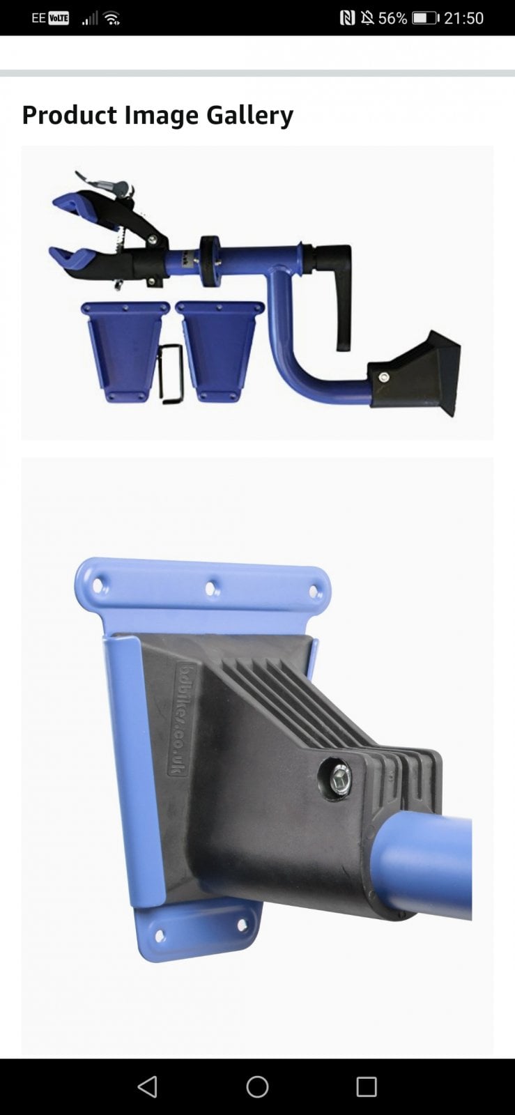

That looks great. What brand is that and if there is a link
I got 2 from Amazon a few years back, have one each side in my van. I also cut down the length where it fits into the holder, so it brought it closer to the side of the van Looks like they're not available at the minute on Amazon, but here's the link.

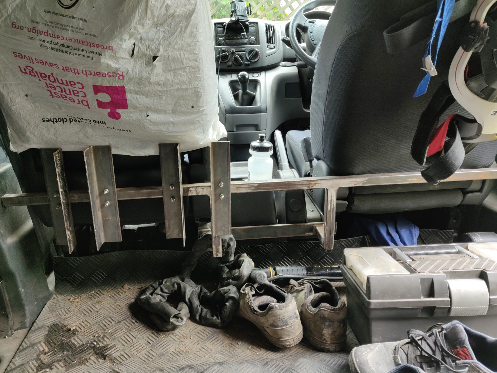

I had a bracket made up with adjustable angle iron slots to hold the wheel.
If I had to faff taking a wheel out, I would buy a longer van.
