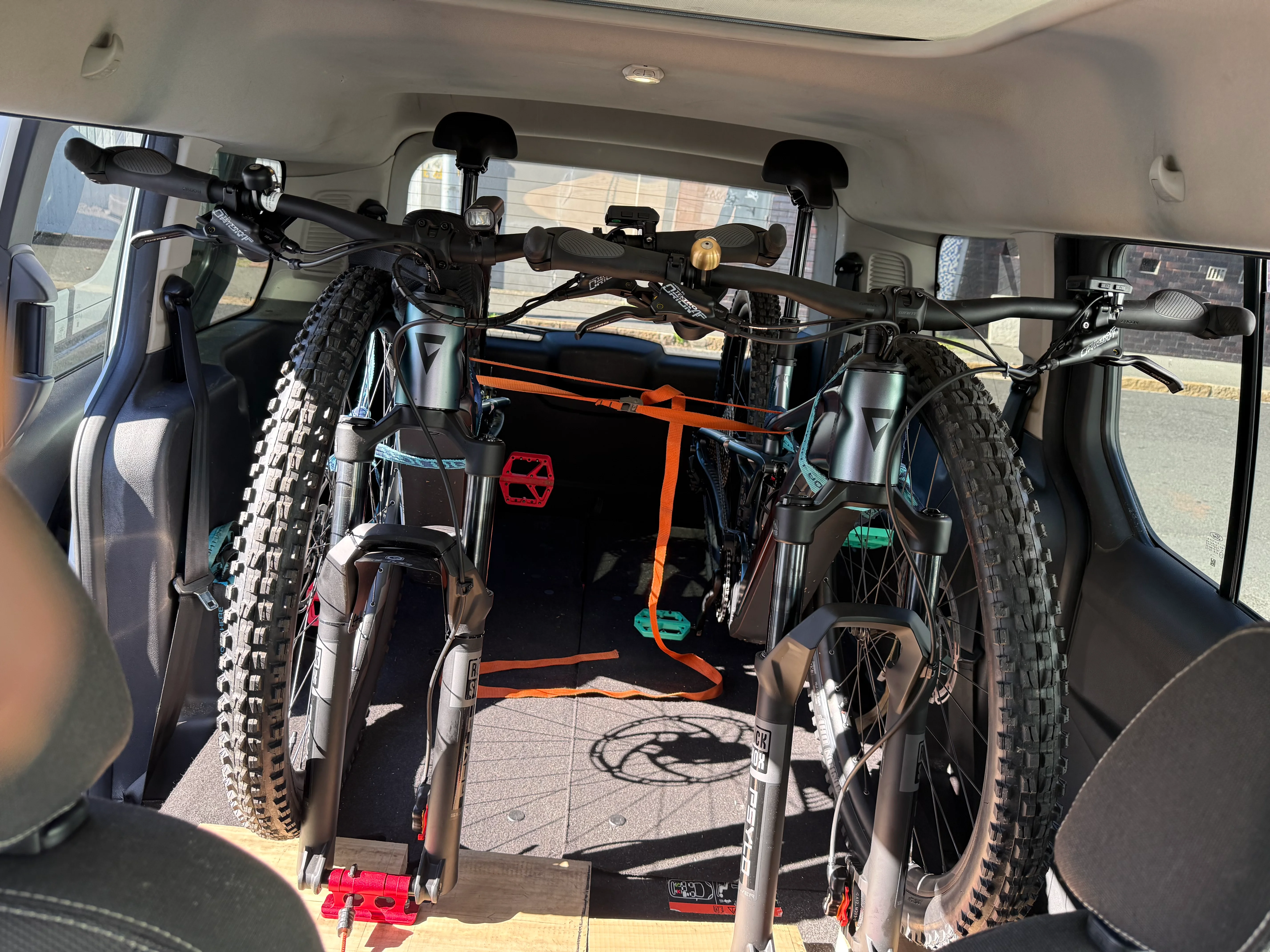

Loading bike into the Van.
Cocktail_Dave
Mar 7, 2023
20
62
Lincolnshire UK

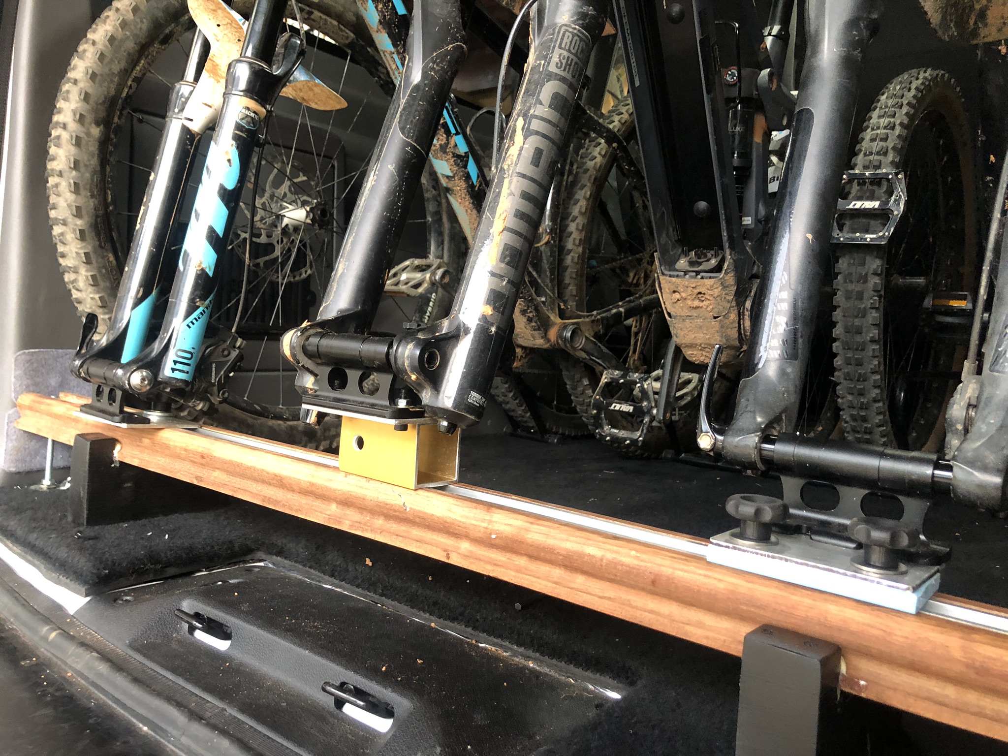

These are the runners about £80 from e bay, I have 2 sets one for the bikes and one kit.

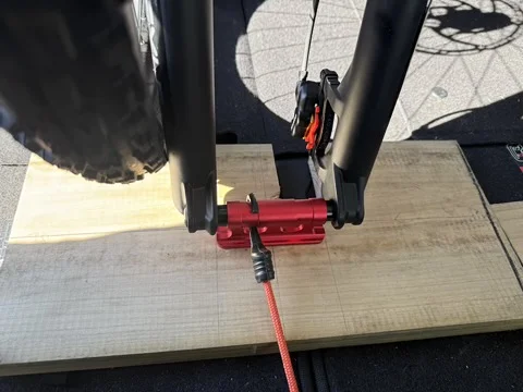

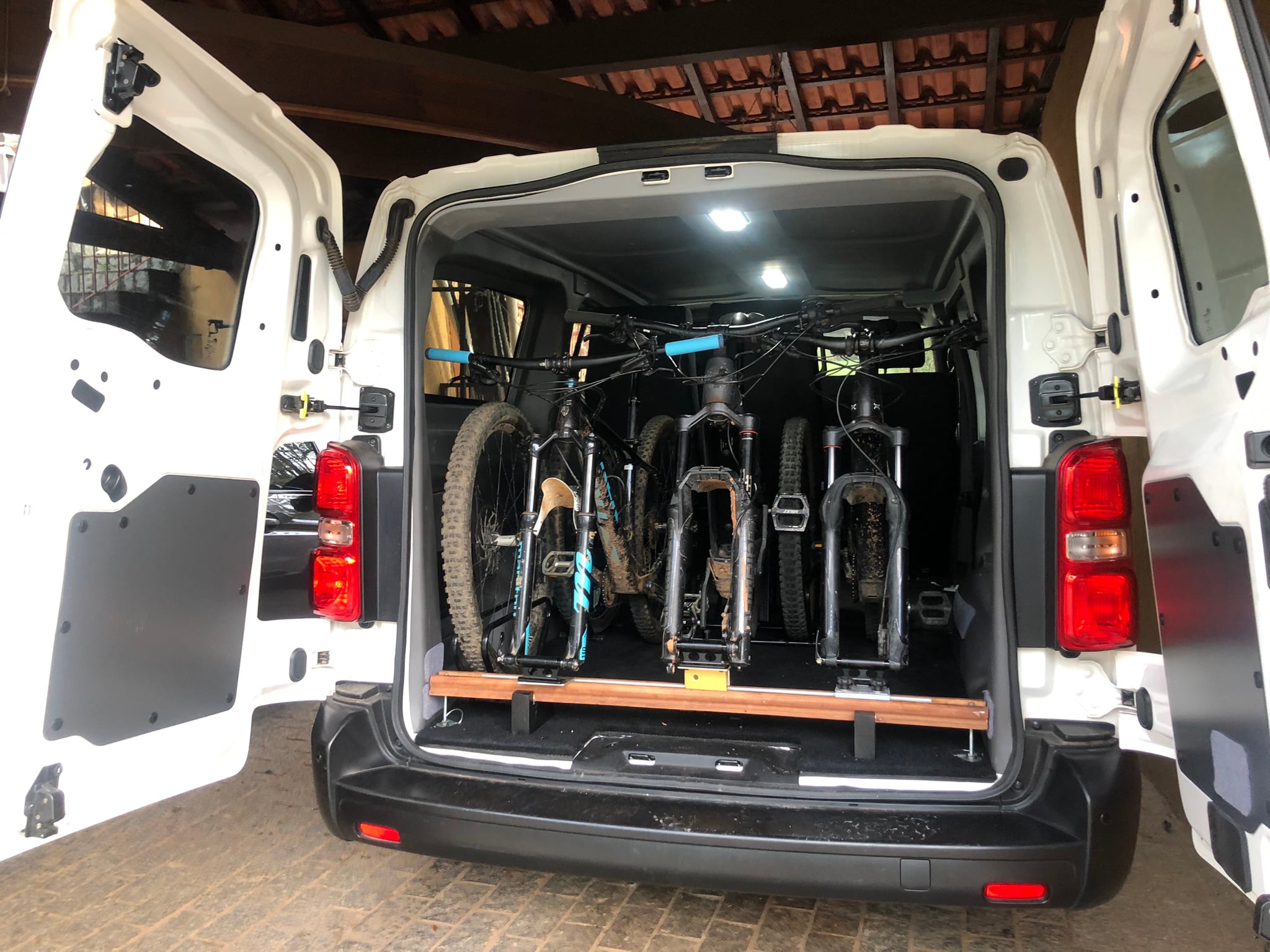

You can do a lot with some simple bits of timber.
Something like a 8" wide strip of MDF, with 3x2 'sides screwed from underneath and a block of timber to be a 'shoe', with an appropriately placed 15mm hole through it for the axle bolt.
Wheel off, place your block in the forks (the heavier lower part would swing to the bottom as you rotate the front into the 'slot' ) then shove it forwards. If you make a decent job of it the bike will stand up steady whilst you get a strap or something on it for driving.
That said, if you're a VW T6-dweller you probably want some Gucci emperor's New clothes affair that's actually shit and costs a fortune when a few bits of timber would be perfect.
But, hey ho, I tried. :-D

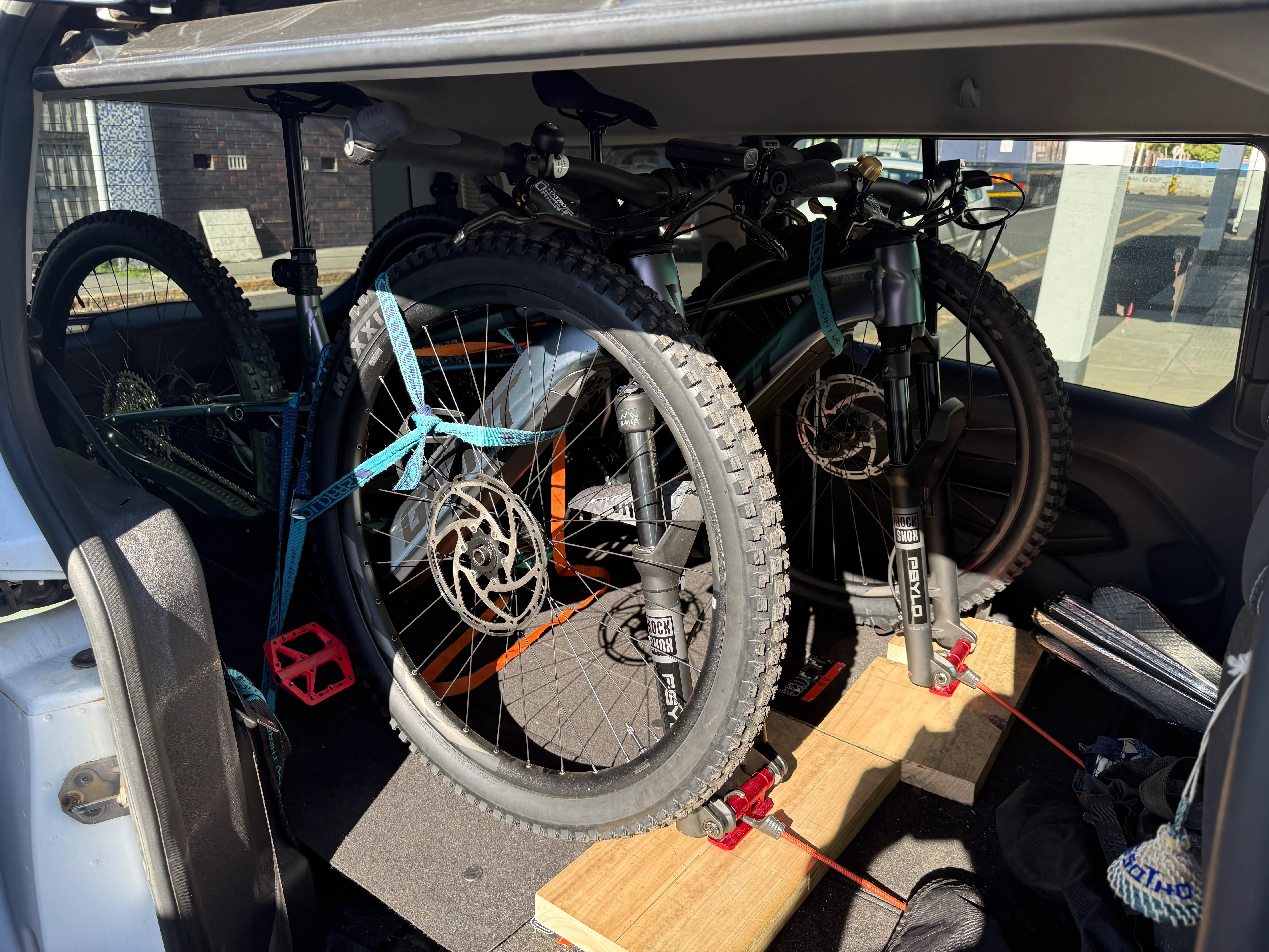

Get a scaffold board and ride the bike into the back of the van ( keeping your helmet on at all times)😂

Check out Tom Cardy van.
May give you some ideas

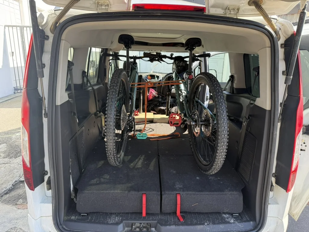

I personally use Bikestow in my VW , I too have a dodgy lower back which I try to protect as much as possible. I find leaving the wheels on is much less of a strain on my lower back, I simple roll my bikes in backwards, yes you have to lift the rear, but since the weight of bike is supported by the front wheel it's a easy on my lower.
Hope you find a solution that suits your needs
