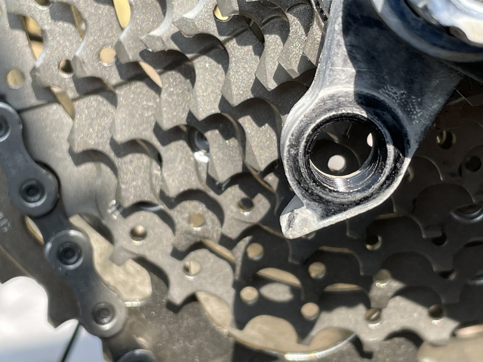

Problem is now that the derailleur is too short and that pulley wheel cannot fit under the 46t sprocket.

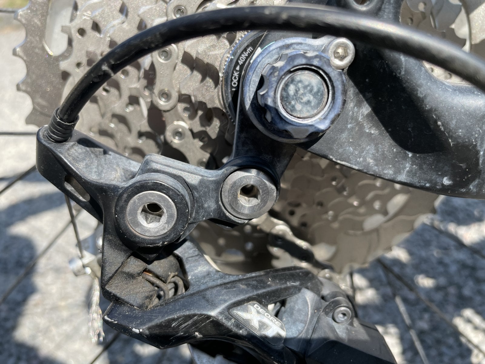

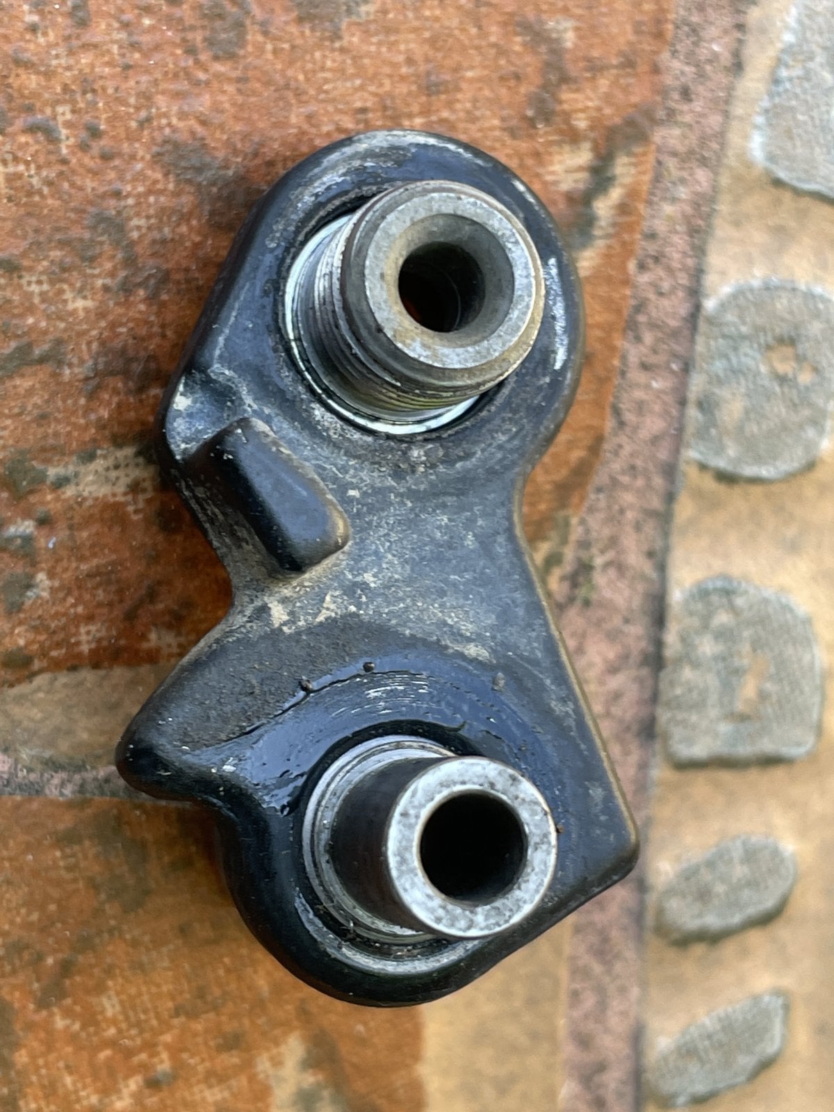

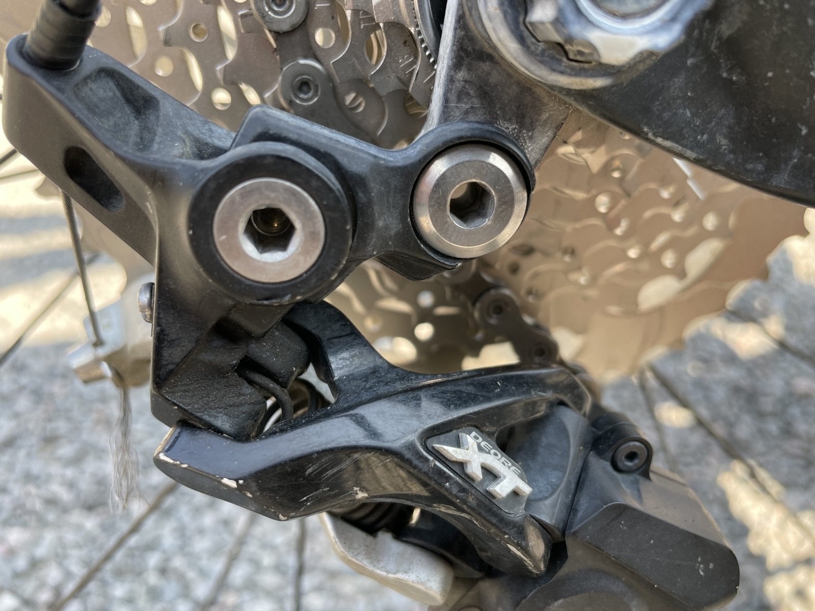

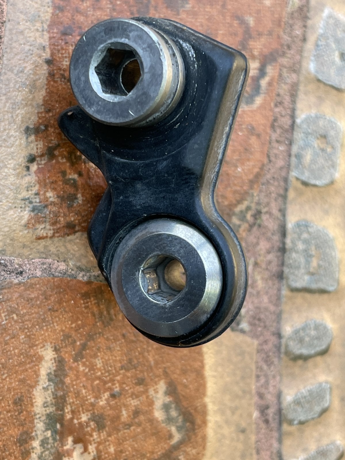

It seems that there already is some kind of extender between the frame and the derailleur, on the Focus Bold2 (see attached photos). This is possibly to make the derailleur capable of accommodating the original 11-40 cassette.
Question is: Will Goatlink make it possible to use my existing Shimano Deore XT derailleur?

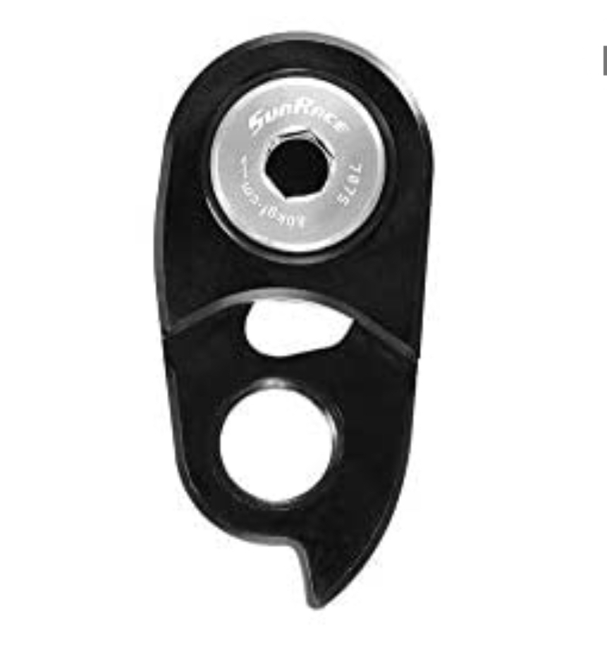

I’ve used one of these on a couple of bikes now where I’ve converted them to a 1 x 9 or 10 system and a wider range rear cassette.
if you search for ‘SunRace Unisex's Extended Link Derailleur Accessory, Black, 2.25cm’ on Amazon, you should find it.
Only a tenner but work well.

You didn’t post a photo of the derailleur arm and tension pulley on the second to lowest gear position, so might pay to double check that your chain might now be too short (instead of the derailleur arm)?
