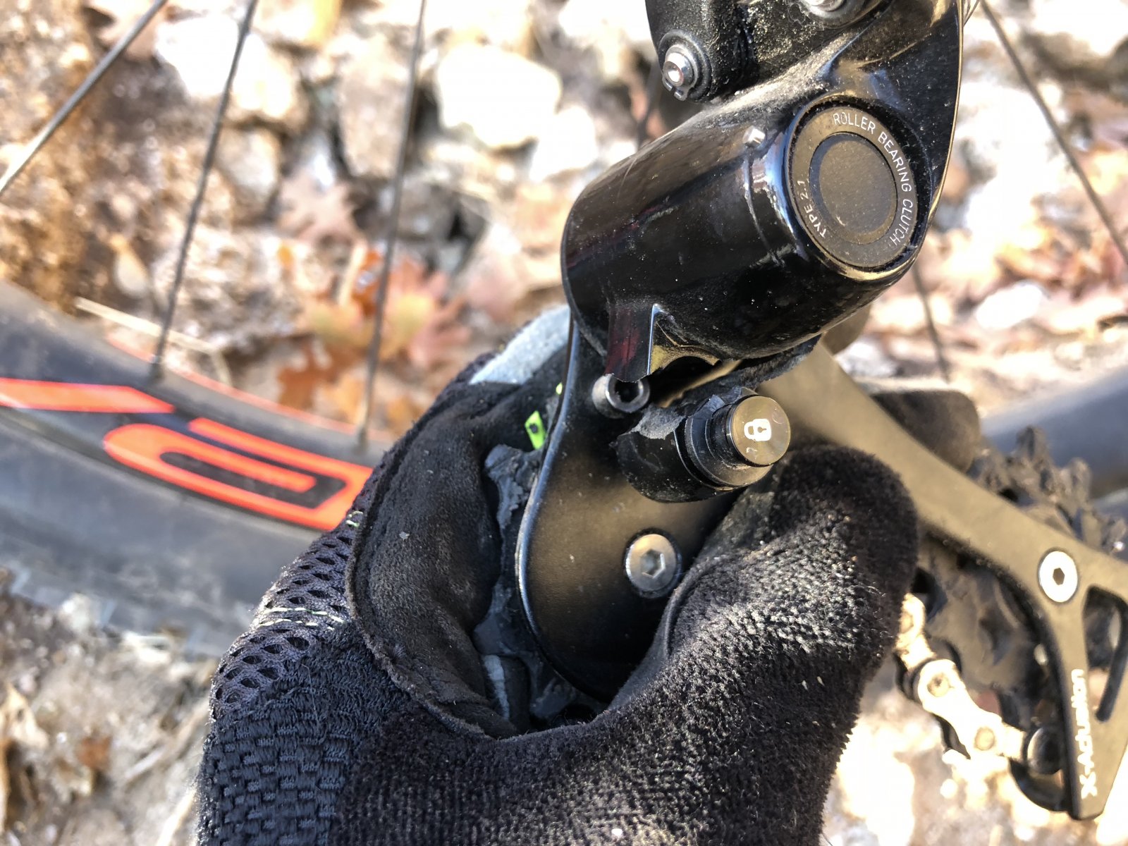

Hey guys, @dirkbike here.
I've tested the Levo in different builds, the Kenevo comp, and now purchased the Kenevo Expert a couple of days ago and really loving the bike, until today... I was powering up a really steep climb that normally only hikers or horses do, bikes are allowed, but unless your mega strong, you're going to be hiking, it's really steep. Which is why I really wanted to see if I could get up it with the new assist bike.
Anyways, I was pedaling a good cadence in full turbo mode, in the granny gear when all of a sudden, the SRAM GX derailleur broke off from pure torque and power alone. It didn't get caught in the spokes, nothing weird. It snapped off, went into the spokes, and smashed into the seat stay. Has anyone experienced this before? Whats the most durable derailleur for e-bikes? I'm going to get it warrantied but certainly don't want it to happen again.

Hmm so what the heck could have happened? I was literally fighting to keep it going pushing as much torque as I could apply in 100% support mode, figured it had to be from too much strain on the drive train, but I can see your point which is, it should go from top dead center of cassette to front chain ring, but at the same time, I can see the torque working it's way down the cassette to the derailleur especially since it doesn't wrap around the cassette like a moto chain, it's only meshing on 1/4 of the cassette, and with the amount of play in the teeth/chain mesh, I'm no scientist but it makes sense in my head the chain wanting to pull on it.

in your lowest gear there's a good chance it can touch a spoke and get taken out.. it can also get ripped off if your chain is too short and the suspension compresses or something jams anywhere along the chain causing it to pull the derraileur forwards too far. A seized jockey wheel can cause this too. (SRAM jockeys are bad for this). As can a twisted chain link. or if it had previously been damaged by a hit. there's a rather large list of possibilities. including a manufacuring defect. (unlikely but possible).
is there honestly no other marks on the mech itself or your drive side spokes? and is the bottom jockey wheel spinning freely?

Awesome I'm more at ease knowing I should be able to tackle these steep climbs that were never even imaginable before the ebike.
I went through the bike. Got maybe 1/8 of a turn out of some of the linkage bolts, the hanger is tight, it could be bent though, it shifted fine but I guess if it's tweaked slightly as @steviedsolve mentioned it could have done it, I'll check it tomorrow with the gauge when I throw on a new derailleur. I actually tightened both limits before this ride as it left the shop with too much over throw for my liking - that or maybe it had gotten bent and I had to adjust it. I don't know, I certainly can't check it now. There is a spoke that's mangled but my initial thought was it broke and then went into the spokes, perhaps under torque, it twisted itself into the spoke? I don't know. SRAM may warranty it, if not I'm not too upset, luckily derailleurs have come down a ton in pricing. I'm more upset about the chewed up paint than anything :/ We'll see if Specialized can send out some touch up paint.
I'm gonna get a new GX tomorrow from the shop, and go back to this hill and hopefully conquer it.
Thanks for everyone's feedback, I'll report back with my findings.

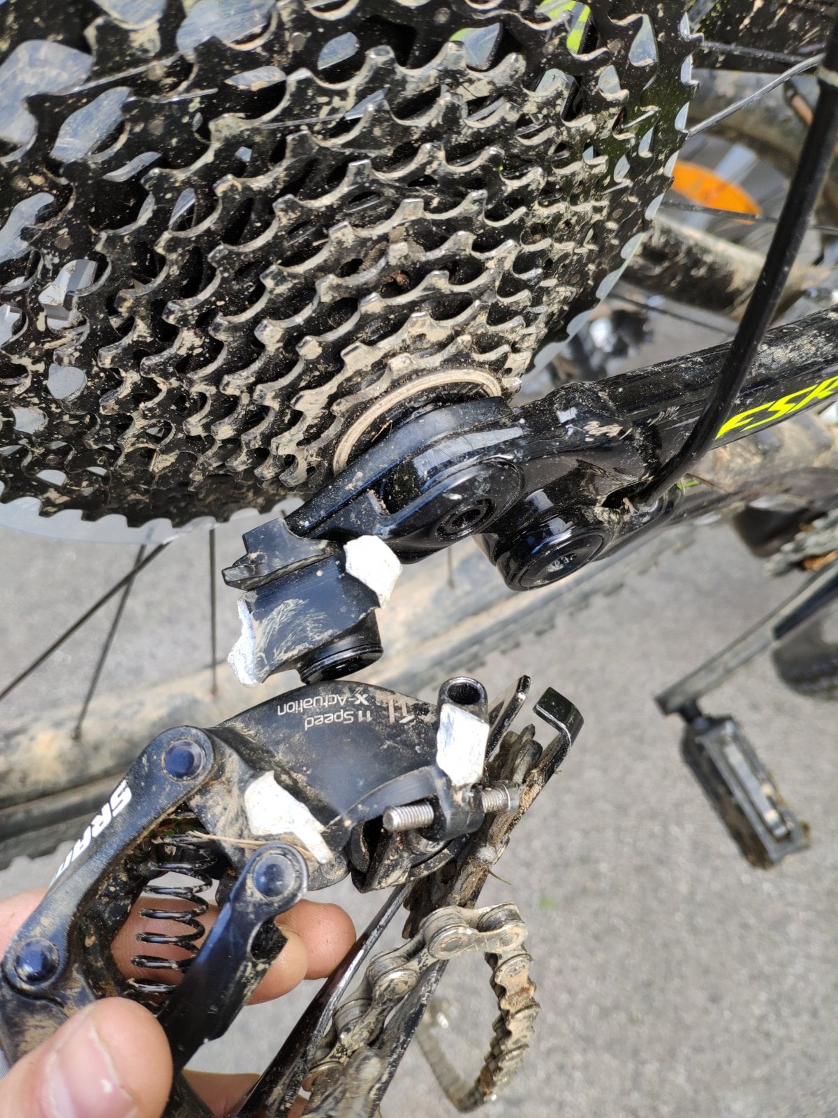

My derailleur broke off today in a similiar situation to yours. Going up a hill in turbo hit a bump and it snapped clean off. A stick might have got caught in it, i'm not 100% sure as I wasn't riding it at the time.
Bit annoyed as I had to push home and the chain has scratch the rear triangle now. Hoping specialized will warranty it though.

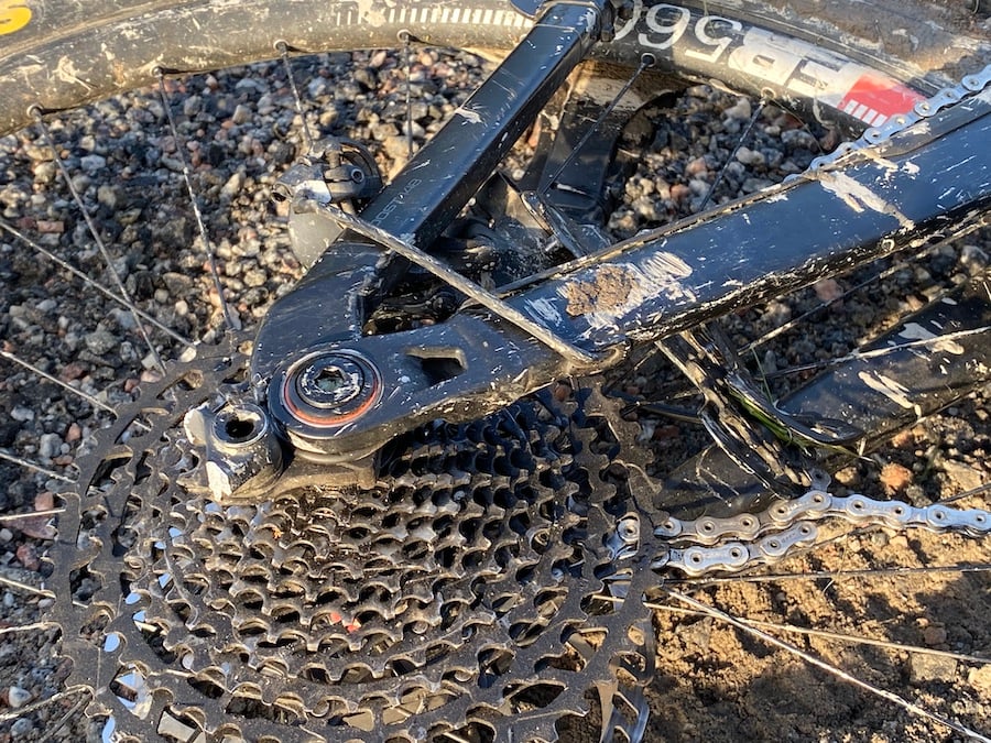

Notice how mine broke off in a different place than the other ones posted. This was caused by a stick.
Being in turbo is irrelivent
Your mech cage plates are twisted. This shows the mech was caught by something (most likely by your spokes) and forcably twisted until the aluminium near the mounting bolt sheared. It did not break from the added power from the motor.
If caught by the wheel rotating (by a spoke or even a stick in your spokes) a mech is going to very quickly be pulled past it's designed pivot range therefore it will break at it's weakest point (Which also depends on the direction of the pull/twist).
If hit by an object (rock etc.) a mech or hanger can break catastrophically. for a mech this can be at a pivot, cage or more often than not the aluminium near the mounting bolt.
This happens more often now that rear thru axles are the norm. Replacable QR dropout mech hangers were loads weaker and less stiff so in a lot of cases the hanger used to break before the mech did. occasionally saving the mech from damage.
#science
For this to happen to you guys less often pay careful attention to mech clearance from trail odjects as you ride, when riding through or close to overgrown terrain listen out for anything in your mech spokes and if you suspect anything is in there stop pedalling and pull over to inspect it.
before, during and after rides pay attention to the condition of your mech/hanger/rear axle. (if any one of these are loose/bent/damaged it will often show up as gear indexing becoming sightly out).
A shop may be generous and offer you a new mech (or a reduced price replacement) but don't expect this and if they do be greatful. None of the above are genuine warranty claims.
