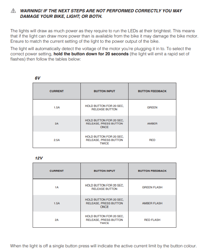

Thanks for the link I always thought the only difference in the versions was in the provided cables. But still if the brose version pulls 24W and the bosch only 17W the worst thing would be some lumens lost?

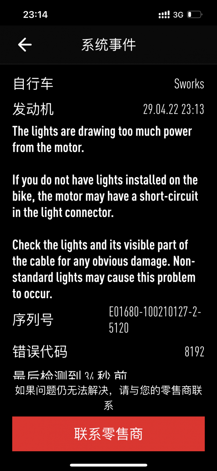

Error was on the TCU. When i put the power on at the TCU and light turned on, the TCU gave error.
And there's a answer earlier in this thread why it gives error:
As you've seen from the table above, the light ports are available but limited to 2A max - this is pretty important. We've seen with the Lupine SL SF (for example - with high beam) that the inrush current is way higher than 2A so the motor sometimes shows an error. Same with the Supernova M99 mini (we believe - we're in the process of checking this out). Key point is being sure to keep the inrush and regular use current under 2A if you use these light ports on the Brose motors. Note also that the max current on the Brose 1.1/1.2 motors we used on 2016/17 Levo and on many Vado bikes is 0.5A.

I just tested my new Lupine SL-F with C14, got error code when I turned high beam on over 1 minute or some, with low beam there is no problem at all. Contacted Lupine last night, waiting for the reply, but it seems it was inrush current higher than 2A as SP described. Let’s see how this will solved out
