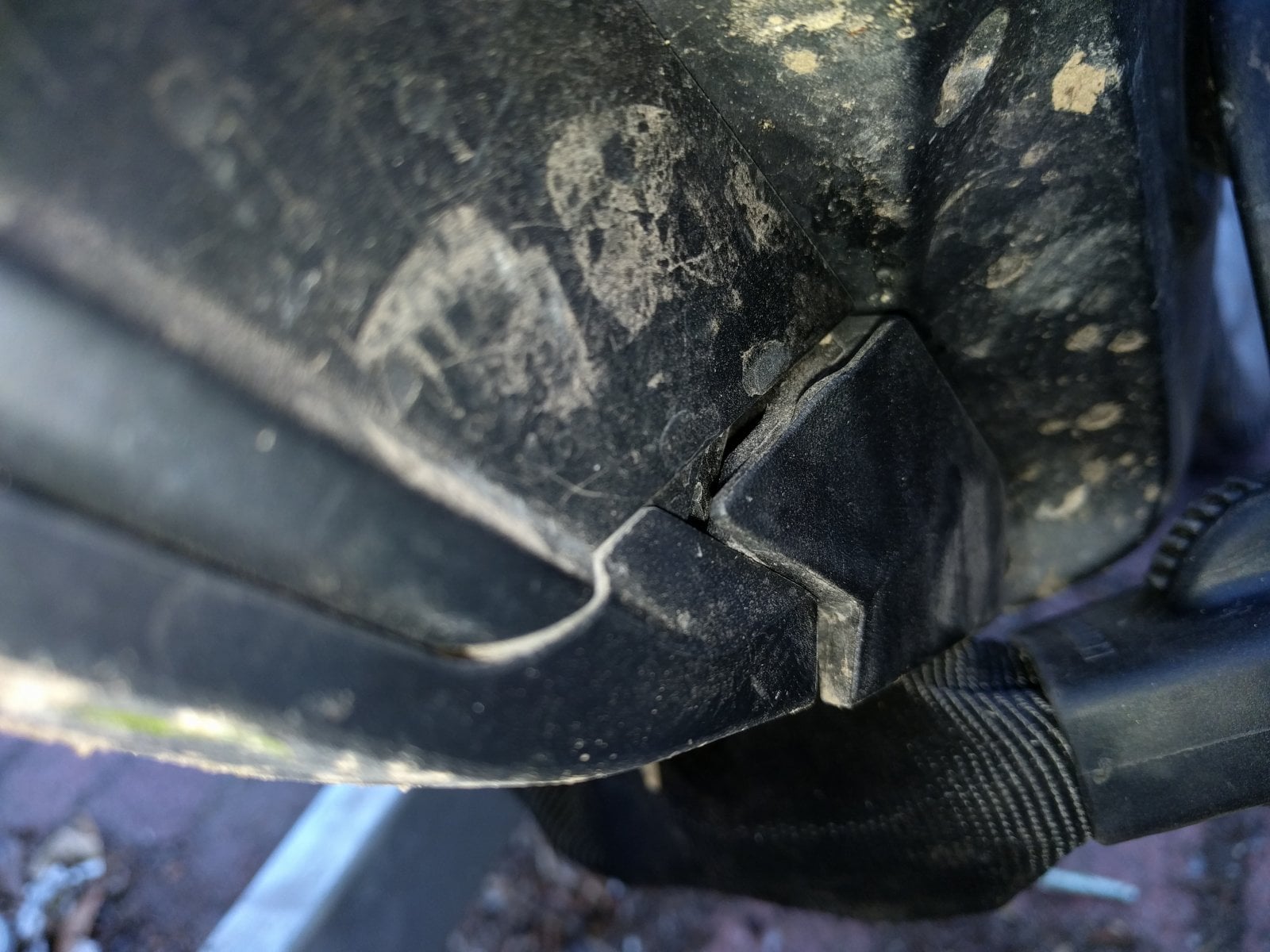

Turbo Levo with no power assist
Norange
Jul 29, 2018
337
245
Wiltshire
Mine sits like that too, and have had a couple of issues with connection. Will ask lbs to take a look when it goes in for 6wk service.

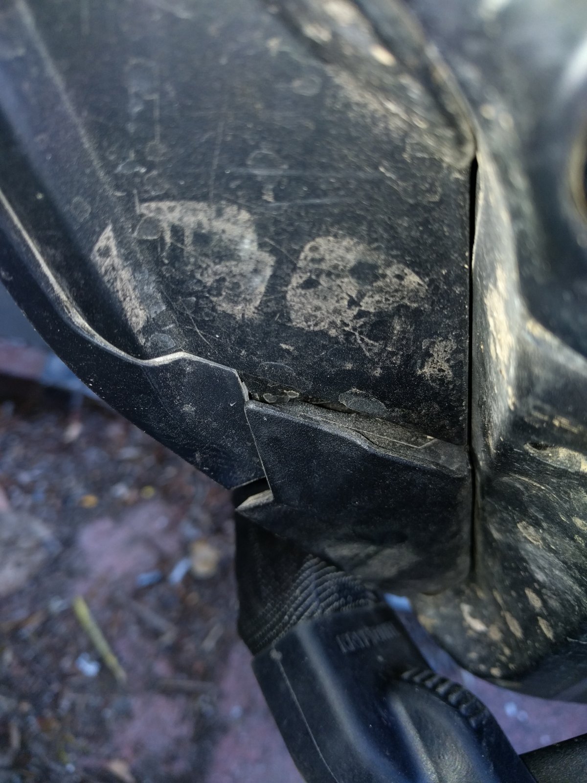

Norange
Jul 29, 2018
337
245
Wiltshire
This is how mine is:
Surge
Aug 20, 2018
142
75
Toronto
Thanks, helpful. Mine looks similar. It makes good contact... odd that the shape, especially the left edge is not more flush with the body.
nictom
Jul 4, 2018
9
24
Sweden
Hi, I have had the same issue. The broblem seems to be behind the cover. There is a cable holder and depending on how much cable you have between the cable holder and the battery the contact can be flush or like in your and mine case as on the picture.
Solution is tho adjust the cable length by so you got the proper length.
If it’s to long the Bluetooth cable can get damaged and give power cuts.
So be careful while adjusting the length because the cable holder is sharp and easily cuts into the cable.
Norange
Jul 29, 2018
337
245
Wiltshire
Cheers Donnie, doesn't look too different to mine. Will have a look at their stock bikes when I take it in. Once I just thought I was knackered after a long day at work. Did a few miles before I thought to check walk mode :unsure:

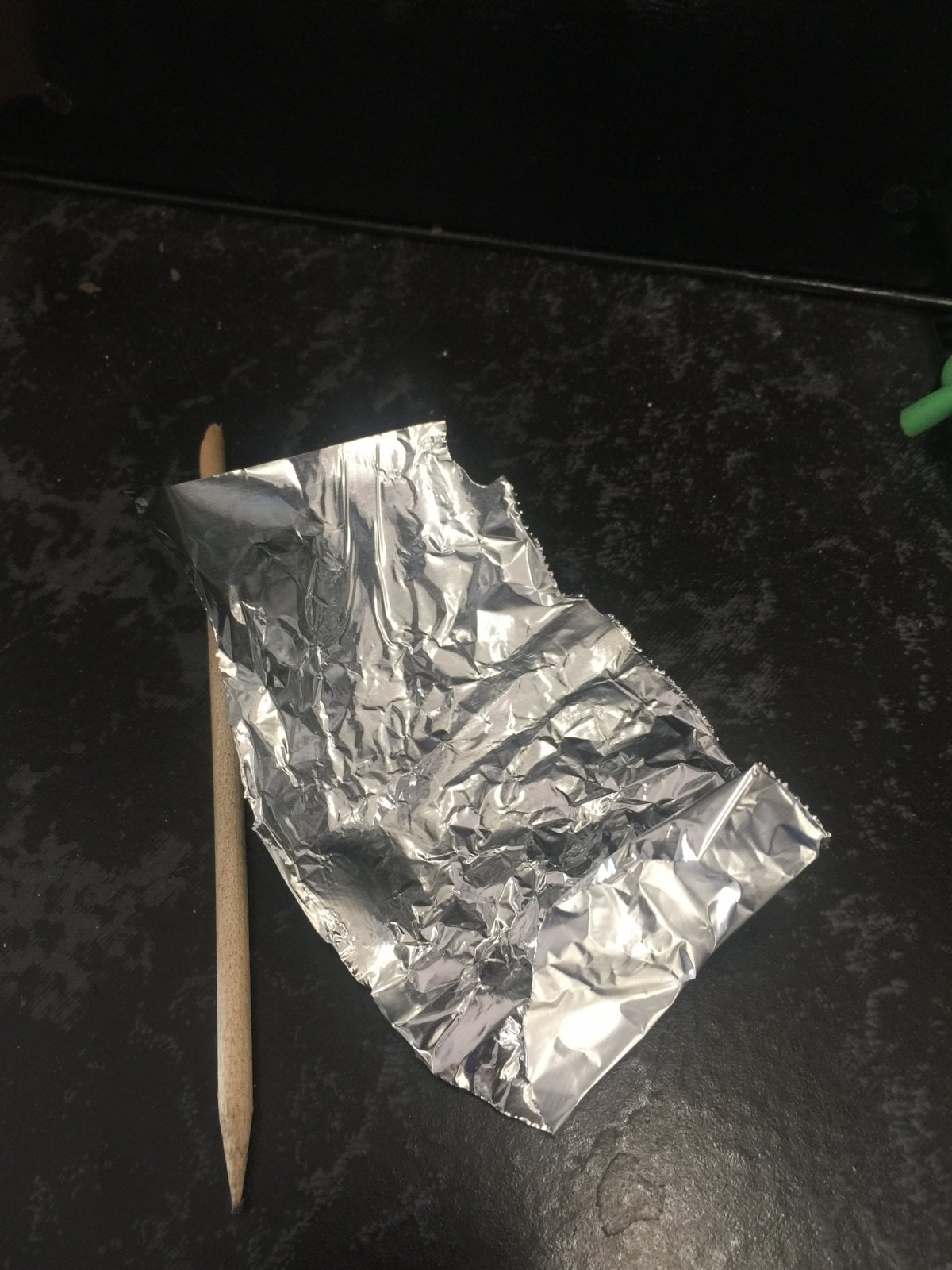

A recent mtbr post just made me the happiest guy on the planet! Putting small wads of foil into the female connector holes instantly did the trick! Seems like the female connectors stretch out and start to lose contact with the male pins, causing this problem of intermittent or no connection.
Word of warning on putting anything metallic in the socket charging connection to make it work. If you short the battery charge to the small gold connectors it blows the batteries management circuit. You are then £700 down as they can't be repaired.

I’m having the same issue on my 2019 Kenevo Expert. Happened a few months ago but seemed to resolve itself. Now it won’t turn motor on. I wonder how it went with the foil solution? Simple fix or as the following post suggests a disaster? I’m afraid now of taking it to the shop fearing a Covid-19 lockdown and having my bike in “quarantine” for months, especially if there may be an easy fix or at least to give a try to rule out other problems. Thanks.
43428425-0188-41FA-AA30-1D223C7B499D.jpeg Here is the answer: Crack?
No, not drugs, that tiny corner of aluminum foil ever so gently inserted into one of the female connectors that looked a little more worn. Now the motor engages and the thumb switch is working again. No field test yet but no explosion or I’ll effects so far. Maybe I’ll see if the LBS will replace it under warranty without leaving it there. And I’m definitely putting crack... foil in my Camelbak.

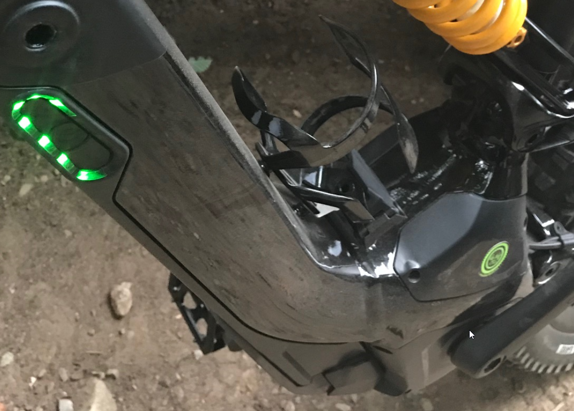

Belgium
After a 3rd battery change and a new motor cable, I lost the power (again) after just a few rides. I tried to clean everything, tried the aluminium foil trick with no success.
The thumb switches do not do anything and I have no power from the motor. The battery leds respond normally.
I've had so many issues with this bike (2018 TurboLevo FSR comp)...
