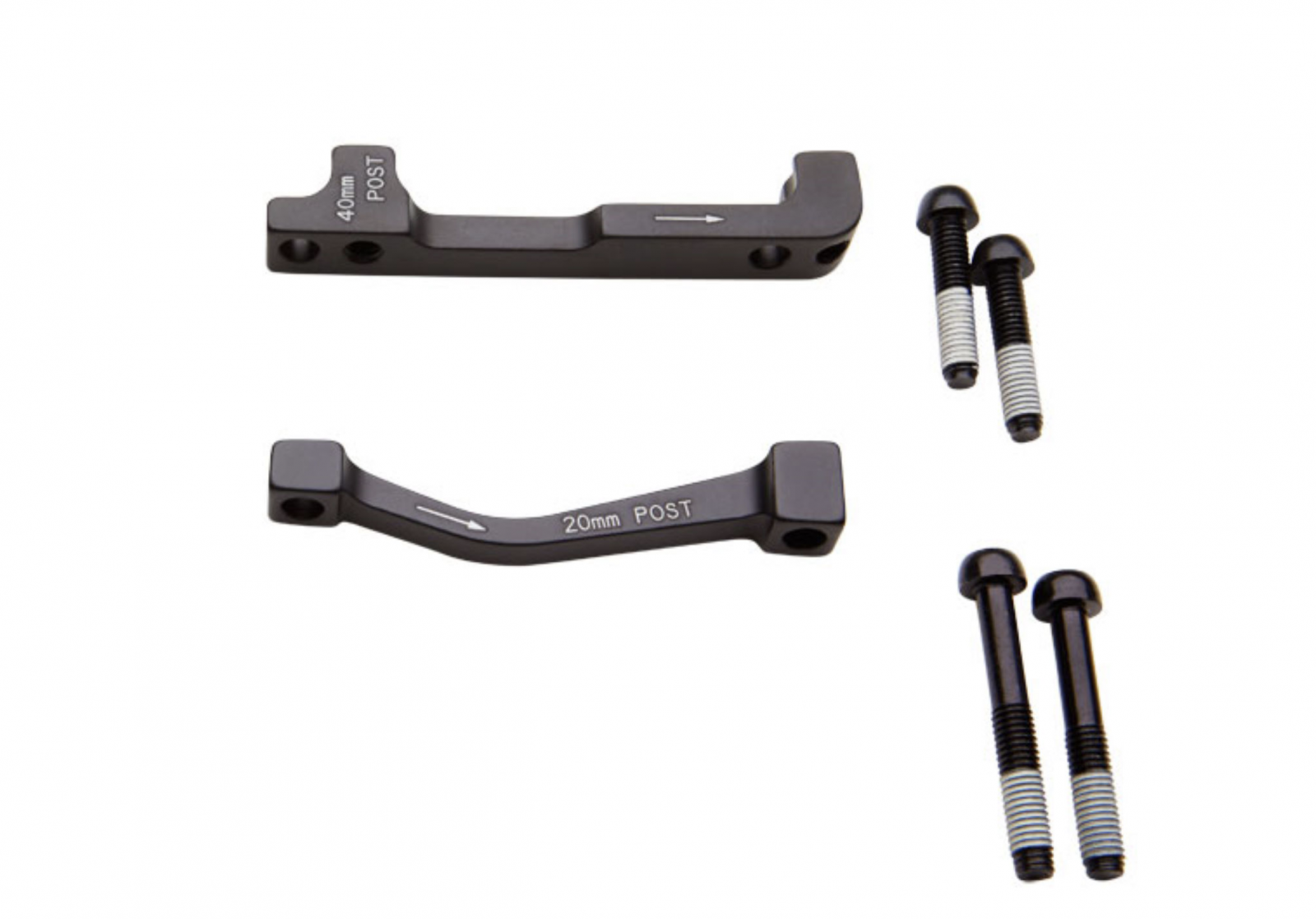

I ordered the new SRAM 220mm HS2 rotor to put on my Turbo Levo 2019 carbon. It's the first time I'm changing a rotor and due to the size increment (200mm -> 220mm), I swapped the +20mm adapter to +40mm. But those really don't have the same shape... so I'm wondering if my mounting is OK or not...
What do you think? does it look safe :unsure:? (with the +20mm adapter, the screws were going directly into the frame....)

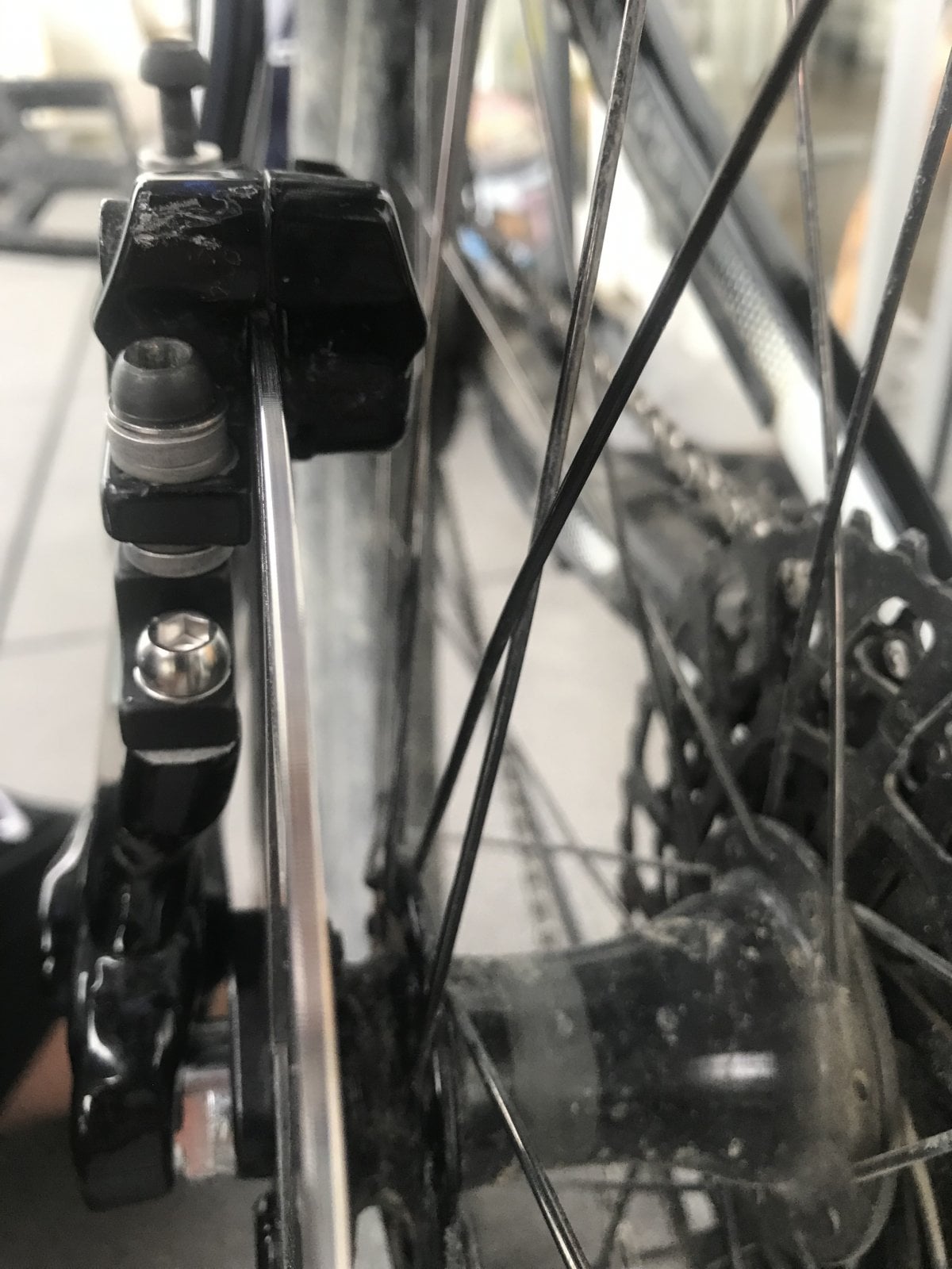

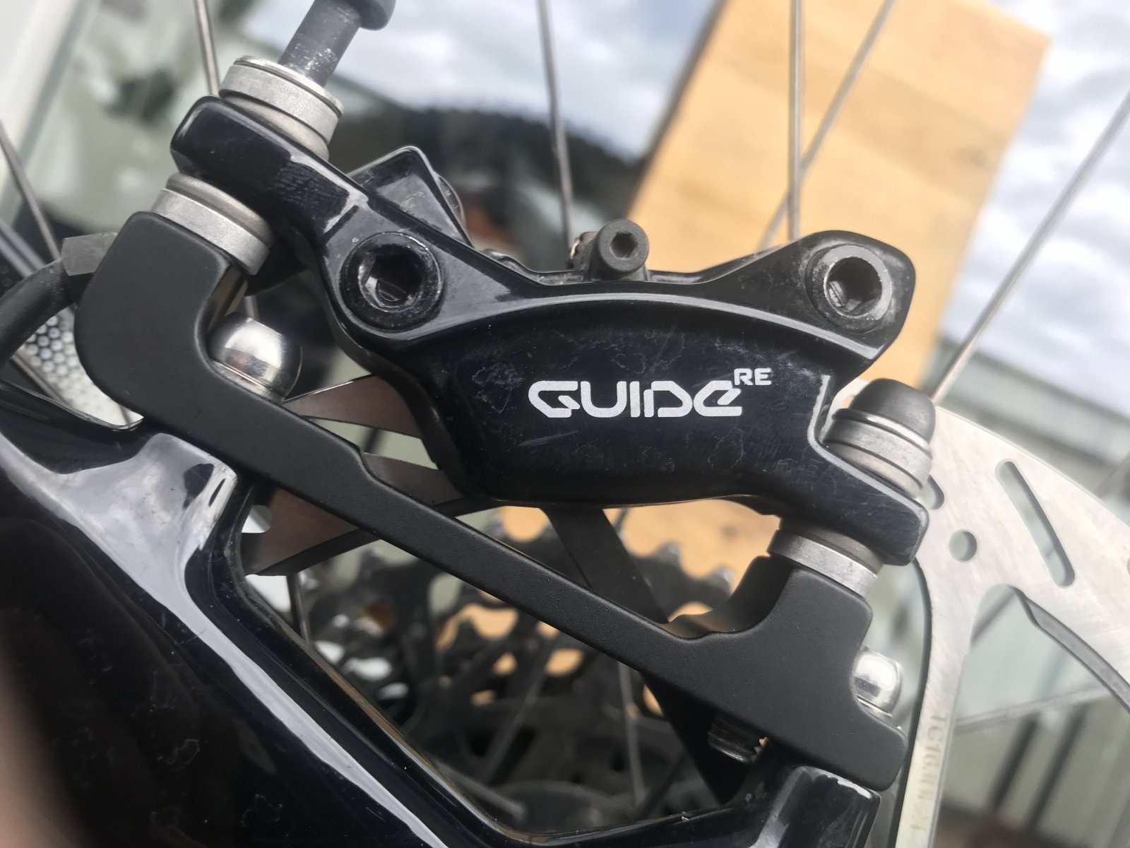

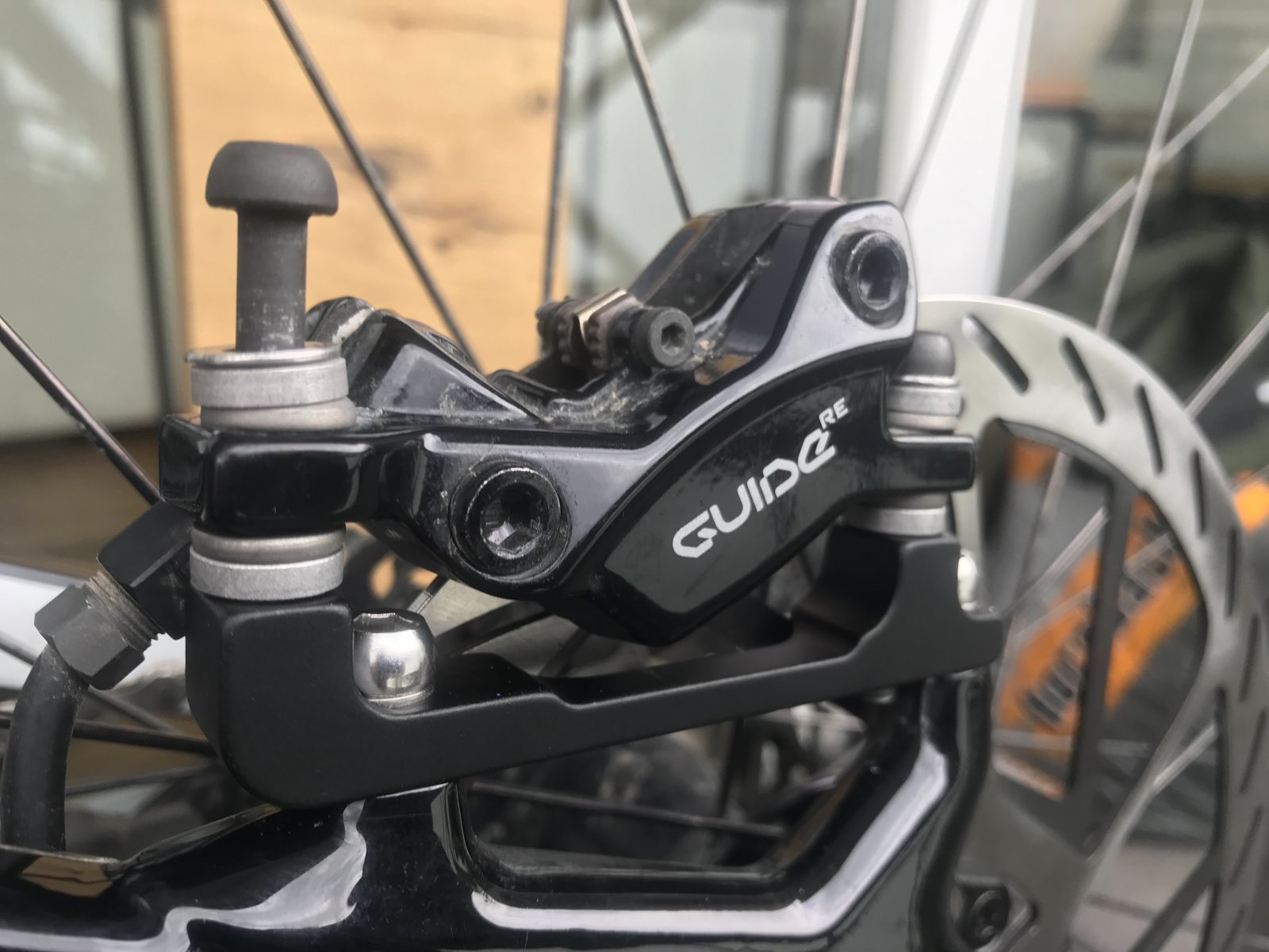

Here are some pics (don't worry about the left screw, I have to find one which has the right size!) :

Except front bolt being too long (or not yet tightened?) it is exactly as it should be.
My OCD wouldn't be ok with larger rear rotor ?

I've got at least 1000 miles with lots of heavy braking on my similar Magura setup. No issues.
Ignore the numbers, I created this pic for another post months ago.
Edit: Someone is going to ask about this. My pad scuff marks are exactly where they should be on the rotor. The pad to disk alignment would be screwed up if I used bevel washers under the adapter or under the caliper.
