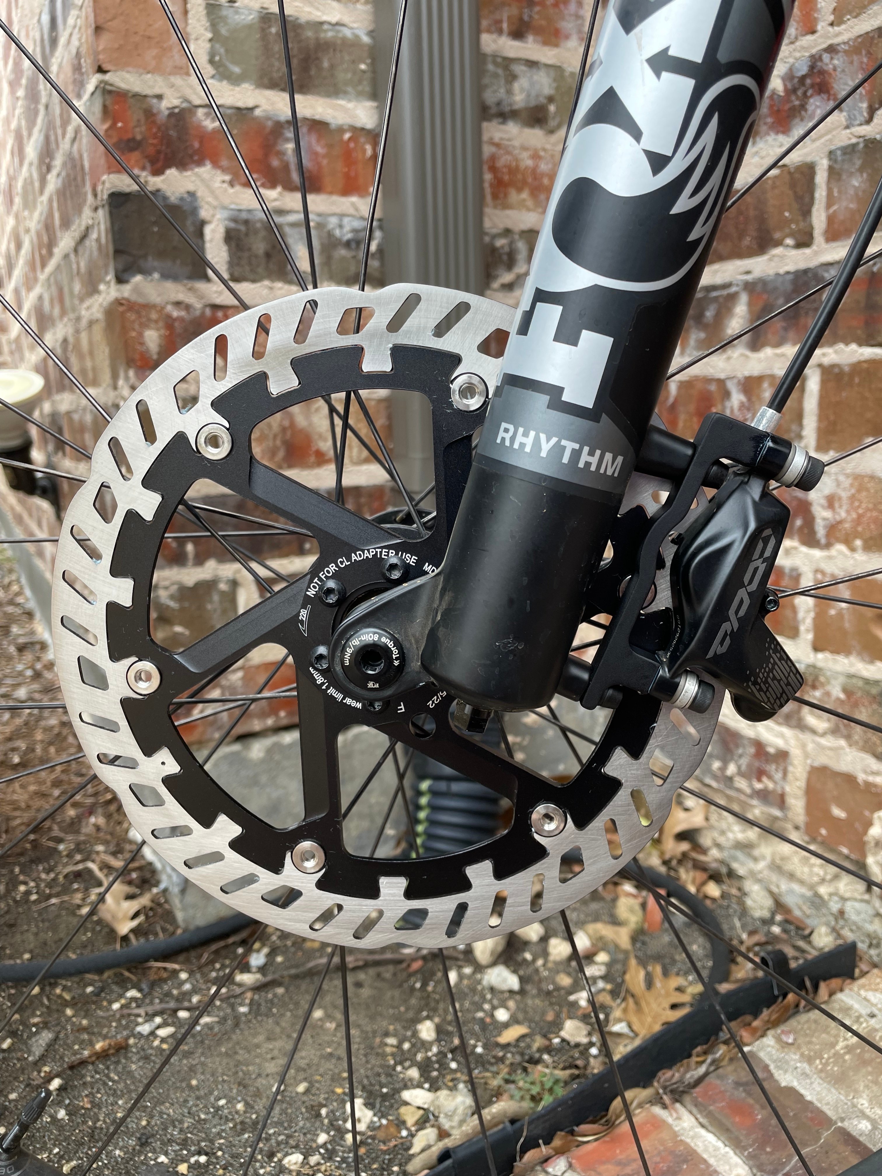

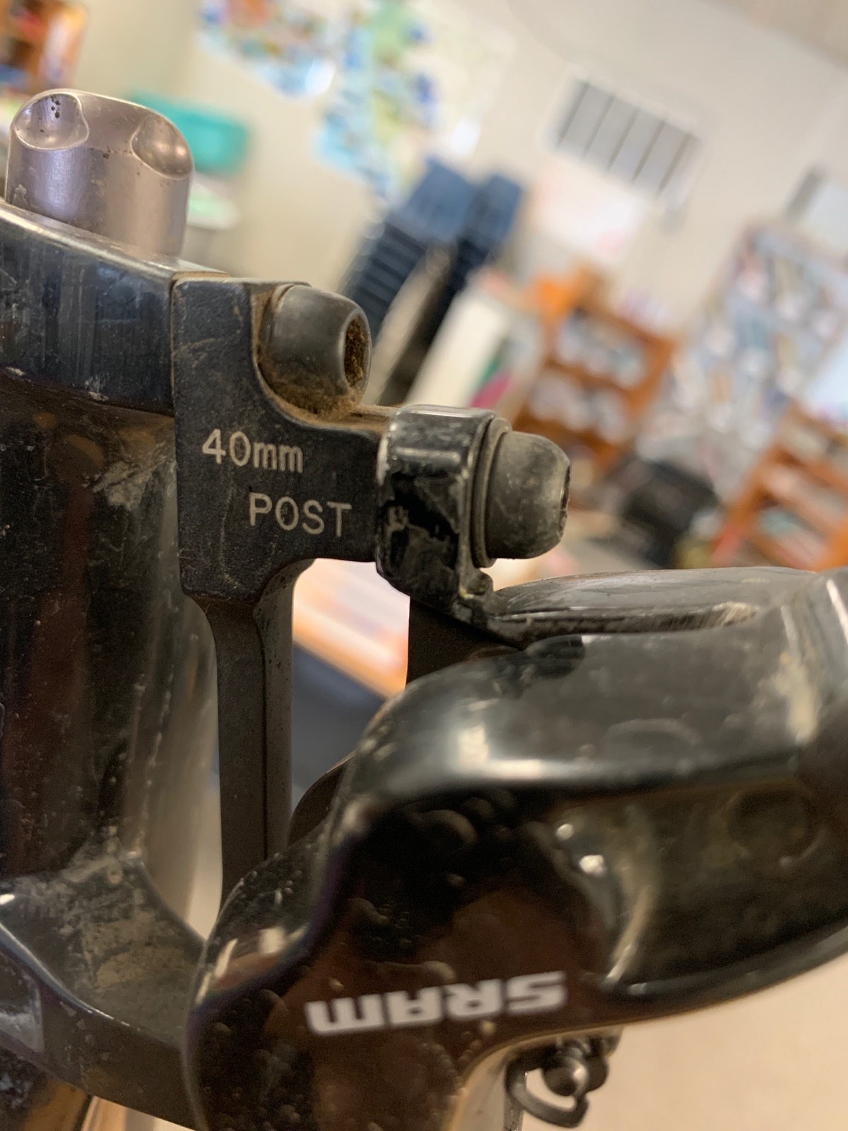

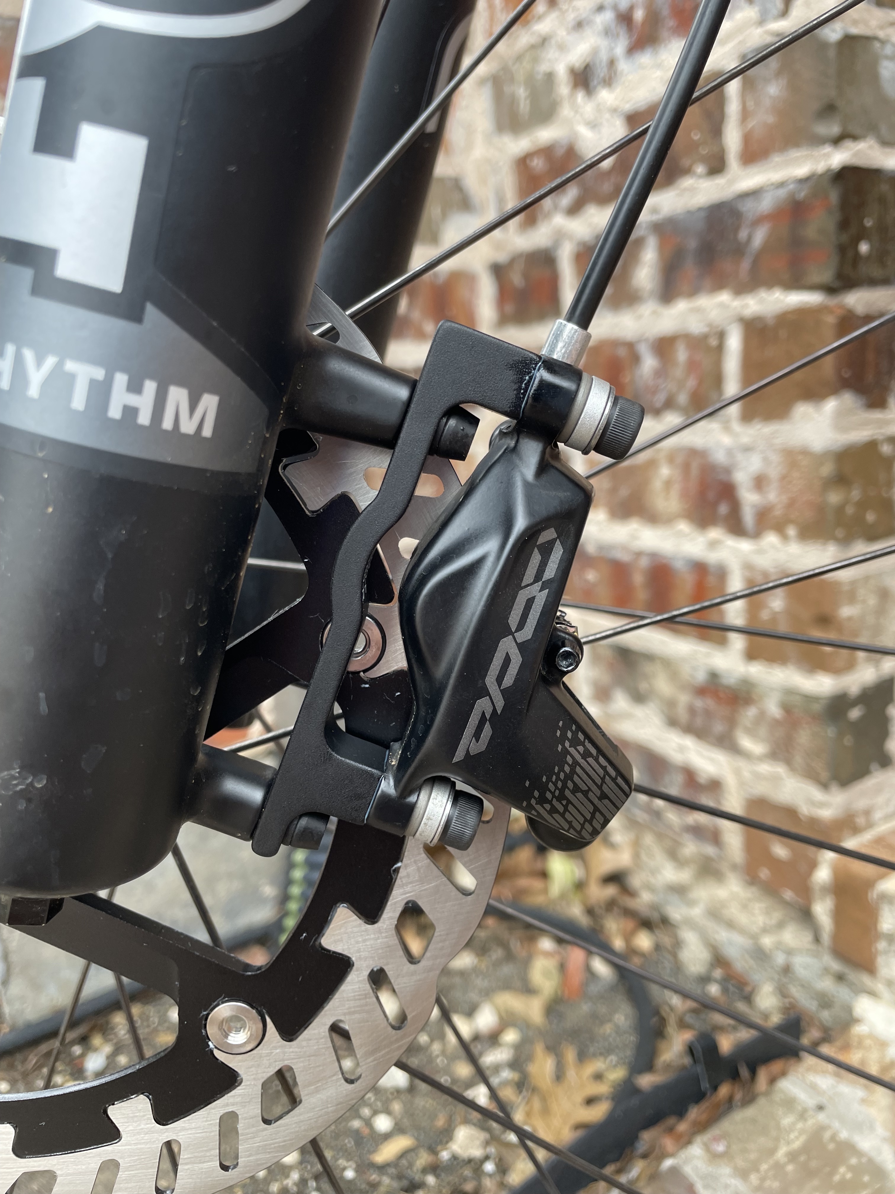

I just converted my front rotor on my 2019 S-Works from 200mm to 220mm. It took some research to get the conversion right so I wanted to share what I did.
220mm Rotor: SRAM CenterLine 220mm 6-bolt Disc Rotor with Rounded Edge
40mm Adapter: Avid/SRAM Disc 40mm Post-Mount Adaptor, Fits 200mm Front and 180mm Rear Rotors
The adapter converts the 180mm post mount on the fork to 220mm. The bike came with a 20mm adapter for the standard 200mm. If your fork is a 180mm post mount then the 40mm adapter will be the right size for the 220mm rotor.
The adapter comes with the screws to mount the itself to the fork but does not include the screws to mount the caliper to the adapter. I measured carefully and bought some M6-1.00 30mm stainless steel hex head cap screws. The size was perfect. The adapter threads were completely filled with screw without any excess.
On my first ride today I spent much of my time getting the rotor bedded in. After that the brake felt great. The brake is noticeably stronger and the bike is more in control on very steep descents. I expect it to get a bit stronger as it continues to bed in.
Recommended!

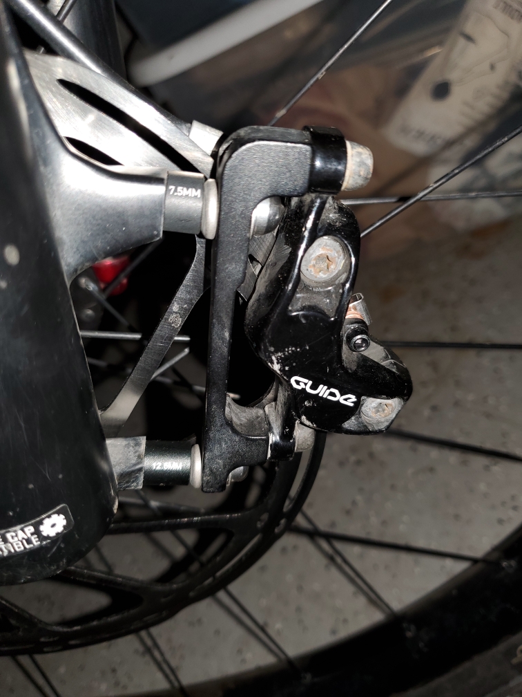

Great discussion you guys. My situation is a little bit different. I have a 2017 Levo and my posts in front and in the rear are already 40mm. my buddy with a 2017 did his front but they sent him some janky looking spacers they are SRAM, but it looks terrible. I'm trying to go from stock 200mm rotors to 220mm.
salko
Aug 29, 2019
1,303
894
SLO
Looks like your fork have 160mm PM caliper mounts, so with +40mm PM adapter you can have max. 200mm rotors. I would strongly advise against mounting 220mm rotor on such fork. The last picture is somewhat shocking, I don't see the point having 220mm rotor with such a bad and dangerous caliper mount setup.

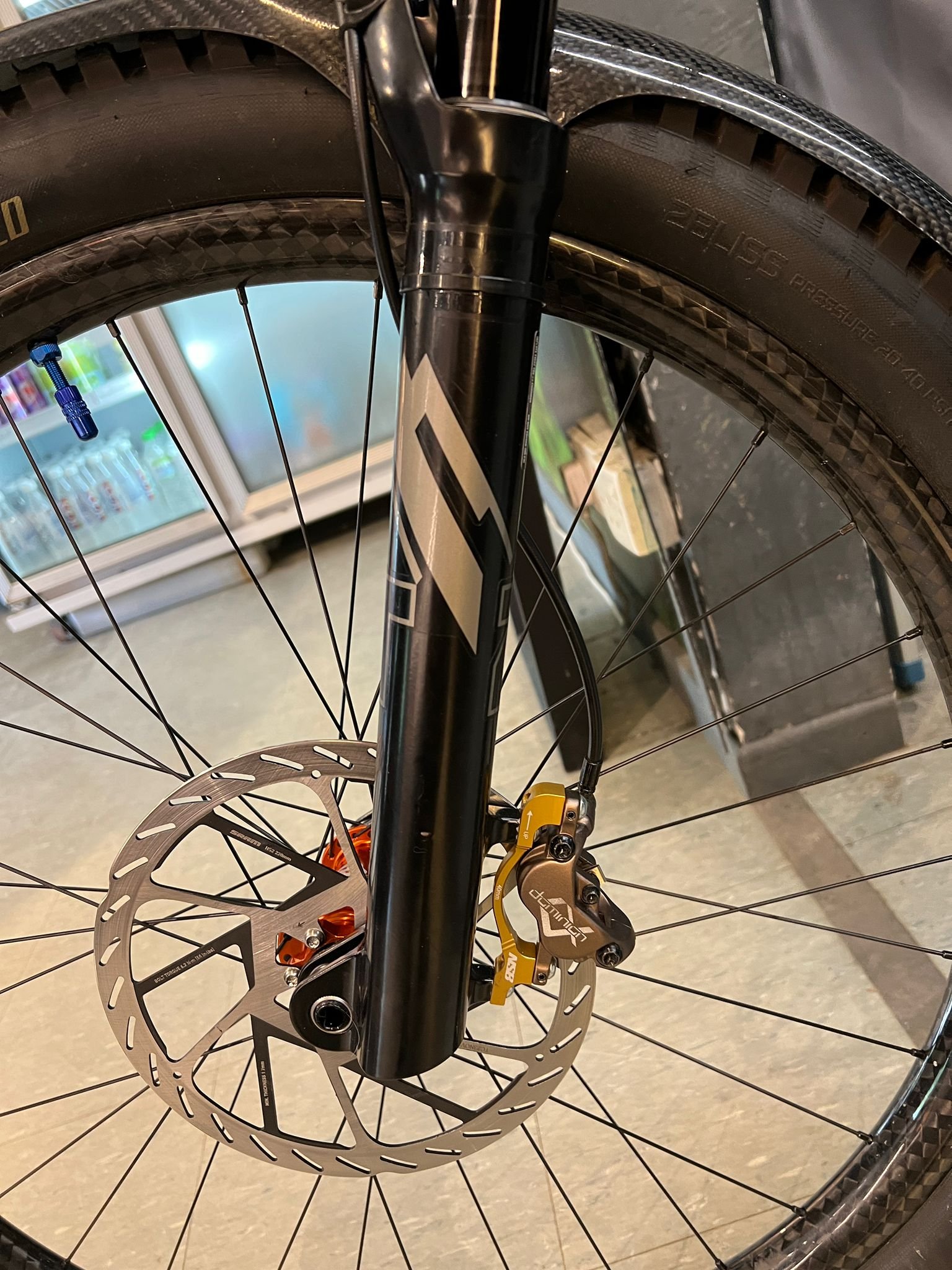

I'm looking to do this upgrade on my 2021 Kenevo using the stock Bomber Z1 fork. I've ordered a Sram Centreline 220mm rotor and a Hope HBMMN Mount M adaptor which fits: Postmount 160mm frame/fork for 200mm rotor + 180mm frame/fork for 220mm rotor which comes with 2 x M6 20mm bolts. Will upload pictures when the conversion is done.

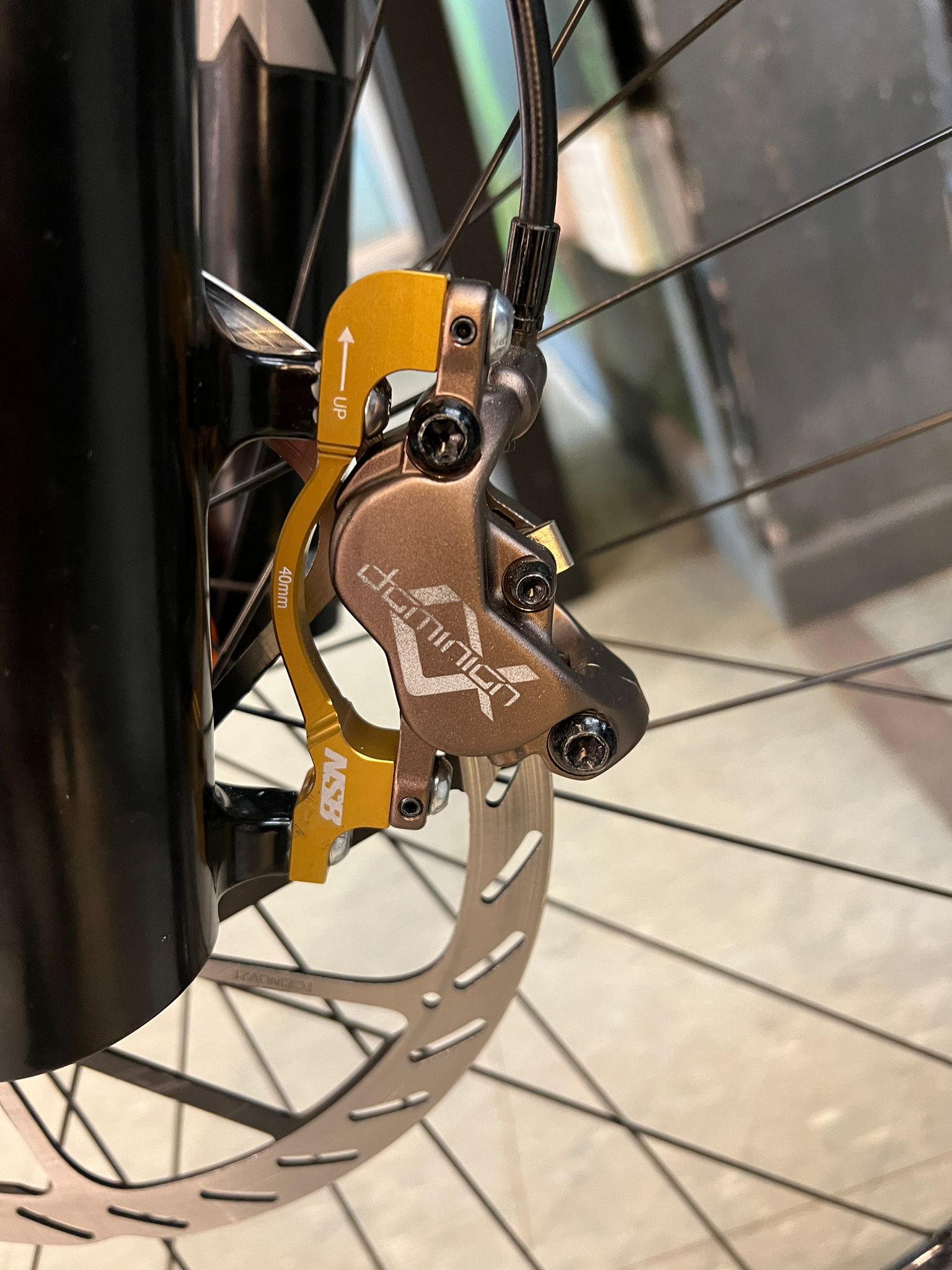

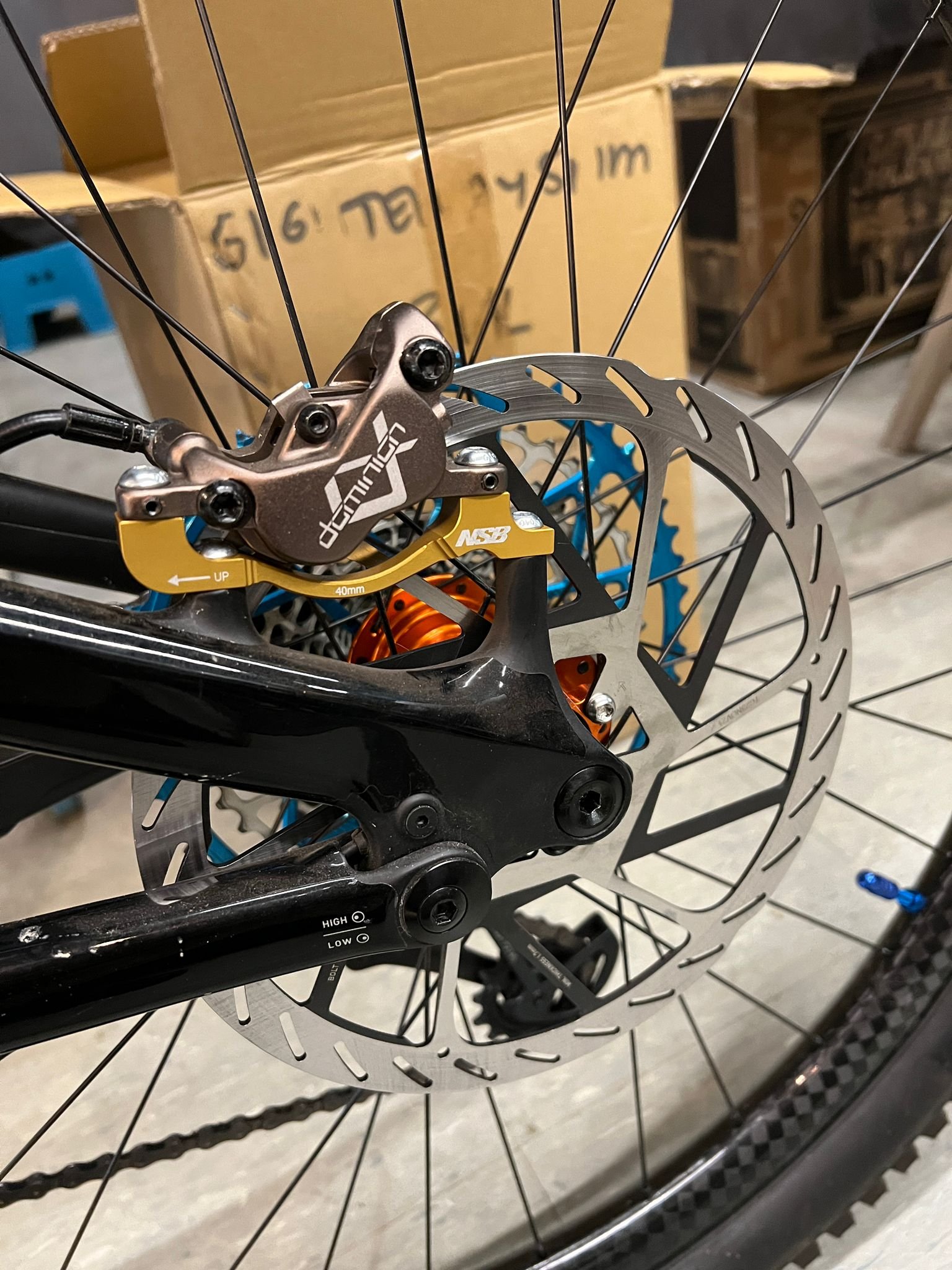

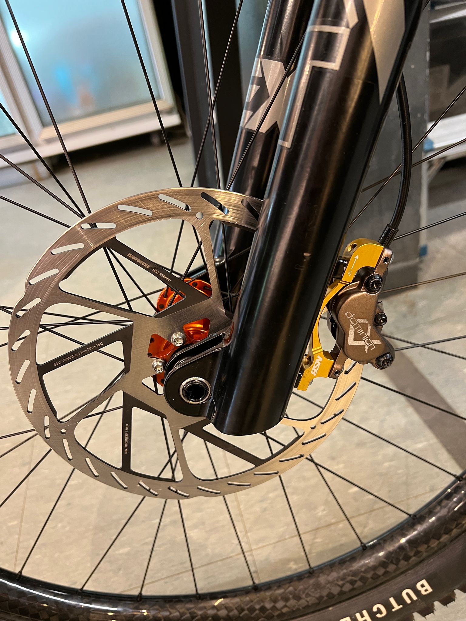

xiaochew
Feb 8, 2023
22
Singapore

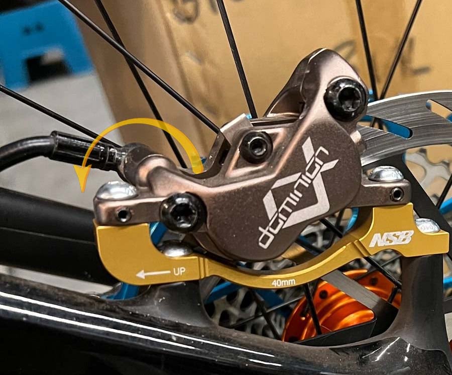

hi guys any hayes dominion a4 brake mount adapter for 220mm rotor . can advise me where to order. can't find on my site . pls help. tks
Recommended!
Do you know if this will work on my stumpjumper’s Sram code rs? Its comes with 200mm and idk what j need to bug for a 220mm rotor to work?

I have a 2020, Fox 36 factory fork, with SRAM RSC caliper, and 200mm disc.
I’d like a 220mm disc, but aren’t sure what adapter post I need, can anyone help please?
It currently has a bracket/adapter installed, but it doesn’t have any writing on.
Please can someone tell me exactly what I need to buy?
Thank you
salko
Aug 29, 2019
1,303
894
SLO
For this fork you need Postmount 40mm adapter if you want to mount 220mm rotors.
