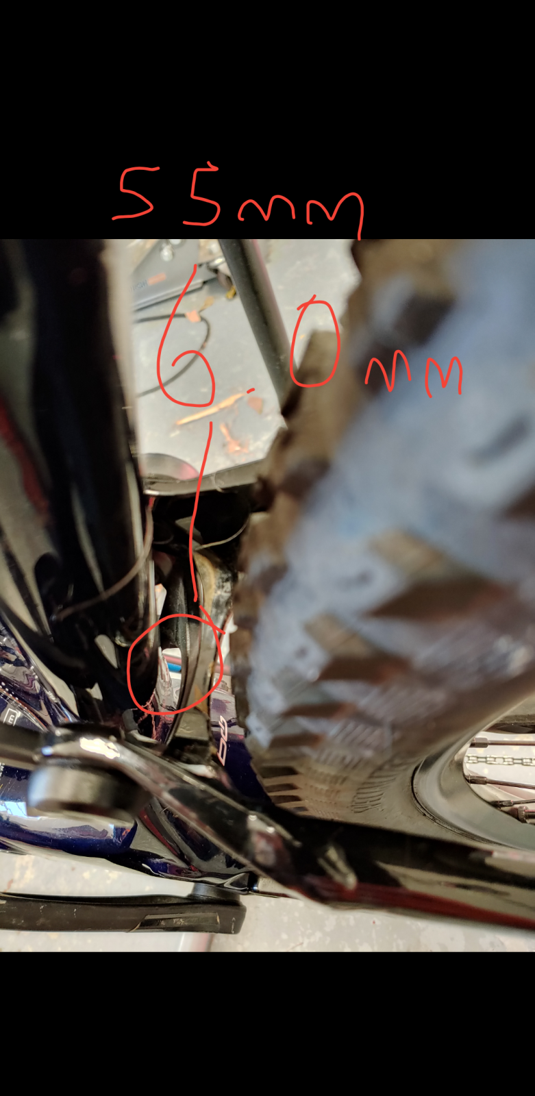

I will try and post pics. I have a 55mm DPX2 and am probably going to try the Cascade link. Both bikes in the following test are 2019 carbon comps. One was large and one medium, but I think the rear triangles and pivots are identical. The closest point of contact with the 52.5mm shock is 6.5mm. The 55mm shock should add 7mm of travel and the closest point of contact drops to 6mm. So my brain calculator says that another 8mm of travel from the Cascade link will put the closest contact point at 5.5mm. All I have to worry about is the chain. It should work fine. Tire rub is not even close.

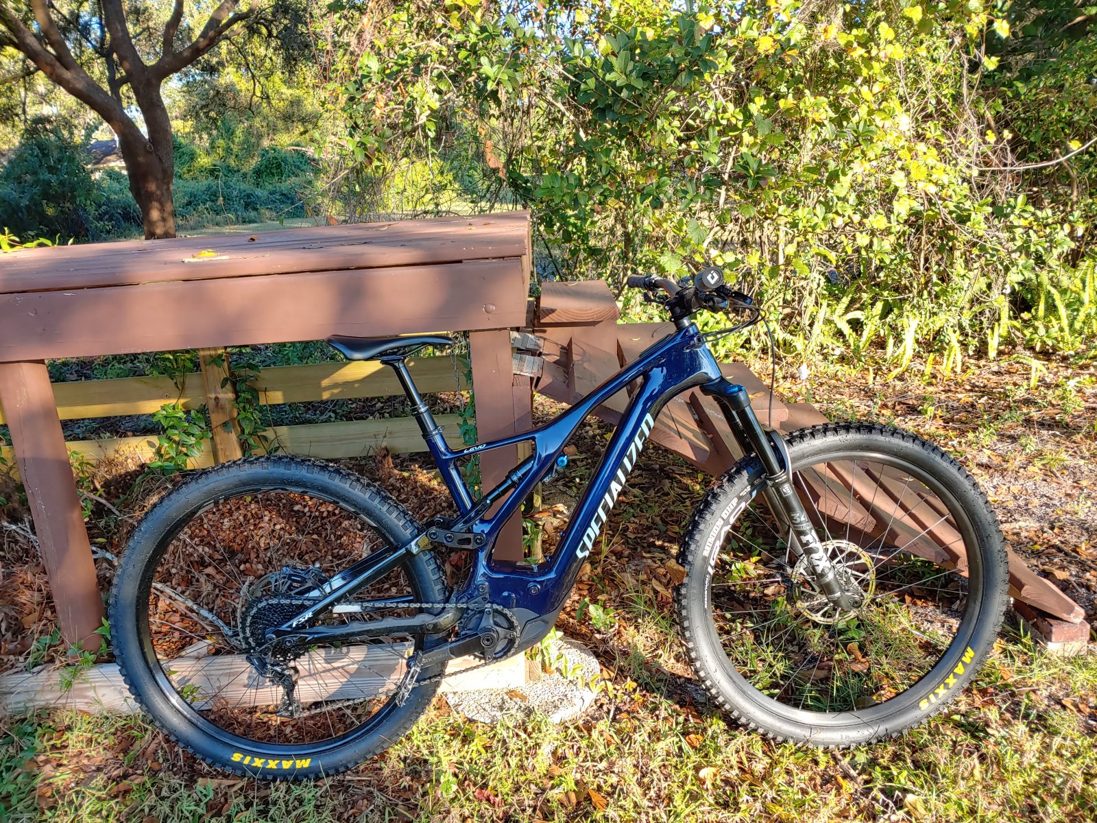

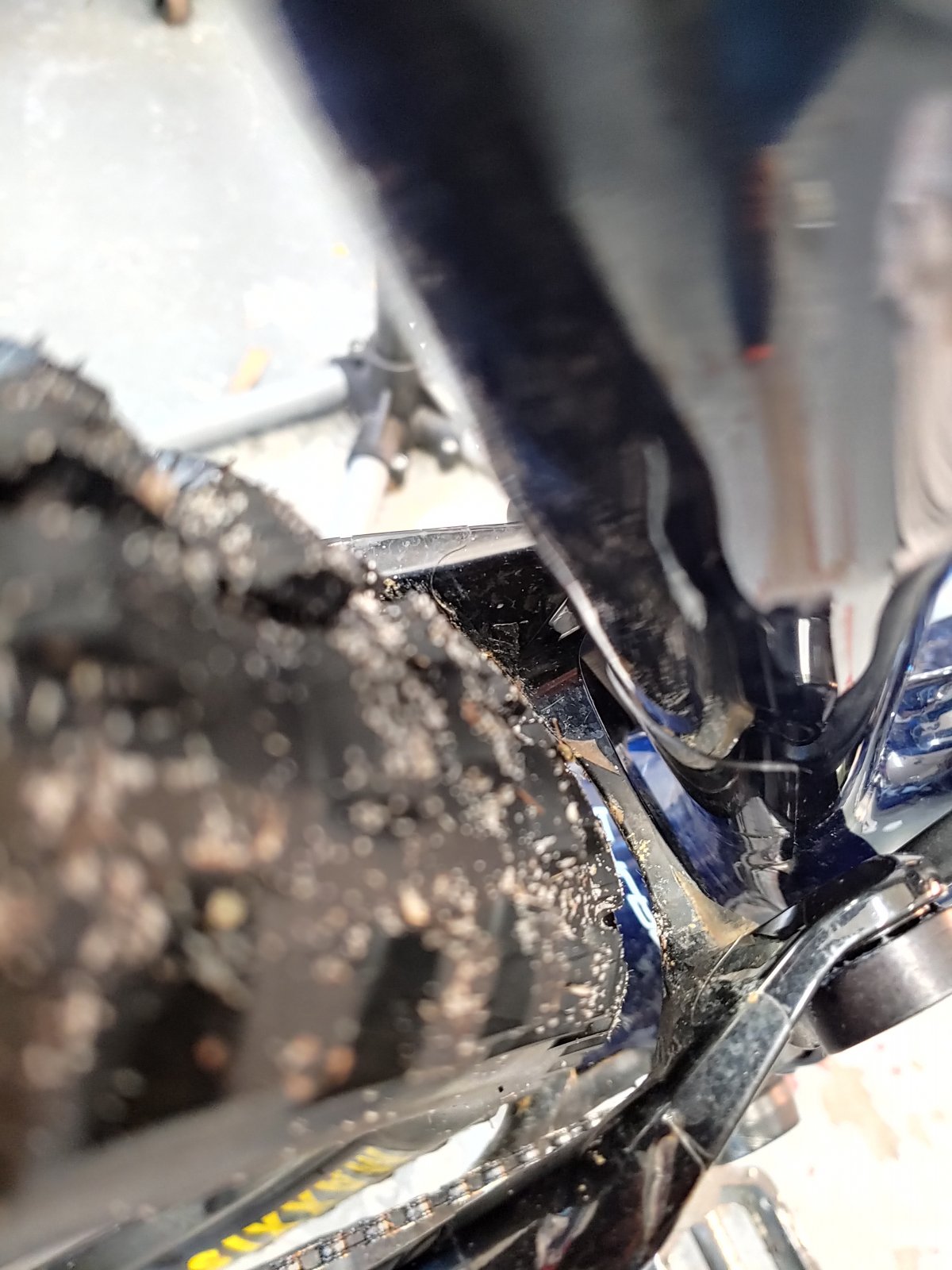

Got the Cascade link on. The website said the black link was backordered, but I got it in a week. No clearance issues with the 55mm stroke DPX2 in the low (slack) position at either end of travel. Chain is plenty long enough also. Looks and Quality are better than the stocker.

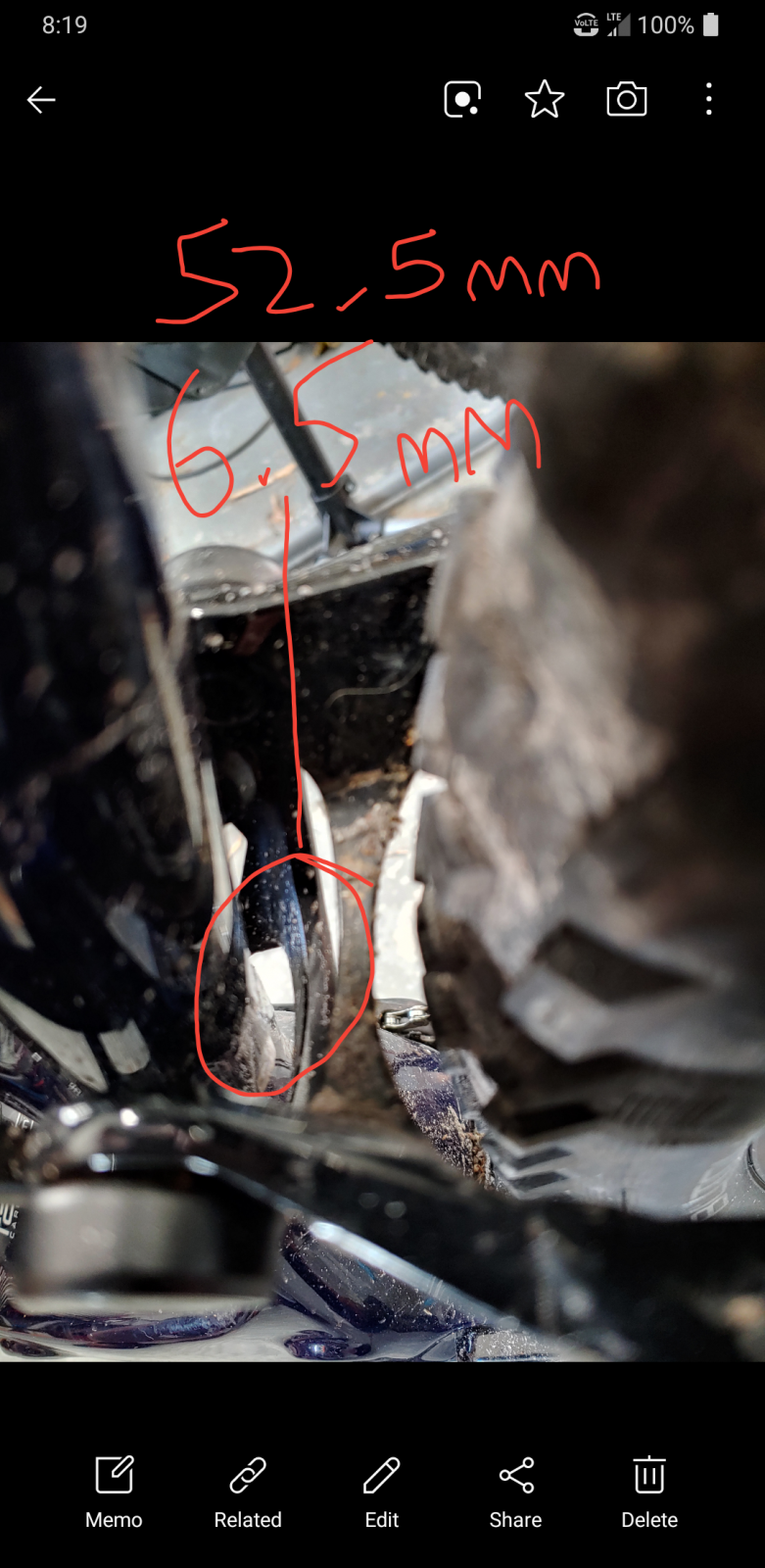

Here are my travel measurements. I know they are not accurate, but it will give you an idea of the difference. I measured axle movement perpendicular to the floor. BB height and Head Tube Angle did NOT change from my previous measurements.
Stock 52.5mm = 146mm
55mm Stroke = 149mm
55mm + Link = 154mm

No big test ride. Just my "back yard North Shore"..... Give me a break, I am in Florida.
I usually just barely bottom out if I land flat off that big one, but I did not with the link. I still had a few mm on the o-ring. I will have to take it for a big ride, but I was happy just to get more travel. Easier on my broke and poor ankles and knees!

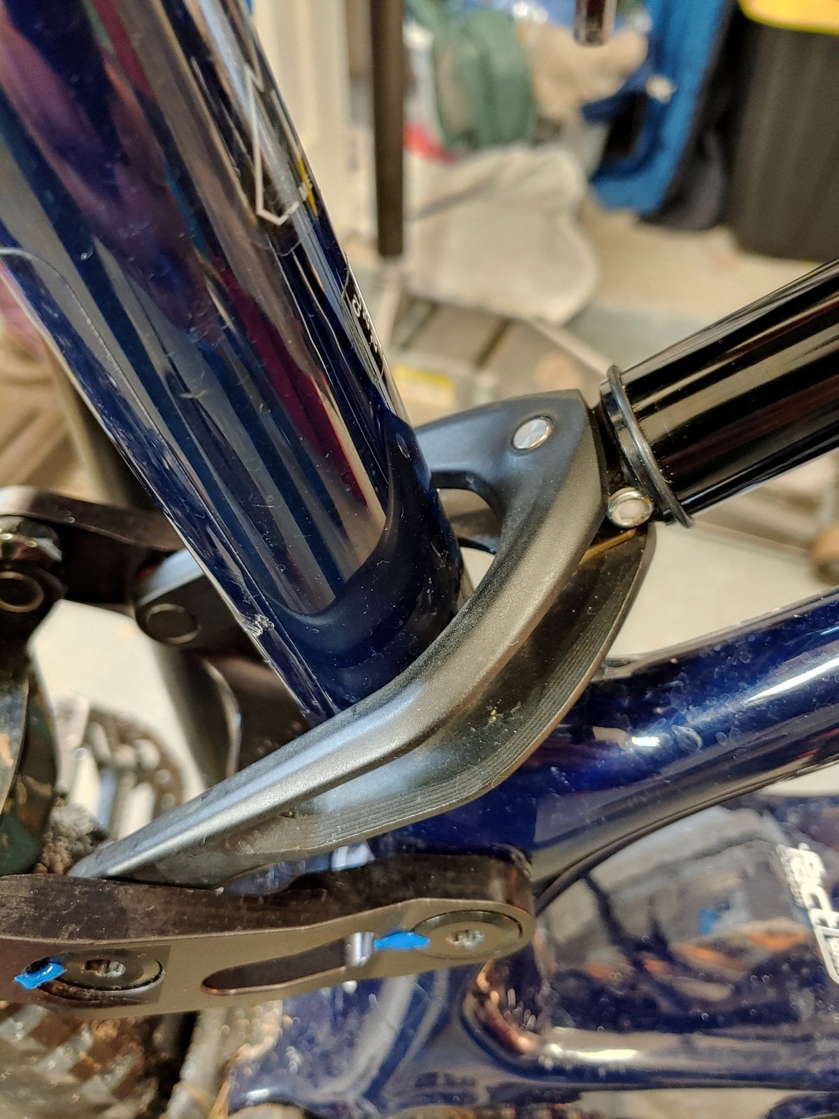

I added a neoprene "shield" to keep rocks from getting stuck between the Cascade link and the seat tube and causing damage. I figure if the happened Specialized might not be too keen on a frame replacement

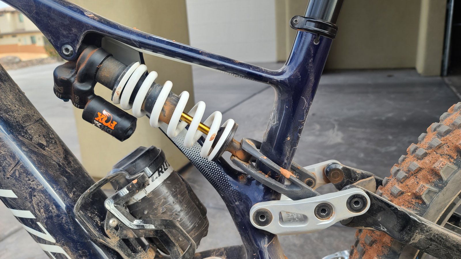

I have a 210x55mm DHX2 with a CC progressive spring and a cascade link with my Medium Levo comp carbon in the high position(27.5Rear). I went from bottoming out with my compression settings at 8HS 9LS (from full open) to no bottoming at 4HS5LS. So plush, and the rear end sticks to the ground like glue. (Edit)I've been experimenting a bit and my shock is now at 3LS 0HS. slight bottom out on a rough trail. So good!
