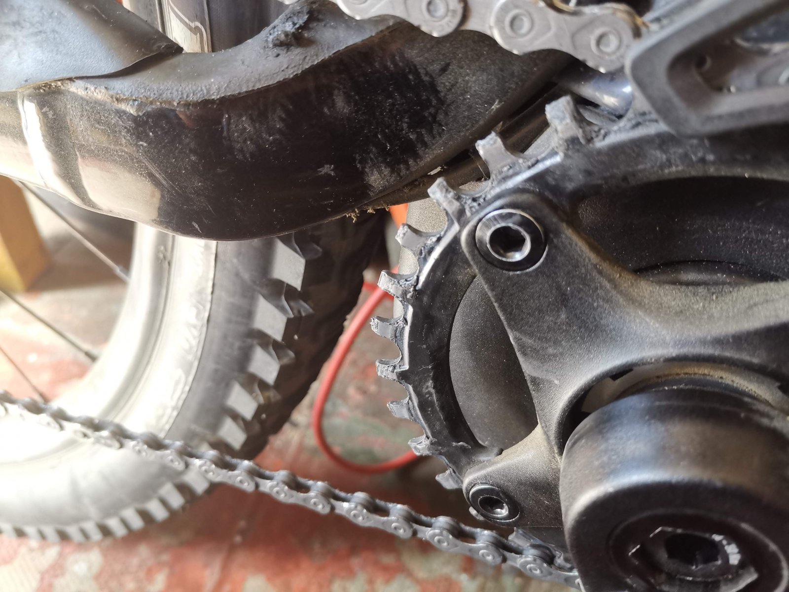

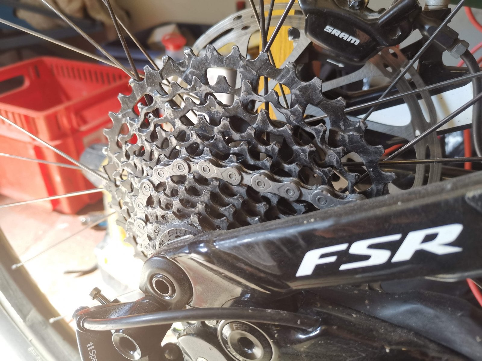

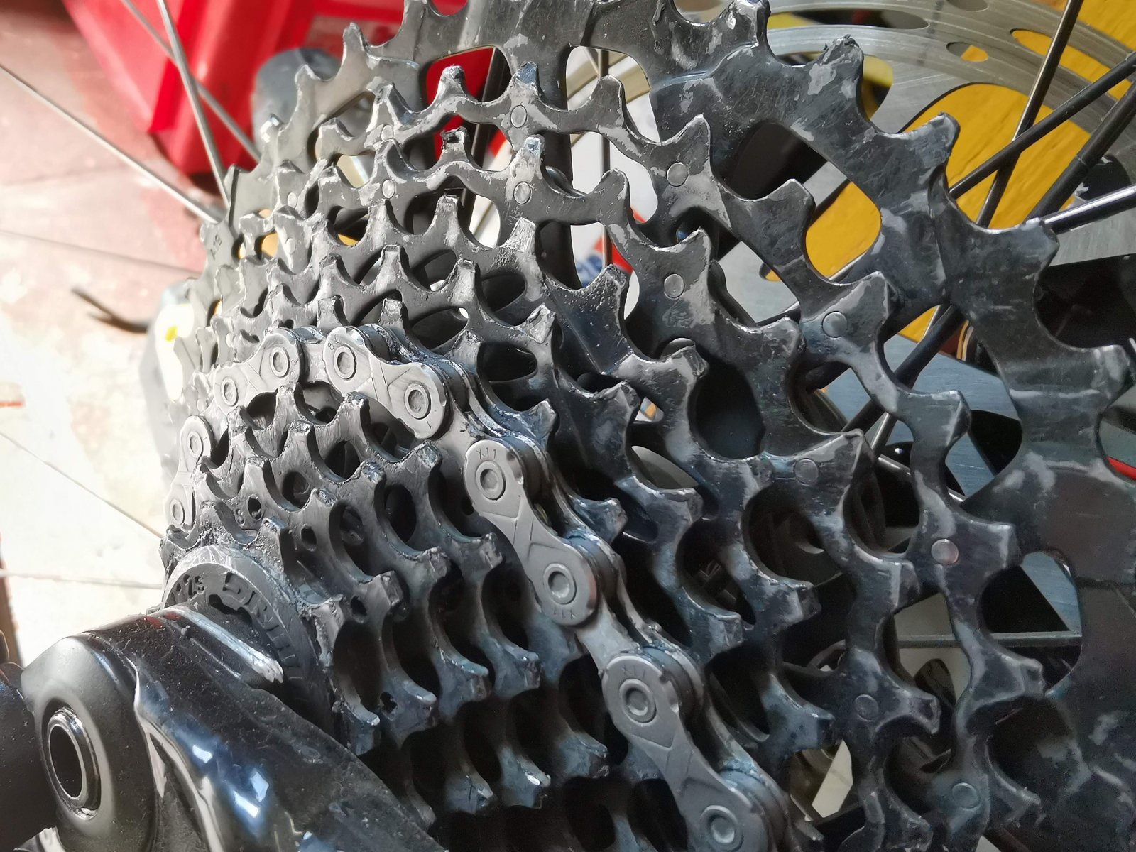

I have attached some images of my cassette and chainring, do any of you consider these worn enough to need replacing?

If it is only doing it in the smaller 2-3 cogs in the rear, it may also be that the freehub body is damaged. That's not uncommon on eMTBs. The cogs actually chew away the freehub body material and start to spin/slip under load.

It will 100% be the cassette has worn to much to put on a new chain without skipping.
It normally skips on the smaller cogs as they are the ones you generally use the most and they have a smaller surface area to hold the chain.
Just put the old chain back on and ride it till it dont work anymore, I did this with my levo and got about another 1500miles out of it.

The chain doesn’t bed in, the chain prematurely stretches if you use it with a worn cassette (or front chainring)... because it is forced to conform to the elongated and worn cassette tooth profile. And that will cause skipping because the chain (when new) cannot properly sit into the worn tooth profile.

One new factor today... the high eBike torques produced (motor plus pedal force) will accelerate drivetrain wear. Ideally is to use the drivetrain as long as possible until it is worn and starts to give issue.... then change the chain, cassette and front chainring so as to maximise the life of the new drivetrain. By replacing just one component on a worn drivetrain, you will just prematurely wear that new component.
