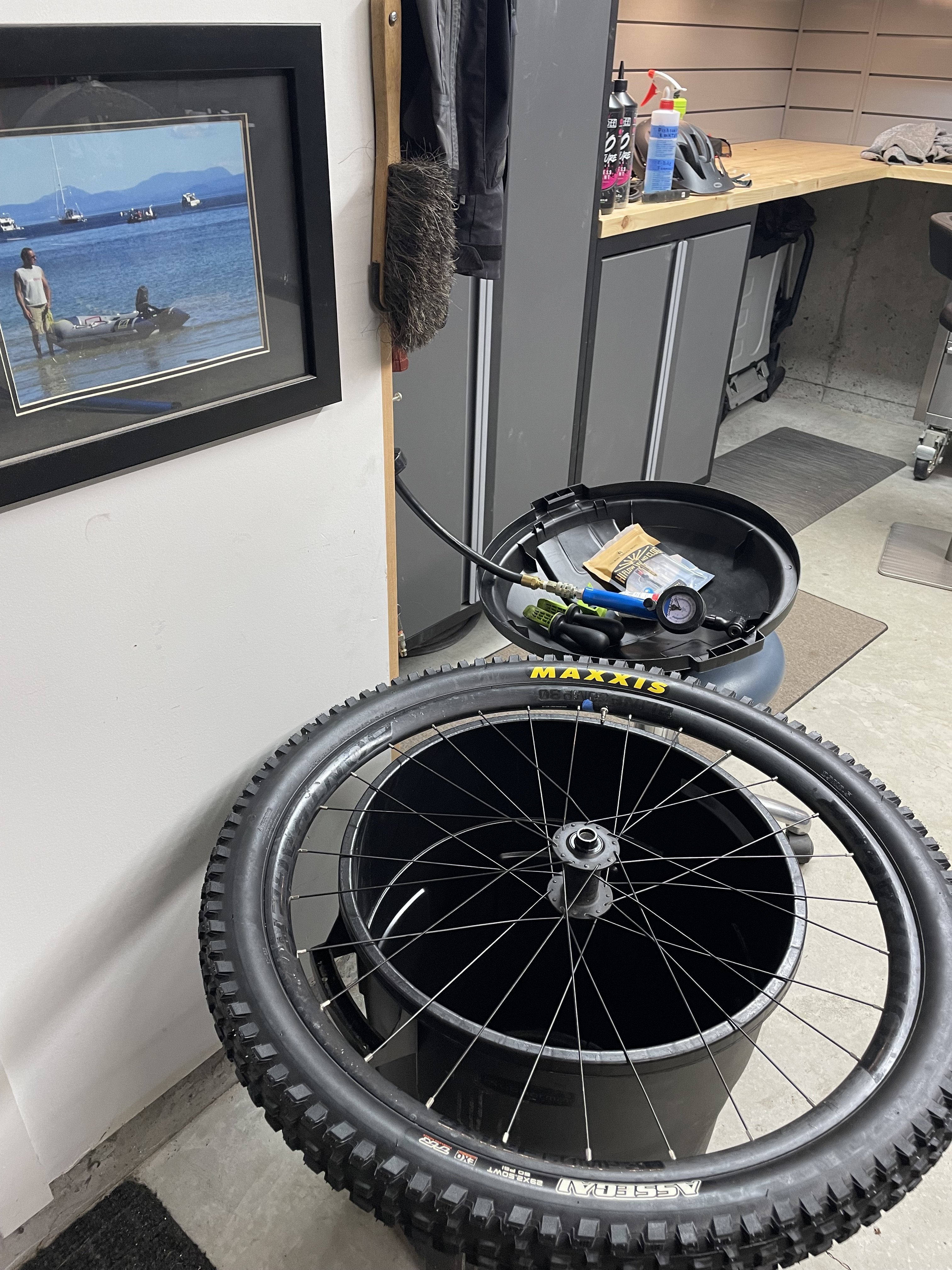

I have a special wheel and combination tool holder for those new tire/CushCore days. I don’t think anyone else has this specific model and colour in our circle of eMTB’s. When not in use it can be used as a container. 😉
