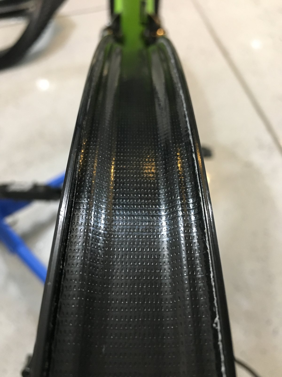

I made a mistake last year when I removed my rear tire by jam the tire lever too deep and broke the original rim tape. I was in a rush so I clean the rim, grabbed the Gorilla tape and applied one layer with about a feet overlay.
It was holding air fine until I removed the tire again early this month. The stan's sealant I use penetrated the tape (the oily stuff) and mojority of the tape lost its stickiness and got pushed into the middle of the rim, and I got sealant in almost all my spoke holes.

;)Maybe “rush” isn’t a good word to use. I had plenty of time to work on the rim that night, and I by “rush” I mean I want to ride the next day so no time to buy online or go to LBS.
I scraped dried sealant off the rim and wiped with degreaser. I measured the tape width against old tape and applied quite bit pressure when wrapping and press it firmly around when finished to make sure it stick to all the surface and crannies. When mounting the tire I also make sure the bead not pulling off the tape. Here is that it was looks like before, I didn’t take a picture to show after.

The tape I used wasn’t as wide as that, 1 1/4” I believe. The tyre bead seats on the rims rather than the tape. Hopefully that will make it easier to get the tyre off without damaging the tape, hopefully.
