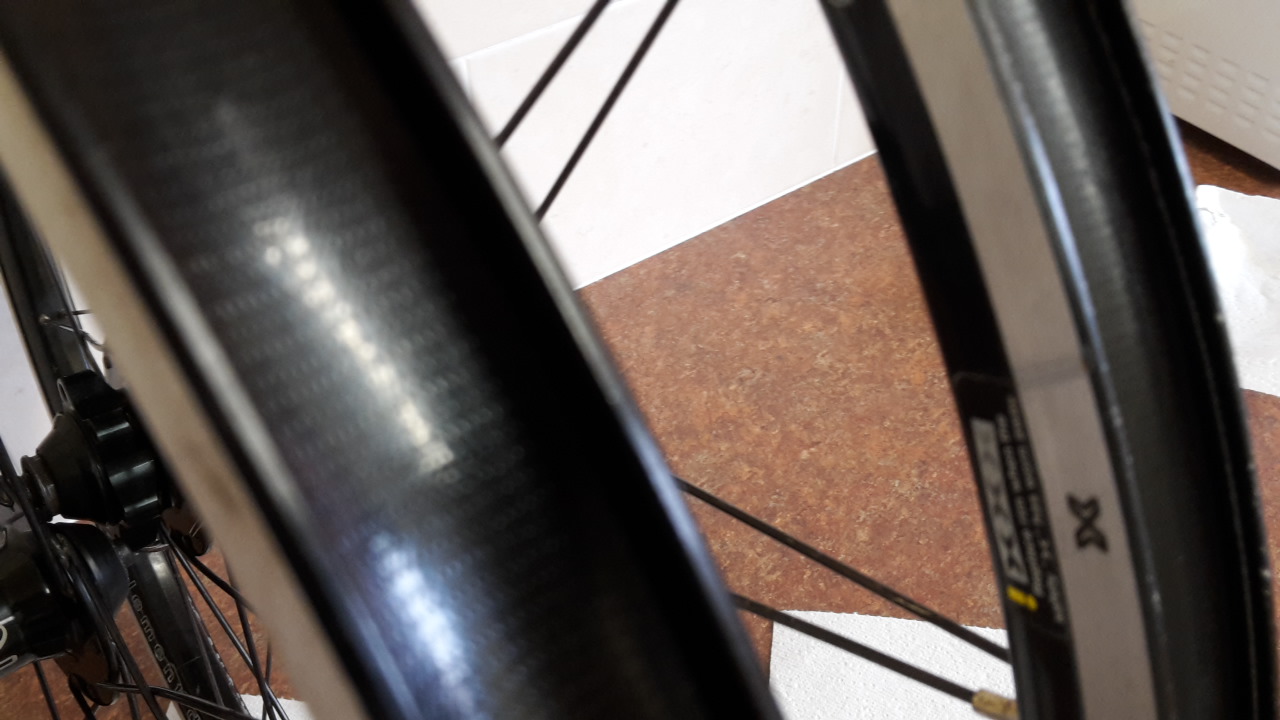

That's the stuff!
It comes in all sorts of colours, but get the black stuff with the woven finish.
Why? because it looks like carbon fibre and looks fantastic when its on! :love:
OK, nobody but you will see it, but you know it's there!
