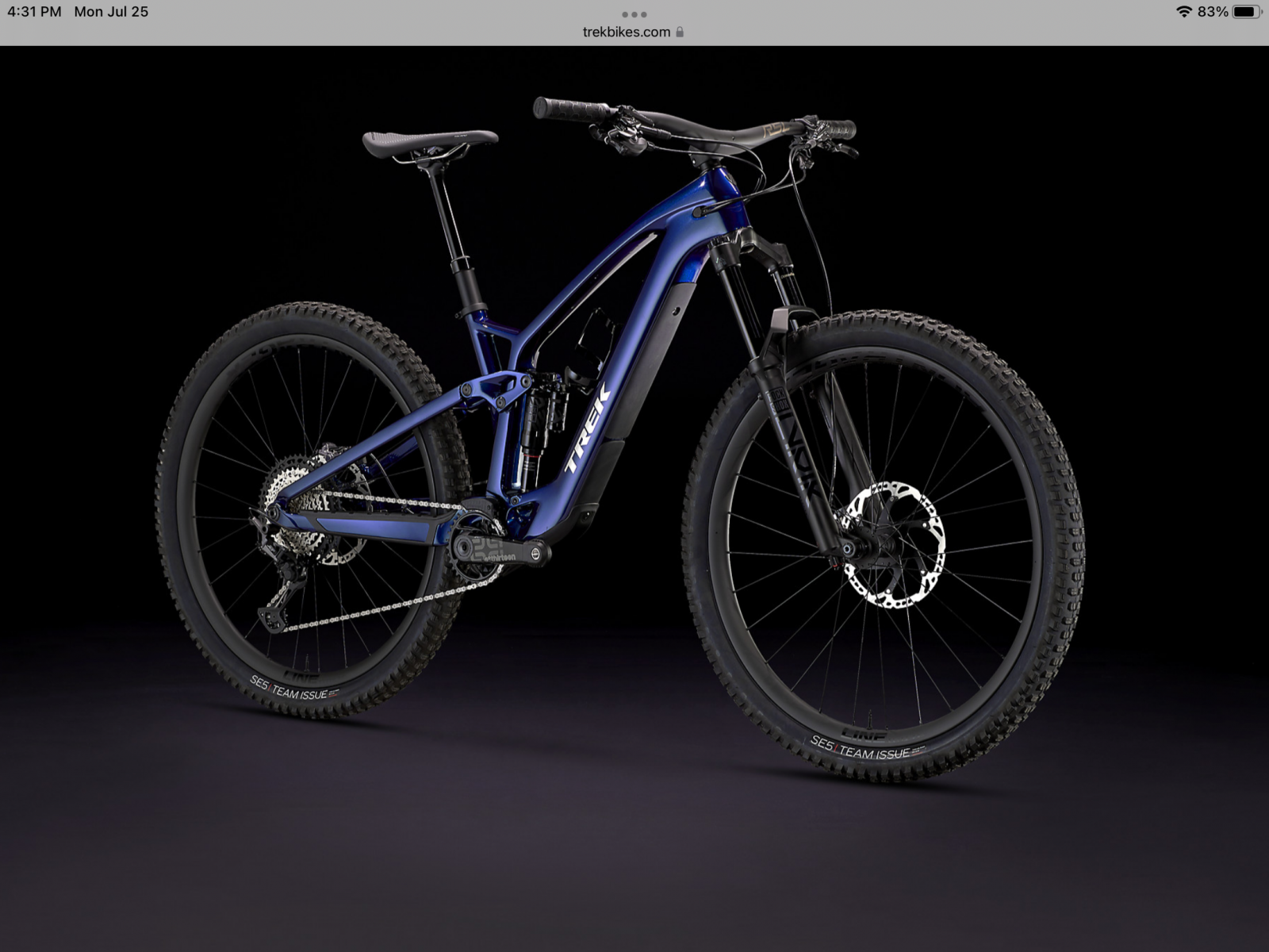

Just put a deposit down on a 9.8 XT that will be here in November. It is the blue one. I’ll be selling the entire XT drivetrain as I’m going to run an AXS drivetrain with the XX1 cassette. I think I’ll be able to keep this at about 40 lbs ready to ride. Can’t wait to ride this bike.

I ran the XT cassette on my Rise. It shifted great, but didn’t last very long, I’d say somewhere between 550 and 700 miles. I’d rather sell the entire XT drivetrain and run the XX1 cassette and chain from the start. I‘d like to see what kind of miles I can get out of the XX1. The XT broke a tooth with several others worn too much. I am easy on my drivetrain and shifting.
I am really waiting to see the new Shimano EMTB specific 11 speed Linkglide. I think 11 speed would be perfect on an EMTB and should be easier on the chain and cassette. Weight savings too. If that is good, I’ll run that eventually.

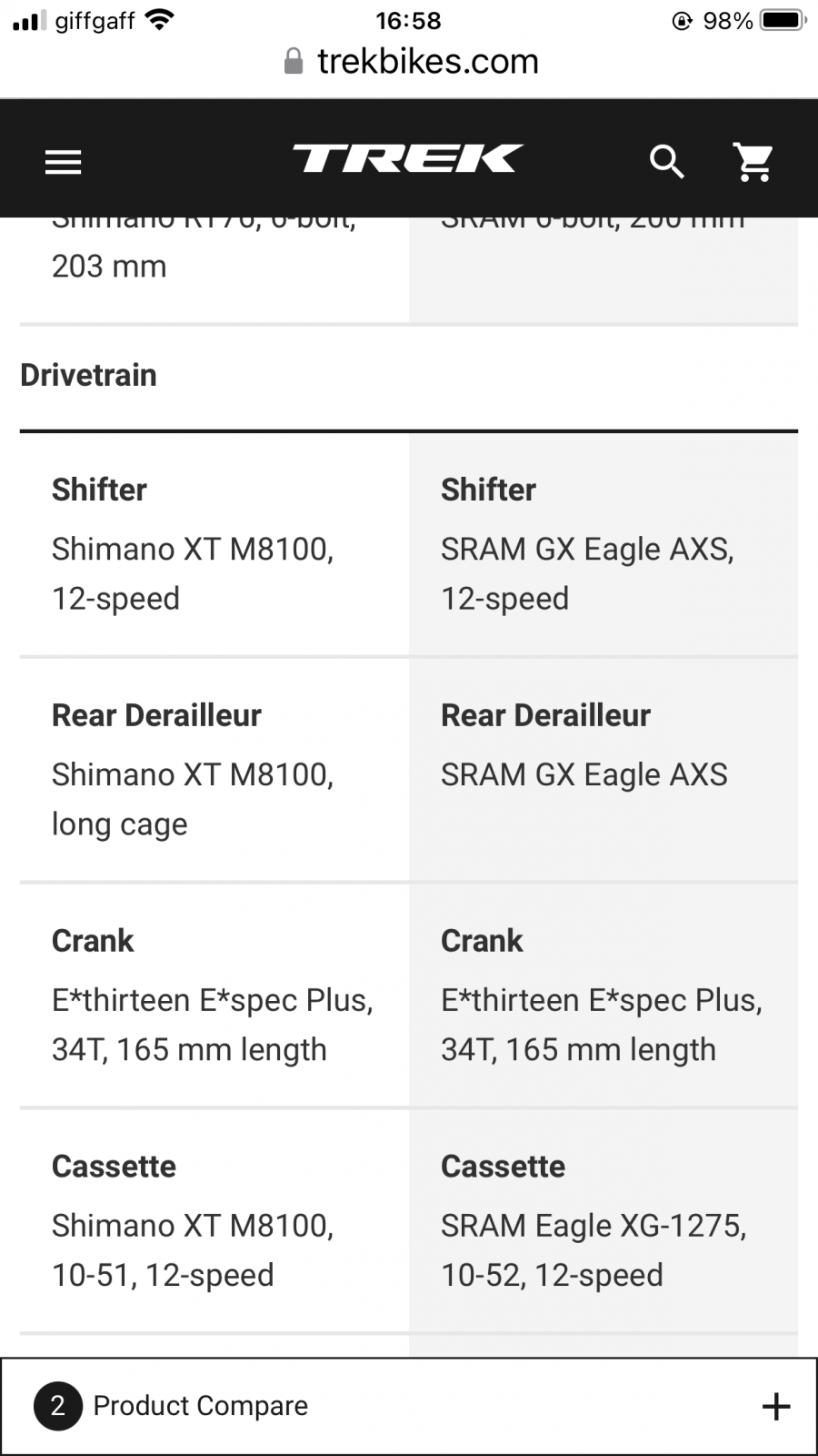

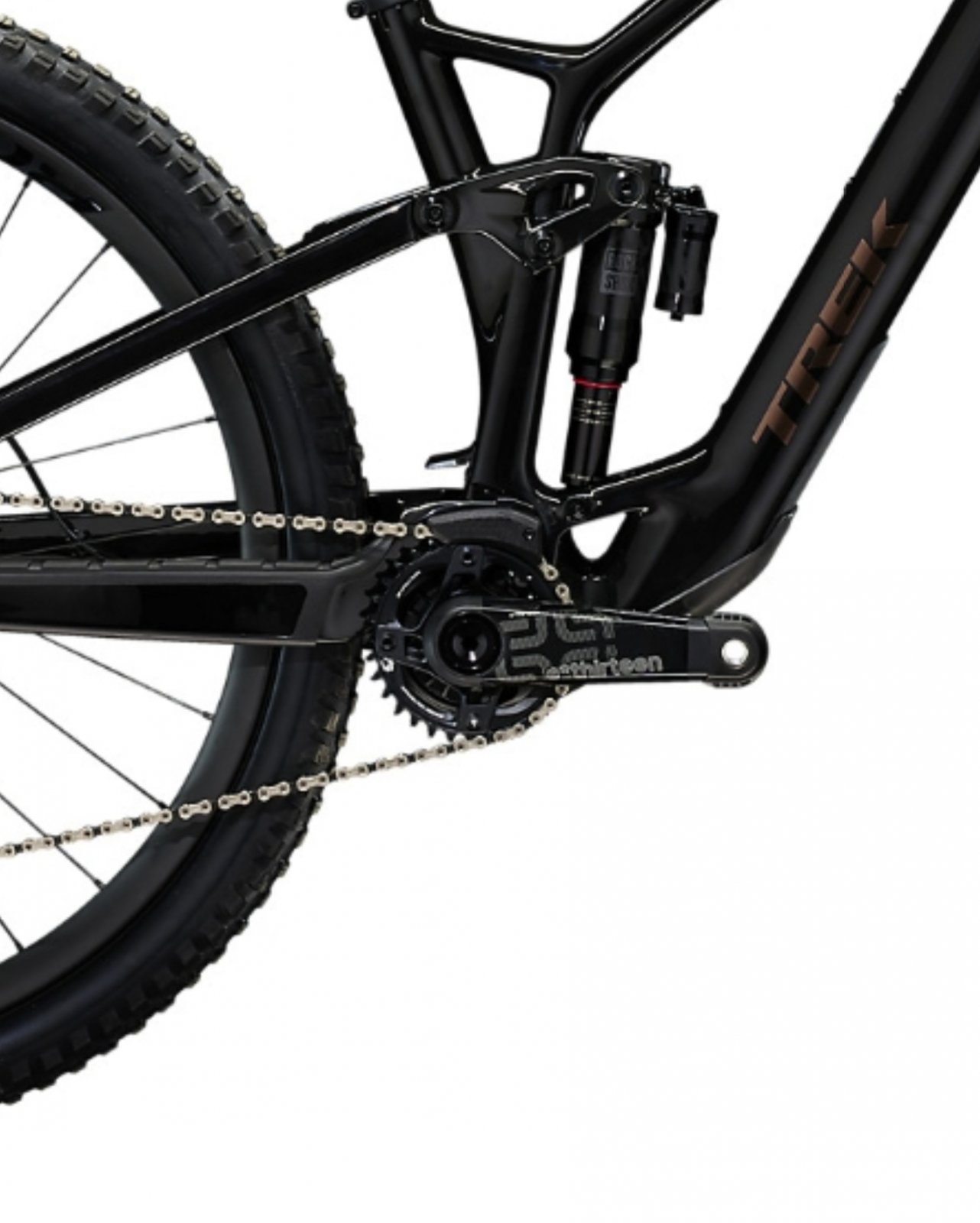

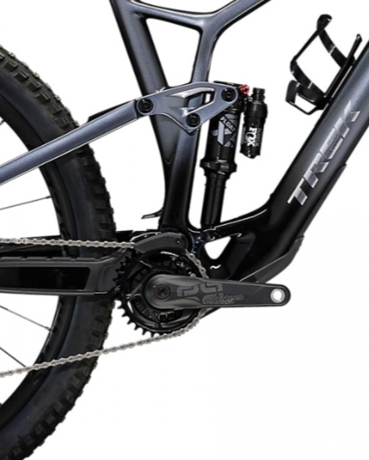

If you look on the Trek website and look at the EXe with the Shimano drivetrain the chainring is definitely different than the one on the Sram equiped models.

IME is a load of marketing BS. I've run SRAM and Shimano chains on SRAM chainrings without obvious issues.
Right? I am doing that right now on my bike. I'm just curious why Sram comes with a different chainring than the Shimano builds. Is that typical? That Rails I have purchased have all been Shimano with the E13 chainring. So, not sure if the Sram built Rails have a different chainring. I'll see what they have to say and can always just change it myself.
Are you sure? According to the Trek UK website, all the bikes run the same E*Thirteen E*Spec Plus, 34T, 165mm length cranks and chainring.

Yes, I'm sure. On the US website it doesn't even list the chainring for the Sram builds, but lists the E13 for Shimano. You can see the differences in the pictures. The top, grey bike is the Shimano.

Fair enough. I have used both chainring styles on my Rail, with both Shimano and SRAM chains.
