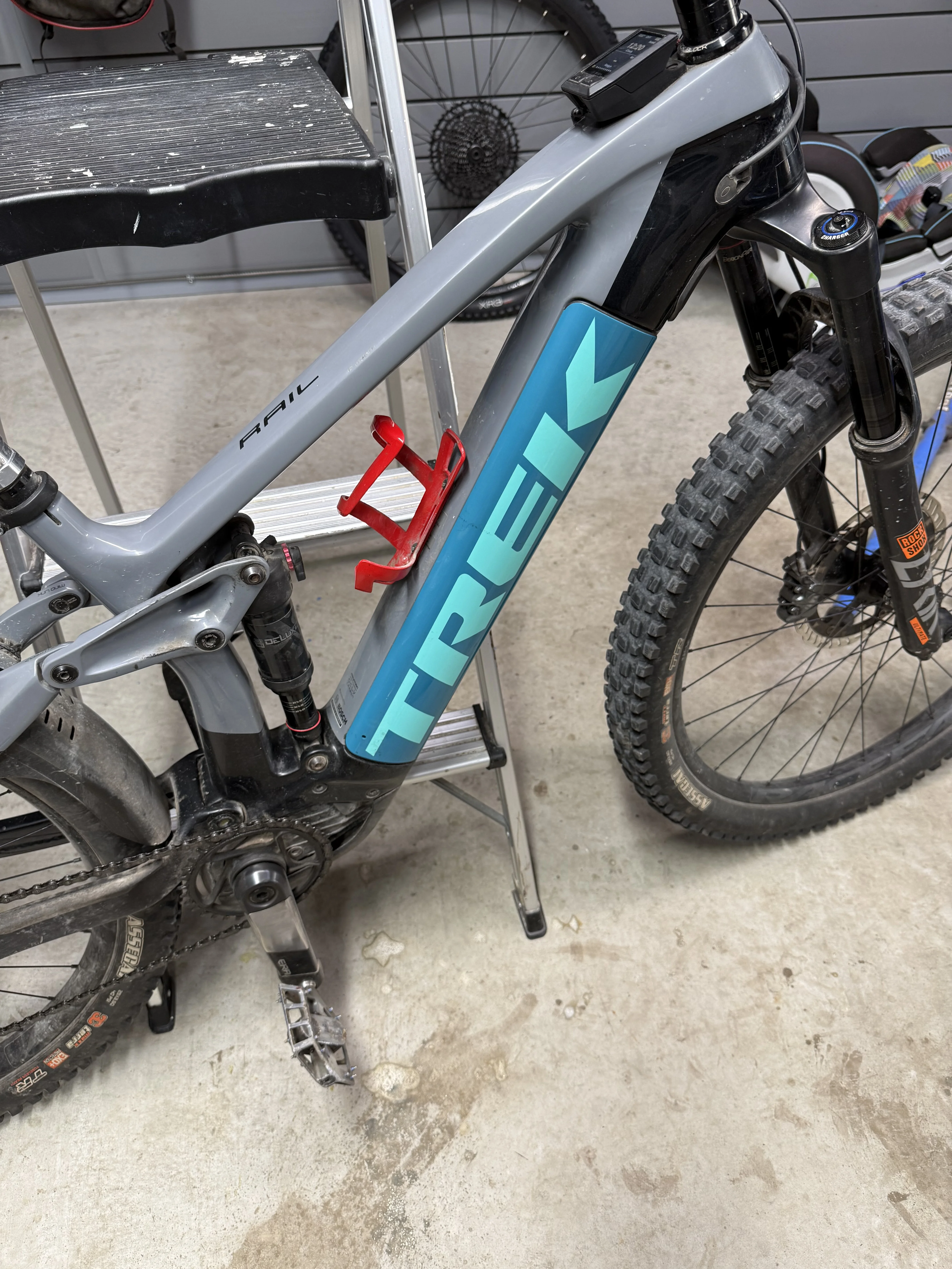

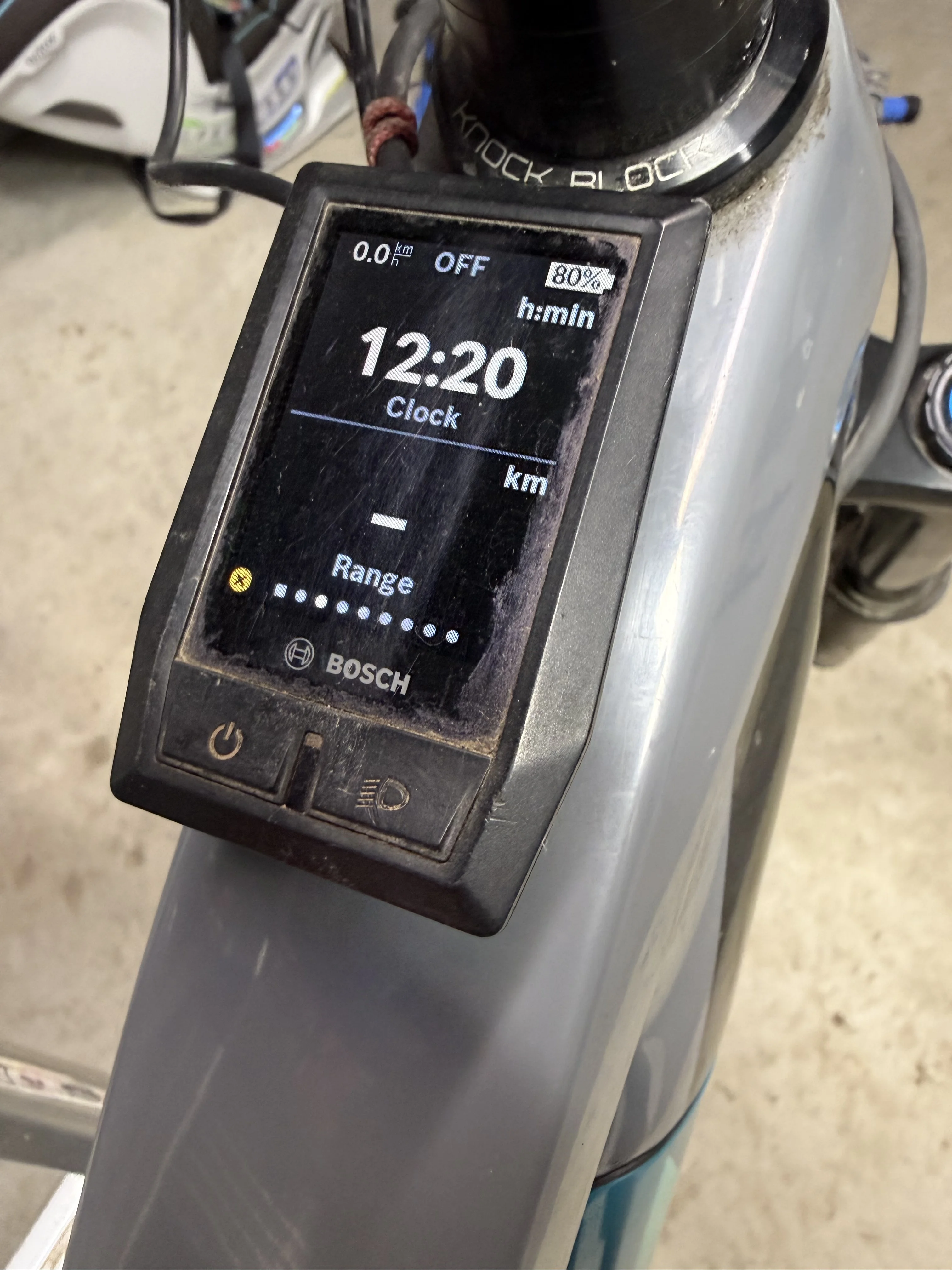

Did a battery swap on my Trek Rail 9.7 this morning. Took out the 650wh battery and tried a 500wh. What A Difference …wow! Less than 20 kms but with steep climbing and gravity back home.
80% battery left. I couldn’t believe it.
I’m thinking …things are gonna change. This tank felt like a SL. Fast and nimble.
Find the same when install the 500Wh batteries our bikes originally came with, completely changes (improves) the handling.
Isn't only due to the 0.7kg weight reduction from the 3.5kg 625Wh battery to the 2.8kg 500Wh battery, is also due to the weight being lower down and further back.

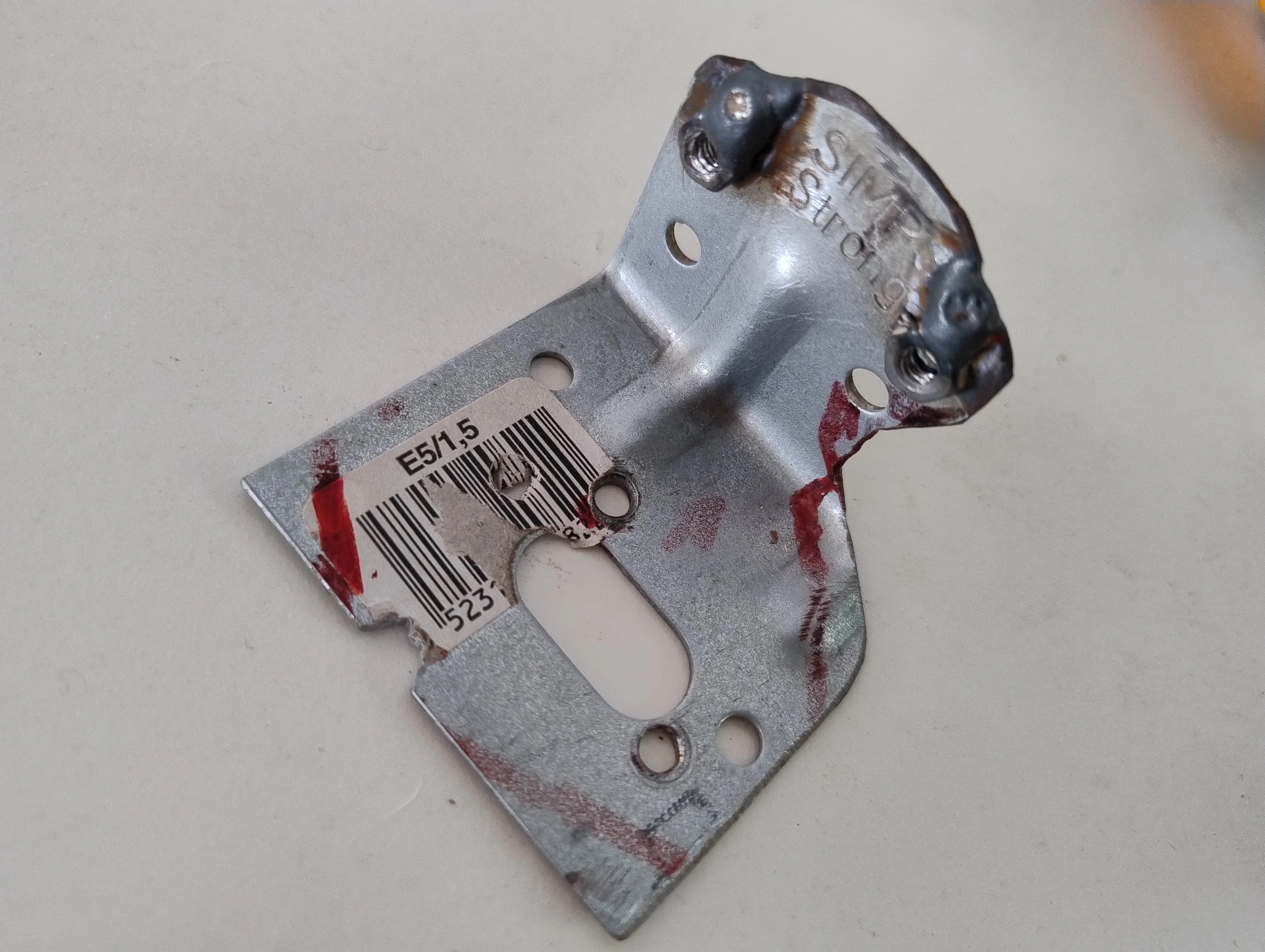

When I removed the lock over a year or more ago I don't think Rolph was still selling the 3D printed adapters that irie bought. I just made my own from a right angle steel plate that you can buy from a DIY store and then welded on some nuts to take the two frame bolts. I glued a piece of inner tube around the end that bolts into the frame which serves to fine tune the gap between the battery cover and the frame hole. I recall that someone on this forum was also making the same kind of piece from thicker aluminium, but that was quite some time ago so I doubt if he's still producing them.
This was a prototype I knocked up to test the dimensions and fit. The plate with the label attaches to the end of the battery. If you're a handy DIYer it's a fairly simple job. This was for a 625Wh battery, so you'd need an extended version to take the 500Wh. Hope this helps?
Or use a spacer to extend the 500Wh battery to the same length as the 625Wh. Is what I did because our Rails came with 500Wh batteries and spacers. Might be Trek part number W582323
