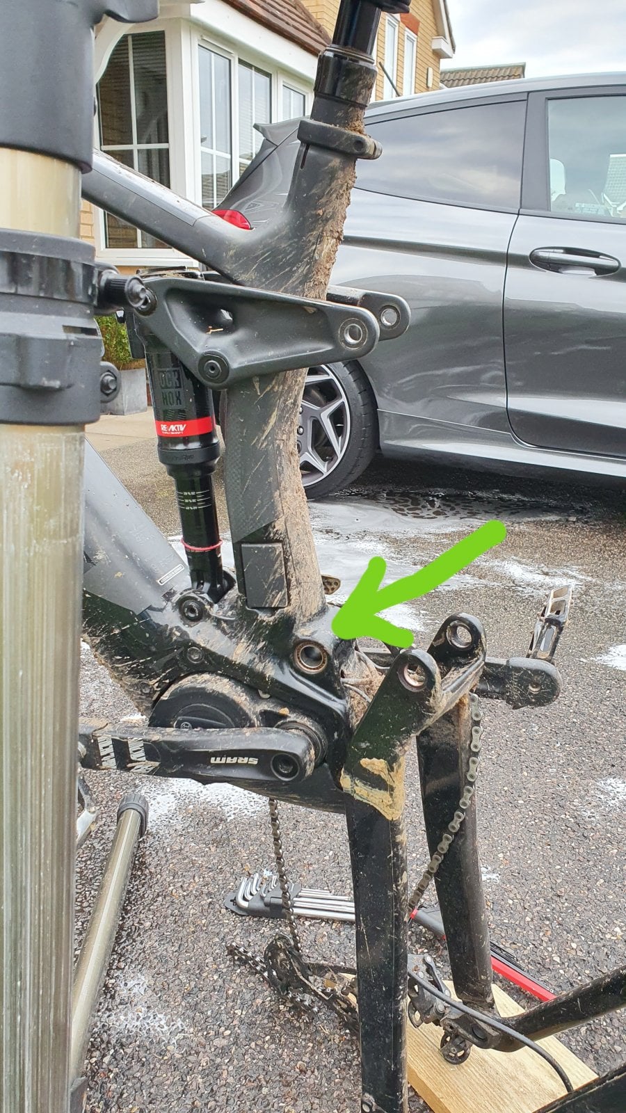

Hi all anyone replace the bearings on their rail. Mines a 2020 rail 7 and there's play developing in the back end can't quite work out where it is.
Also how the fu@k do you get mino link bolts out mine will not come out so i can't check of it's coming from there or main pivot.

Replaced mine recently, the wear on mine was from the main pivot bearing.
The mino link bolts just pull out, there is nothing holding them

I thought that might be the case can you remember what size bearing it was only really need to replace that one
Paul Mac
Jul 9, 2018
997
1,046
Uk
3803-W
It's the 10mm wide one.
