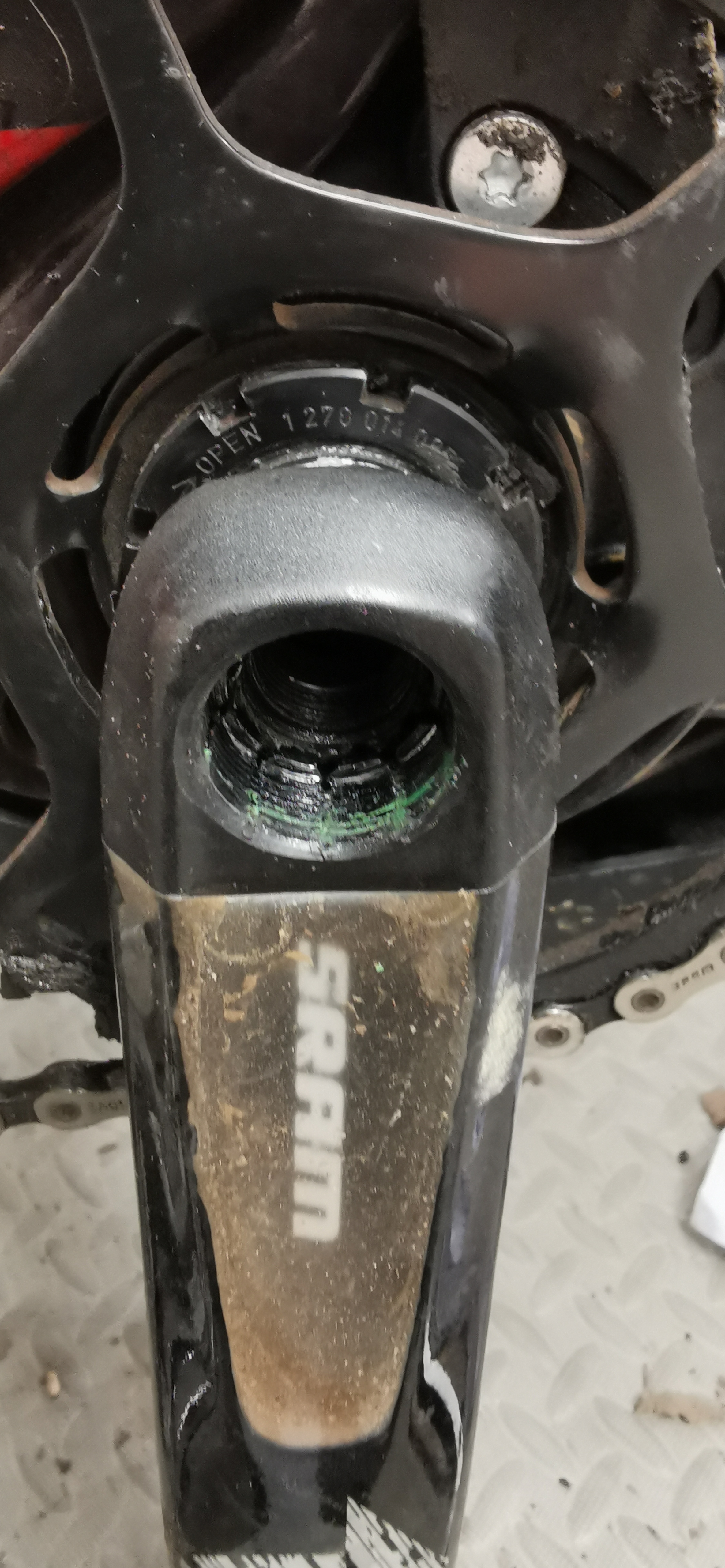

I already have that one it doesn't work as the middle of Crank is hollow the that tool as nothing to push against

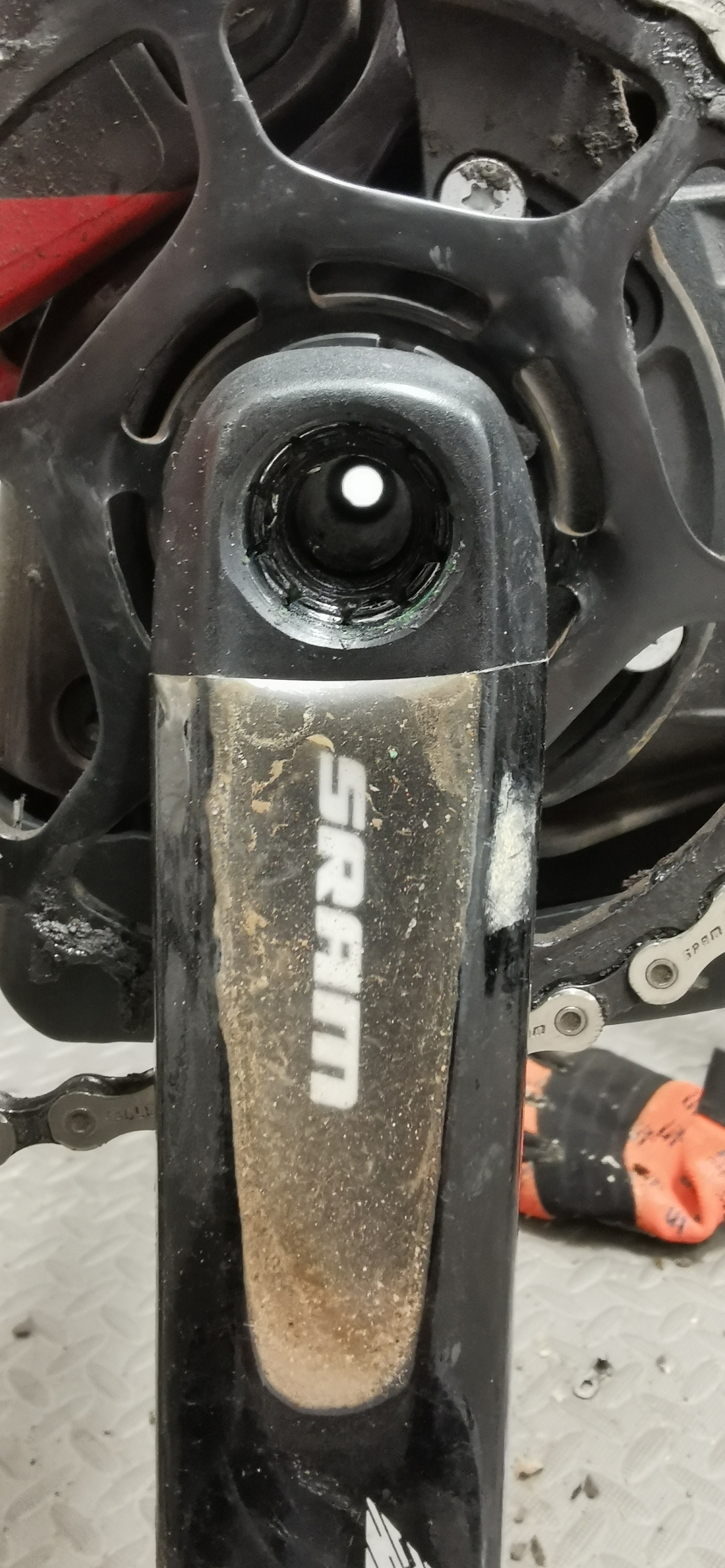

Some of those style crank pullers have two ends for different spindles. The small diameter end is for older square taper bottom brackets, and the large diameter end is for spline spindles.
If your tool only has the small size you can use an insert such as the shimano TL FC-15, or you can improvise with an appropriately sized low-profile bolt (choose one that won't push into the internal threads) or maybe a coin of the correct diameter (the TL FC-15 is 16.5mm).
The E-13 cranks on the Rail 9.8 are 6000 Al and pretty soft. I find that they come off pretty easy.

This it what the crank looks like

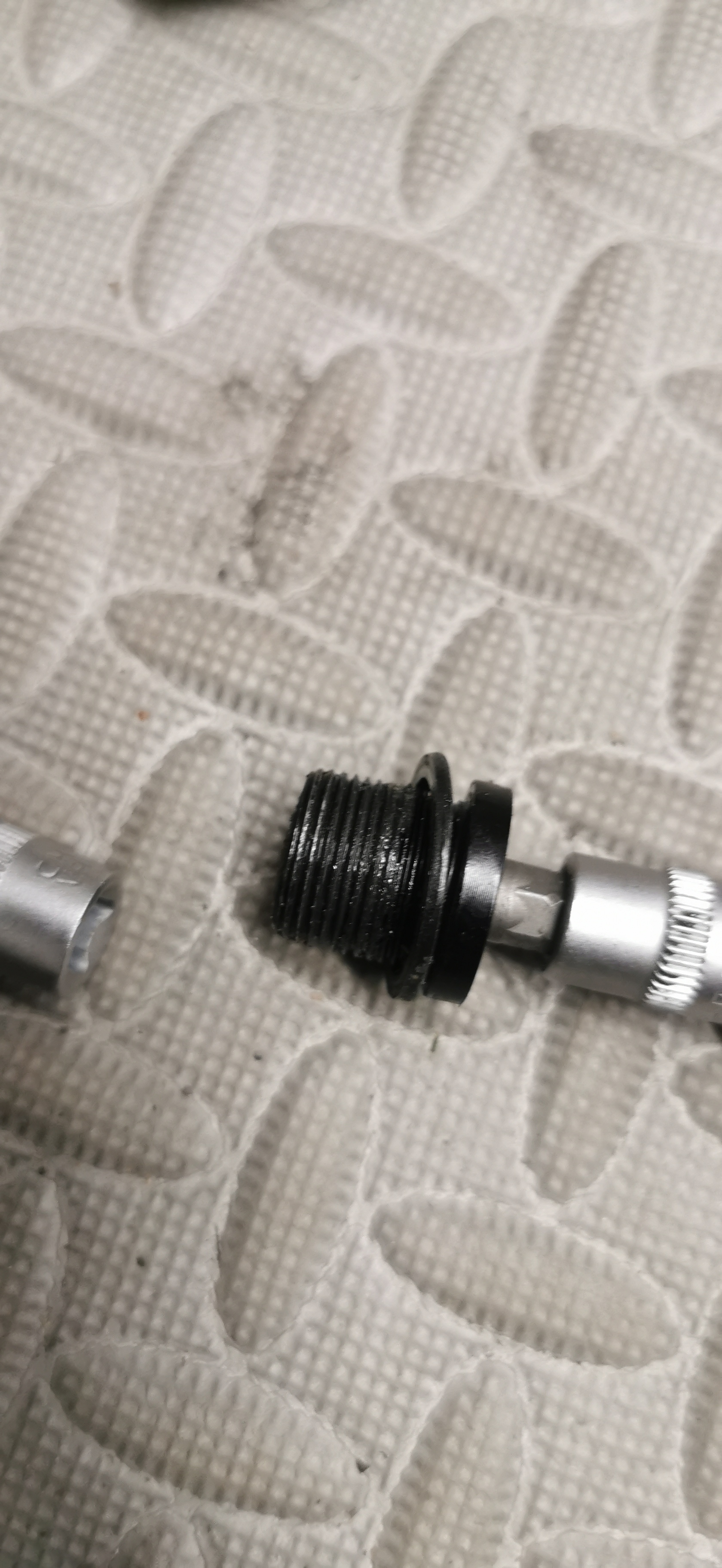

IMG_8034.png IMG_8033.png You probably got the crank-arm off by now (using the biggest hammer you can find) but I found these useful.
