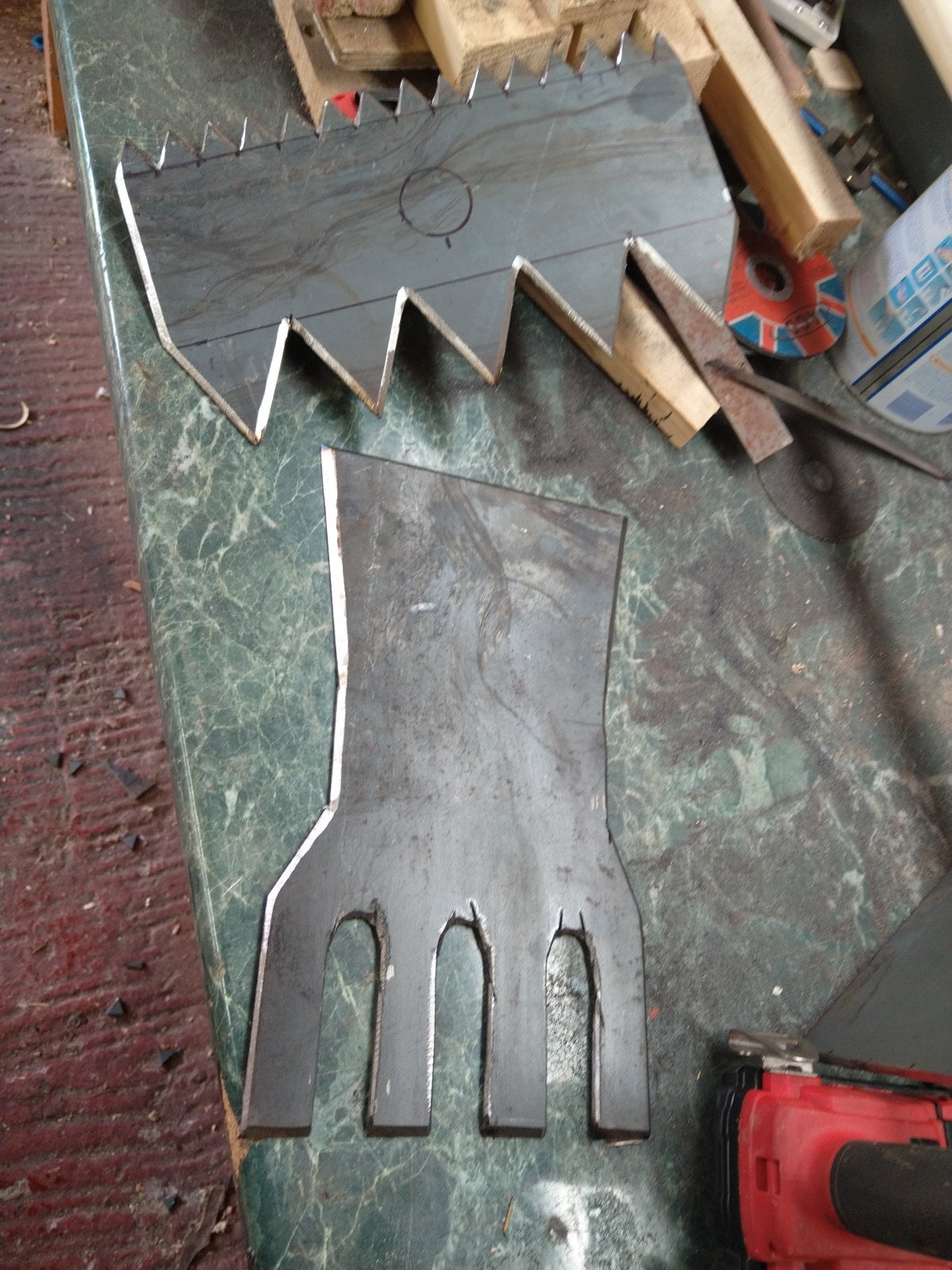

Second one done, I'll make a couple more and then get to welding

Btw, there’s a slight curvature from the cutter to the rake. I don’t know if that’s necessary or what the radius might be? I use all 4 sides but the blade/cutter side cuts through roots like butter. Good for tamping also. I hope you get the colour choice right 😉.
ah yea I see the curve, probably makes cutting and dragging easier!

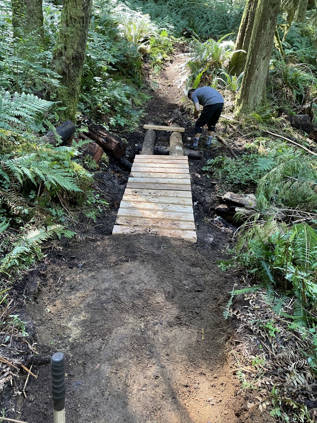

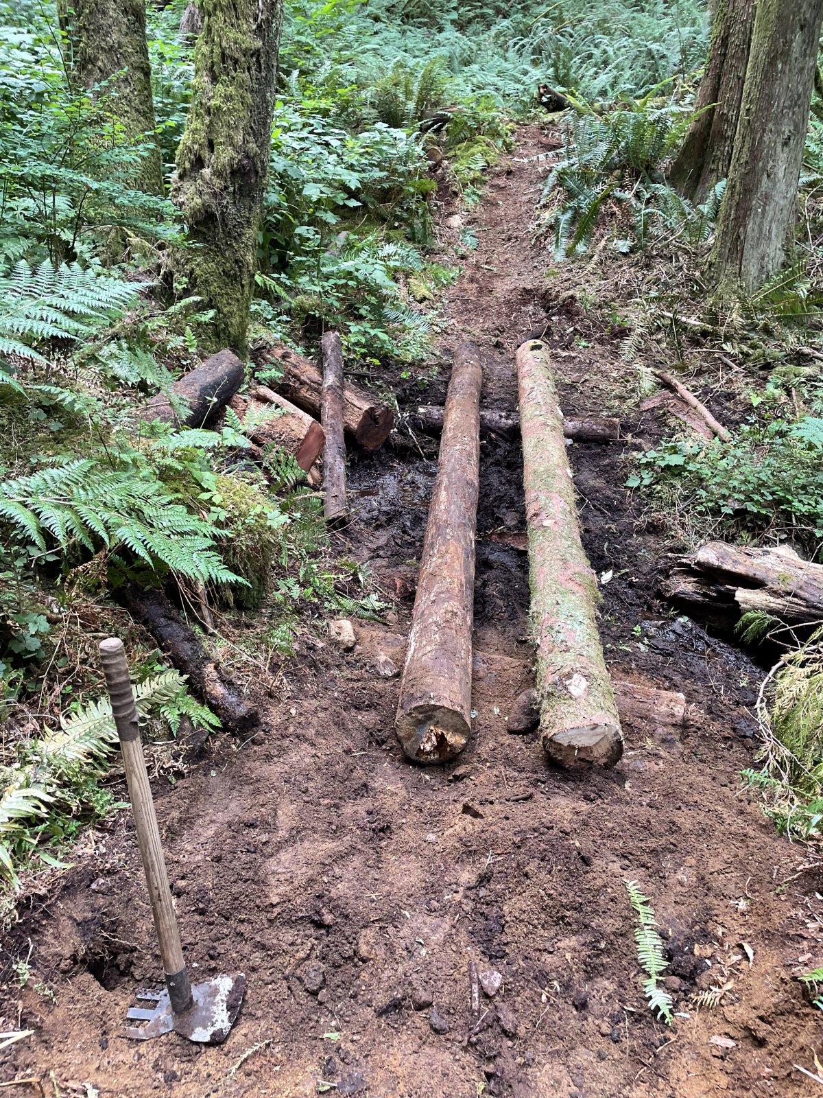

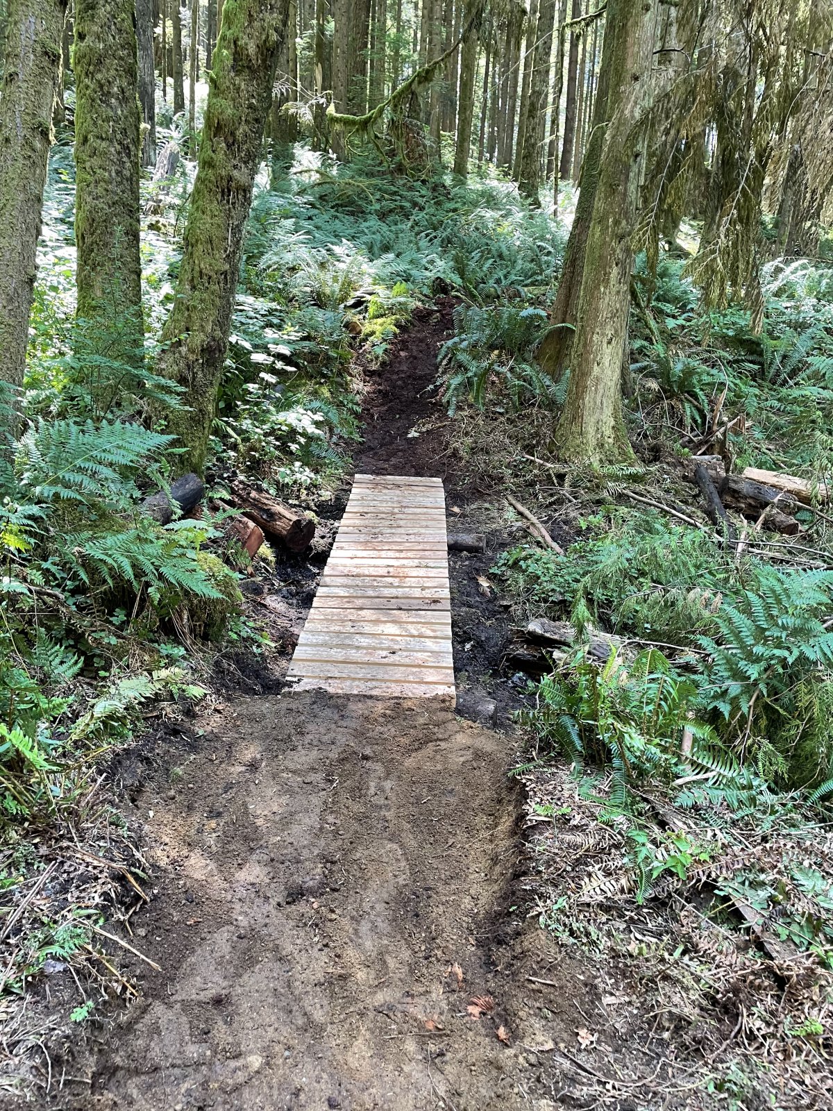

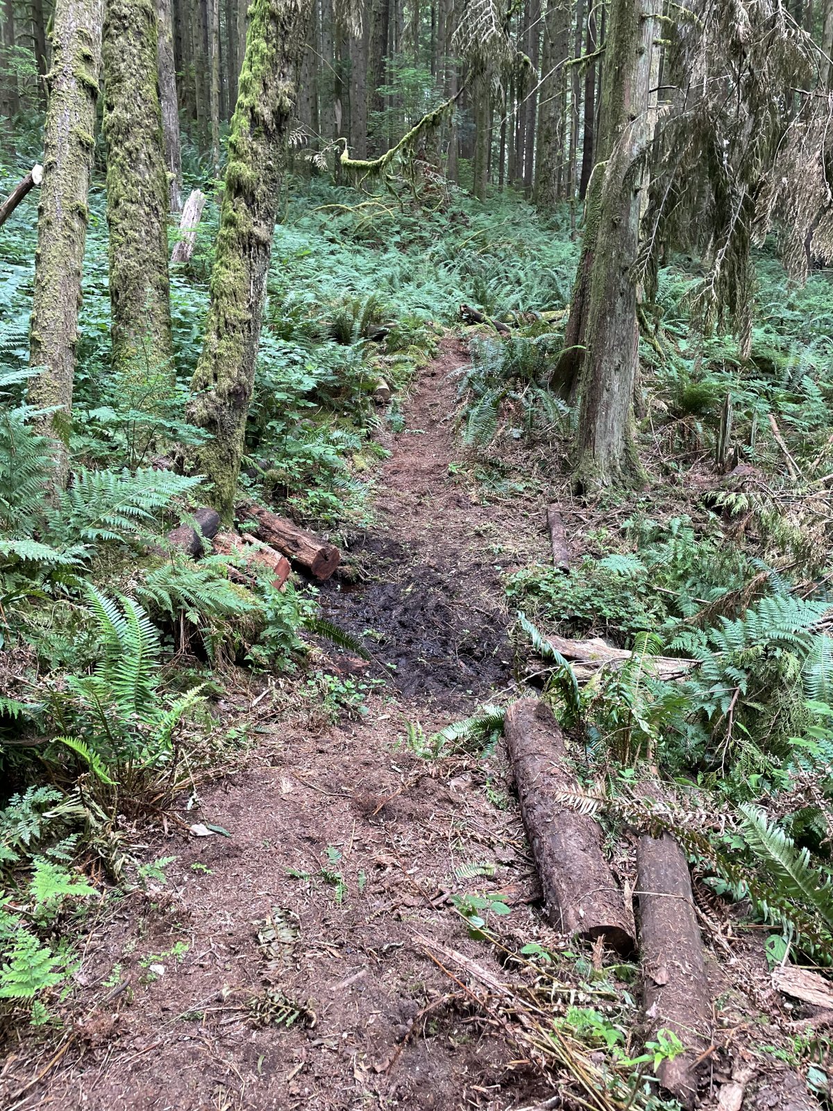

I know it doesn’t look like much but this small creek crossing was a disaster from past logging practices and an impossible mud hole to cross. Took a few days to correct the water flow and clean out the debris.
This trail is not well travelled and is quite secluded, but some hikers/dog walkers have agreed that this is a beautiful area for a trail. This lengthy trail is perfect for eMTB’s also because it’s a loop with lots of potential for moderate features. It’s very unlikely that regular mtb’ers will venture here because the access and exit can be difficult …and lengthy.…but Kudos to them if they give it a try.
The approach to the bridge.
Hauled in some stringers and sleepers from some nearby downed trees.
A little help from a friend.
And finally the finished product.
Might build one more bridge or possibly a wooden berm on this trail, but mostly the terrain needs a cleanup, slight fixing and an interesting path with some switchbacks. There’s several natural features on this trail but I’ll leave it to others to decide if any man-made features are needed. I hope to be finished this fall or early winter.

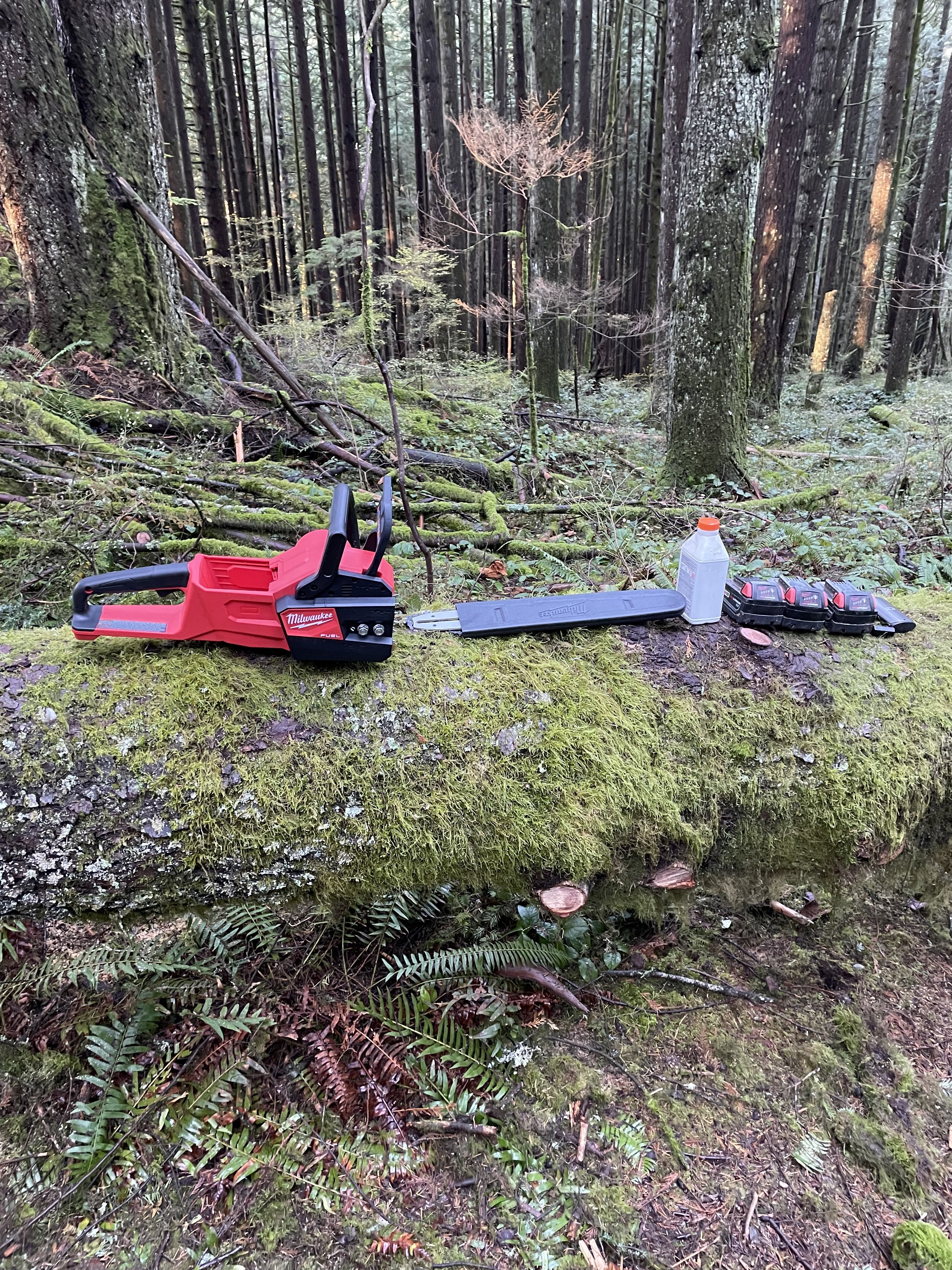

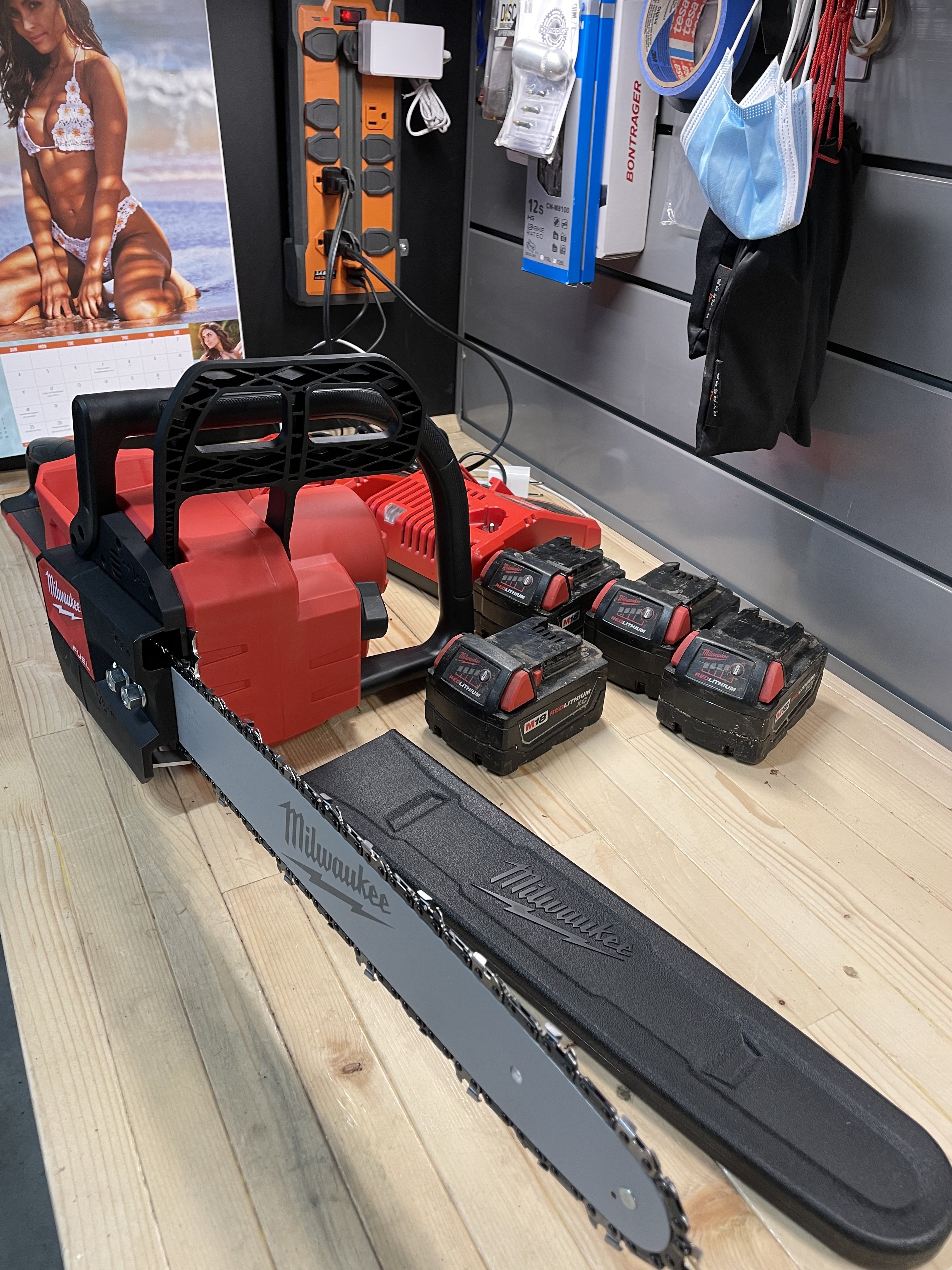

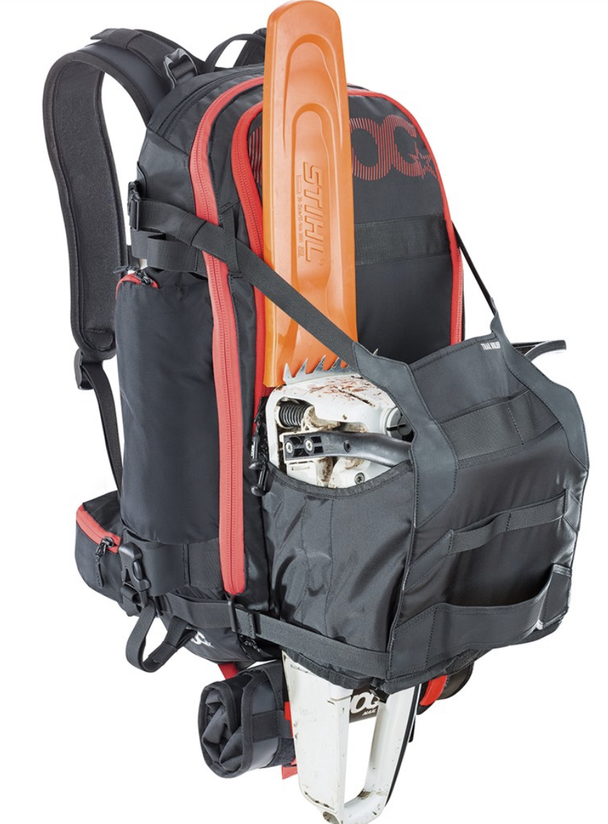

Picked up this new tool yesterday. Just need to figure out how to pack it. 16” bar (13”cut). Should help with trail maintenance and make quick work of those blow-down-snags.
Note the gratuitous picture of my iPhone charger. 😉

Picked up this new tool yesterday. Just need to figure out how to pack it. 16” bar (13”cut). Should help with trail maintenance and make quick work of those blow-down-snags. View attachment 102858

seriously considered swapping my stihl for one of those because of fuel and the fact I have about 10 milwaukee batteries.. let me know how you get on with it
Yah, I’ll test it out in the next few days. I have 9 5ah batteries. The 12ah battery is $300+. That’s what I paid for the saw. I’ll take 4 batteries with me. 🤞

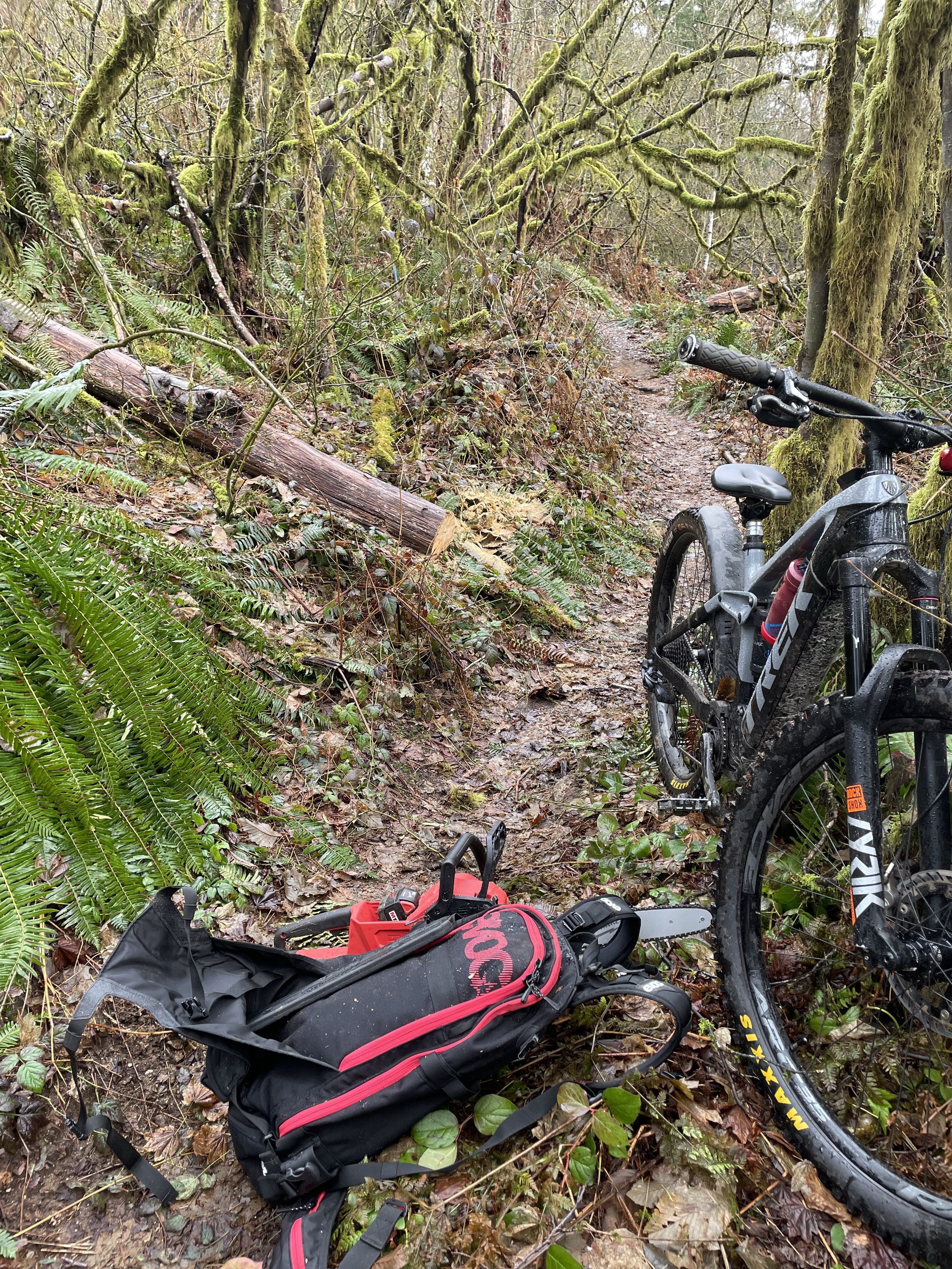

I use a Grunden's back pack that is large enough to put the saw in head side down/handle away, plus a couple batteries. Heavy on the back but certainly doable, especially with an eBike. I only bring it once in awhile if there is something too big for the sawzall and M12 Hatchet tool.
I used to do trail work off a Rokon years ago and it had a nice rear rack for the saw and I bungied a milk crate on the front rack for gas/oil/water/snacks but I really don't see a clear way on a conventional MTB to carry one.
the 12ah batteries definitely deliver a better kick, I use them with a milwaukee cutoff wheel to cut concrete floors etc, the power it delivers over a 5ah is hugely different, no slow down and no loss of torque but as you say... $300 :D

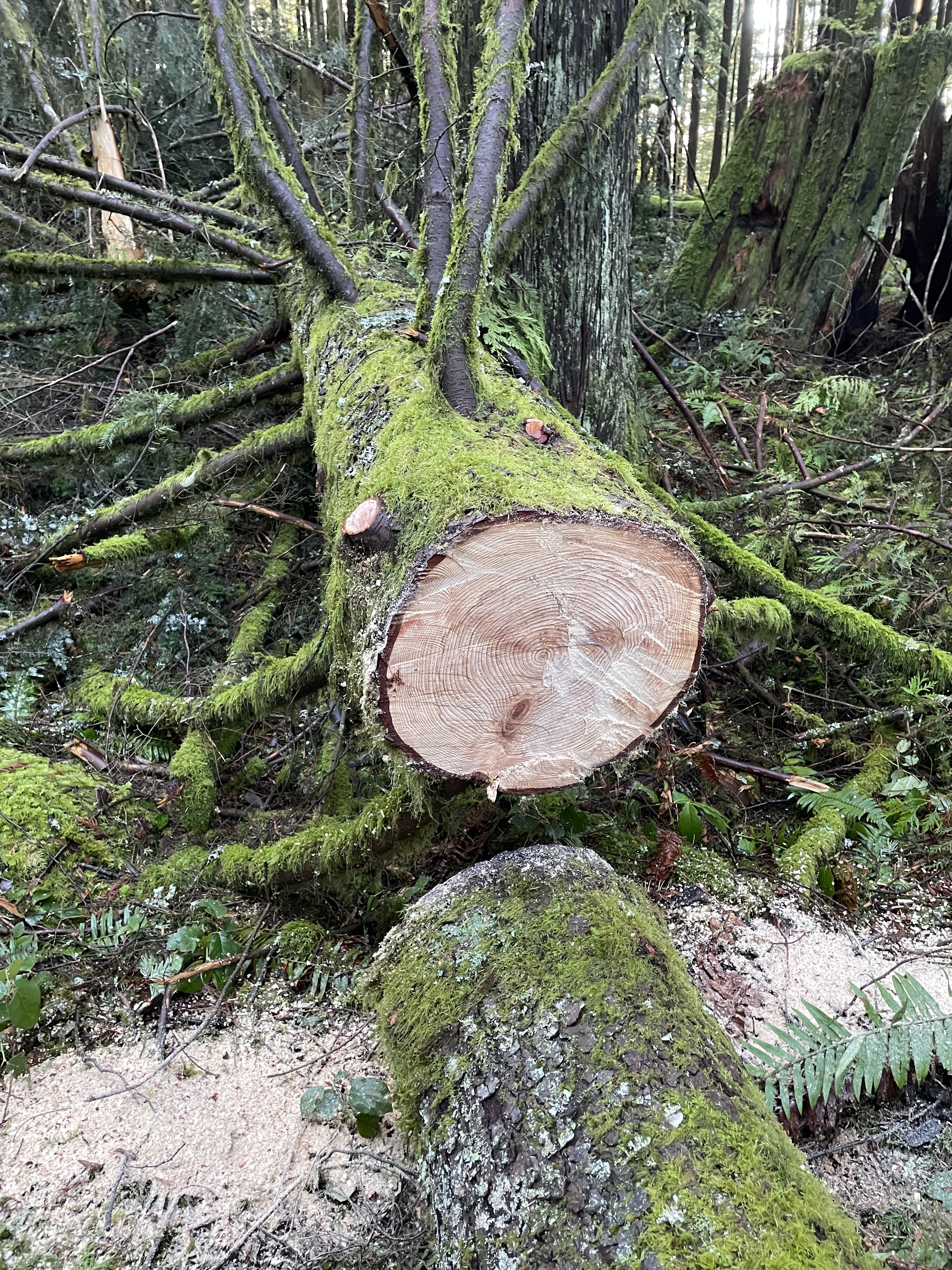

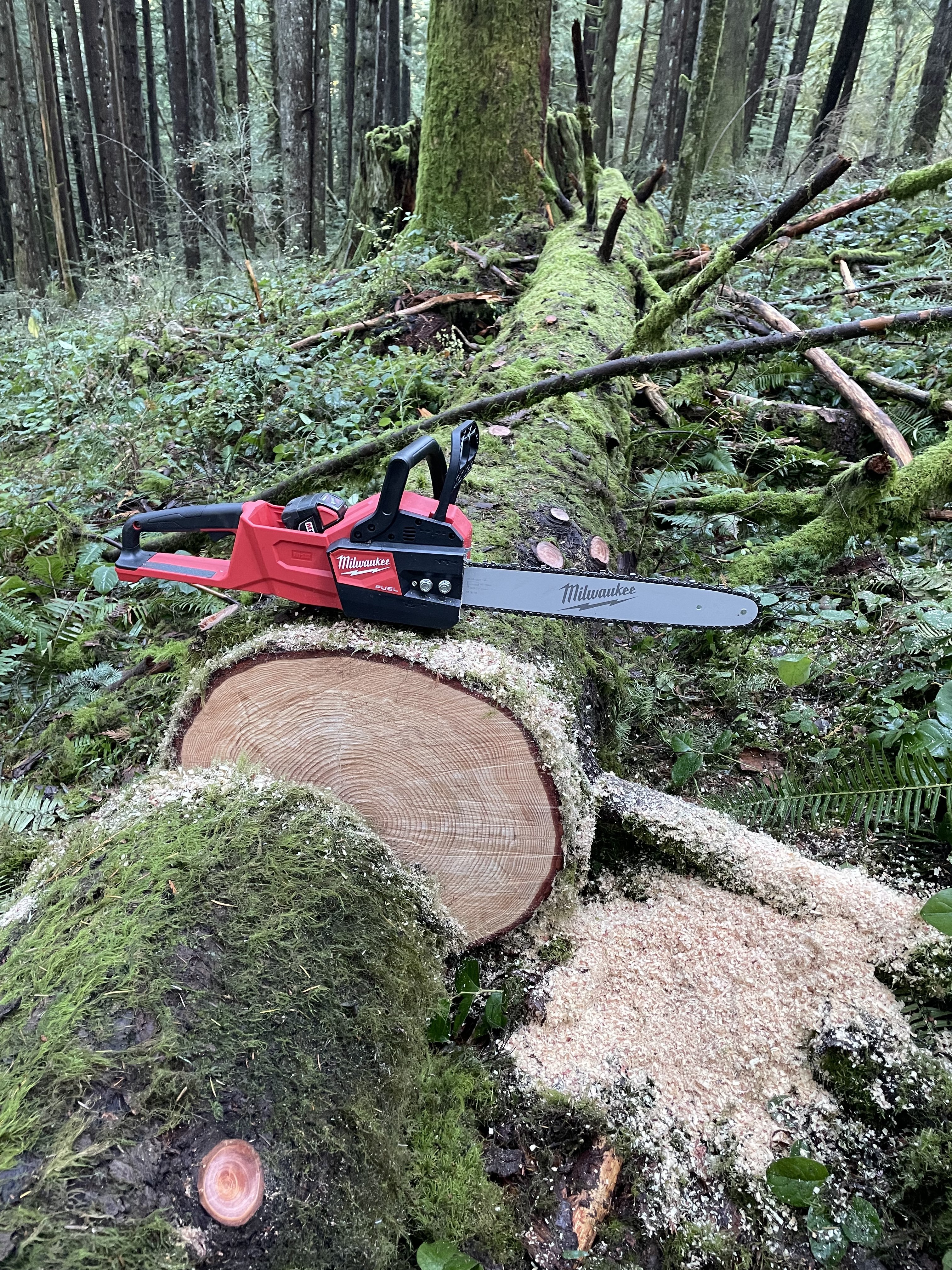

The 12ah battery would’ve been better. I used 3 5ah batteries for this log. The motor stalled a few times probably because there was some big knots inside. Just had to feather the bar at a few spots.
I’m use to larger Stihl saws (032, 066 and 084) but I was impressed with this little guy. It did the job. Diameter of this log was about 22” Douglas Fir…and very hairy. 6-8” knots. DE3E57BB-C5B5-4D39-8C41-4DA9EE2AAF75.jpeg D4BADC16-D9A4-4181-848C-A318A307B2BB.jpeg 1184A037-2AD7-494C-B993-73B89308ACF4.jpeg 252D9FD5-24E5-47D4-897E-B6661E8D640A.jpeg BB139E36-A7CD-49EE-959C-E5BCA2C677DD.jpeg A61C4D73-2BF4-4C2C-9837-7C0BF10776B3.jpeg FE686722-F3EC-4DEB-BD3A-56AB161F353A.jpeg 47A09996-A97D-4807-BAE4-69DE89A93B42.jpeg
Al in all I was pretty happy with it. Keep the chain sharp, chain oil and charge the batteries.
I’m use to larger Stihl saws (032, 066 and 084) but I was impressed with this little guy. It did the job. Diameter of this log was about 22” Douglas Fir…and very hairy. 6-8” knots. View attachment 102959 View attachment 102960 View attachment 102961 View attachment 102962 View attachment 102963 View attachment 102964 View attachment 102965 View attachment 102966

Check out the dakine builder pack and the evoc trail builder pack, both are designed for chainsaw carry. I have the evoc, it works well.
Notably all the photos have got a fairly small saw, I’ve always used mine with a little makita battery saw and it works well, I haven’t offered up a big petrol saw yet to see how useable it is.

I made sure the Milwaukee saw and some batteries would fit before I purchased the Evoc pack. Tight fit though. Total weight might be 25lbs. …or less with everything.

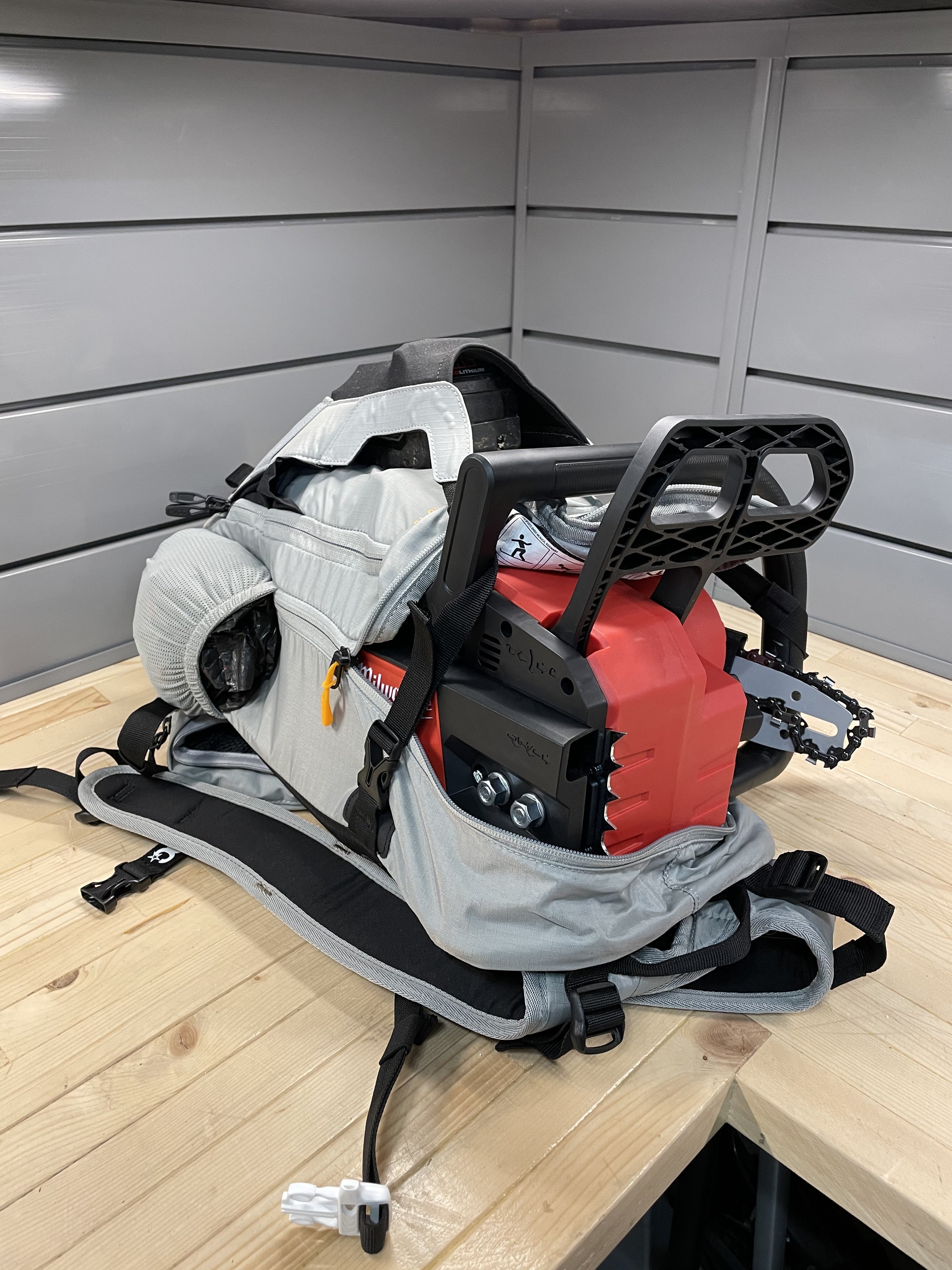

Just ordered the Evoc Trail Builder. Should be here in a few weeks.

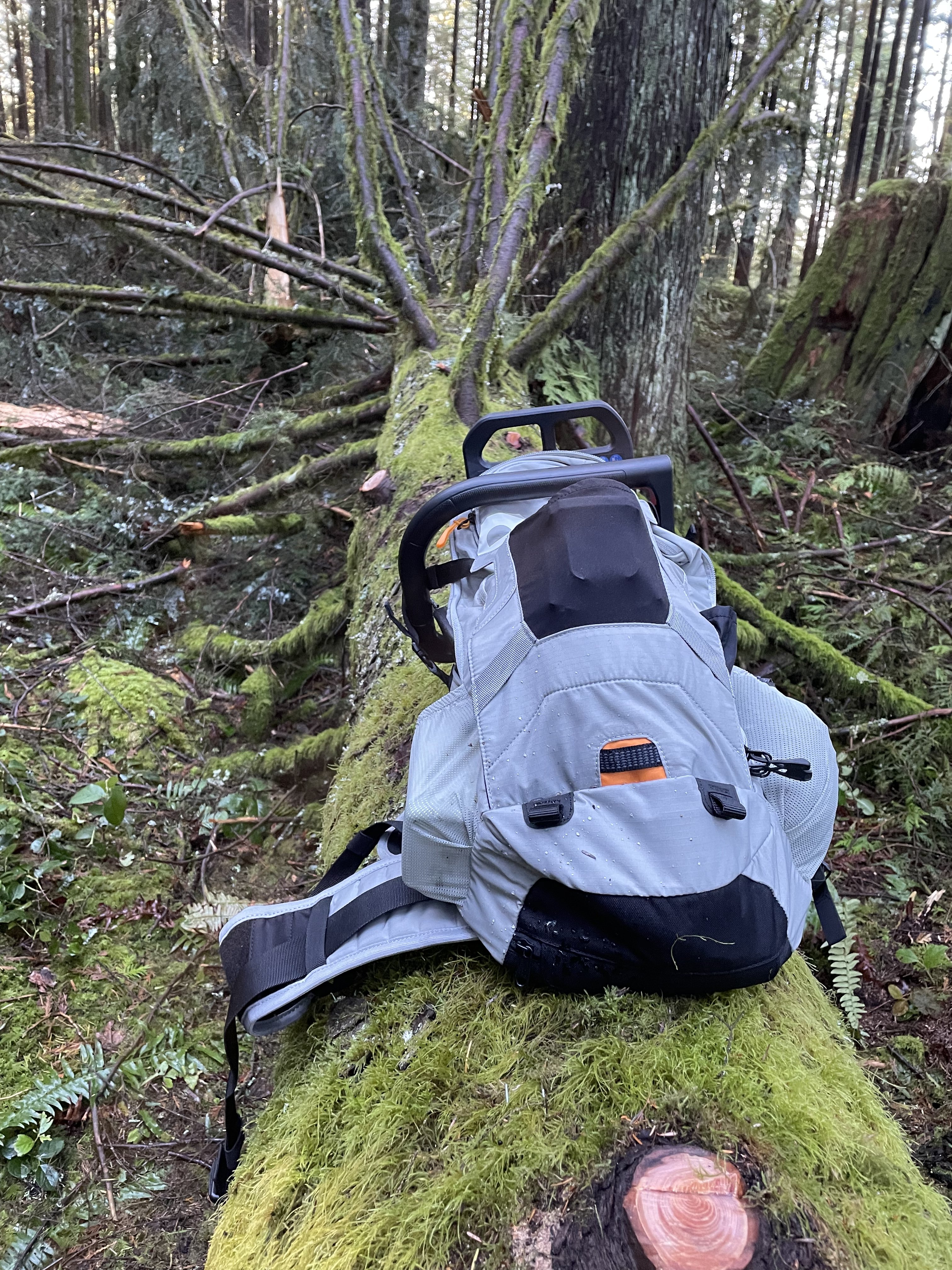

A new year and a new project. I decided this new Evoc pac makes sense since I’m packing the Milwaukee saw, Rogue, shovel, small garden rake, batteries etc. over a slightly longer distance.

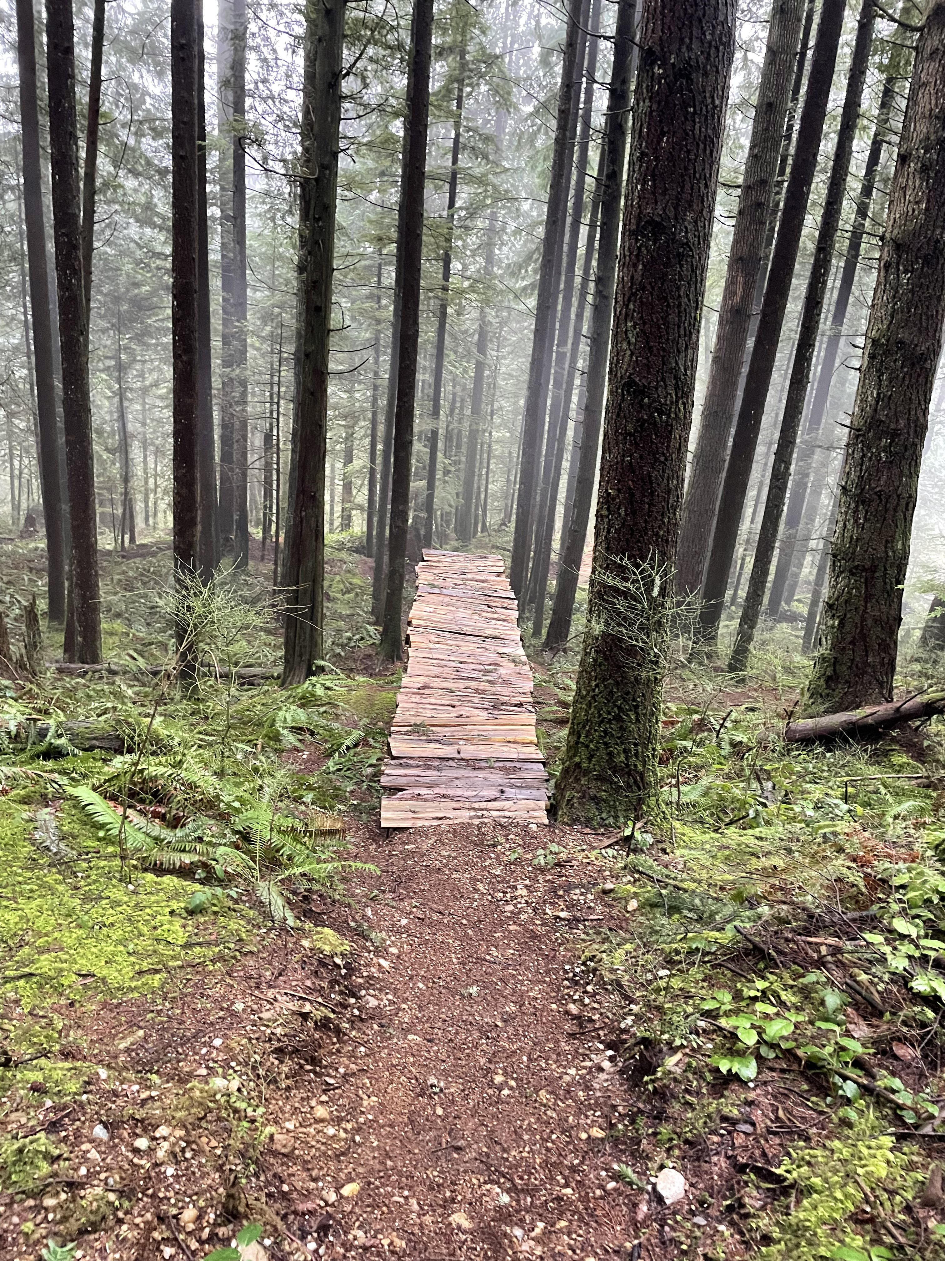

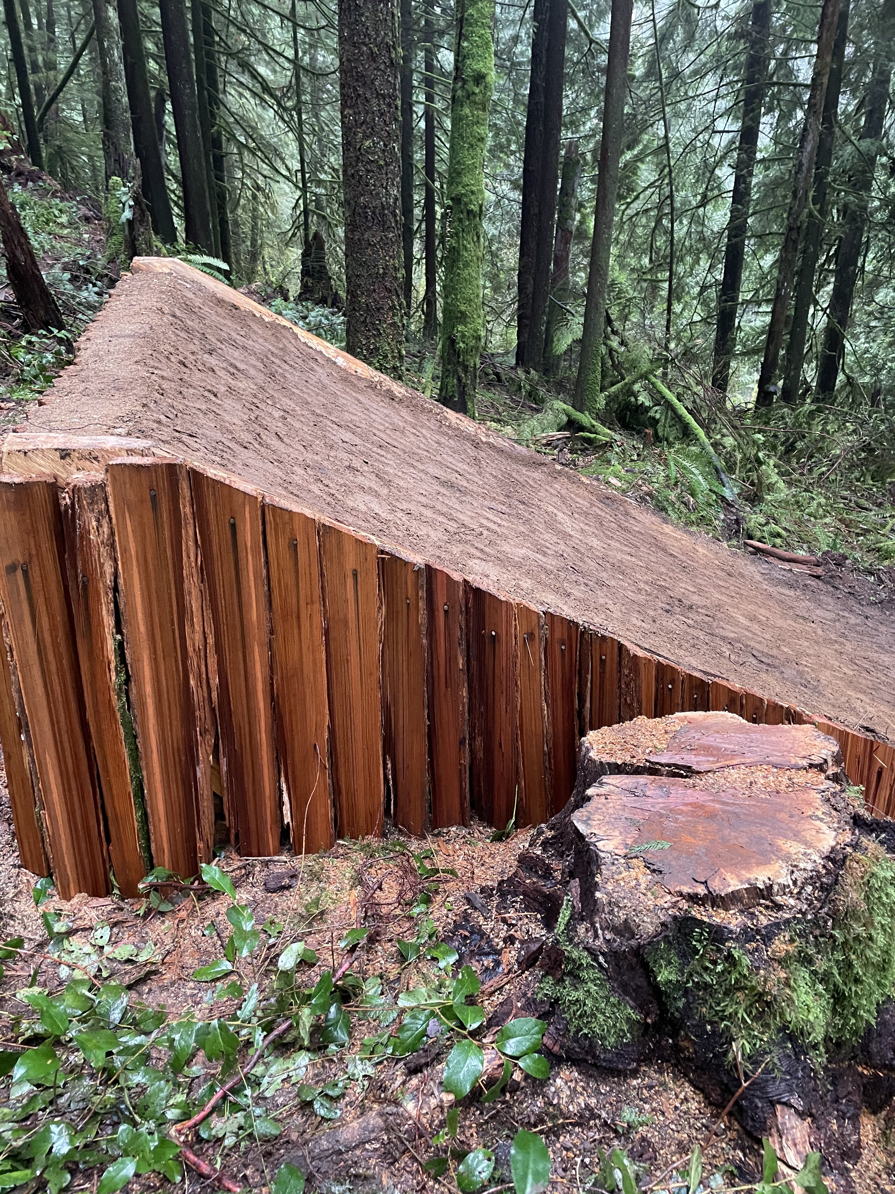

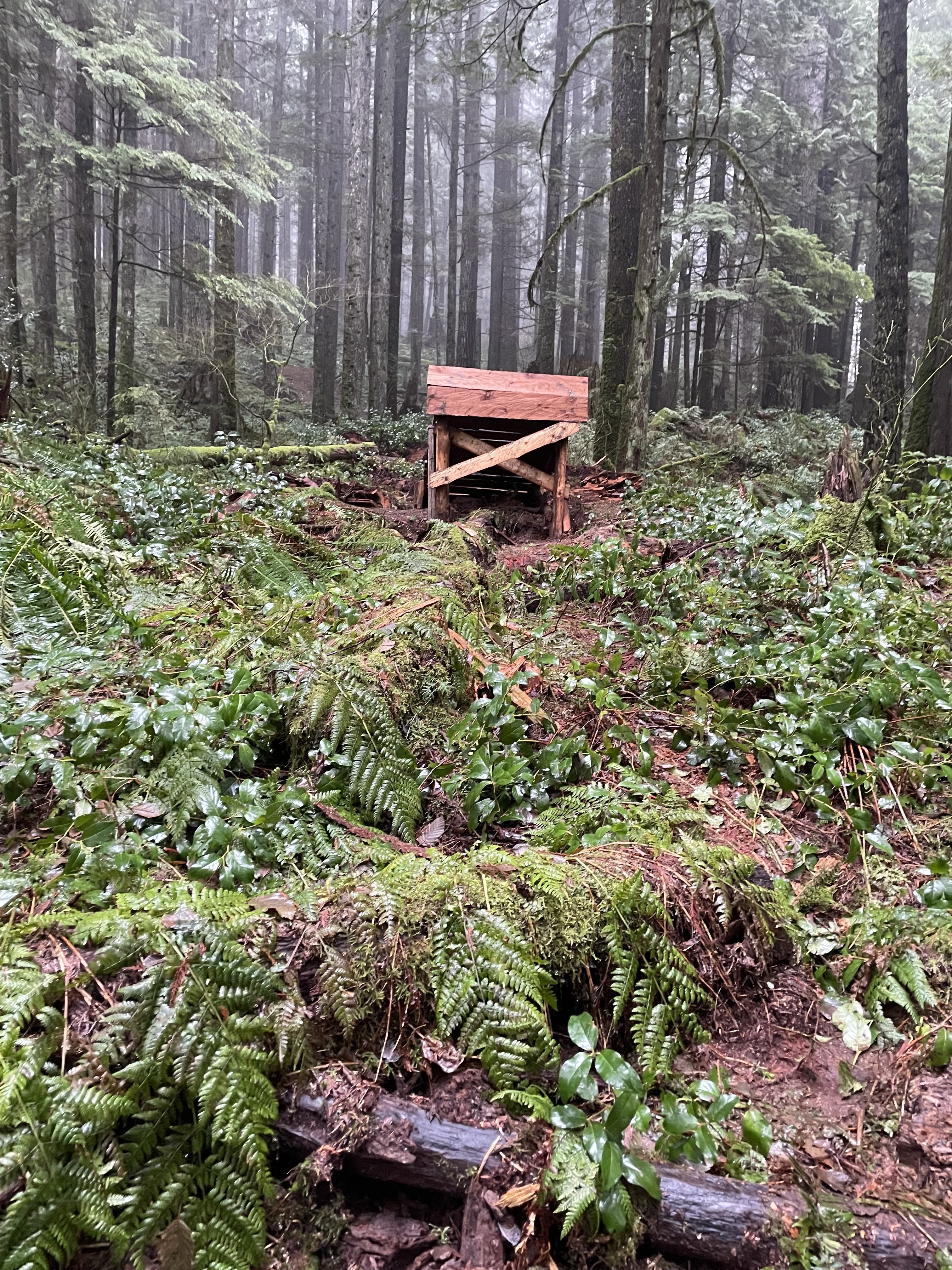

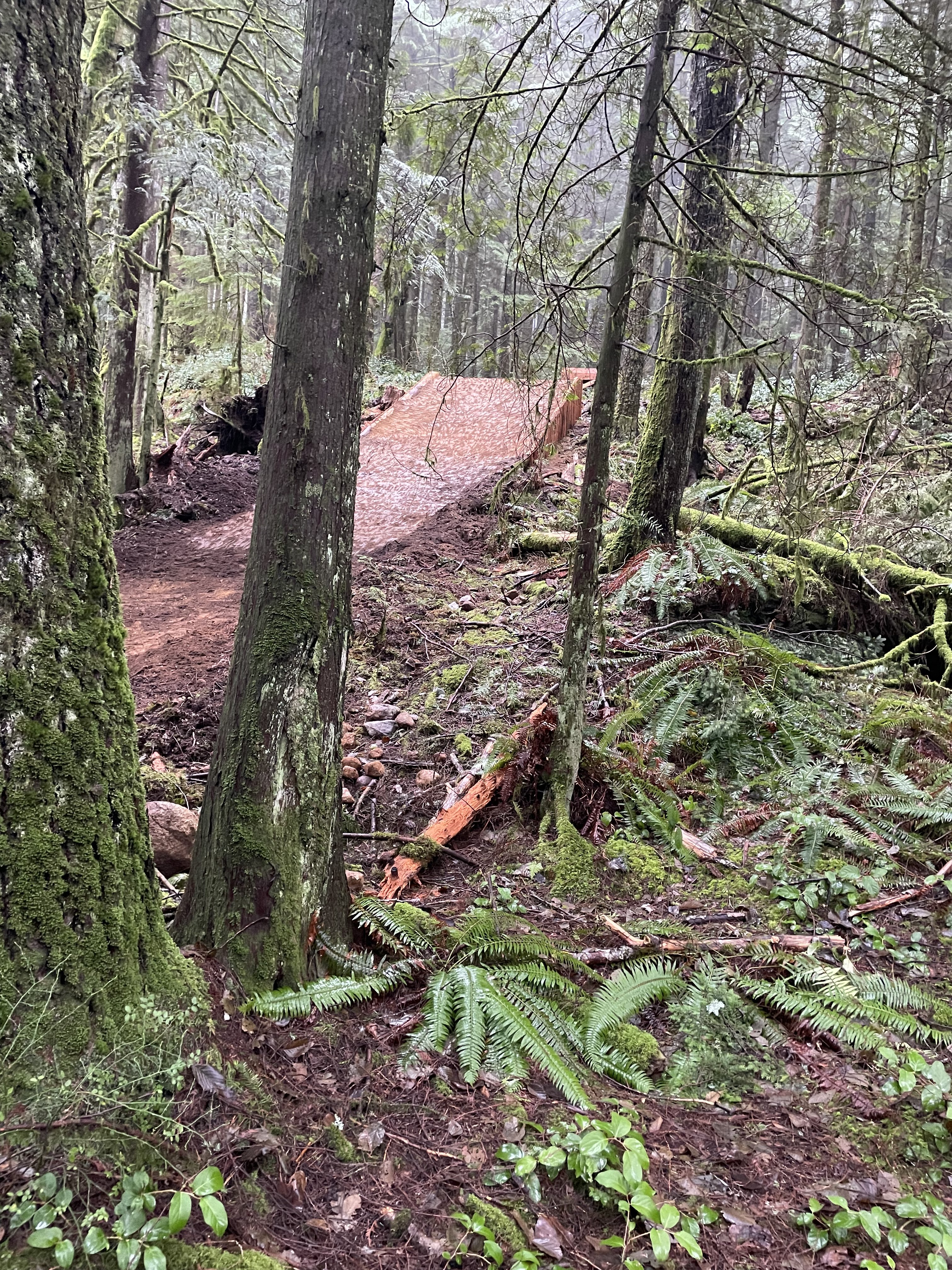

So I recently finished the trail I’ve been working on for the past year. 4 bridges, several drops, technical but kinda flowie. Perfect for hiking and eMTB’s. It’s more of a loop so riders on analog mtb’s don’t venture to this area…except a few.
8E46536C-6170-4340-9BF5-9D3354442846.jpeg 5CF31C90-1B9F-49A0-8CA6-941BC58B524A.jpeg 8E80CC58-97D7-45D4-B7C8-F13A0B56DE90.jpeg FD99A813-5DDB-42A5-80AB-CF7C62E070DB.jpeg 2AC4365F-B8FF-4E30-9F33-F6F1582AA90A.jpeg 234D8AE3-2849-4FF0-8572-381B169FD5AA.jpeg 190A924A-697E-40AC-A680-EA48FC1DA554.jpeg A6858DEB-1C7E-4D3A-8F0C-B35D713A9F06.jpeg
These jumps are well above my pay-grade but they are well built. The builder has pouched “my” trail but I’ve also pouched his trail. I think there’s an understanding. We’re both confined to a secluded area which is bordered by a creek/ravine and a river. Any water flow and environmental issues is a priority for both of us. Past logging practices has caused some problems and Logging debris has blocked some of the creeks and drainage, but I correct those when I can.

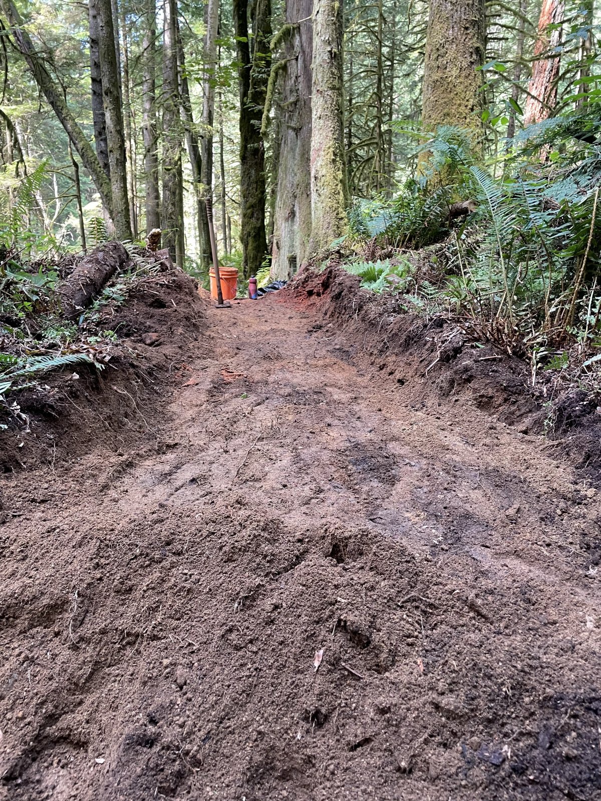

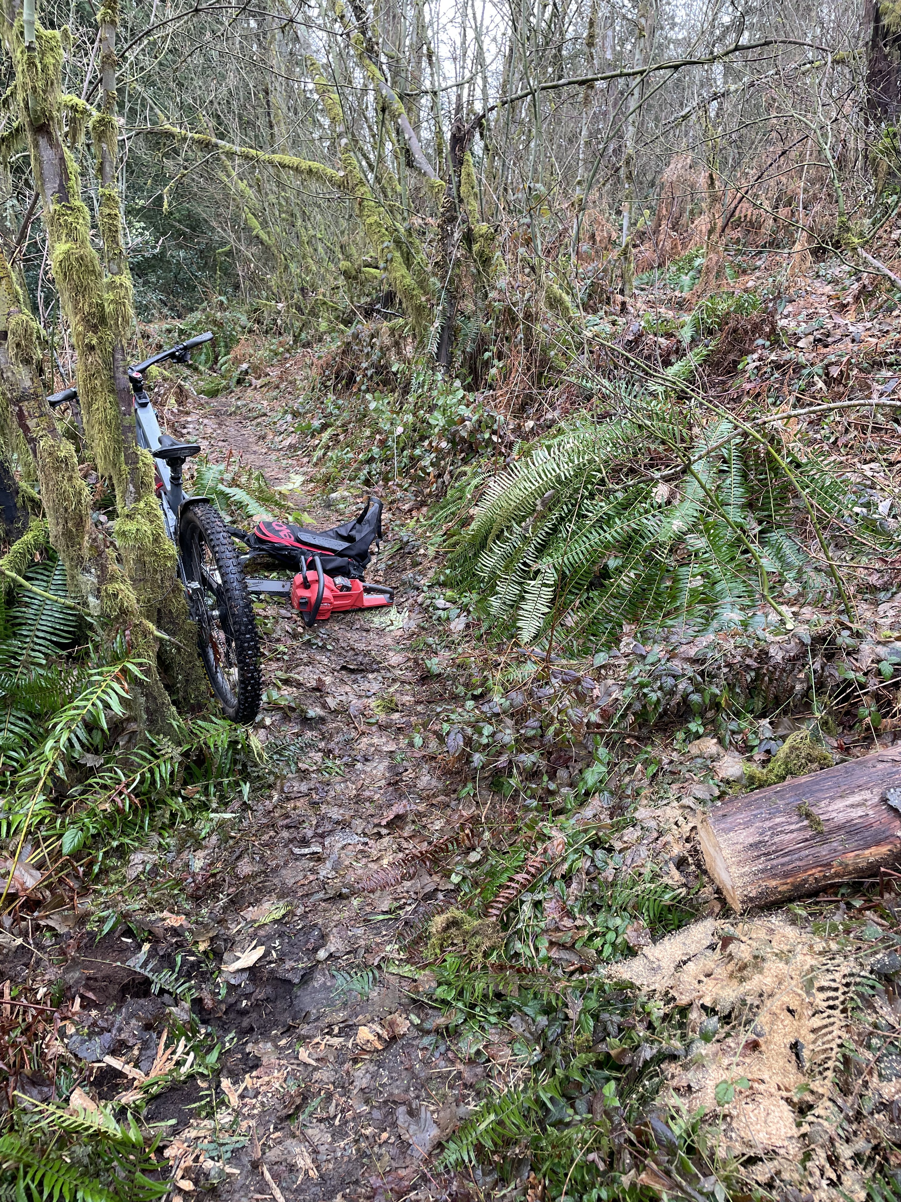

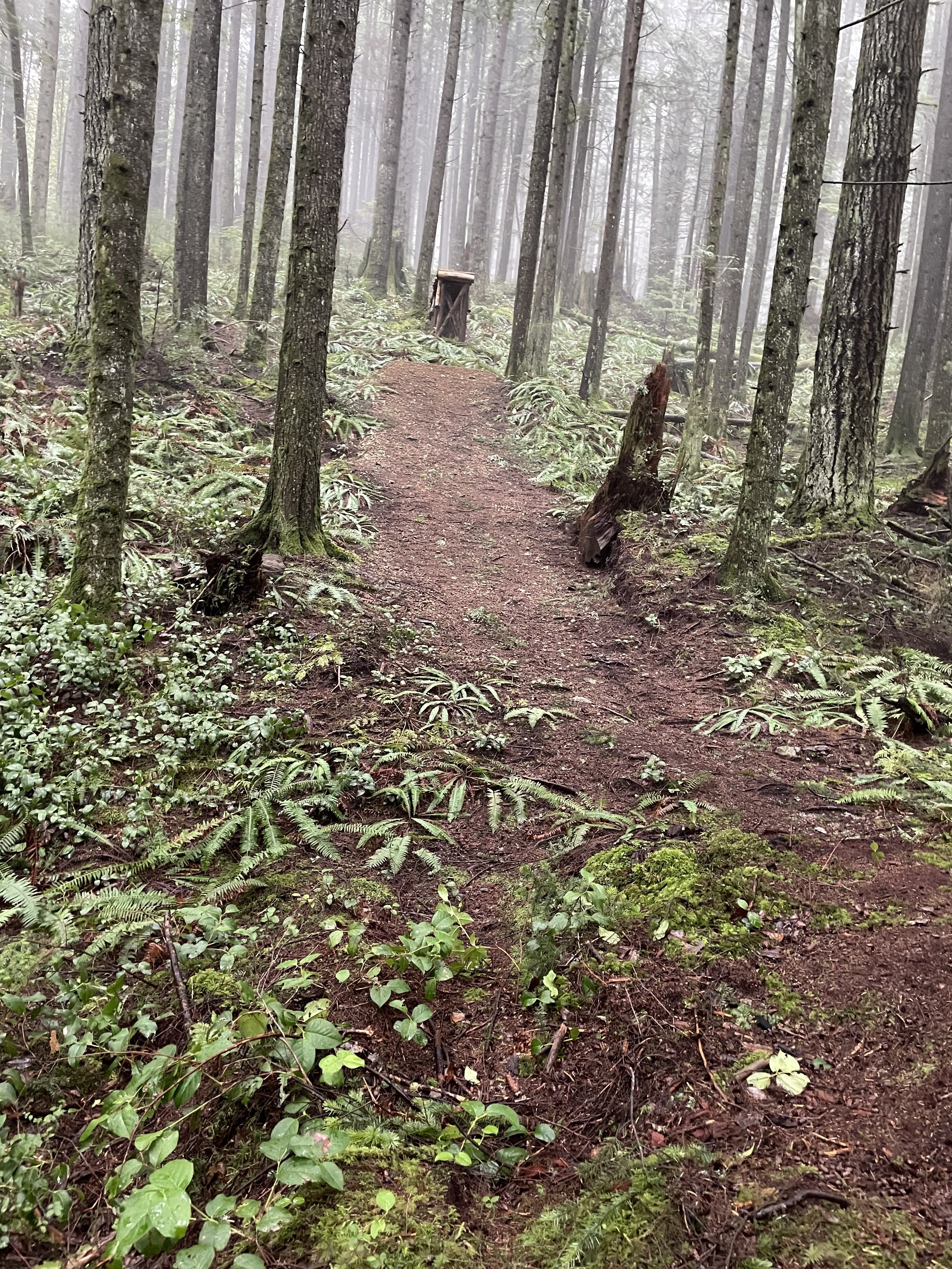

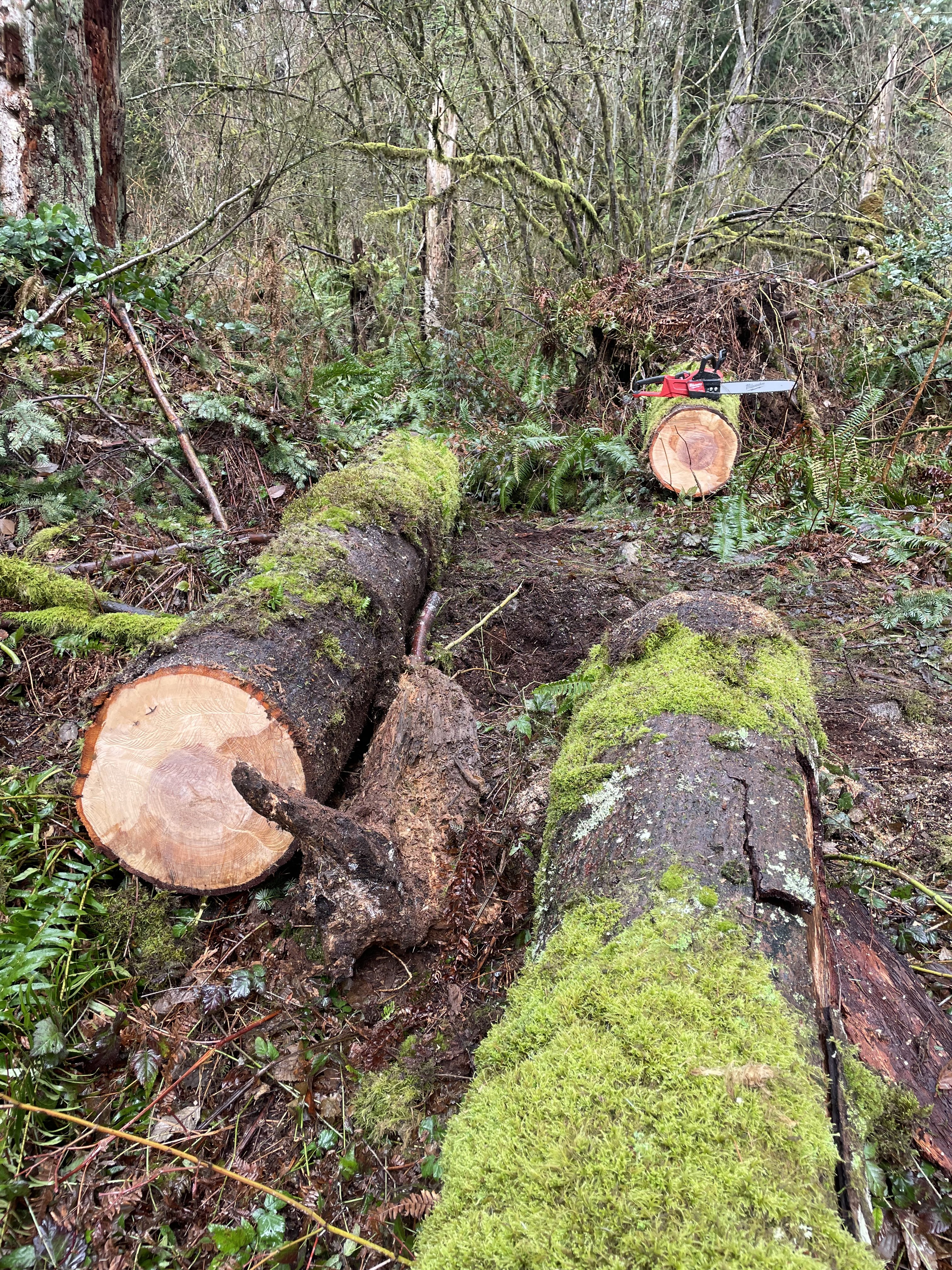

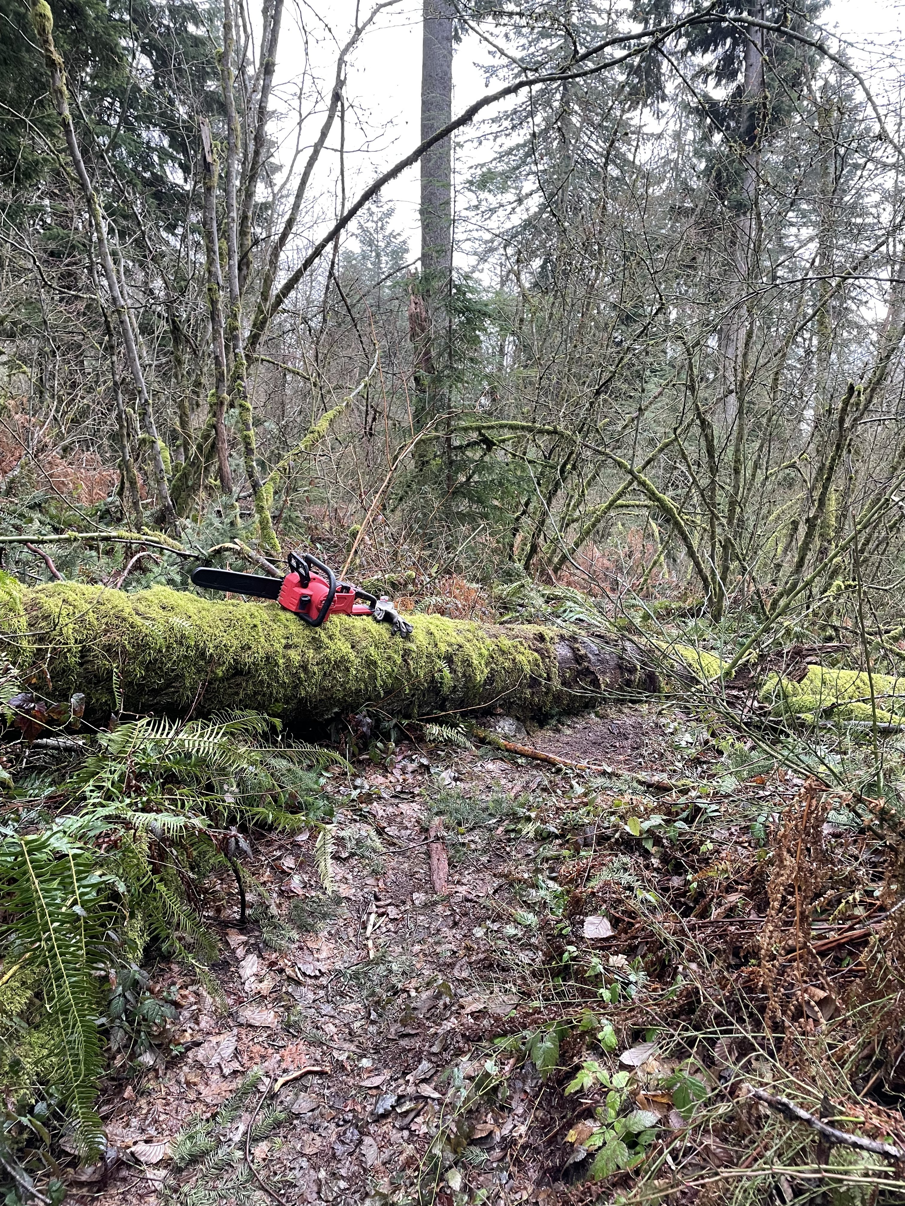

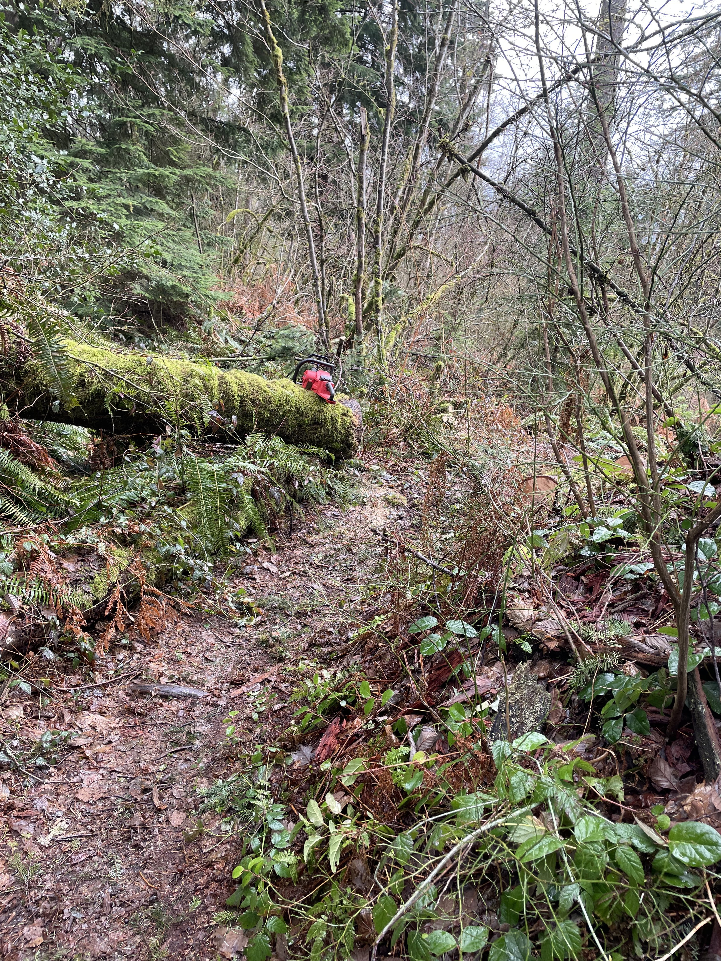

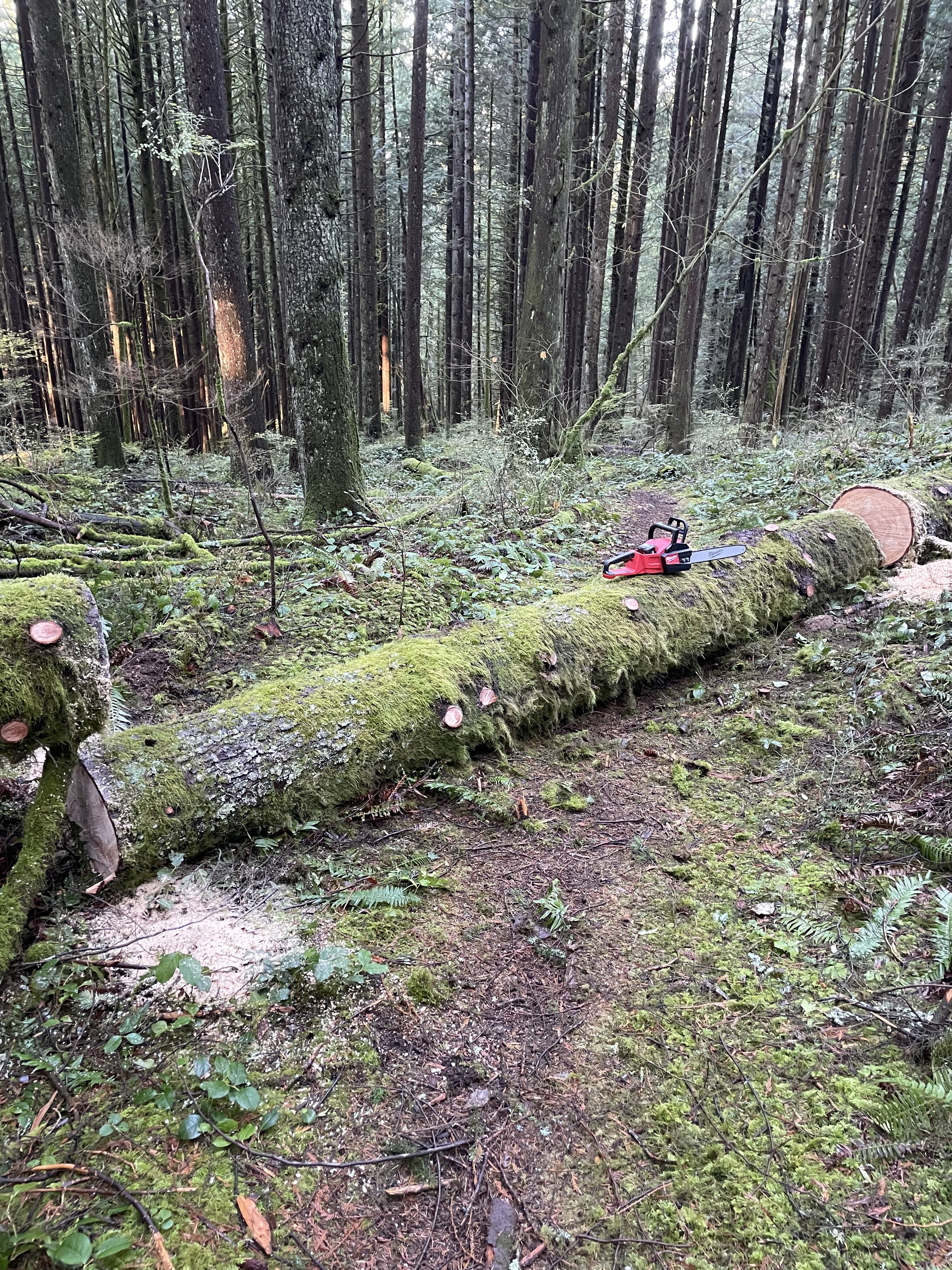

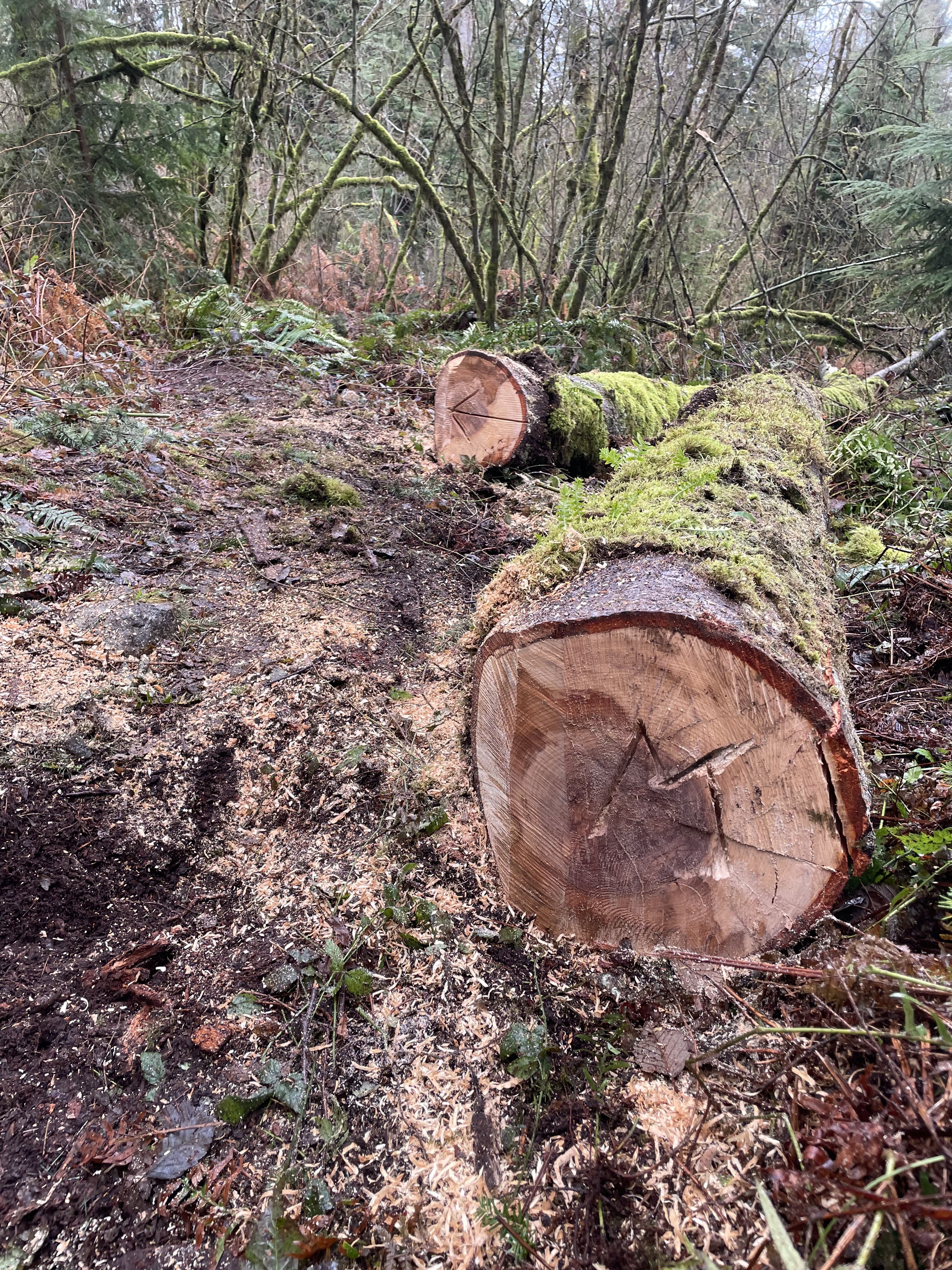

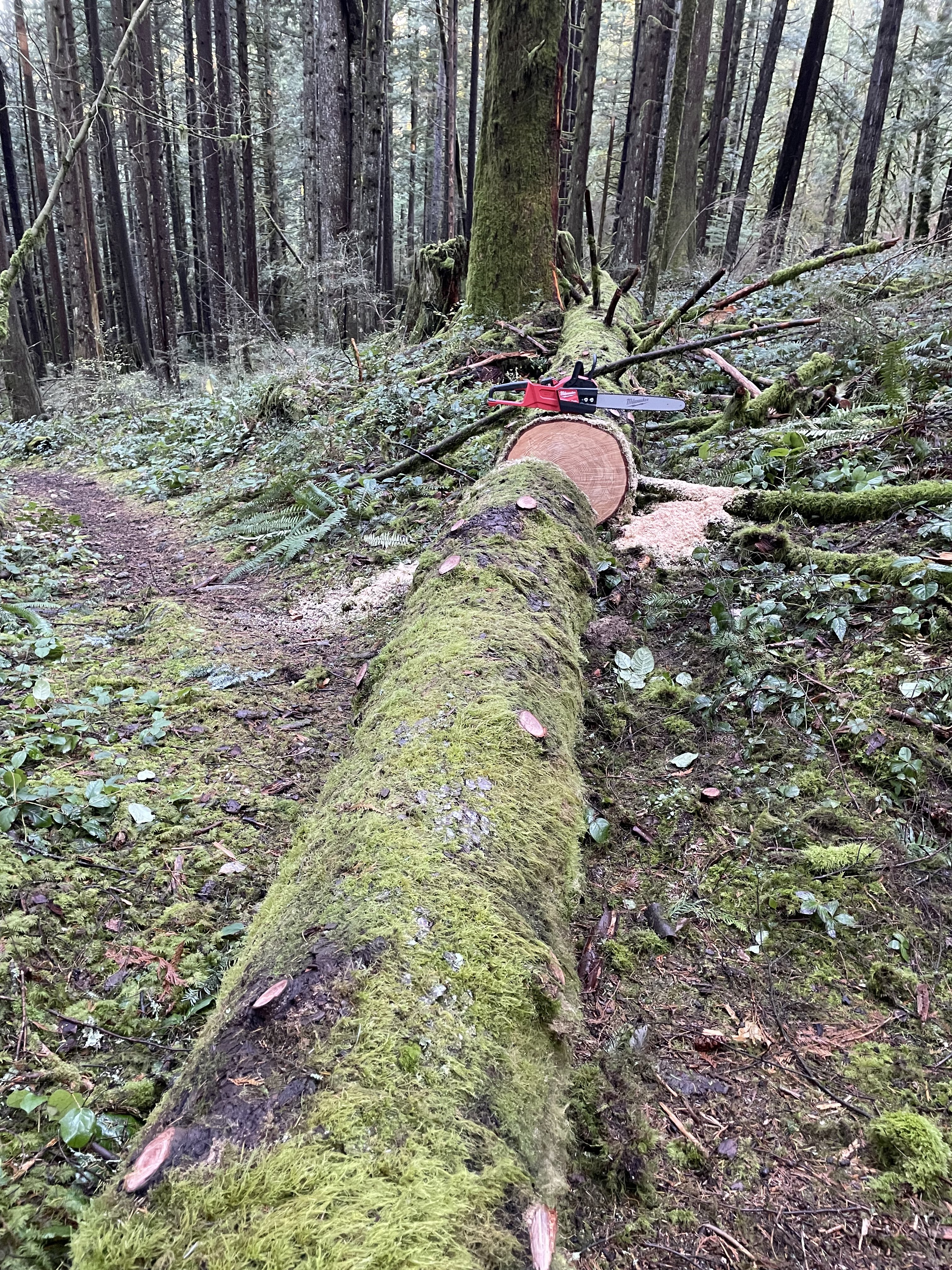

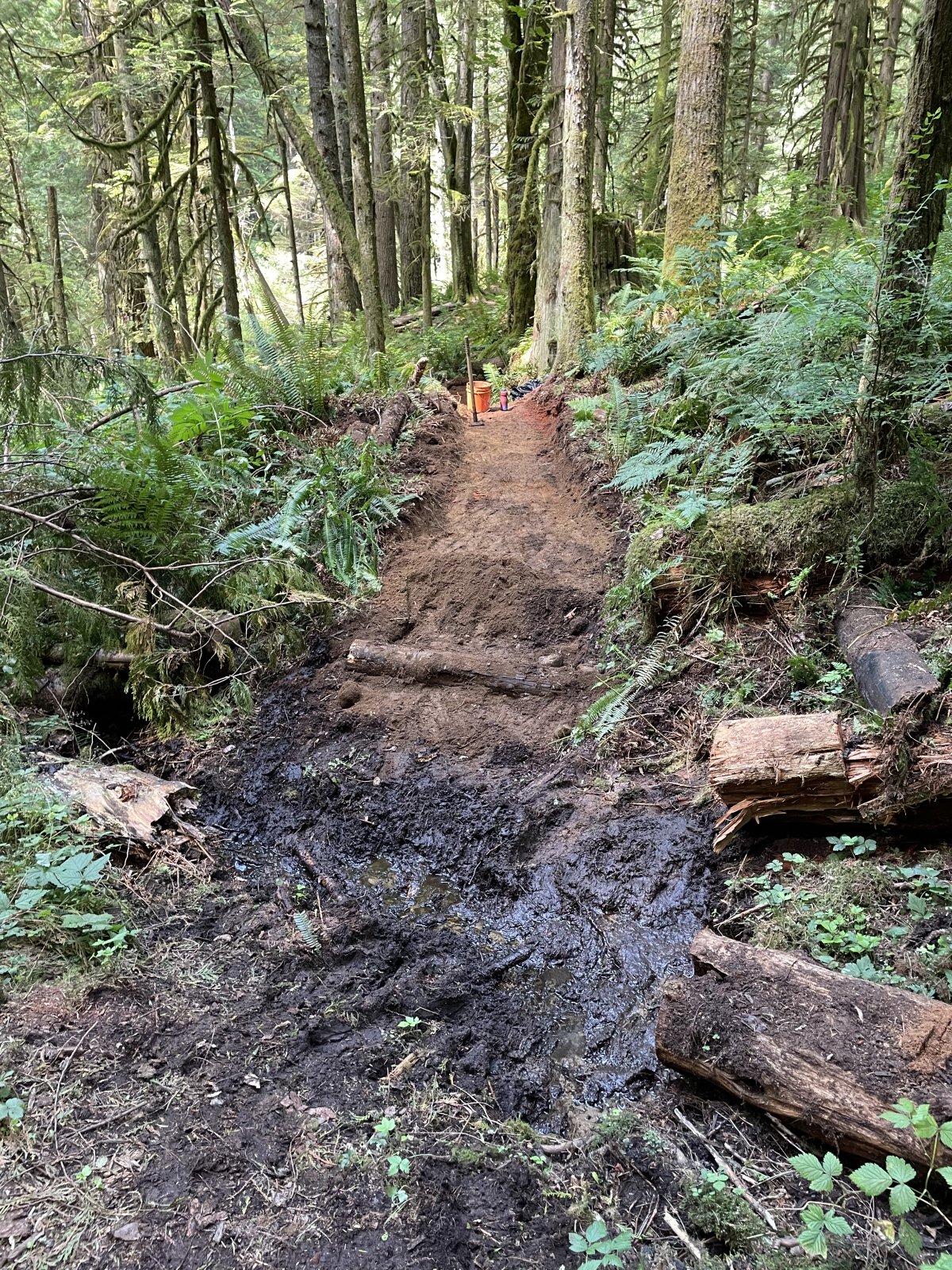

Day 2; same ‘Ole Franks’ trail (posted day 1 in pic of the day recently) and finally cleared the winter damage. Two hikers helped me push the log off the trail.
C9FBD038-893E-45B8-8E4F-98F4AA3D2624.jpeg AB5891C2-D48B-4B27-98CF-9C05096EA03E.jpeg F1F6A5FF-8681-445F-A7BC-050390331A8C.jpeg 5545FD69-71FA-497E-B094-88191C5E4737.jpeg 90258BE3-65CF-444A-9E00-37E0C49C734A.jpeg
Hmmm, someone carved an arrow and their initial in the log.
Cleaned up a few other minor things too, but it’s good to go. 👍🏻

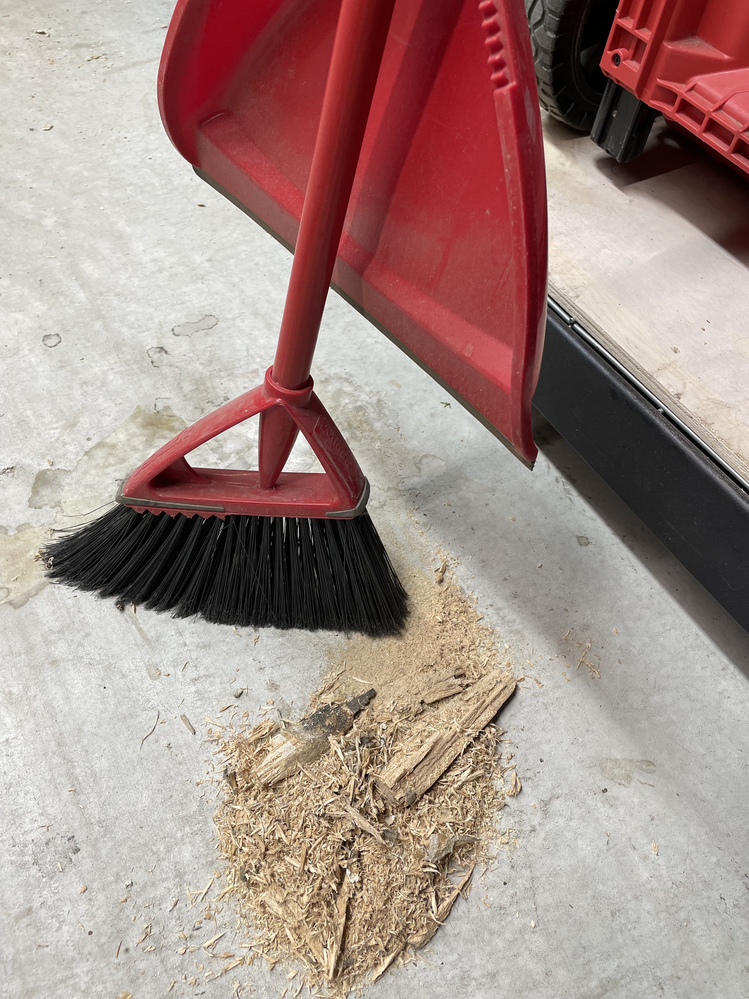

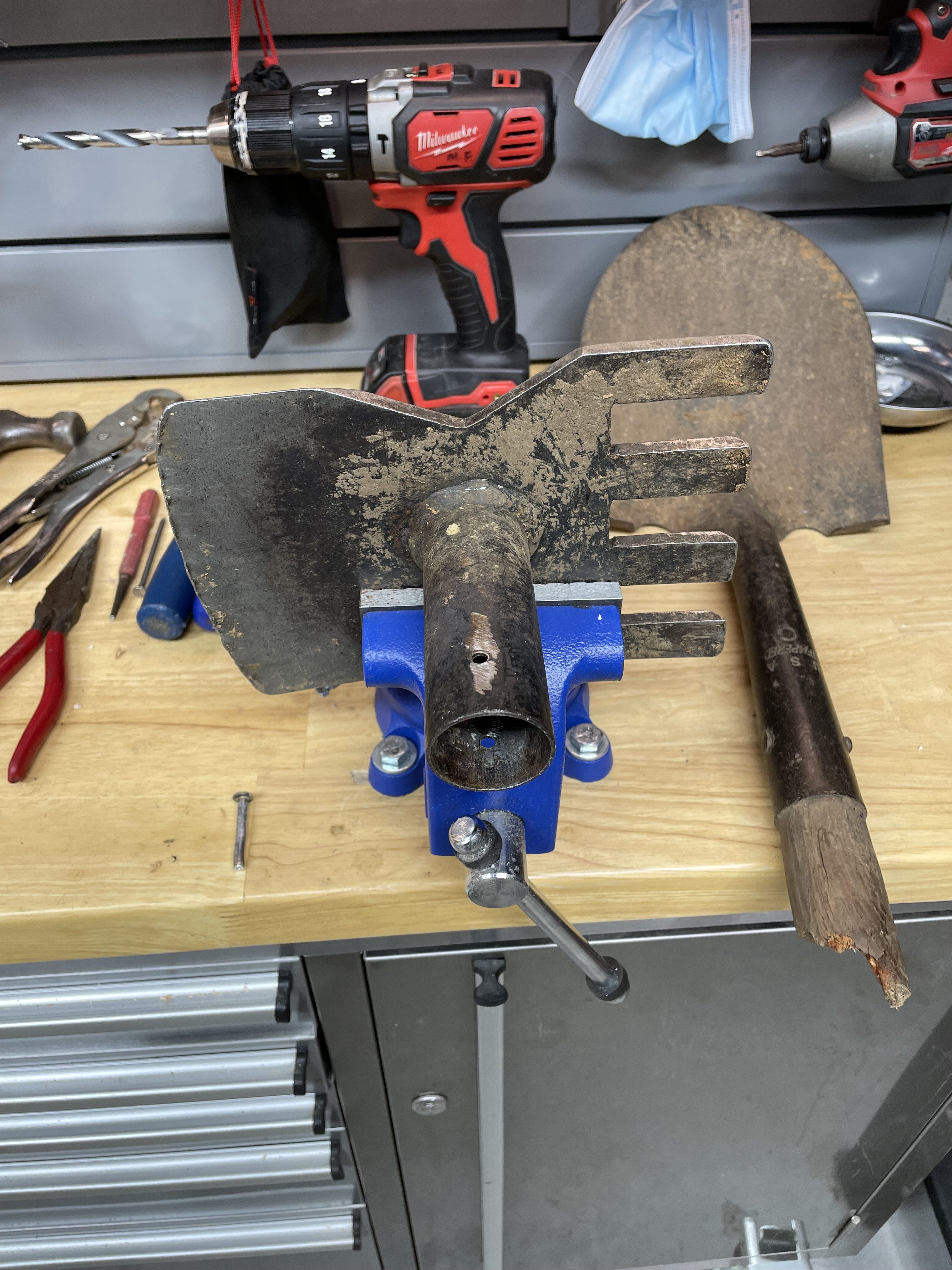

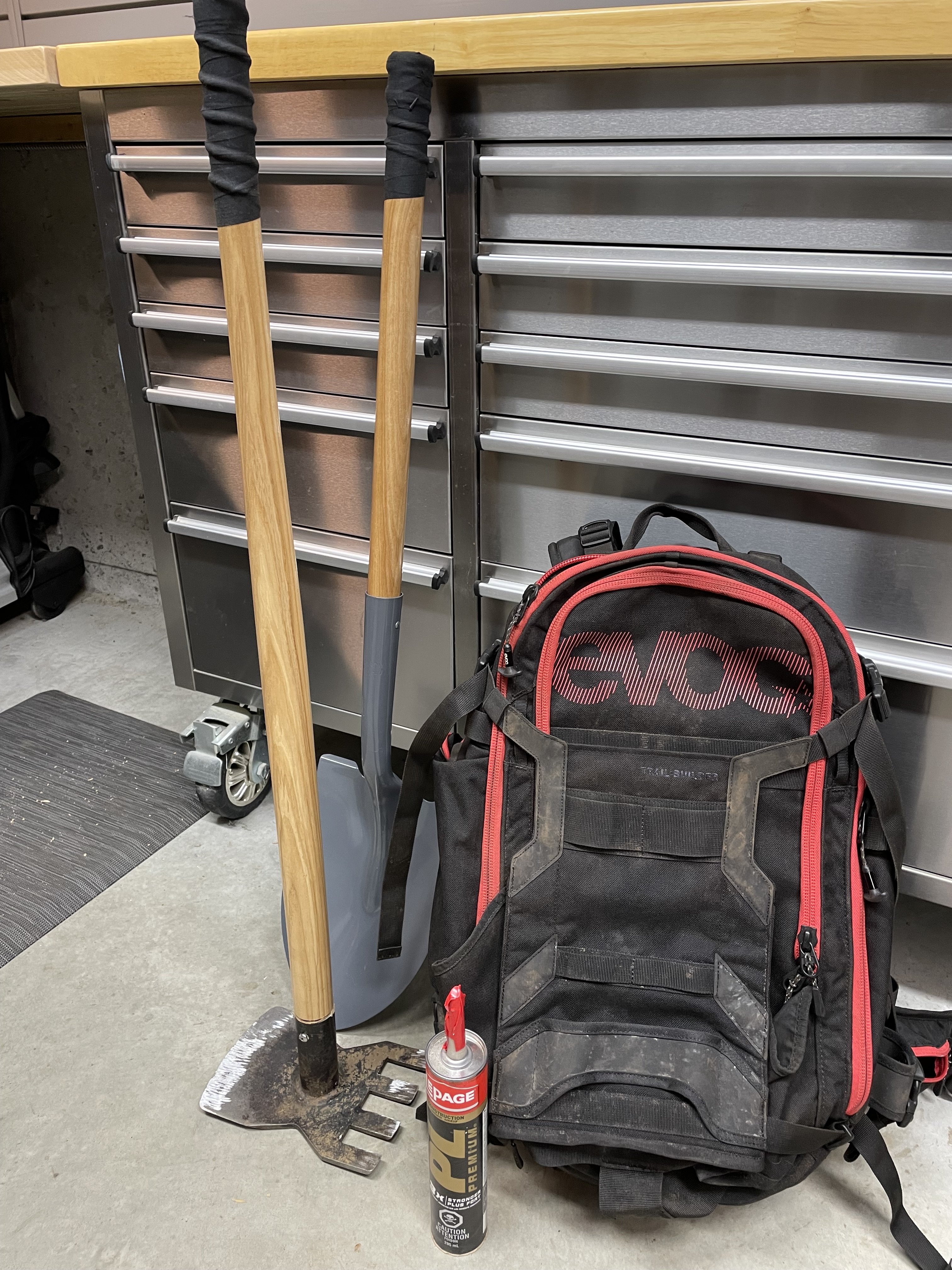

So I finally broke the the handle on both the shovel and rogue this week. I knew the handle on the shovel was about to break, but the handle on the rogue was definitely “operator-abuse”. I tried to use it as a peavy or lever(whoops).
The handle (hickory?) on the Rogue was glued and pinned in place so it took some grinding, drilling and chiseling to get it ready for a new handle. The old shovel had seen better days. I replaced it with a new $13 shovel. A new handle would have cost $25(wtf)???
Anyways, the new handle for the Rogue was tapered and would not fit unless I custom sized it. Cut the taper off (6”) and lathed the correct diameter and depth. Once it seemed like it would fit I added some construction glue (PL 200). Rather than using a clevis pin, which would require mushrooming on one side, I used two stainless steel wood screws with round heads. Seems to work.
I cut the handle to length (shortish) and wrapped the ends with hockey tape (for those serious digging moments 😉) and better grip. Hockey tape is like duct tape but with better grip. 👍🏻.
So it all fits in the Evoc pack, along with the chainsaw and other things. I generally stash the tools close to the trail in an ole stump. I wrap the electric chainsaw in plastic bags but the other tools can be damp sometimes.
RustyIron
Jun 5, 2021
1,915
3,010
La Habra, California
Nah, the handle was junk, and clearly not robust enough to withstand REAL work.
I like your treatment of the ends with what looks like cord wrapped underneath the friction tape. I might give that a shot on one of my hoes.
Y'know... I've never understood why manufactures put a pin through a taper. I can't tell you how many times I've had a handle break, always at the pin. I've started epoxying handles into place, as there's nothing worse than trying to work with a wobbly handle.
Stihldog
Handheld Power Tool
Jun 10, 2020
3,936
5,572
Coquitlam, BC
I agree. Those pins can be a pita.
The grips are the same I’ve used for my hockey sticks. Peel out one arm length is tape, then spin it so it looks like a cord. (Don’t cut)Starting at the end of the handle and create a small knob. Then wind the tape-cord down the shaft until the tape is flat again. Now start taping towards the knob while covering the tape-cord and finish with a few wraps at the knob. Done!
I’ve done many many hockey sticks this way …takes me about a minute…and usually last until I break the stick (one stick every 3-4 games on average). $30-$50 a stick back then. Now there’re $300+ fake wood (carbon).
