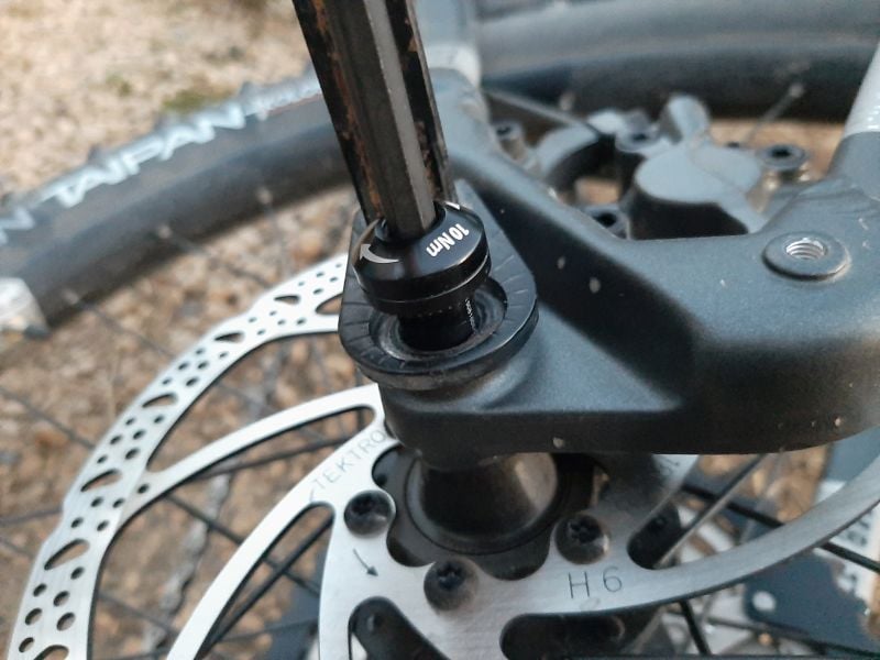

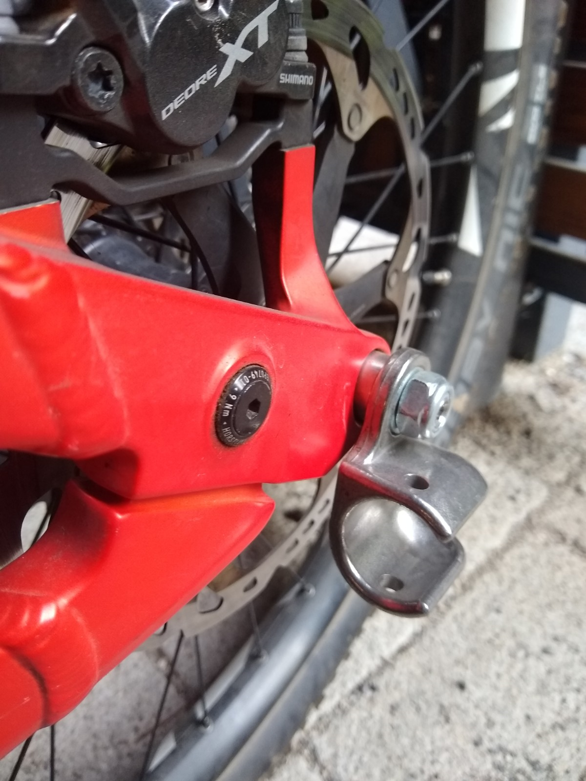

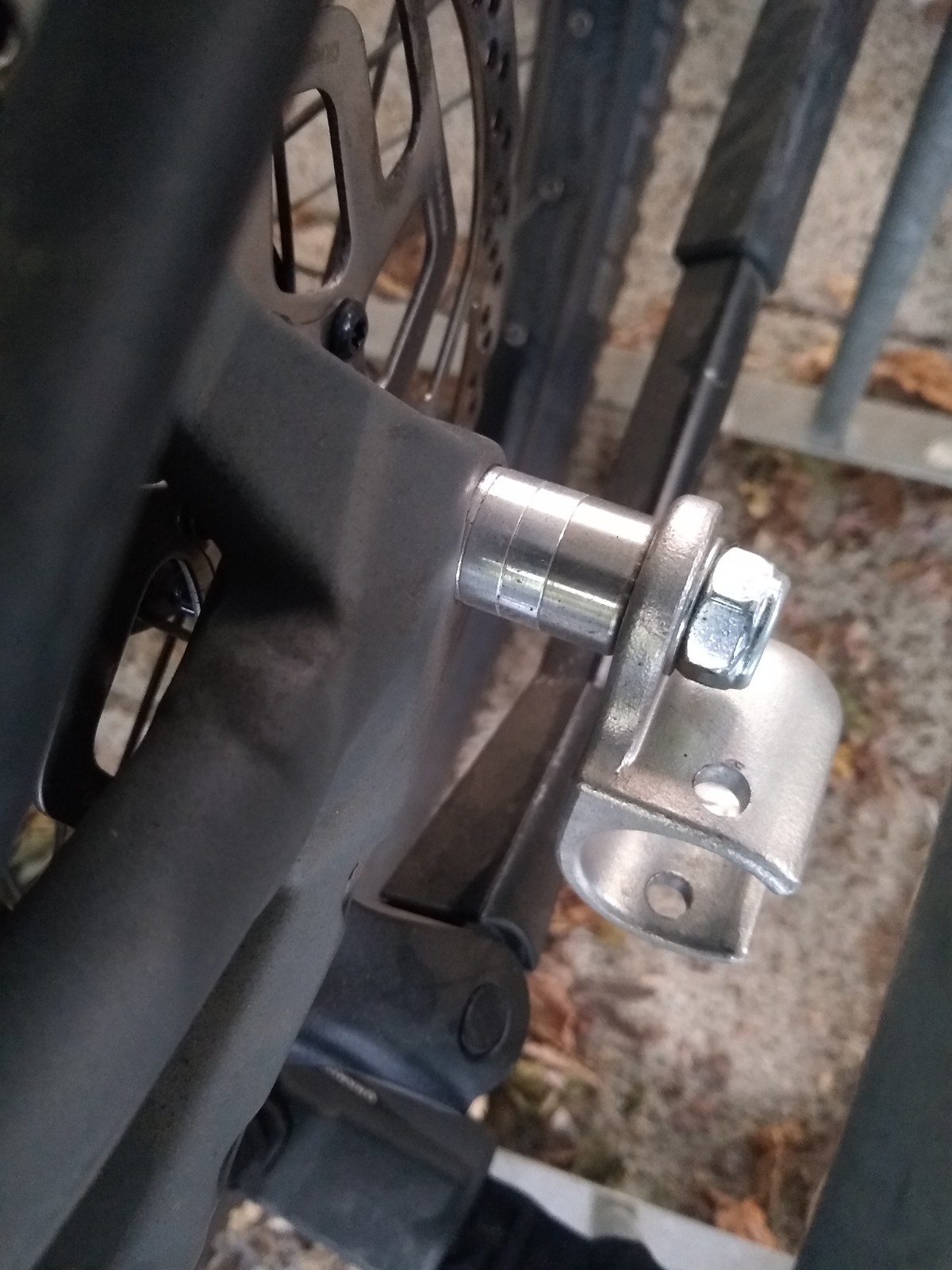

Getting the Thule 'clutch' attached to your rear axle requires replacing the axle that comes on your bike with a Thule specific axle that is a a few cm longer and has space for the metal bracket that holds the trailer arm. If you can't find one that fits exactly, like we did, you can go a size up on the Thule axle and add spacers, like you see here:
Here is the Thule axle on a Spectral On, the fit was perfect and didn't require spacers:
Towing the trailer with the rear suspension doesn't create any detrimental feedback, and lateral forces haven't cause us any issues. We've bike about 500km so far without issues.

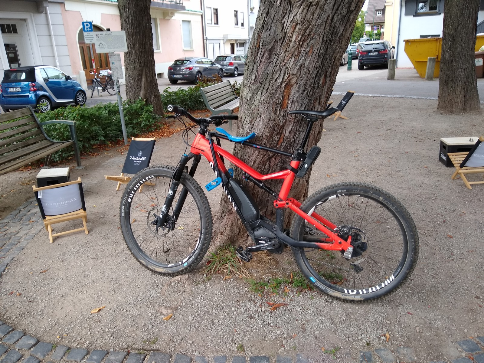

An inconvenience to note is that most EMTBs do not come with a kickstand, for obvious reasons, which can make connecting the trailer to the bike a bit of an artform. However, the Focus Thron does have a kickstand, and it works very well, as the bike stands on its own when connecting the trailer.

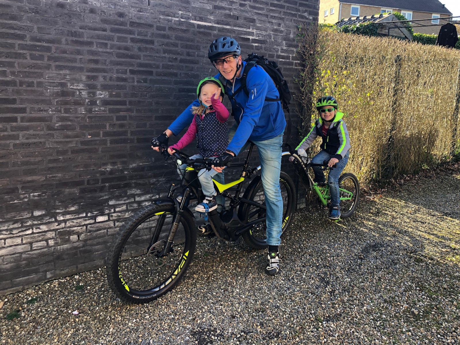

For those who want to carry a kid but are annoyed with connecting the trailer without a kickstand, there is an alternative, the Mac Ride, which is pictured below.
In some respects the Mac Ride is superior to a trailer, as the child can see where they are going and are more engaged with the ride. This means they can tire out during the ride then sleep at home, rather than fuss in the trailer because of boredom. On the other hand, a tired kid will struggle staying awake on the Mac Ride, and tends to want to let go of the bar and lean on you as you pedal instead.
The best thing about the Mac Ride is the child can mount and dismount quickly, making it much easier than connecting a trailer, and a good solution for taking the kid somewhere and dropping them off, or just going to visit something. Similarly, the Mac Ride is easy to remove and use your bike as its intended, for trails. I recommend both the trailer and the Mac Ride, different solutions for different problems. A trailer is better with a kick stand, the Mac Ride is better for an actual mountain biker who wants full use of their bike the majority of the time.
It took two ten minute rides to get our 2yo acclimated to the Mac Ride, so twenty minutes of tears and screams of bloody murder, but now loves it and is fearless. Before we had trouble getting him to wear a helmet, but now that he understands a helmet is required to ride the 'big bike', he has no issues putting the helmet on. It was a welcome surprise.

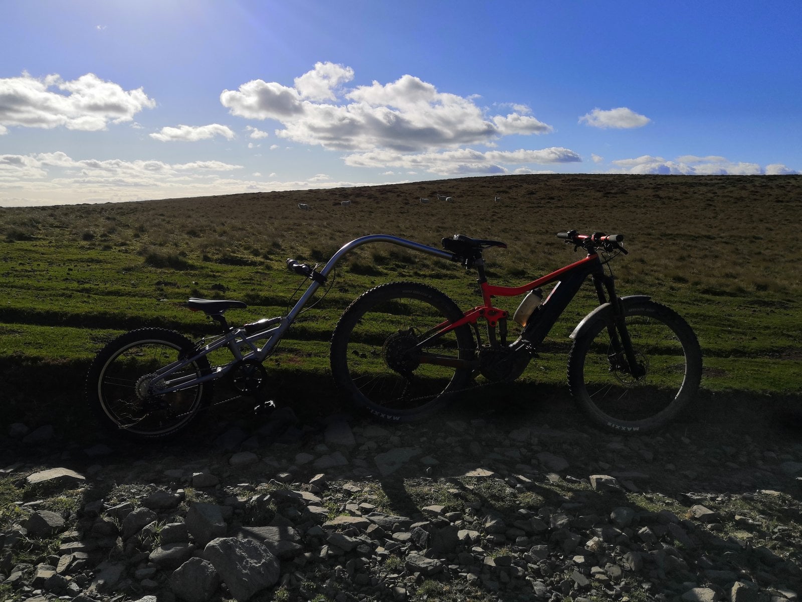

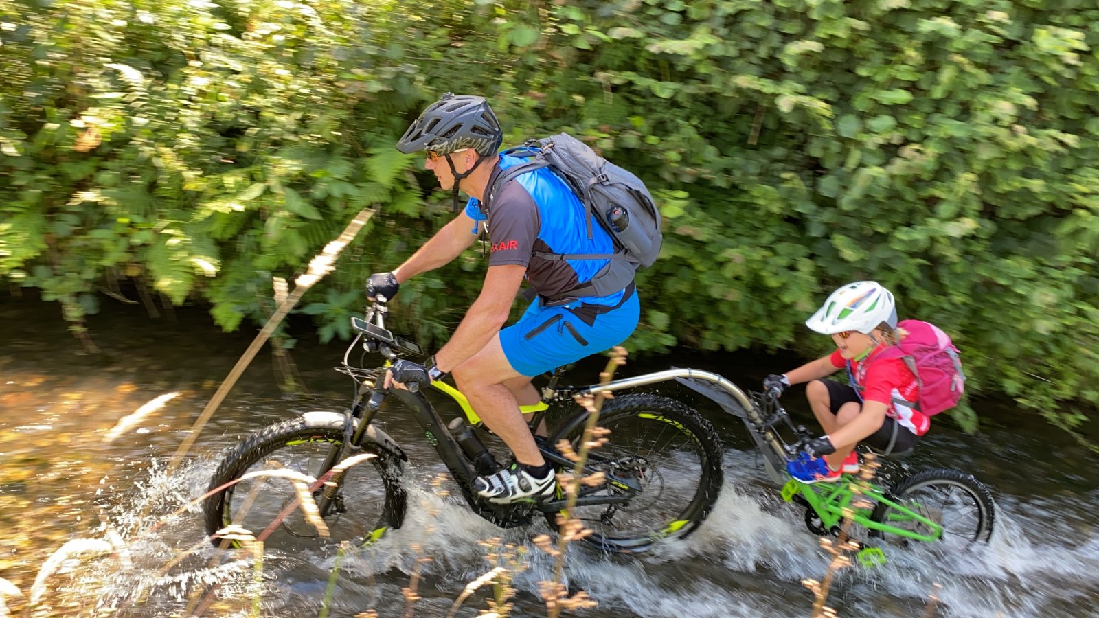

Some more info / experiences for you:
I've got a dropper seatpost on my Meta Power 29er, and have a 2nd rigid post for towing. This has had a trailgator bracket on, and currently has a WeeRide bracket on. This lets me reasonably quickly swap between towing vs normal riding - I didn't fancy having the brackets on a dropper as they'll likely damage the finish / stop it working while fitted / be a pain to fit and remove each time. With both of the systems below you keep control of your kid's direction and speed which has let me take my boy out for rides from him being about 2.5 years old. Before that it was a hamax seat on an analogue hardtail.
The TrailGator (pictured below) - a tow bar with brackets that fit to your seatpost and round the headtube on the kids bike. The setup lifts the child's front wheel off the ground and has a securing rod to keep the handlebars mostly still. The brackets are intended to stay on permanently, and you can remove the bar fairly quickly allowing your child to ride themselves. I've used it to take my boy to a park, let him ride round, then bring him home again. It's also been pretty decent for taking him to nursery/school over the past couple of years and then be able to bring his bike back home solo.
Downsides to the gator - it's a heavy lump of iron, any spare parts are so expensive you might as well just buy a new one. It's very sensitive to any of the connections or parts being out of plumb. If everything is dead centre on and between both bikes then it rides well. If it's off then you feel like everything is leaning to one side, and it'll push further out of true. A bit of time spent getting the setup perfect pays dividends. Also, it's almost impossible to get the connection tight enough on the kids bike without causing marks in the paintwork. I ended up cutting up an old road bike tyre to act as a protector - tubes weren't enough. Finally, if your charge easily gets in a grump then remember to disconnect their brake! Doubly, don't forget to reattach it afterwards!
The WeeRide is more like a towbar with 2/3rds of a bike on it. There's a set of bars, rear wheel, pedals and seat. The tow arm folds up when not in use. This has had some work done to beef it up and being honest we're probably pushing past the intended use - new BB and cranks, a chain guide/tensioner (it kept coming off), new seat, fatter and more nobbly tyre. It's also had the "safety" lugs removed that stop it turning past a certain angle as it was far too restrictive. It's far more capable and useable after these mods, and with only one connection point it's much more solid feeling than the Gator.
Between me and brother we've got this setup and boy (4) round both Llandegla blue trail and Gisburn's red 8 trail (except the boardwalk bit, and we did Long Way Down instead of hully gully). Gisburn was a hard day out with a fair bit of pushing / heaving over the sharper lumps but it got round and we had a great time. The main issue is lack of clearance over my 29er wheels - it sort of grounds out over anything but a mild lump. Tacking diagonally over lumps helps, but I guess a smaller wheel would as well. (will add a pic of that setup, likely tomorrow after it's used for the school run!)

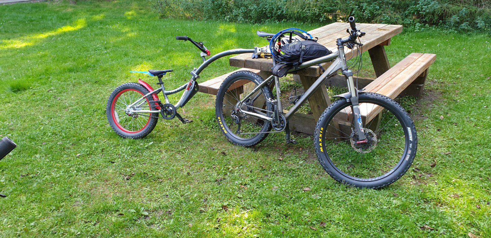

Here's the Wee-ride I mentioned in my previous post. Of course, my lad didn't want to be attached to the only ebike in our little group today. CBA to swap the wee ride to my bike to fake a photo!
We did the blue Querious trail at Whinlatter with no issues at all, and took it down the little bit of red near the Revlin Moss car park.
Mods list:
New pedals
Cranks
Bottom bracket
Chain tensioner (rear wheel hub is v poor - so wobbly the chain was coming off)
Removed the "safety tabs" that stop you turning sharply
Trimmed the bottom of the steerer tube
It's not bad now, and the fat tyre smooths the ride for kiddo. He has a great time which makes all the above worth it.

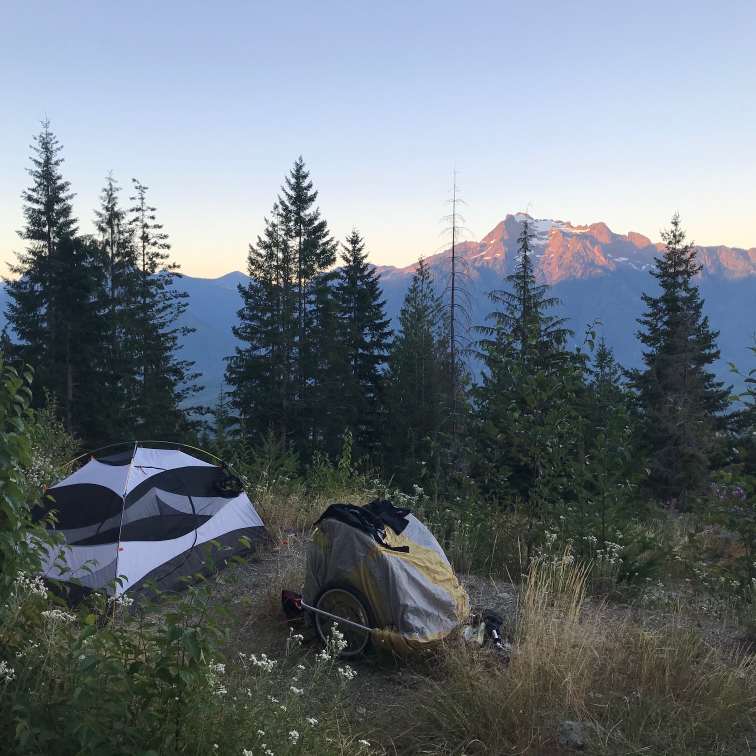

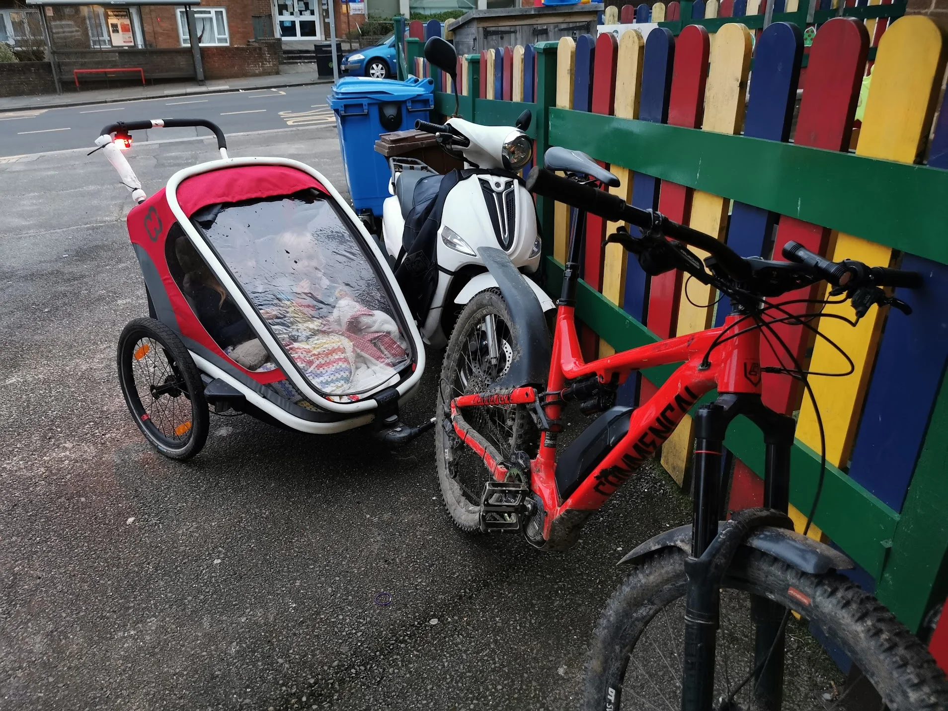

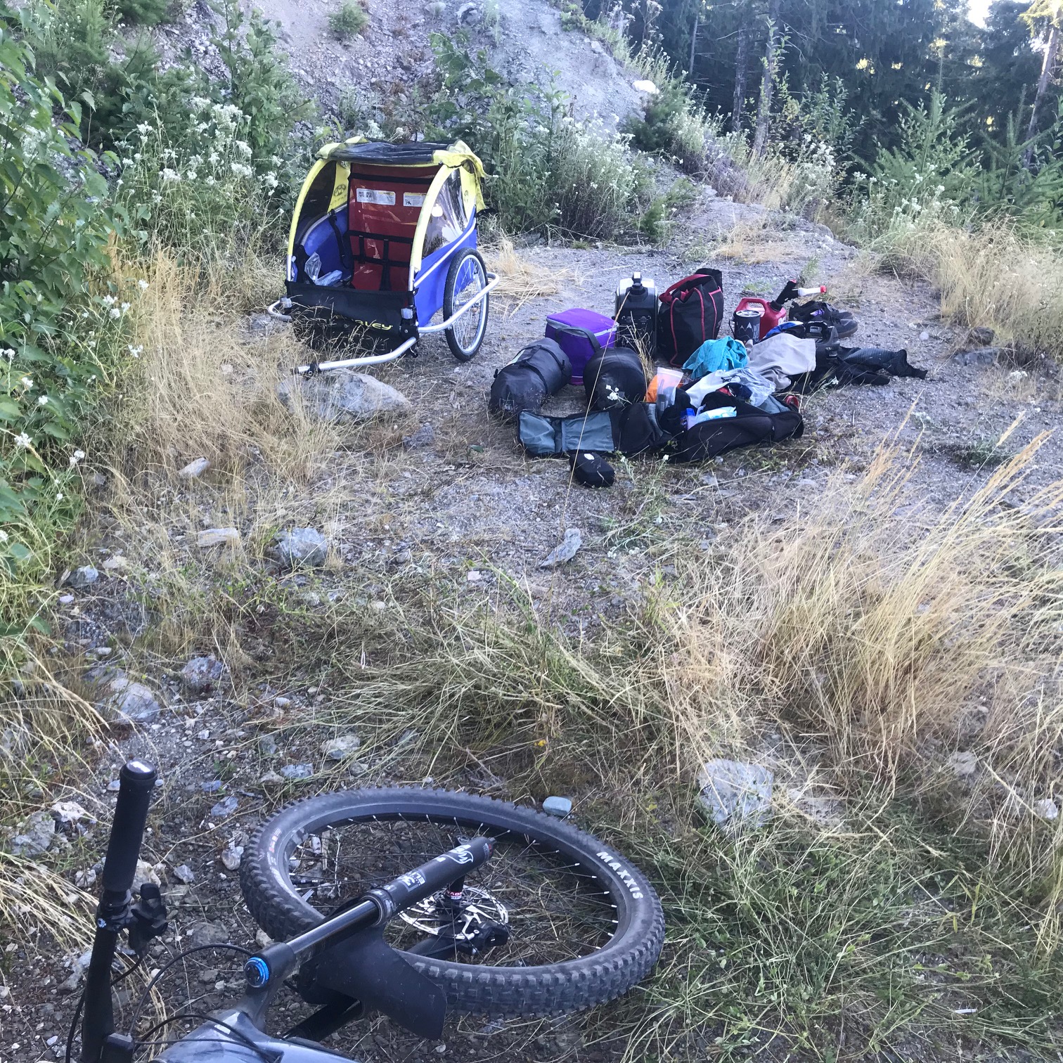

We have an e-cargo bike for extended trips, and the kids like to pedal / push now, but I am pulling their kid trailer with my eMTB for camping.
I load up an old Burley trailer with my whole camp and hit the trails.
Bike is a Norco Range VLT. Beast. I got an extended axle from Robert Axle Project and it's been great. 30 second swap with a 5mm allen wrench and it's time to go ride.

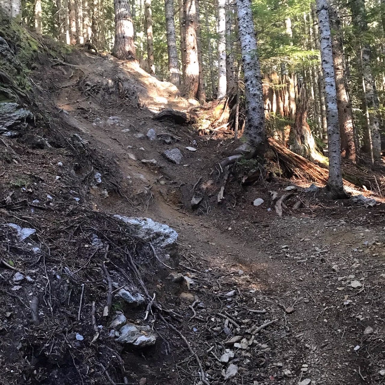

The trails are North Mountain in Darrington, WA. Steep trail system that was designed around shuttling big bikes in the backs of trucks, and it's a perfect fit for the Range. Beefy. I've been riding there since March with a few friends, and our eebs have been knocking off more vert per day than all but the most dialed shuttle crews. We'll ride a few laps, charge bikes on a 800W generator I got from Home Depot* as we eat lunch (or drink beer at the campfire), repeat. I've been riding MTBs for a while, can't say I've experienced a better setup.
So, yeah. It's great to ride the local trails on the eeb, but combining it all with camping has been a revelation. Doesn't hurt that the trails are amazing.
*I tried to figure out a solar / battery solution for off-the-grid charging, but it was just too heavy and expensive no matter what I researched. The 40cc gas generator has revolutionized my MTB life: 0.5 gallon tank runs for about 8 hours. With a power strip I've been able to charge three bikes at a time, the generator handles it, although at its limit. (Shimano E8000 chargers with these Norcos draw around 200W each, and reviews of the generator say it'll cut out before it hits its claimed 800W...) These little 40cc generators are about the size of your old desktop computer, 19 pounds empty, so great. Can't recommend it enough. Revolutionized my eMTB trips.
View attachment 40822 View attachment 40823 View attachment 40824

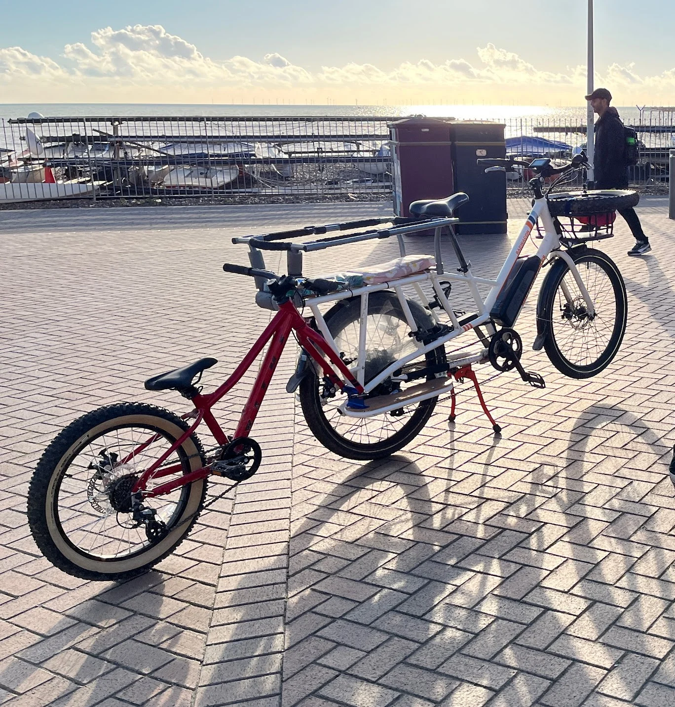

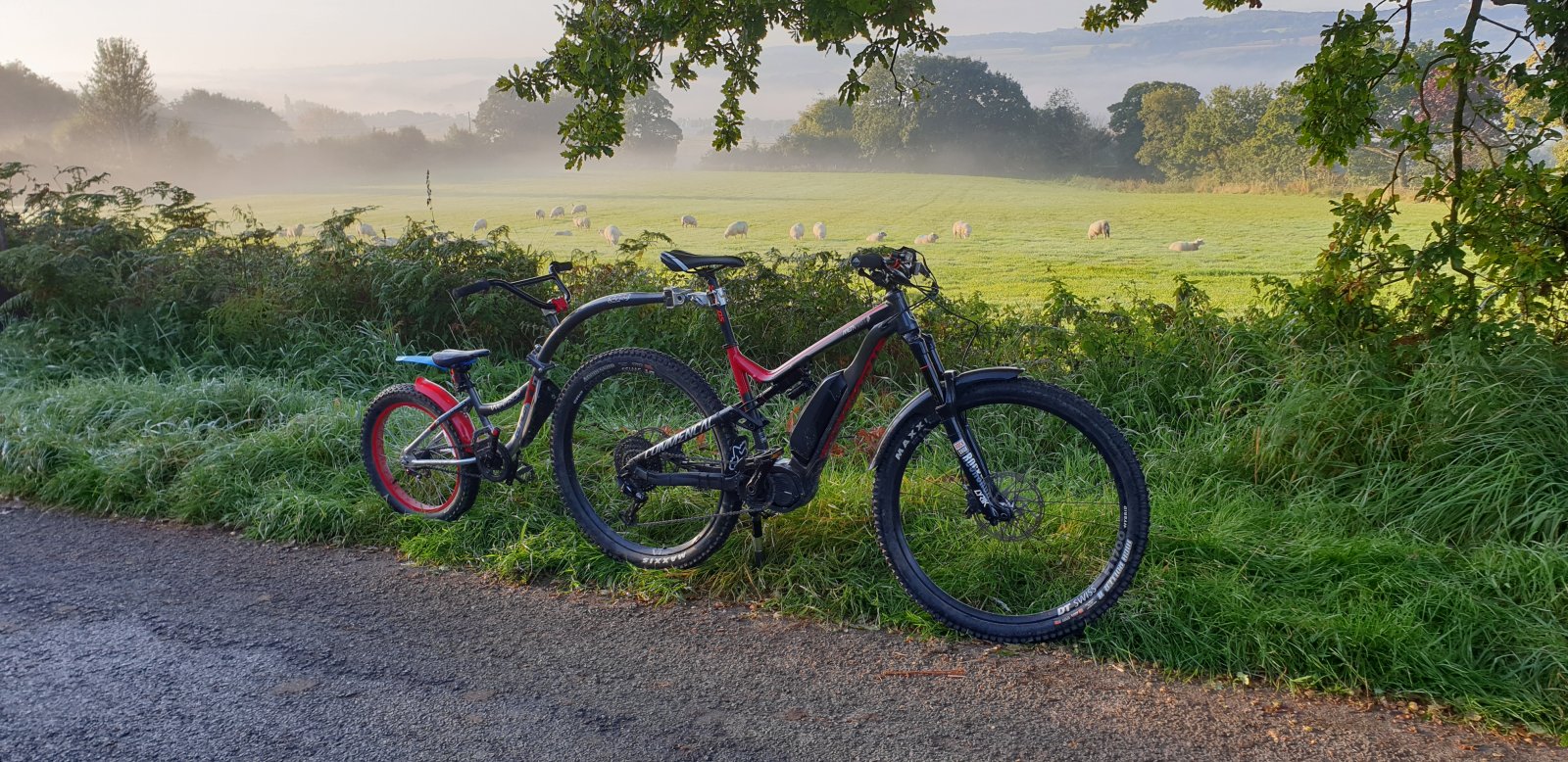

Mine and my daughter's new set up,
Tout Terrain Streamliner.
We were given a cheap tag along to try out and daughter loved it, but because the wife is a shorty it didn't fit her bike, this does so we can share the load.
