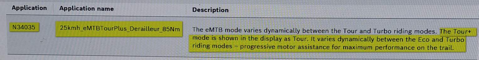

I've had Tour+ for a couple of months. I find it does exactly what you'd expect, switching to the right mode for the moment. I never switch modes manually these days. Initially when I got the upgrade, my display was a Purion. After about a month I got a Nyon fitted. Neither of them actually display Tour+ , just Tour, so don't expect the display to change if you get the upgrade done.

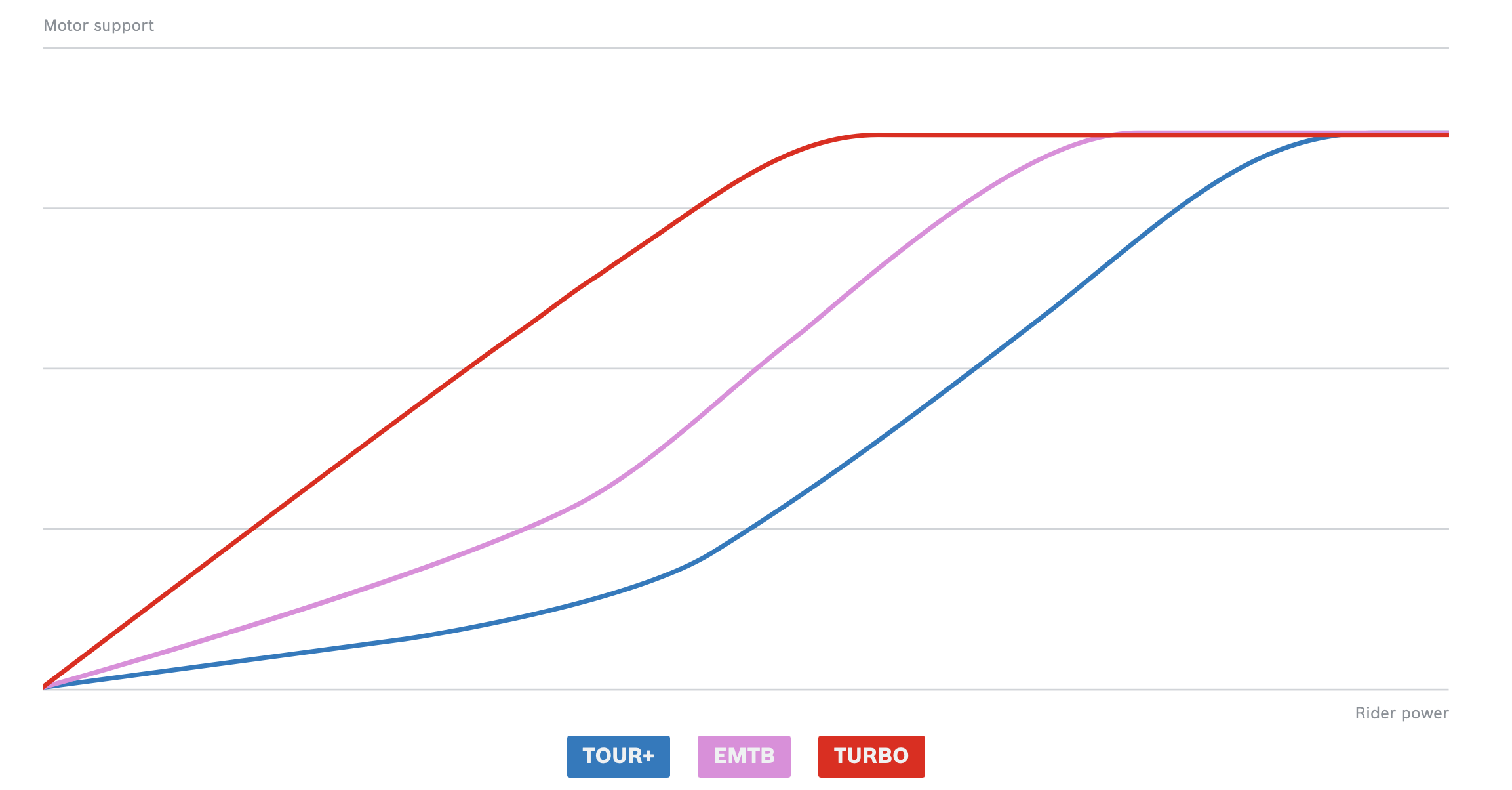

With tour+ enabled do you still have e mtb...if so isn't this the same thing.

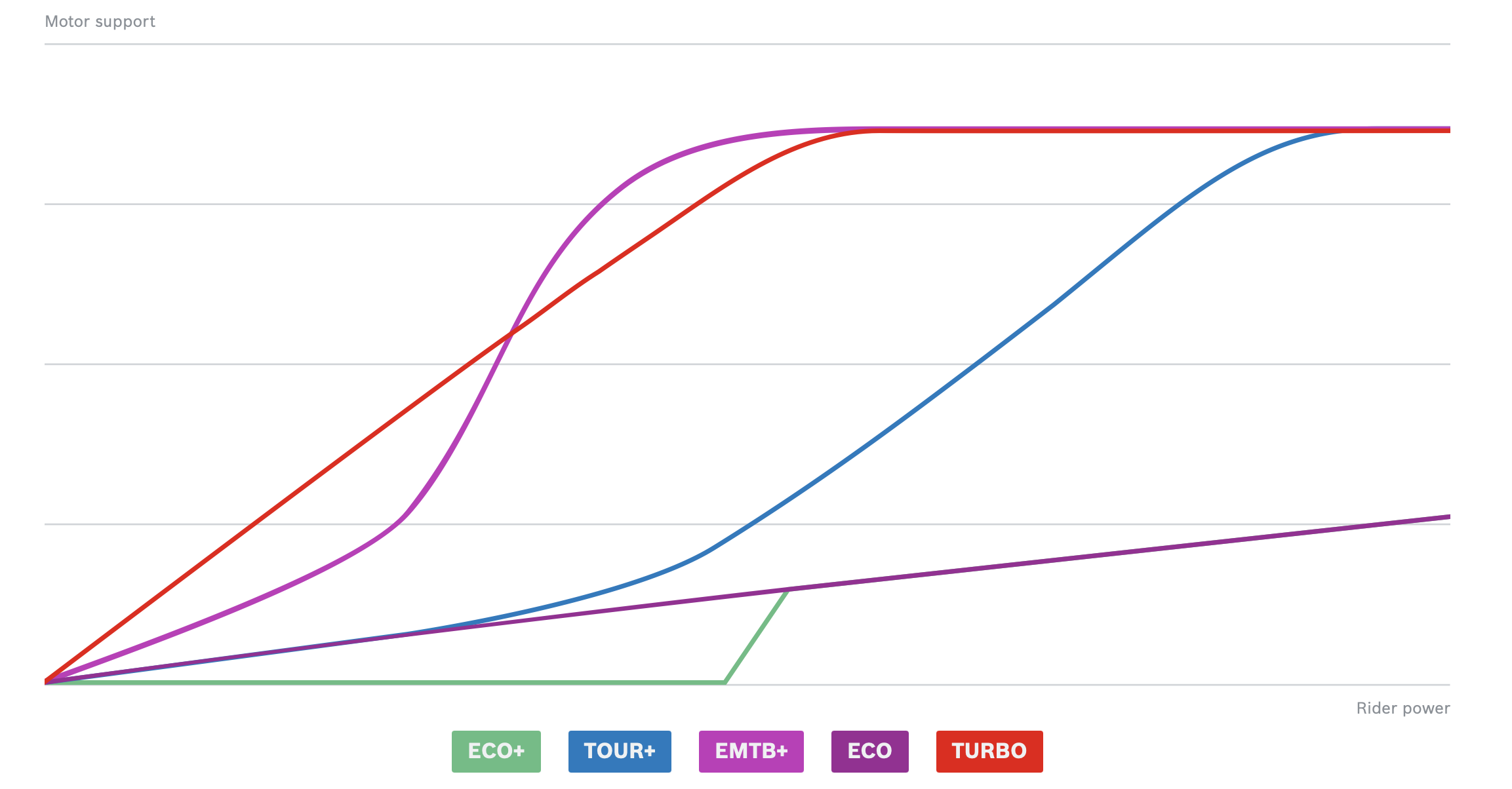

This should answer your questions .. there's even graph's ! :)

I had tour+ mode installed a while ago, and now having used it for quite a while I think I preferred the old tour mode.
Hard to explain why I prefer the old tour mode, but I think it because whilst tour+ does give you automatically varying assistance from eco levels all the way up to turbo levels, it takes a lot of power input from you to get access to the higher levels of support. It likes to stay in the lower levels of assistance - which I guess is what those graphs in the thread above show.
it not a big deal and I wont get it switched back to tour (mainly because I cant be bothered to go back to the dealer), but I think I did prefer the old tour mode.

Tour+ gives more support but drains significative more juice . Unfortunately user cannot change from Tour to Tour+ or vice versa. For longer rides Tour mode could be a good choice/option in the pocket to extend range.
