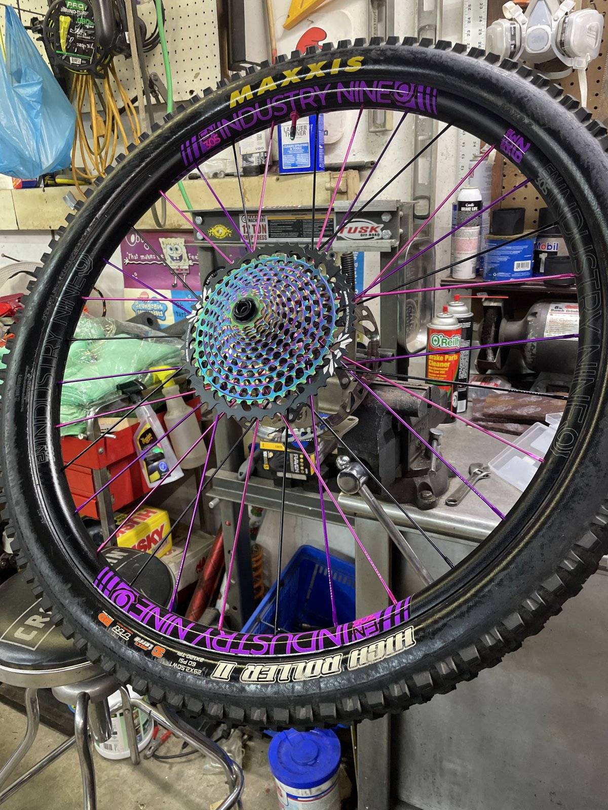

Industry nine

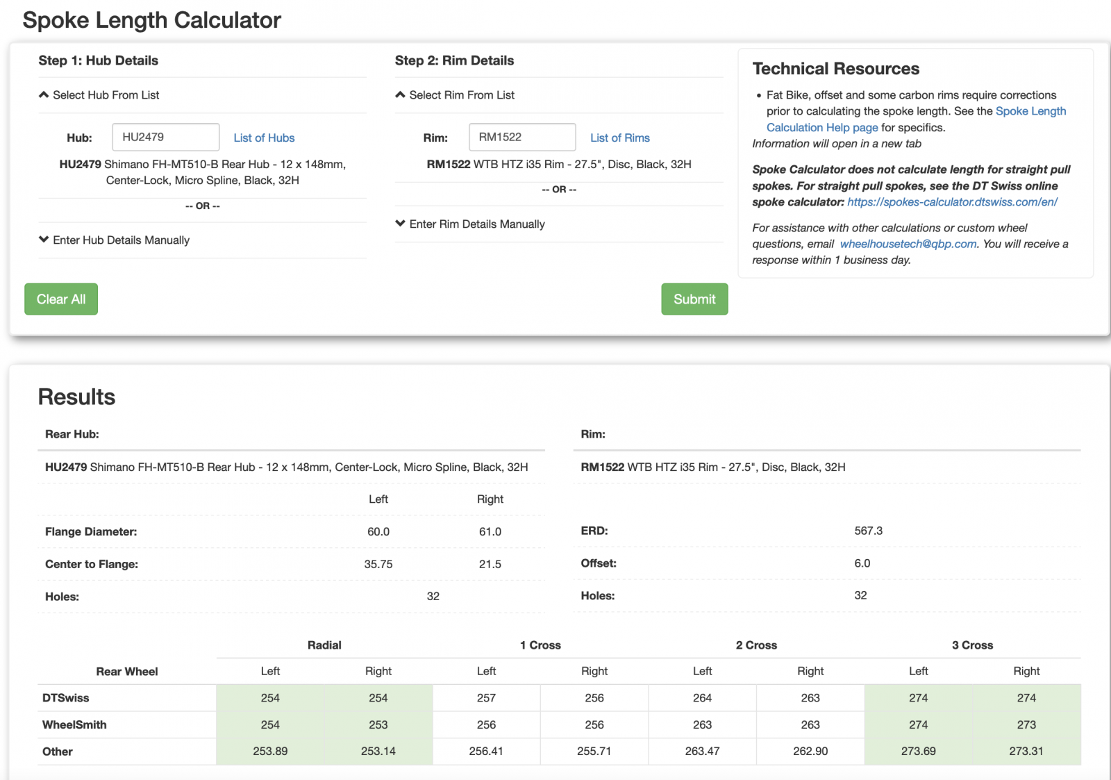

While I would never re-use nipples if the spokes are relatively new I would have no issue using them but of course new ones, I recommend Sapim Strong's, would be the best way.
Here are the size(s) you will need depending on the cross pattern.
Thanks a lot man. I didn't find any that could search for the last existing rims and hubs. It's very useful.
Sapim strong aren't too much heavy to use it for a non gravity use? I mean, 2.0mm in the middle section and 2.3mm in the "j" where I never have broken any... I think it's not the best for my riding style. I have always broken all spokes in the head part close to the hole.. And there, the size of this spoke is the usual, 2.0mm...
