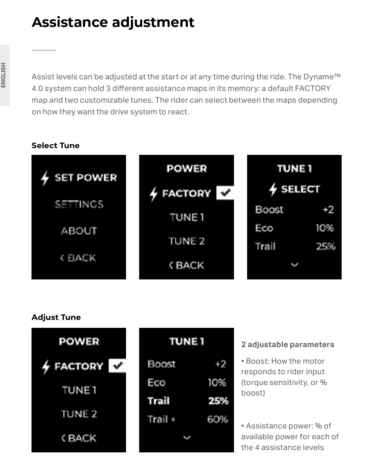

JordanF
Nov 5, 2022
Vancouver
adjust it to Boost +2 , it'll ride like how you want it to ride. Save it in tune 1 and never look back lol
