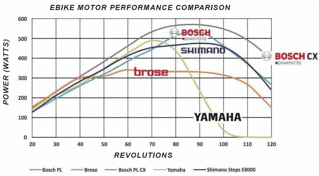

Car manufacturers have shown torque and power curves across the rev range for decades. That seems to have stood the test of time.
I always understood that the power shown was the continuous power available at the rpm shown, not the peak power.
But of course the big difference is that the power unit there is an internal combustion engine and not a battery, which is a markedly different power source. So what does Tesla do?
AFAIK, the power and torque charts have always shown maximum power (a.k.a peak power). It's something that an engine can output a brief period of time, but no one expects that you can drive a car "flat out" days on end (like "continuously") - and still keep regular service periods etc.
The definition of the legislative "250W continuous power" is one of the great mysteries of our times. I have searched through the whole world wide web without founding any valid technical specification for it. The Illuminati must have hidden the original copy and now reveals it only for the chosen ones.

Isn't power really limited by how many volts x amps the controller puts out rather than the motor?
As a roadie that averages about 85 rpm cadence (maybe 10 rpm less on the mountain bike), the Yamaha motor wouldn't work for me. I think it's a bit ridiculous how "peaky" that motor is.

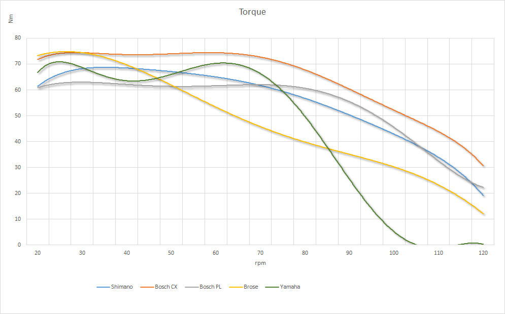

This is not Shimano related post, but couldn't find a better place for posting, so here we go.
I found power curves of few motors from the electricbikereview.com and did some "reverse engineering" to visualize also the torque curves (something I've not seen before). I was interested in torque, because when climbing, torque is usually more relevant than max power and also because I was frustrated of reading manufacturer torque claims without any reference to corresponding crank rpm.
Some of you might be interested in this, too:
The original power chart looks like this:
Flame on.
I can tell you that the the power chart that is posted is incorrect regarding the Brose as would be in a Specialized. I have an early 2017 Hardtail with the Brose and also a 2018 Haibike with the Yamaha PW and there is nowhere in the rev range that the Yamaha is noticeably stronger. The Yamaha actually does show the predicted roll off of power above 90 rpm. The newer PW-X2 would be better. The Specialized continues to make good power all the way up to as fast as I can spin my legs. 120-130 rpm. RobRides did a good video with a drag race hill climb of the 4 newest versions of these motors and the results were Bosch 19.78 seconds, Specialized Brose 20.32, Yamaha PW-X2 21.07, and Shimano EP8 a distant 23.31 After the first run showed an early roll off of power in higher (normal all out) cadence and clocked in at a very disappointing 26.76 so he did it again with a lower cadence. He does go on to say later that the Shimano has a very natural feel to the torque sensing so I am still considering buying a new E8000 bike with external battery since I never use my Specialized on the highest setting which makes it a little too jumpy to control in tight trails if it is muddy anyway.
