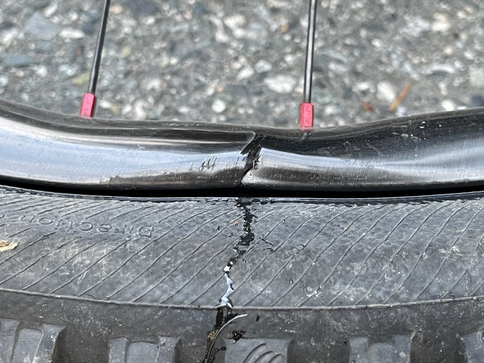

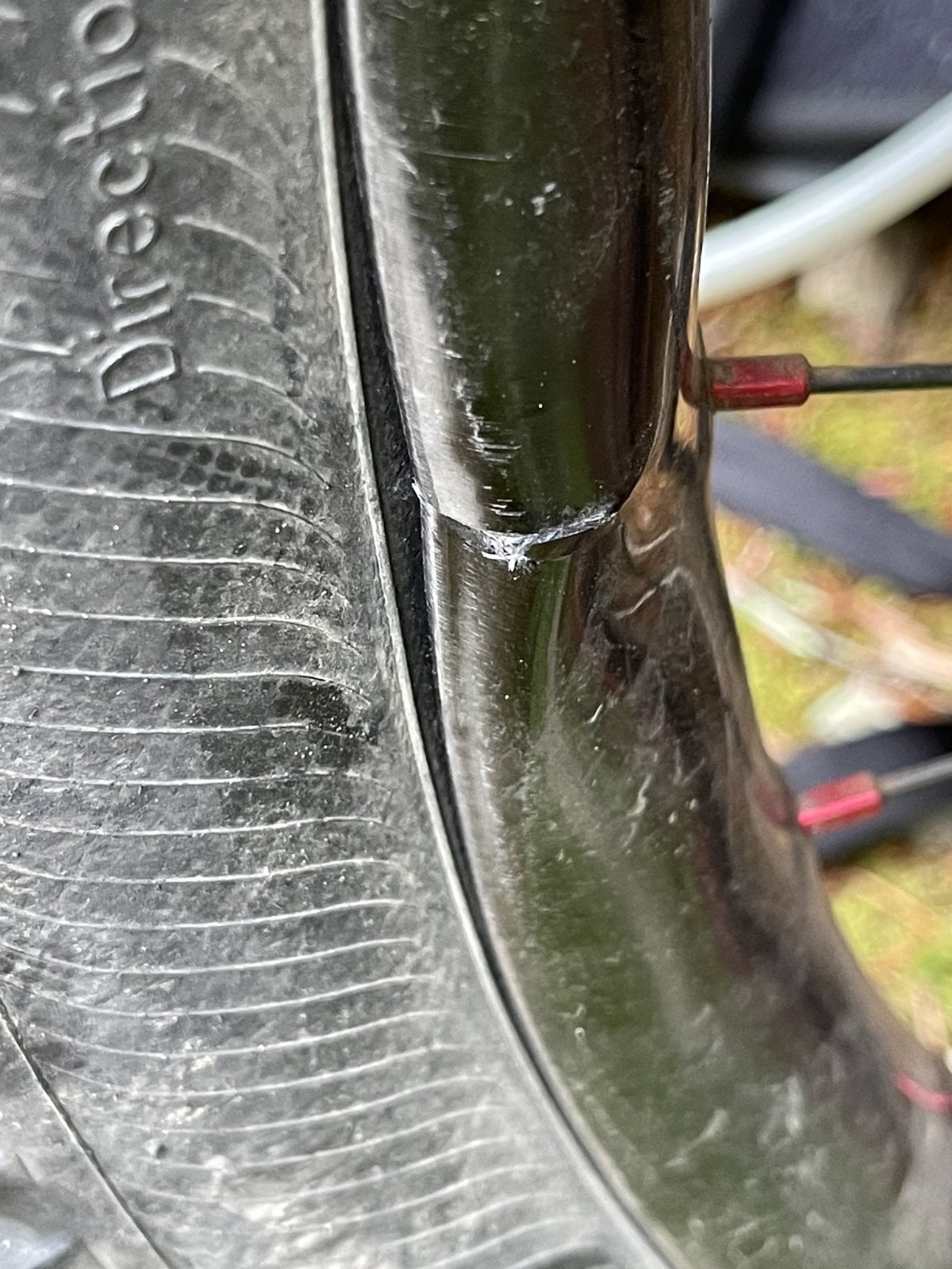

I was about 10km up the mountain away from the car this evening when I noticed I had a flat, and then further inspection revealed a crack rim. I had a CO2 cartridge with me, so popped in some air, but it didn't hold. Without Cushcore I'd have had a long walk back to the car, and probably wouldn't have made it back before dark.
If you're thinking of getting a tire liner, I'd say don't hesitate. Totally saved me this evening. And being able to limp home with no air in the tire is only one benefit of a tire liner.

Damn dude.
you had to hit something super hard and/or were running stupid low tire pressure.
Run 20-22 PSI. I did hear a loud noise from the rear, so I know when it happened. I just hoped it was a stone flying up and hitting something...
It was on a trail called "Neds" out here on the North Shore in Vancouver. Very rocky - well known for people getting flats... and the occasional broken rim... I've been riding the trail for years, and it's actually the first time the trail has damaged the bike. It's damaged me a few times tho!

I got a flat and rode home on cush core no probs .
Just took it easy and avoided rocks and roots . Alloy rim didn`t show any wear and tear .Cush core was fine .

It didn't. As per @Rosemount I took it real slow getting back to the car. Which was still much faster than walking. Even if it did toast the Cushcore it would have been worth it vs navigating/walking in the dark in the woods/mountains. We have bears here who are looking to stock up before hibernation haha.
Glad to hear you made it back to your car alright.
My buddy and I ran into you just at the end of Ned’s.
Man that rim crack is significant. Couldn’t agree more with your assertion of how good CushCore can be.

What a coincidence. I was up there again on the other bike yesterday evening. No dramas this time.
New rim coming next week. No problems with the warranty claim.
