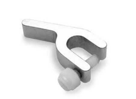

Installed cushcore front and rear on yt decoy after several rides on it without inserts.
My experience:
1) install was pretty easy especially compared to moto. I cheated and used a Motion pro bead buddy two and used the cushcore tool.

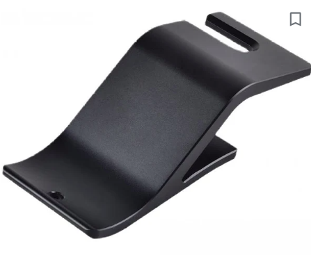

Hi skinipenem \ all.
New here, just a mtbiker looking for info on the bead buddy tools.
Which bead buddy did you use? The "trail or the "2"?
Being metal did you scuff the rims?
Has anybody else done this?
Cheers
Cheers
Those tools look like they are for motorbike wheels. You shouldn't have any problem putting the Cushcore ON the wheel if you follow the instructional videos and keep pushing the bead into the center of the rim. You might want to get a Cushcore Bead Dropper to get the tire OFF the wheel as it can take some effort to break the seal to release the tire bead from the rim. I never use any metal tools on a rim!
Bead Dropper - Cushcore
Cushcore is easy, try a new tannus ad a new wire bead tire ;)
