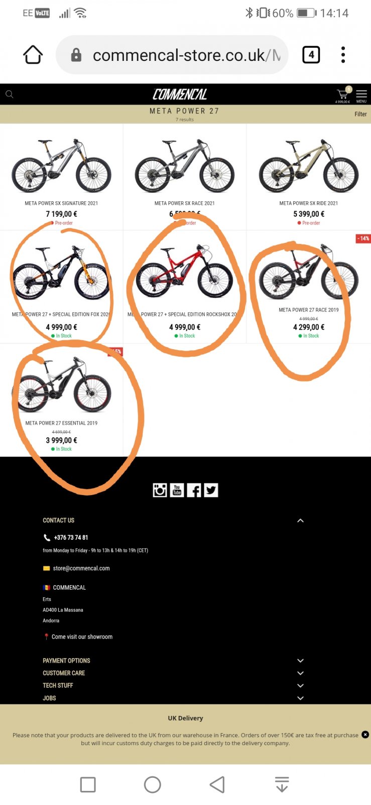

Hello everyone I'm currently in the market for a ebike, and like the look of the 2019/20 commencal e bikes has any had any experience with any of these bikes and can over any guidance
