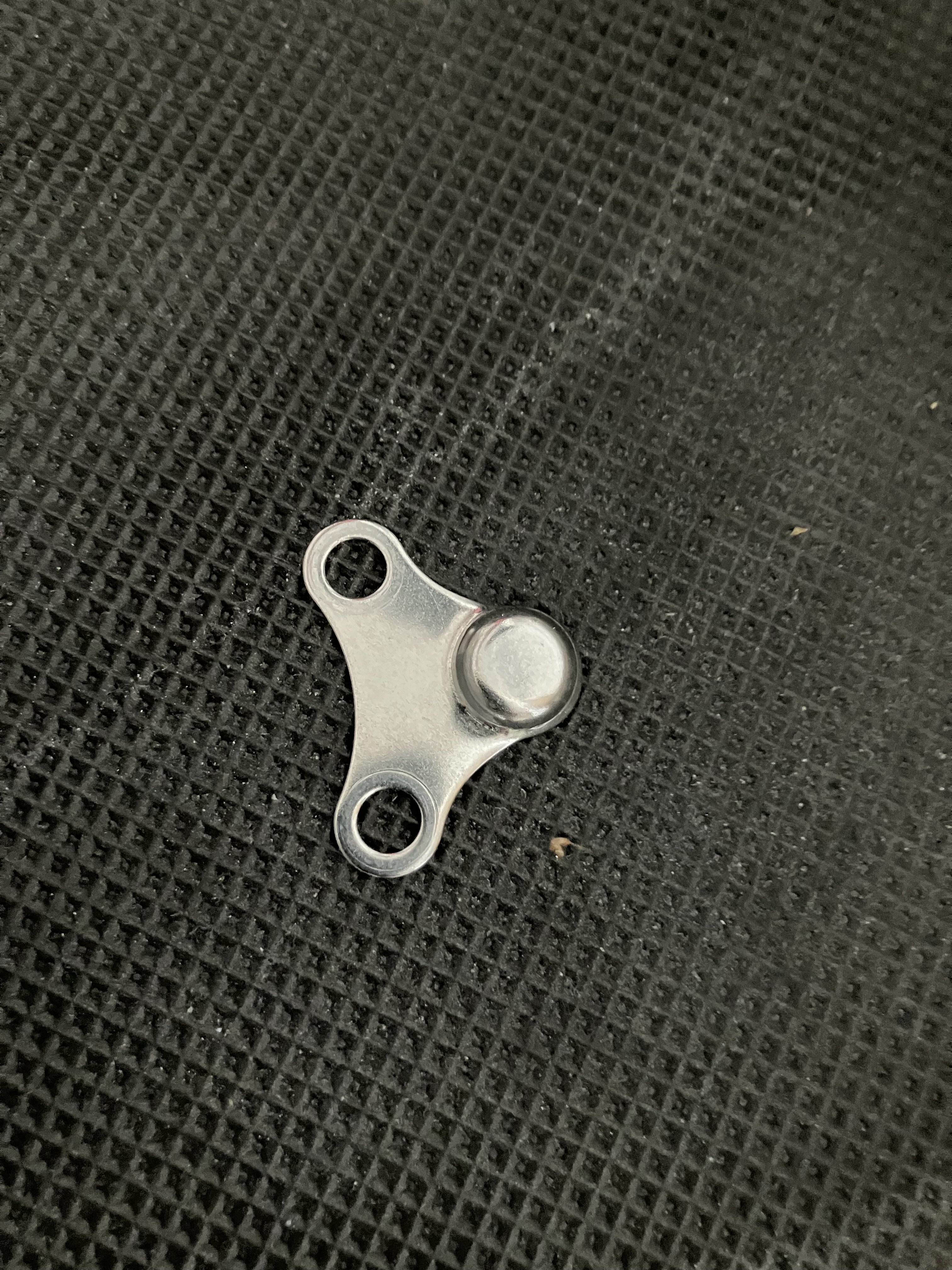

It's not a communication thing. It's a magnet signal thing. What's causing the the error is the pulse, in the speed transducer, from the magnet is different. Most likely is it's a double pulse, created by inconsistent voltage levels as the magnet passes in front of the speed transducer.
Regardless. The induced voltage in the speed sensor obviously needs to be within a very tight tolerance. And only running a Shimano Centrelock hub, will ensure the spacing created when you mount the Shimano Magnet is identical to the original wheel. And will thus produce an identical signal in the speed sensor.

Just to show how uninformed your statement is. I have 2 different branded boost hubs in my spares. On one, the gap from the end cap to where the brake rotor mounts, is 16.7 mm. Whilst the other is 16.4 mm. This would change the magnet position. Which would alter the signal produced in the speed transducer.
This has been discussed in detail in the pedelec forum. People have actually put oscilloscopes on the transducer signal showing how it changes if you use different magnets or have different spacing. But I'm sure you know better. So please explain it, rather than go on some, "Brand Rant".

If you are not getting a clean signal on the speed transducer, because you changed the magnet, or changed the spacing. Then it isn't going to consistently count 1 revolution of the wheel. Sometimes it could count 1 (Counted OK). Sometimes it could count 2 (Voltage just went high enough, the dipped slightly then up high enough again, to produce second trigger). Sometimes it could count zero (Voltage never got high enough to record a count ). So adding the counting errors up could take a varying time to make the error big enough for the E295 alarm.
Shimano EP6 and EP801 motors, see varying speed sensor signals as someone trying to tamper with the speed limit. That's why they have a tight tolerance. So you get a couple of warnings. Then they lock down the motor.

The point is the spacing from the endcap to the rotor must be identical, and the magnet needs to be mounted exactly the same. If you do this. Yes it doesn't matter which hub you use. But if you are getting errors, and the original was Shimano Hub. Then refit a Shimano. The fitting will then definitely be identical.

So magnetic field strength is constant no matter the distance from the magnetic source ? I am getting a good Physics lesson tonight. :LOL:
The strength of the magnetic field is a factor in the amount of induced voltage in the speed sensor. If that volage is too low. You can count double pulses or no pulses, or the correct pulses. That causes E295 errors in the EP6 and EP801 motors. The discussion has been had on the pedelec forum.

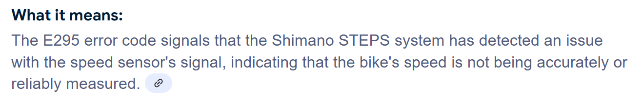

At his time, i don't read that EP601 had error E295 (real subject of this thread)
EP6 runs the same firmware as EP801 and has the same issue. It also develops the E295 error if the speed sensor and magnet are not positioned correctly, even though the speed seems to display correctly on the display.
