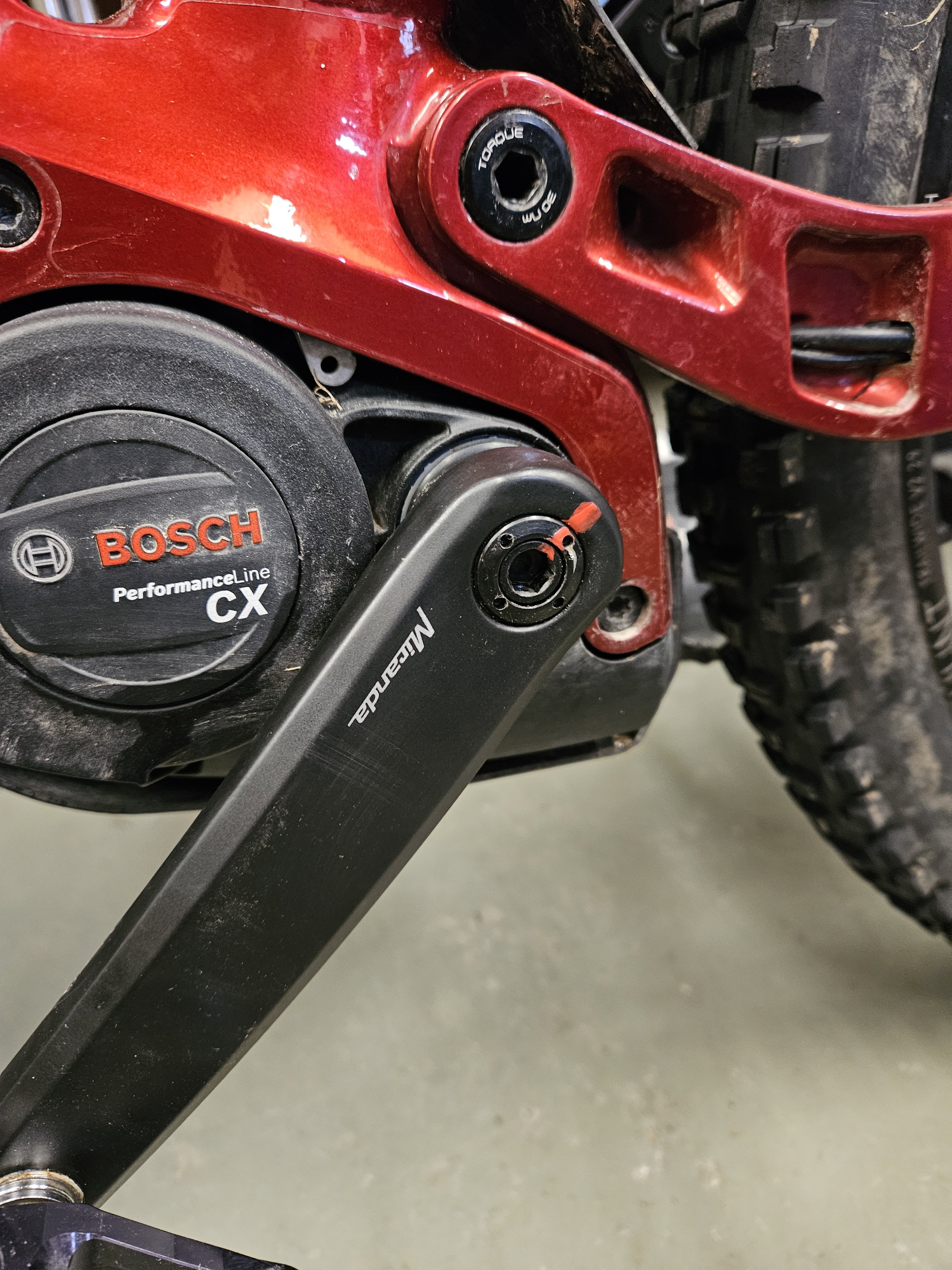

When commuting to work this morning, I noticed that my left pedal was wobbling. I stopped to check, and suddenly had the complete crank arm in my hand :eek:
I have a 15km commute to work (into the nearest town), most of it in rural areas. Luckily, I had reached the urban area, so I dropped in at the tire shop where I buy both my motorbike and car tires. I borrowed an Unbrako key and remounted the crank arm. I guess I lost max 5 minutes on the incident.
However, I must say i'm quite surprized that this could happen. The bike is my Haibike with Bosch CX smart system, and it has done approx 550km since i got in in September. Quite a new bike in other words.
When I get home, I will take the crank arm off and inspect it. Is there anything I should do / check before I torque it down to the torque value stated on the screw's head? Should there be any grease on the splines? Anything else? I guess it could be wise to check the other crank arm as well.

I found my left crank loose the other day too. I do remove mine regularly for maintenance so it may be my fault but it was a surprise! You could try blue threadlock, enough to bind the thread but not so much that you won't be able to undo it again if needed.
irie
May 2, 2022
2,575
2,631
Chichester, W.Sussex, UK
Put a little grease on the bolts.
Tighten them to the specified torque.
Then after fitting put some nail polish on them as tell tales so you can see if they're loosening.

I did what you suggested. Used some copper paste on the threads, torqued to 50 Nm, marked it with Tipp-Ex, as I had no nail polish handy. The Tipp-ex bottle sits by my lathe, I sometimes use it to mark out when working in the lathe.
So then I just have to cast my eye on the markings from time to time. Lets hope the Tipp-Ex doesn't wear off. If it does, I gues I'll have to invest in some nail polish (or ask my wife if she has a spare bottle).

milwaukee do a nice 'paint pen' designed for this job, doesn't come off in rain etc... yellow or white. I use yellow on the DH bike bolts.

This is correct, grease to the bolt and then correct torque. It's almost impossible to get ISIS crank to fall off if this is done right.

Paint pens are only a couple of quid and won't come off in the rain/washing the bike.
I put a single dot at 12 o'clock on all suspension and linkage bolts and a witness mark on the crank arm bolts.
I've had a few bolts come loose and this makes it super easy and quick to check if any are working loose.

Indeed, but they are only the size of a pin head so unless you're really looking you won't notice them.
Not like in the motorcycle industry where they put a great big line across all bolts.
They are good as a quick visual check when out on the trails though 👍
